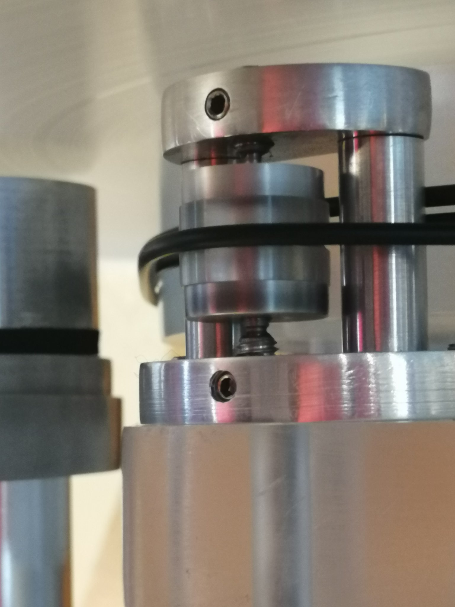

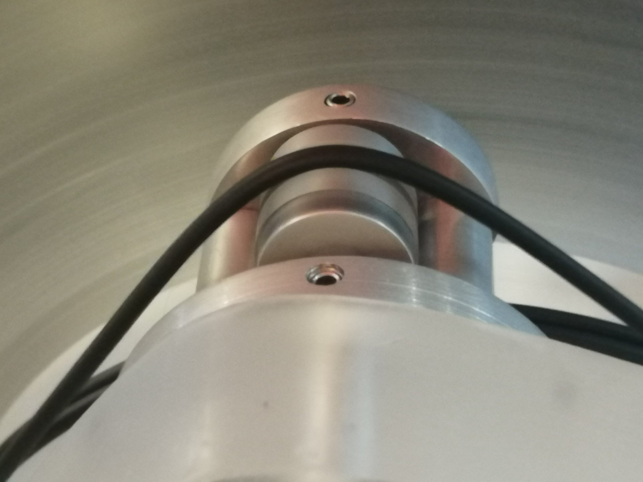

I revisited the 1mm nitrile and 2mm silicone belts. I was a little over generous with my previous evaluation with both of them. Both of them had strong points, especially imaging with the 1mm nitrile. Both of them lacked bass definition and depth, the 1mm nitrile was a bit thin across the board. The biggest failing was in the way they portrayed the leading edges of notes. They both had soft transients.
I also experimented further with the 2mm nitrile. I noticed that the belt tension that I am using was insufficient to curve this belt in as tight a curve as the diameter of the idler/pulley. This resulted in the belt arching away from the idler and not making full contact.
These photos should illustrate better than my description.
The 2mm nitrile had scored highly on tonality but imaging dynamics and transparency faired less well. I had noted that these belts seemed unstable, like they were only just hanging in there. The way the belt interface with the idlers could well explain this.
I remade these belts, increasing the side force on the motor from 0.75N to 1.25N.
The improvement in sound quality was quite dramatic. Imaging and transparency both improved. Dynamics went from OK to the best of the test group. Unfortunately this came at the expense of midrange tonality. Overall still better than previously, probably just behind the 2mm EPDM.
The 2mm EPDM also suffered from the belt arching away from the idlers but to a lesser extent. I made up a second set of 2mm belts of this material with a side force of 1N. These weren't quite as good as the 0.75N set, loosing a bit of midrange fullness.
I'm currently just leaving the 2mm EPDM on the deck and living with them, getting used to them. Compared to my reference 1.5mm nitrile they seem to be better tonally from top to bottom, image better and be very slightly more transparent. However they do seem to be slightly softer on transients. This might be an illusion as the body of notes and the decay are better so the transients only suffered in comparison.
I'll live with the 2mm EPDM for a bit longer then swap back to the 1.5mm nitrile for a while.

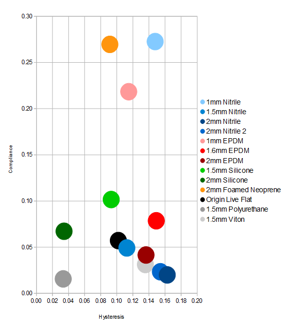

This chart shows all of the belt materials that I have tested so far.
Compliance is shown on the x axis with stretchier towards the top and less stretchy towards the bottom.
Hysteresis is shown on the y axis. Hysteresis is the internal damping inherent within the material. Higher hysteresis means greater damping.
Please ignore the scales on this chart, they are calculated around my target belt tension. The important thing is that the difference between the different materials is clearly visible.
Of the materials shown I have not made belts from the polyurethane. It feels too inflexible and low friction, it would probably need excessive tension.
I was unable to listen to the 1.6mm viton as it slipped on the drive pulley.
I have made belts from the 1mm EPDM but have not listened to them as yet.
2mm nitrile has two entries because I wanted to double check that my measurements are consistent. The two sets of measurements are very close. The second set were taken on a much warmer day which would explain the slightly higher compliance and lower hysteresis.
In general it would seem that belts with lower compliance and higher hysteresis sound better. That is the belts located at the bottom right of the chart. This by itself would suggest that the 2mm nitrile should be the best sounding. It very nearly is with high belt tension. What the chart does not show is the flexibility of the belts. It would appear that being more flexible is beneficial. The 2mm nitrile is much stiffer than most of the other belts, too stiff. The 2mm EPDM is probably about on the edge of being too stiff. The very flexible belts seem to have a smoothness and openness.

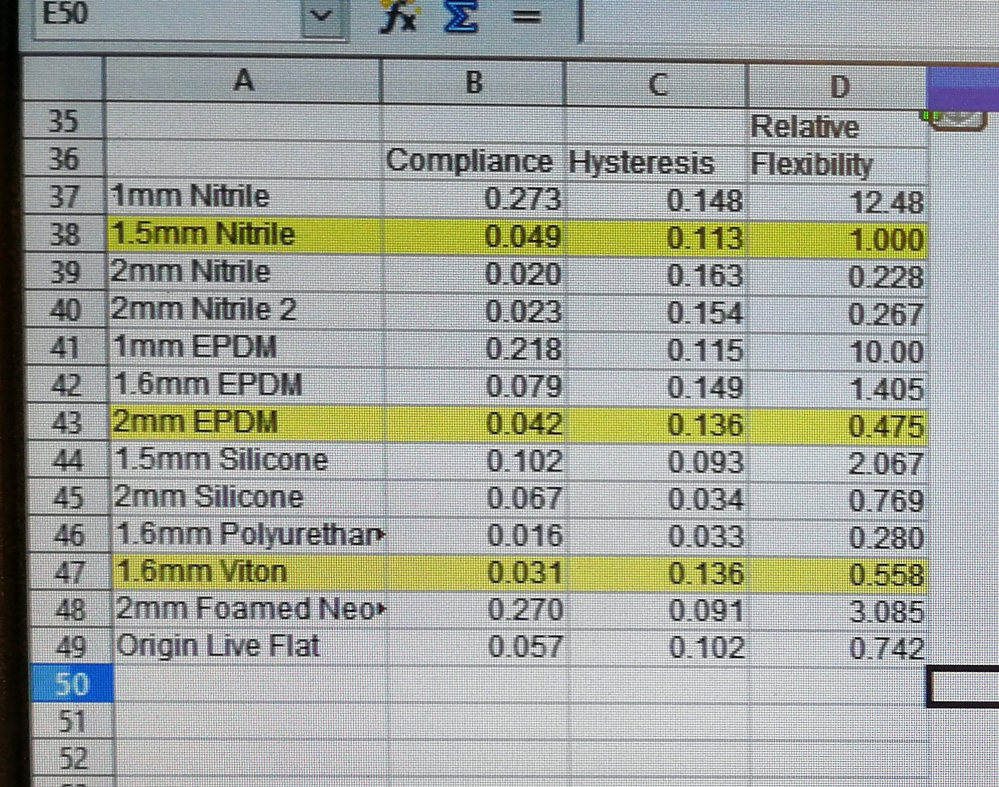

I've made an attempt to estimate the relative flexibility of the different belts. I used the 1.5mm nitrile as a basis, hence it having a relative flexibility of 1. Higher numbers are more flexible.
The calculated flexibilities line up pretty well with how the materials feel with the exception of the polyurethane which feels stiffer than the chart would imply.
A thinner belt made of the same material will be more flexible but will also have greater compliance. The trick seems to be to find a belt that is low compliance, has high damping and is flexible.
The 1.6mm viton looks ideal being stiffer than the 2mm EPDM, having the same damping and being more flexible. Unfortunately this belt slipped. I have remade these belts to have 50% more tension. Hopefully this will stop it slipping without introducing additional problems.
I'm more interested than ever to get the polyester monofilament thread. It will hopefully be very low compliance with high hysteresis. Being very thin it should be very flexible.
I'm still going to keep the 2mm EPDM on the deck for a while before I compare back to the 1.5mm nitrile. Then bring in the new materials.
Niffy

you have clearly thought your measurement process.
Now, the challenge is to correlate your listening results with the appropriate material qualities (characteristics).
I see where you are coming from with respect to the hysteresis concept. Do you think that the time scale may affect hysteresis, i.e. if the stretching/contracting happens in say 1 sec or in 0.1 sec (or less). Would that make a difference in the measured hysteresis? Just a thought.
Keep up the good work. It's extremely interesting and thank you for sharing.
Let's see how the polyester thread fares against the other materials. And even more importantly what your listening impressions are.
P.
Hi Panos, excellent question.
The time scale will indeed affect hysteresis. The measured hysteresis of a material will vary depending on the magnitude of the load and rate at which the load is applied. This is one of the characteristics of viscoelastic materials. I have tried to keep the rate at which I add and remove the weights consistent. The time taken to fully load and unload is much longer than I would ideally like due to doing it manually, minutes rather than milliseconds. A material that shows higher hysteresis at low frequencies is almost certainly going to also show higher hysteresis at higher frequencies. This is why I said to ignore the scale on the chart in my previous post. The chart shows the relative difference in hysteresis rather than a meaningful absolute value.
As I purchased the Sulky polyester monofilament from New York in the US it's expected arrival isn't until the 3rd of July. Hopefully this is a pessimistic estimate to prevent premature chasing and it will arrive before then.
Is should give me plenty of time to finish testing the other materials by then.
Niffy
