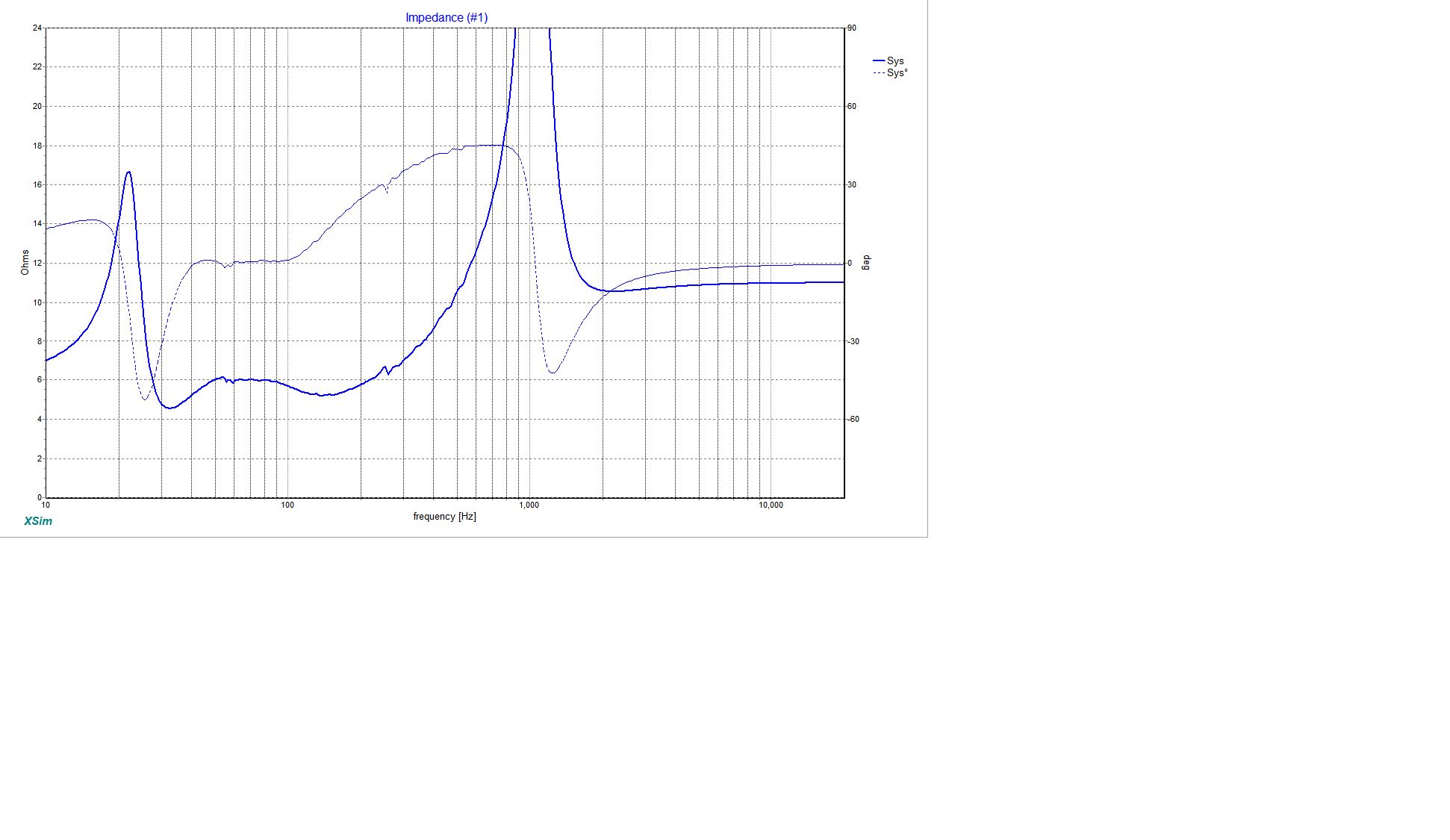

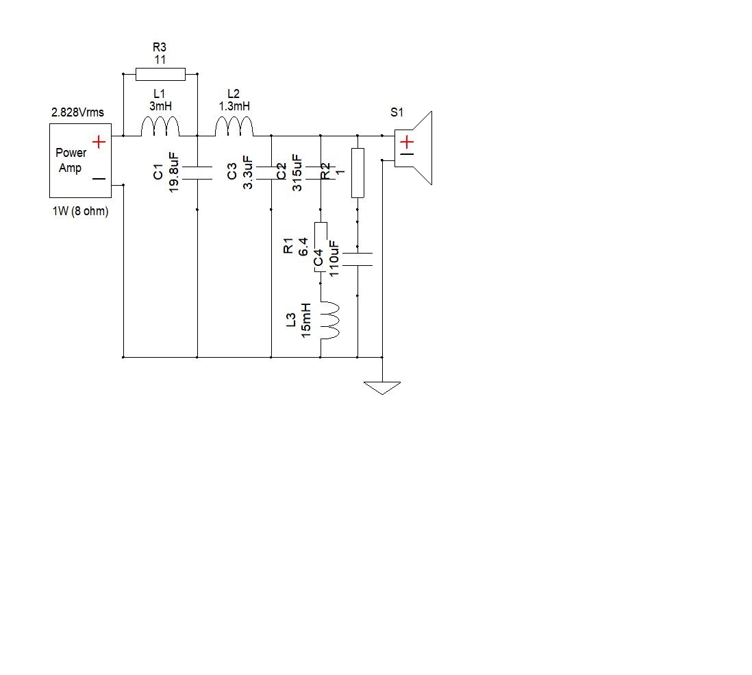

here a filter sim, ignore the low end that was measured in box with the non final port size int the frd I get from the OSMC thread.
Sooner in the thread I posted a simple filter for illustration of low pass with a conventional mid driver. Here I try to do a 900 hz cut off. there is 12 dB roll off at 900 hz, -6 dB at 500 hz, and because the break up after 900 hz it migth perhaps work better at circa 1340 hz where it finally drops to hell !
I think it is over complicated, but I am a noob with filter -while electrical phase are not too bad in the low end till the Fs- and inspiration came from reading a proposal from @LineSource in this post for the start.

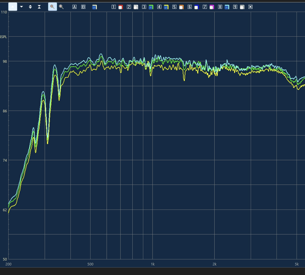

I know also @Zvu measured the 12PR320 in a gymnasium at 2 m heigth and worked with the ST260 with a higher 1200 hz circa cut-off ... if chimming in Zvu, any advices are welcome too 🙂 about what you find, liked or not. Did you like the blend with the ST260 & The 12" from Faital ?

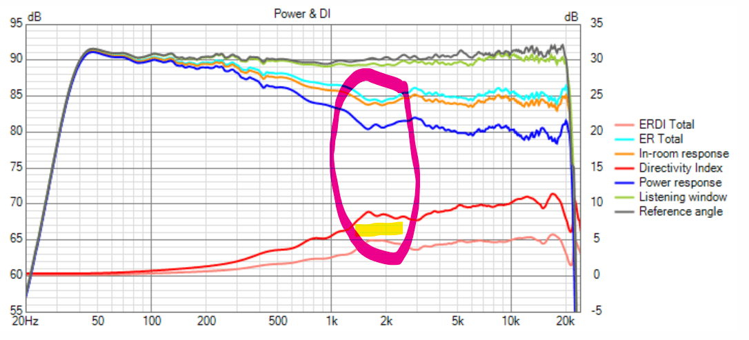

Like wesayso said that isn't what he was referring to and mabat's waveguide's are pretty exemplary in that regard anyway.Readed the Kimmo's post. Seems he doesn't like those early reflexions that horns are inducing...
I have highlighted it here in the graph of the KH150, it can be more pronounced than this if the directivity of the waveguide is held high and constant for as long as possible, at some point it has to drop, so there is a directivity drop which can go from high to low in a fairy small frequency band. If the DI was like the yellow line it would smooth out the step.

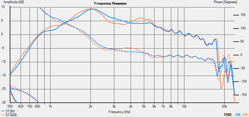

Diaphragm loading comes primarily from the driver itself rather than the horn. It is connected with it's compression ratio. The Yuichi is not necessrily in its element at 600Hz.600Hz for the Faital is no problem in a horn with an exponential throat like a Yuichi or similar
Except it actually makes a huge difference, neither are my own measurements but they illustrate the point, a few dB difference between 4K and 500Hz vs nearer 20dB.Diaphragm loading comes primarily from the driver itself rather than the horn. It is connected with it's compression ratio.
HF108 ST260
HF108 on something that has a much higher radiation impedance to a lower frequency
I did not say it was, but it is about an octave above it's cutoffThe Yuichi is not necessrily in its element at 600Hz.
