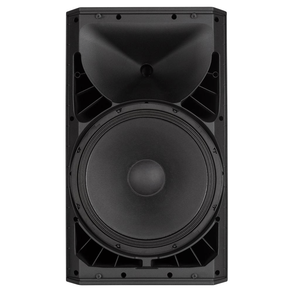

In the pro world, these issues are overcome by using larger drivers above their resonance freq.With some basic understanding of horn science combined with common sense, it's easy to see why a driver yelling in reactive mode isn't particularly pleasant to listen to.
However, even RCF uses a fairly deep expo horn in its 2-way systems combined with a meaty 4" dia. driver for an unprecedented low crossover frequency of 650 Hz.
In their more recent ART series, the XO was increased to 800 Hz to compensate for the reduced loading of the shallow waveguide.

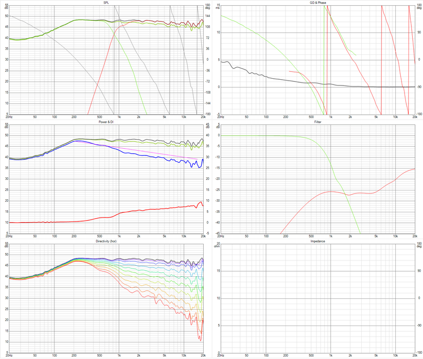

I haven't got further from simulations for now. Unfortunately my time is needed elsewhere. Here's the crossover sim for frequency response from ATH thread - it should present a good starting point.

As the discussion originated from the choice between the ST260 and the ST280, both well designed ATH waveguides with slightly different properties.
The Yuichi, to which you reacted, was mentioned to ***** the performance of a particular CD down low. So that's what got you all rattled up?
The main message, important to this thread was: use the ST280 if you want to cross low, use the ST260 if you want the most even response.
If you are set that you want to cross low then the ST280 will help to make that easier. As always it is a matter of balancing the priorities and choosing which you prefer.
Both of them have quite similar patterns at 900Hz, with the -6dB point being about 60 to 65 degrees. They both loose pattern gracefully to allow for the directivity to be blended lower, the 280 loads the driver better but because of that beams more higher up.
Both control the directivity but the ST260 is more consistent across all angles.

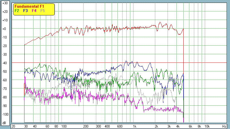

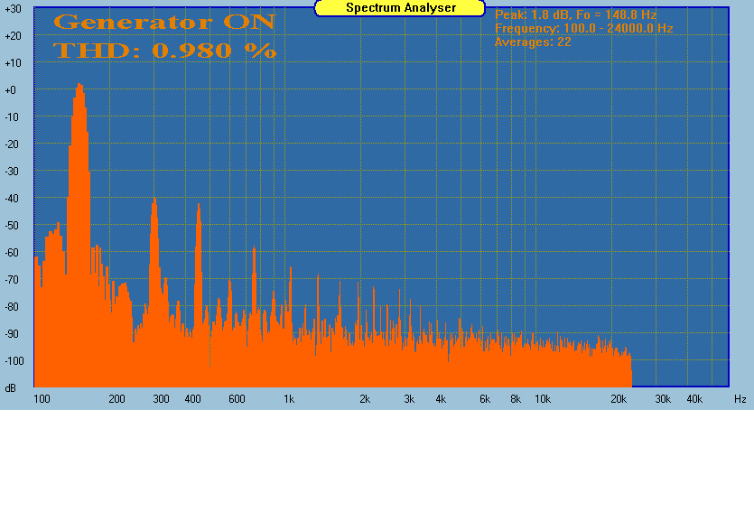

May I ask please what you think about this non linear distorsion test of this close driver : Faital 12PR300 measurement -predecessor of 12R320 used in this thread- provided by Brandon (link in one of my post above). this is a sweep test, so fundamental measured if I understand. Notice between 500 hz and 600 hz H5 is a little high with -52 dB "only".
Are the H5 (grey line) not a problem to be used above 300 hz, or one just should not care and go straigth forward to use it 2 ways till the cut-offs discussed here. (trade off between a 2 ways and a 3 ways).
On the 150 hz tone, one can see if I am rigth : H3=-48 dB ; H5=-59 dB.
