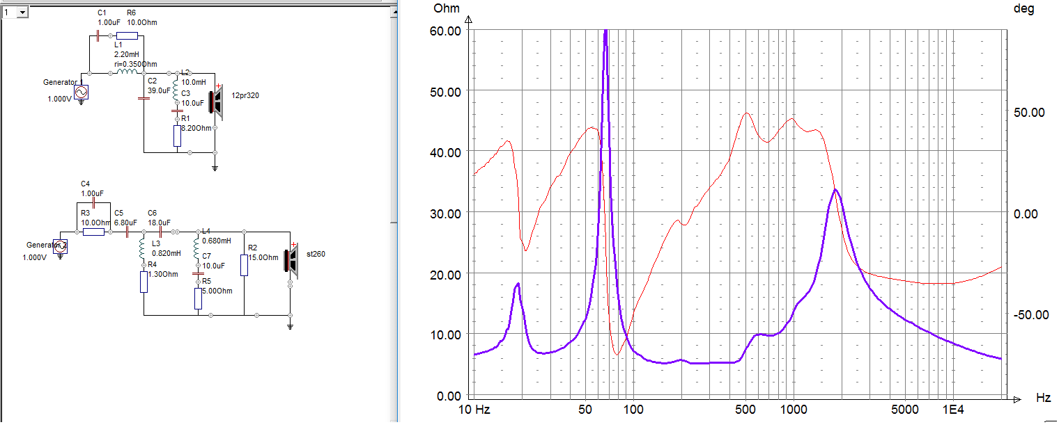

I haven't got further from simulations for now. Unfortunately my time is needed elsewhere. Here's the crossover sim for frequency response from ATH thread - it should present a good starting point.

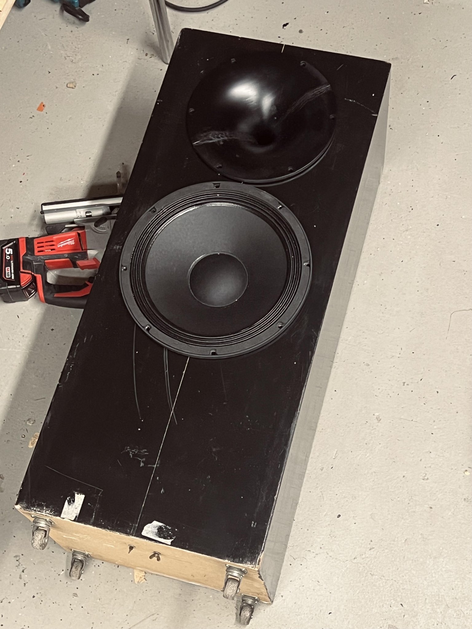

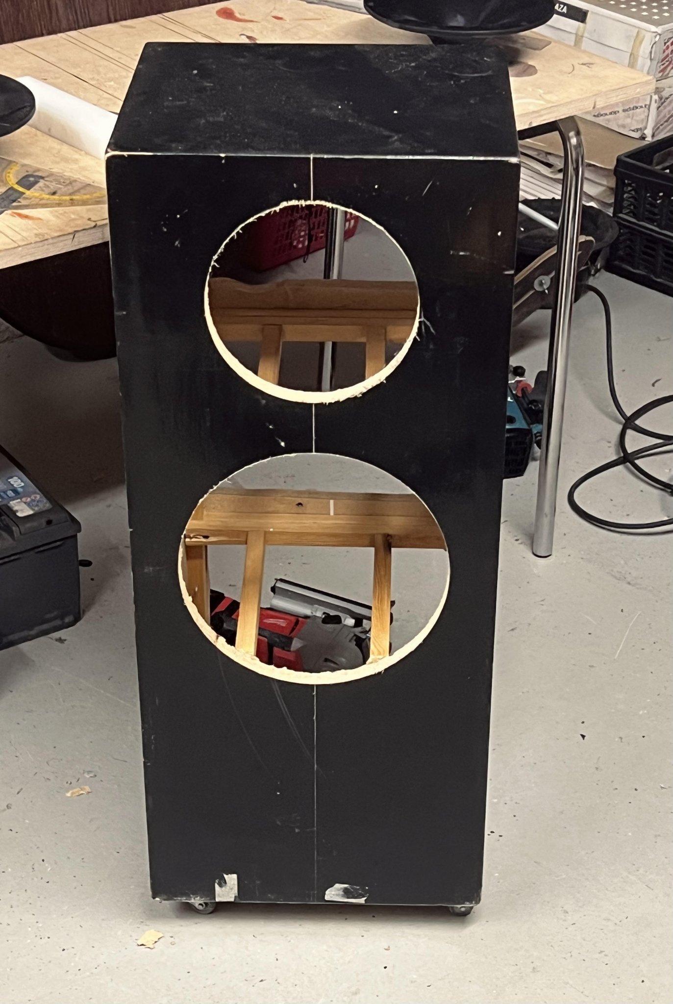

Before starting to route holes for ST260/B and 12PR320:
ST260/B diameter: 259mm /2 = radius 129,5mm
12PR320 diameter: 316mm /2 = radius 158mm
If they are placed at the closest distance to each other, c-to-c is: 287,5mm (11,3") and thats wavelength of 1196.5Hz
Should I position them according shortest C-to-C or maybe with other way if trying Zvu´s xo?
I could try this with my old enclosures and their volume is 85L /each. Baffle width is 380mm, height 900mm.
All equipment is ready and I can post measurements for ST260/B with Peerless DFM-2535R00 after done.

Correct me if Im wrong, but was that Kimmosto´s 1-1,2x wavelength rule/suggestion for 2nd order crossovers? I would gladly follow that 1,2x rule, then spacing between horn and woofer edges would be 5,7cm/2,2" (if xo point is 1200hz) and that would look nicer. But if that rule works best with 2nd order and Zvu´s starting point is 3rd order does it change things and I have to push them closer /max? Am I overthinking this?
only measurements should tell you if you the choice to adjust that c-to-c and as it is also the version for baffle you have to consider the offset in depth for a second order and or go asymetric XO. Easier with DSP. I will go for a stack of two cabinet to make it easier.

Closer is usually better, you're going to have to work to get the crossover at it's best in any case.
@fluid could tell you if @kimmosto restricted this concept to second order crossovers. From simulations with Ath, I found that 1.2 lambda is optimal for a less abrupt transition between waveguide and woofer, despite that I simulated the a crossover in VCad that is asymmetric, fourth order on the tweeter, third order on the woofer.Correct me if Im wrong, but was that Kimmosto´s 1-1,2x wavelength rule/suggestion for 2nd order crossovers?

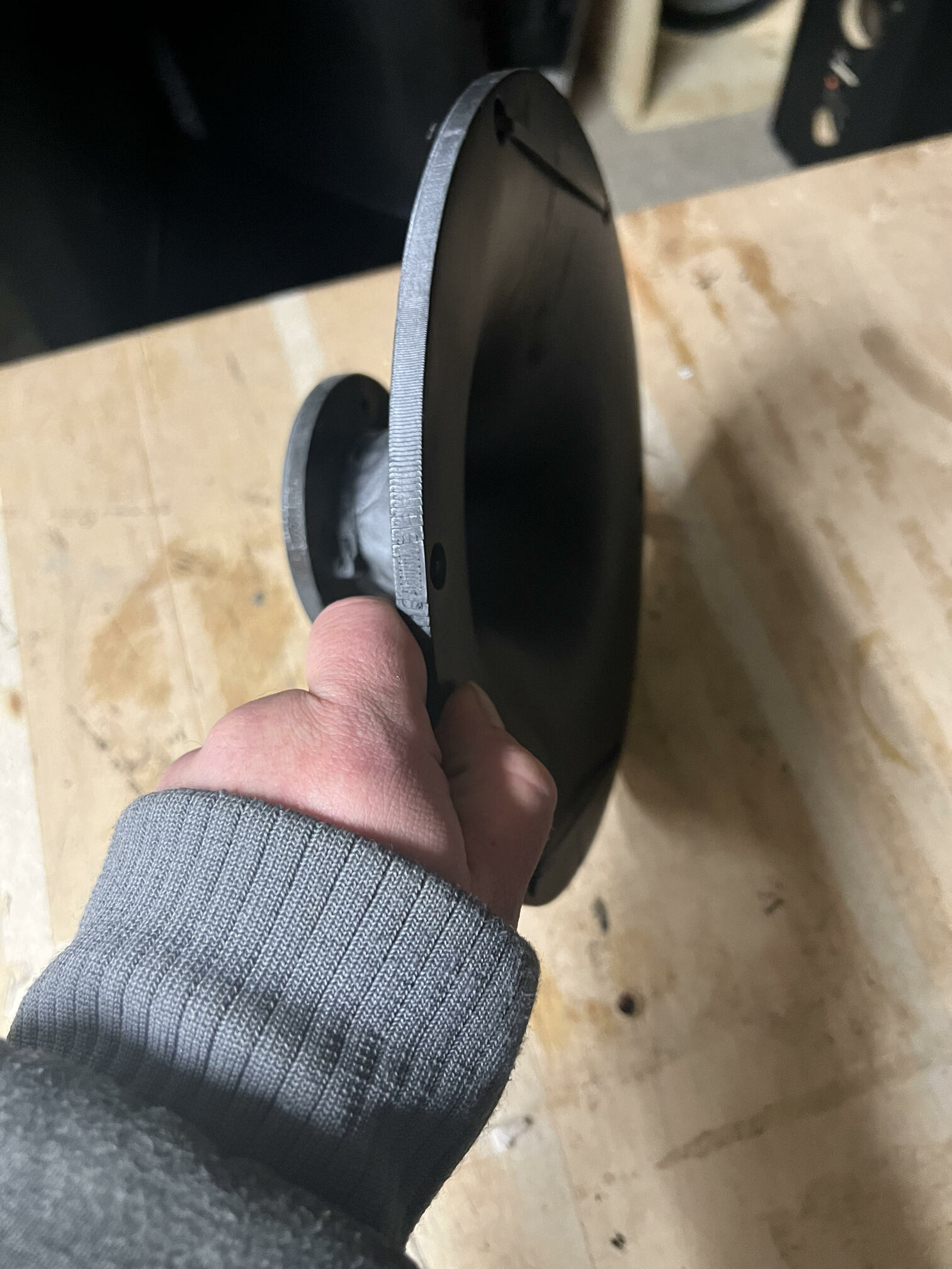

P.S.: Where did you get your waveguide printed? Surface finish is looking nice.

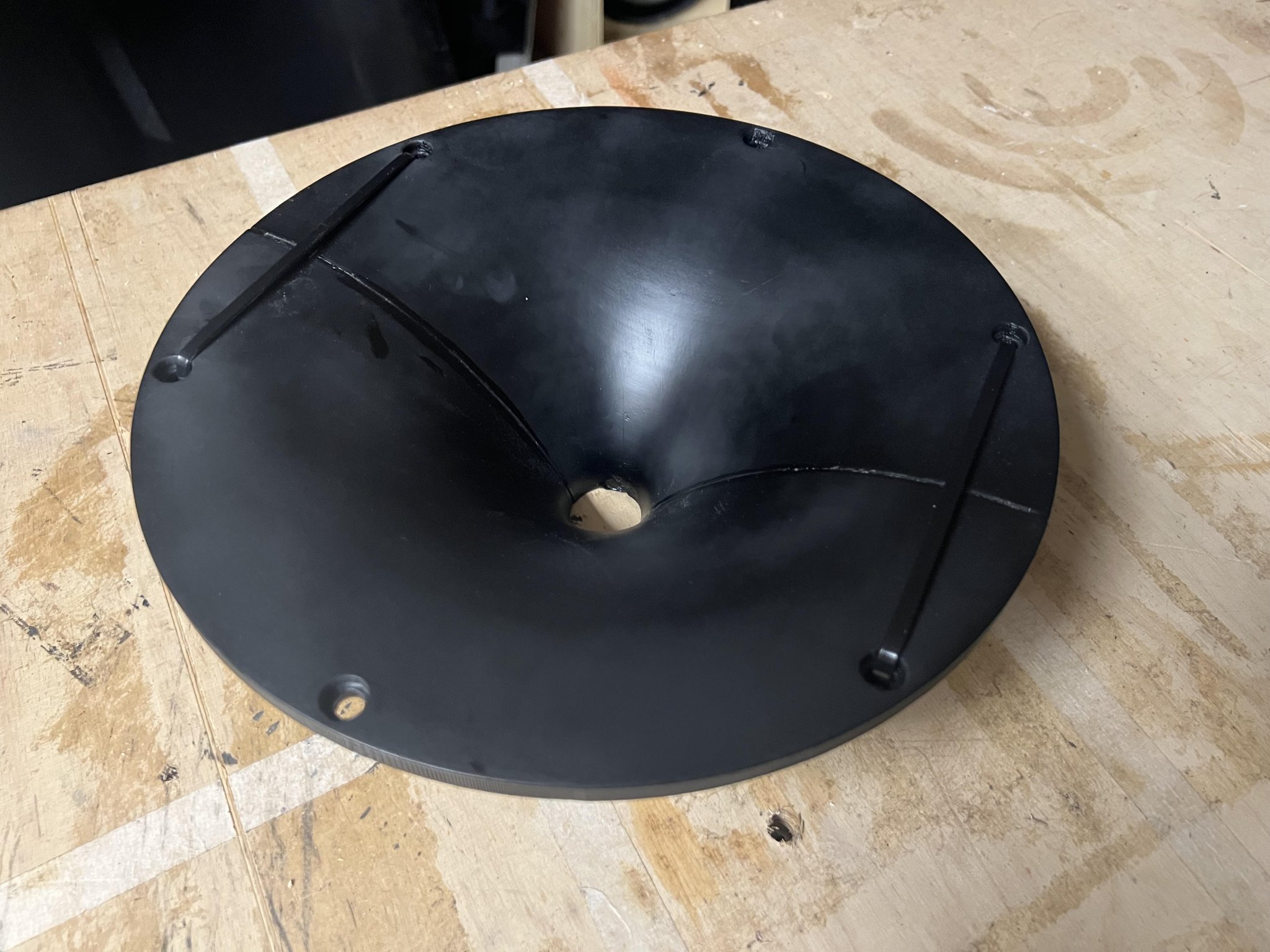

Sheeple: "P.S.: Where did you get your waveguide printed? Surface finish is looking nice."
Thanks, my friend printed them and there was some sanding before glueing halfs together. Still some finishing ahead to get glue seam disappear.

@Oceanw ,With the B baffled version I should be concerned also by the horizontal offset between two driver for phase integration if made passive... The mezzo calapamos description by Humblehomemadehifi shows it has to advance sligty the horn mouth for proper phase in the passband. Yours being less deep it could be different, so two box construction sounds like a nice choice...

Yes, when you measure each driver rotating on its on-axis like in the measurement manual then you would change the coordinates to reflect the build construct as per same measurement manual.
Then, if it is a prototype box and you plan to build the real one so that the c-c can be changed in reality, you may very well deviate from the actual build driver positioning in the simulator for extra design freedom, like changing the Y coordinate to find smoothest c-c for crossover frequency that might have other constraints to it. Play with the simulator, practice taking measurements and how to process them for simulation. Don't be afraid of building several prototypes, each is possibility to tweak multiple parameters / weed out issues. And have fun!🙂

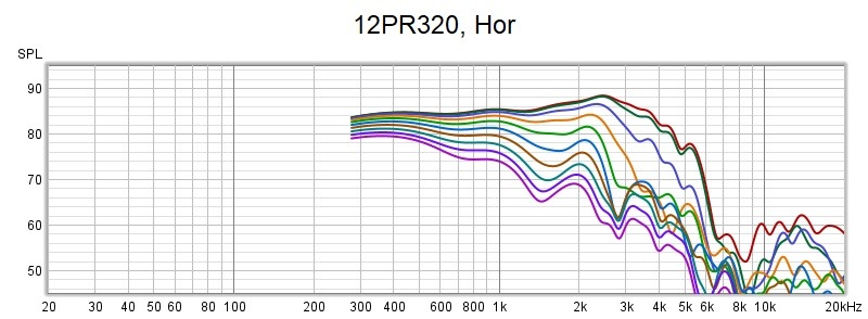

Im wondering will baffle step loss of 380mm wide baffle be visible in 1m measurements or should I merge diffration simulated response on the top of already merged far and near measurements. Hmm.. too early to speculate this, shall measure first and check after that. And apologies for diyiggy for offtopic and hijacking your thread! There will be one week delay for this project due to work and I will post measurements when done that relate this thread topic
Simulated baffle diffraction should only be added to half space measurements like near field. 1 m is not really truly in the far field for most speakers but it is a reasonable compromise if measuring in a small room. If not measure further away but don’t add baffle diffraction to what is meant to be a far field response.Im wondering will baffle step loss of 380mm wide baffle be visible in 1m measurements or should I merge diffration simulated response on the top of already merged far and near measurements. Hmm..

Measured 12PR320 and Peerless DFM-2535R00-8 in ST260B horn.
Heres for start 12PR320 horizontal measurements from 1000mm distance. Any tips what scaling/limits in REW should be used?
