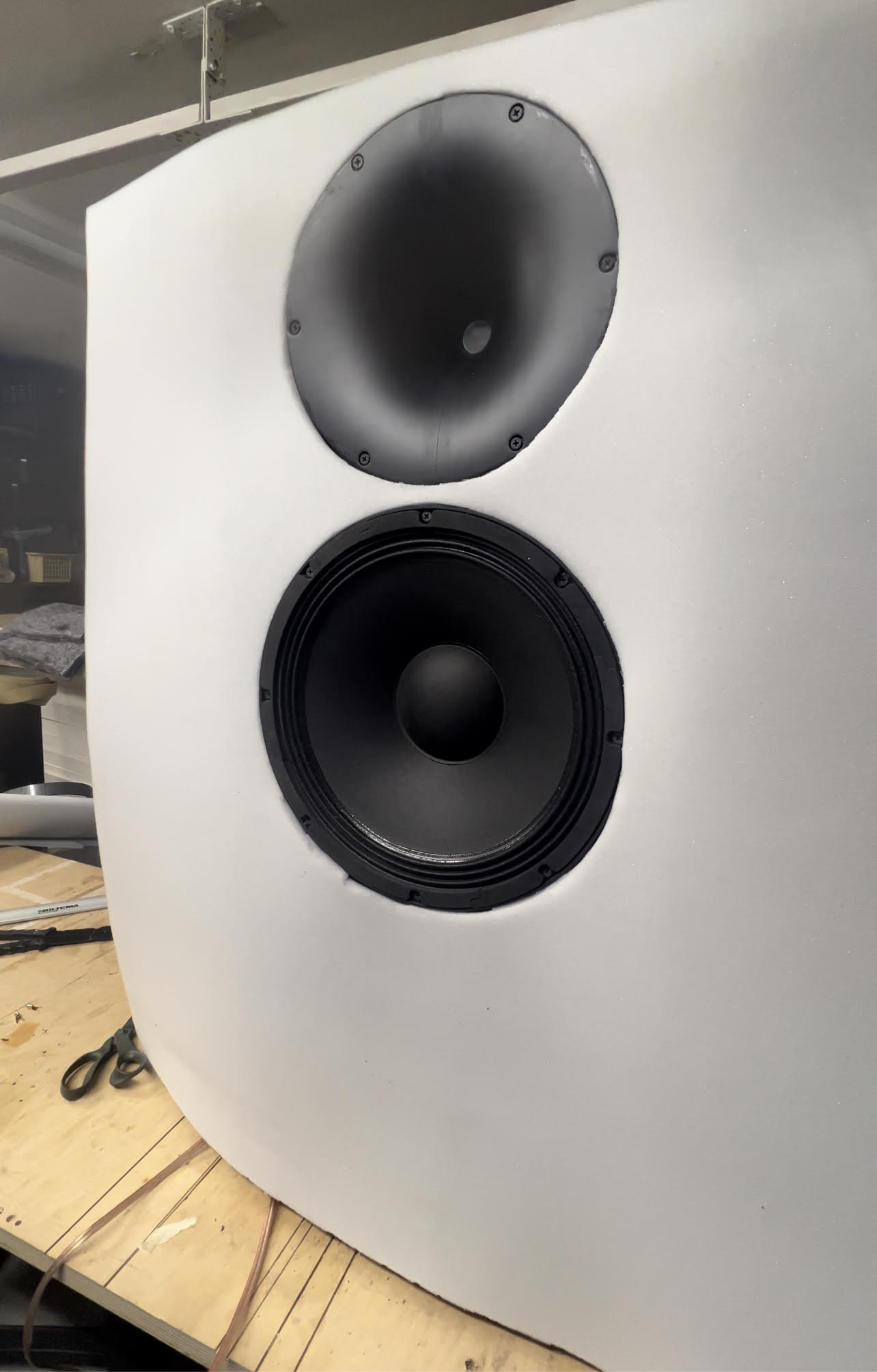

ST260B was not flush mounted.

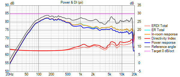

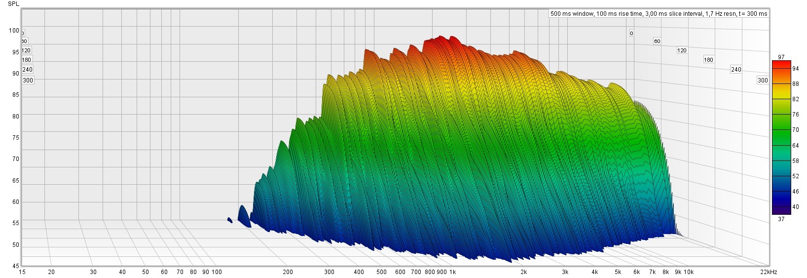

Heres waterfall from straight ahead. Let me know if you need different and Ill post itOr a bit higher.
Do you have a waterfall to show resonances (e.g. 5.5kHz)?

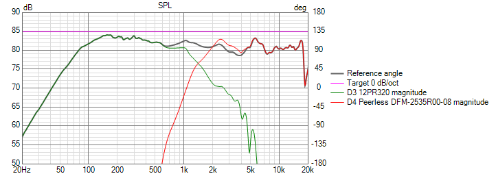

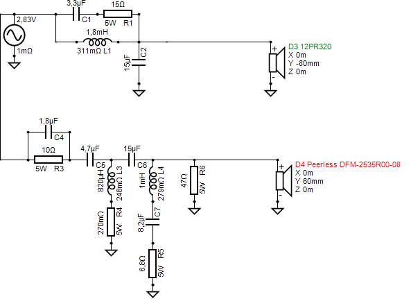

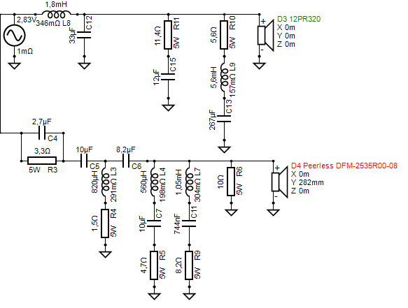

Heres some testing, used Zvu`s sketch as starting point. There is zip with all Vcad files if anyones interested.
you should notch this 5k/6k rigth in the sibilance area with a RLC or a // notch...

Diyiggy: "you should notch this 5k/6k rigth in the sibilance area with a RLC or a // notch..."
I will try this! I have also Minidsp and testing would be easier with it, but maybe I have wrong assumptions but have anybody else noticed that many builders trying active DSP solutions have returned to passive crossovers after trying their best? Do those active solutions need more skills to sound "analog" / passive like easier sound?

I also made "fake flush mount" from foam and its thickness matches ST260B. Have to attach it properly (it fits perfectly unlike in attachment pic concerning ST260B) and take measurements with DFM-2535R00 again. Maybe in best case there happens something to that 5,5-6Khz bump?

for proper crossover full spin is needed or you could try trick from napilopez but it is a rough way:Heres some testing, used Zvu`s sketch as starting point. There is zip with all Vcad files if anyones interested.
https://www.audiosciencereview.com/...th-rew-and-vituixcad.21860/page-2#post-752673That translates to H (0,30,60,90, 180) and V (+/-30, 60, 90) for a typical speaker with vertically aligned and horizontally symmetrical drivers.
I really duno for DSP as I never tried, I like passive and mechanichal cause more elegant but I am looking into such a solution at least for the design process as advised by experienced guys here. Copper became expensive and for sure clicking is faster than soldering when experimenting. Then nothing should stop you to translate it into a passive solution. But plates are seductive for the bass unit to setup into each own room (bass boost if needed).
In the OSMC thread from Mathias you should find the FRD and ZMA of the 12PR320 made by Mbrennwa (his member id) in 77 liter if I remember correctly, this is how I simed the filter above... came strangly close to the impedance curve what is showing Tony Gee from HumbleHomeMadeHifi. Anything between 77 liers and 113 litters should be fine ; the Vas of the neww datasheet is 113 liters.

The passive filter from Tony Gee doesn't seem that complicate but the unit used HF108 seems smoother than yours and when on the baffle the horn should exhibit perhaps a more ragged response. >= 1200 hz cut-off seems wize, not as I planned with lower cut-off with the BMS (900 hz as the lowest cut-off; many people found the sound of horn/1" combo a little hard here. But sure the Mabat horn plus the BMS are more tolerant there... one has to listen to it for real to know and I am way to slow on my projects to help that much alas).
I think it is ok to stay passive, a notch is easy to do and you will know more after in room measurements and hearing tests 🙂 . Looking forward too to see your progress.

Many who design without measurements (or in spite of them) like the quick swap of the DSP... but passive is just as capable of achieving the end goals otherwise. It helps to have the right tools, for example you can use crocodile leads rather than solder, be set up with a simulator, use an equaliser for testing.
I have the HF10AK and 12PR320 aswell. Do you cross them active or passively? If passively would you mind sharing the schematic?I use the Faital 12PR300 and the 12PR320 for moderate level PA. The woofers have a very smooth and linear breakup region above 1KHz which makes it easy to crossover to a 1" CD on an approx. 12" wide horn. These sorts of designs are meant to use the woofer beyond its pistonic range, because that is also the range where the directivity increases due to cancellation.
You want to balance the smoothness of the directivity transition and woofer breakup modes, compression driver distortion to get an optimal compromise. No single parameter will be textbook perfect. Higher-order XO slopes help too.
I cross these Faital woofers to a Faital HF10AK on a QSC clone at 1300Hz LR4 and the sound is really quite excellent, either for PA or in my living room. But at home a lower crossover @ 800Hz would probably sound very nice too, as long as you aren't pounding the compression driver too hard. I would be more concerned with finding a 1" horn that sounds good in the higher octaves.

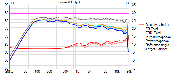

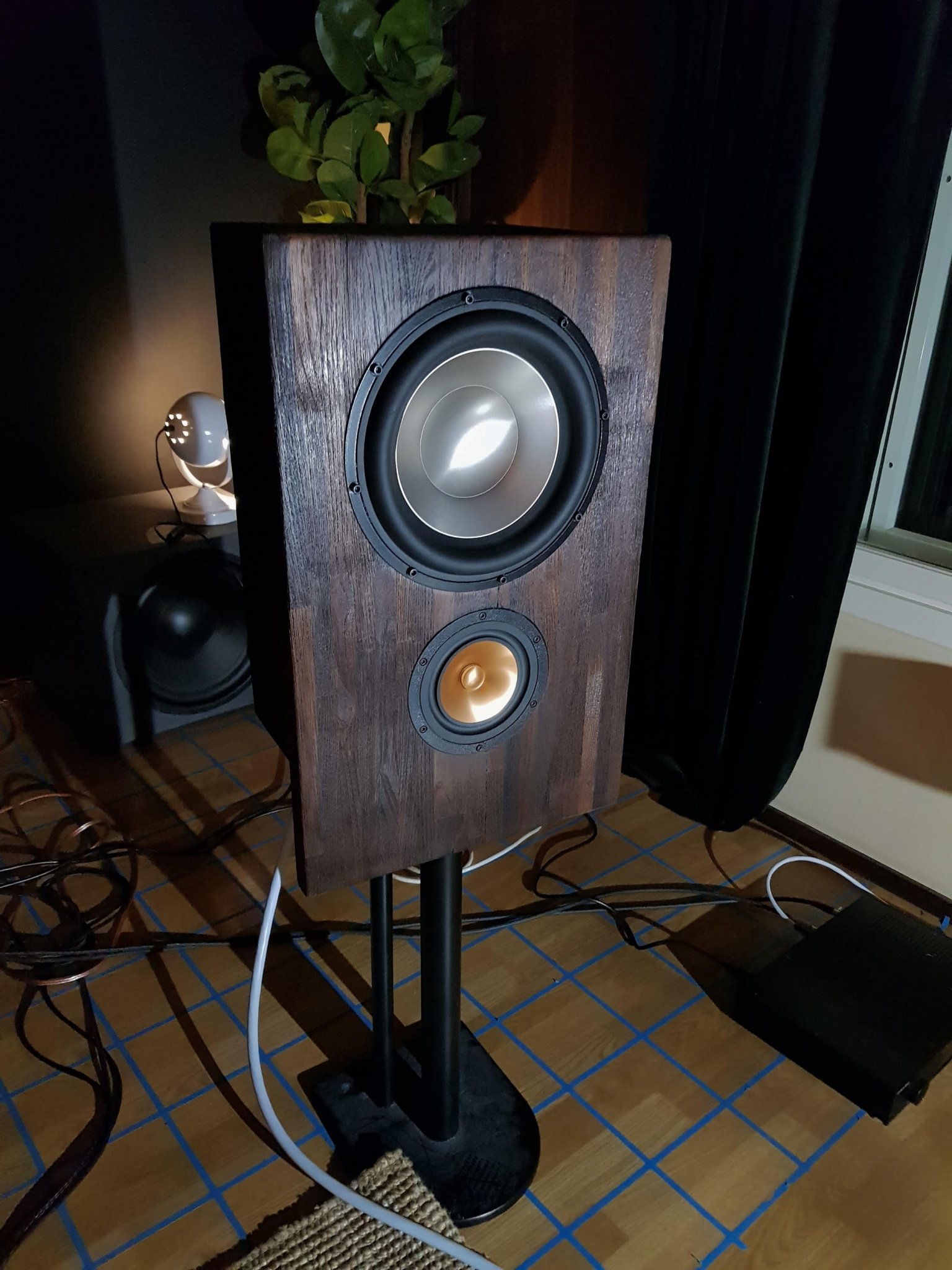

Some progress after break.

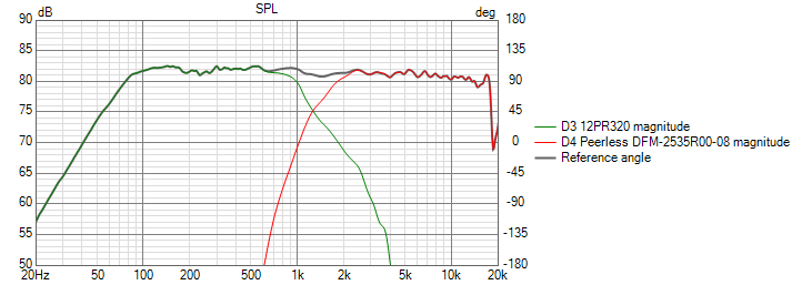

This was best I could do with 12PR320 and DFM2535 at ST260B.
Real-world measurement showed some resonance at approx 1Khz. I have to study it more, it might be from waveguide.
Waveguides were printed in two parts and I should have been more careful before assembling glued waveguide to enclosure: the joint surfaces were not in same thickness/level and waveguide made crackling sound when screws were tightened.
I will make some reinforcement with epoxy at the backside of waveguides and sand all joint surfaces to avoid this at the final phase.
Next I measure Peeless SLS12 and model it with Vcad. It might be a vain hope to get that work at approx 1200Khz XO freq.
But im tempted to still try it, SLS12 would offer F3 of 50Hz in my sealed 80 liter enclosures. Goal of this this project is for home theater (LCR) and they will be on wall.
