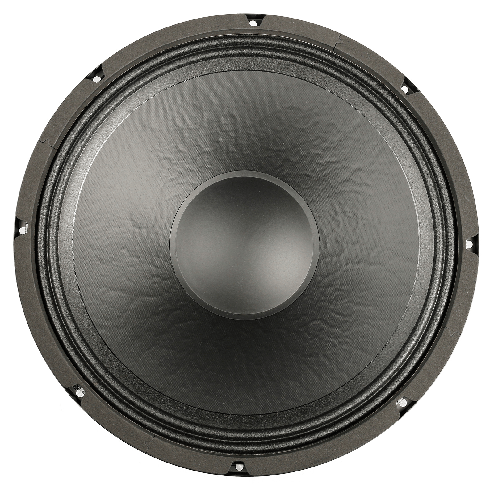

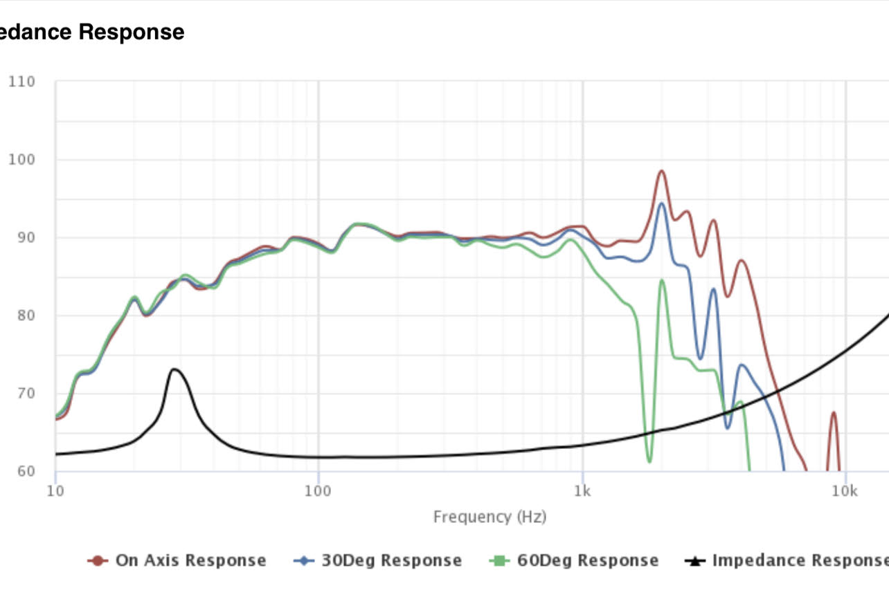

Heres pic of SLS12 response from manufacturers spec sheet.
If I hammer the breakup with notch, could it work? (XO at 1200Khz)
(12PR320 may be a clear winner already at this point concerning midrange quality but I'm ready to make compromises due to use only with movies and SLS12 better low end extension in sealed enclosure which could be integrated better with subs)

What about keeping the 12pr320 and work with the SLS below as a bass driver ? The SLS has a better usefull Fs : lower, for the bass. Could permit a low electrical slope between the two units. But 3 ways and less efficienty due to the SLS. best efficienty with the 12pr320 in BR is around 91.5 dB around 200 hz.
I do not know if this same idea could work at the sacrifice of 12PR320 efficienty if used open, still with the SLS BR.

Thanks for your thoughts diyiggy.
Youre right about 3-way but I kinda hope that SLS12 would work adequately in 2-way so I could save 12PR320 for other project in living room. This project is for bedroom cinema.
Also, my measurement space wont allow to rise speaker high enough to get accurate measurements under 650Hz, which I think would be important to get midwoofer and woofer XO´d at range of 250-400Hz.
When thinking about movie speaker I believe that larger cone (12-15") would produce more violent midbass and explosions if it can handle all bandwith of approx 80-700Hz by itself.

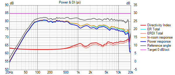

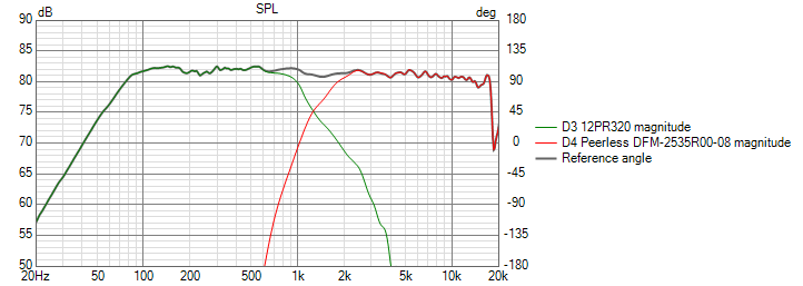

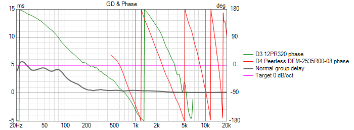

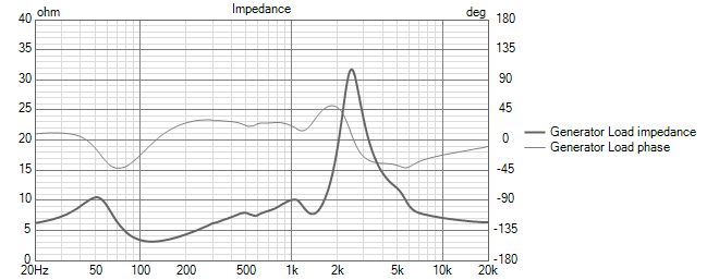

Heres updated data for 12PR320 and DFM2535 in 82L sealed test box (impedance and phase added, couldnt update earlier post anymore)

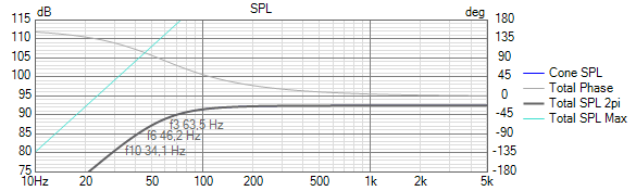

My sim for 12PR320 in sealed (net 82L/2.9cu ft)
f3 89,8 Hz
f6 61,7 Hz
f10 43 Hz
In this sealed enclosure with DFM2535 and ST260B waveguide sound was clean, powerful and dynamic but without lowest bass. I had just one test speaker which was played middle of room at measurement point. Amp was Crown XLS1002 and I cranked volume quite hard, no problems. Especially electrical music sounded good, bass was snappy. Would have benefited from placement closer to the wall. Overall very promising, even with this bad placement and lack of lowest bass.

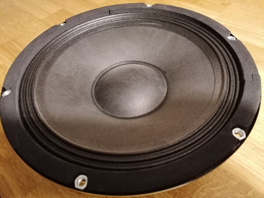

What a great response for a "pa" 12 inch, can be easily crossed at 1.2 khz and even higher, looks perfect for a 2 way, don't really see a reason to use a smaller mid in between for 3 way at home spl levels? Thanks for sharing your data, how do you like it now?Measured 12PR320 and Peerless DFM-2535R00-8 in ST260B horn.

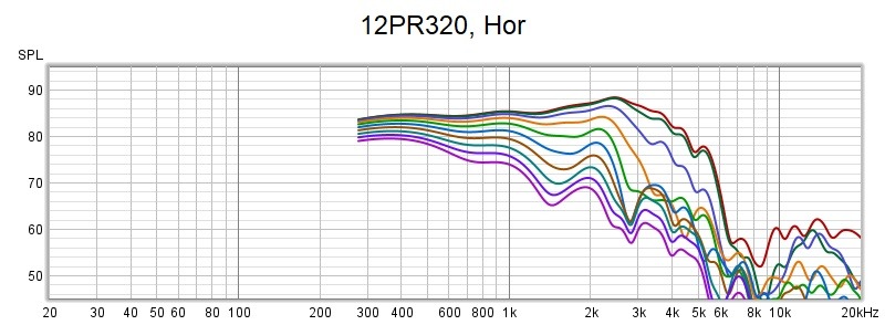

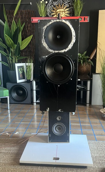

Heres for start 12PR320 horizontal measurements from 1000mm distance. Any tips what scaling/limits in REW should be used?
Currently, the drivers are not in use. They are awaiting two different horn projects to finish (Horn no.1931 by J.Crowe with GRS PT6825 planar and Athex horn by Mabat with DFM-2535)

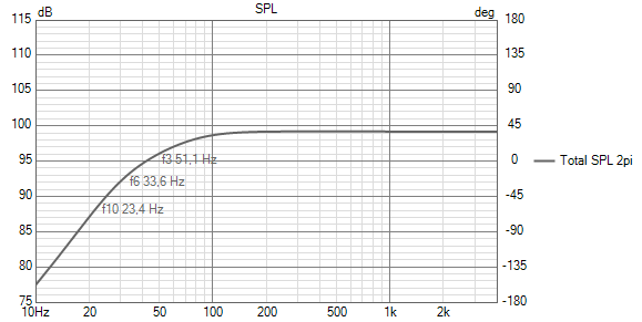

However, the 16 Ohm version fares better in (rather large) sealed cabs.
In 200L:

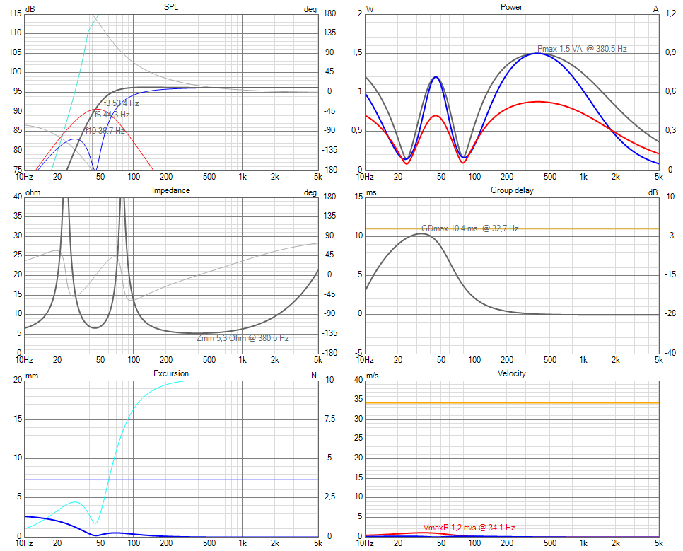

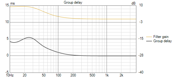

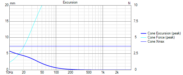

What if we tried the 8 ohm version in, for example, a 55L sealed enclosure and forced the response lower using moderately a Linkwitz Transform? Attached are the simulations with F3 of 51Hz. Or is the LT more suitable for subwoofers, and if used with a midbass, would it result in the loss of midrange reproduction quality because the cone moves with a larger excursion?
Personally I wouldn't use a LT for mid woofers such as the 12PR320 > I prefer to let drivers 'breath' as freely as possible.
A LT is a is a kind of band-aid that puts additional strain on the driver. The best excursion 'profile' is hardly any excursion at all 😉
Yeppa 🙂.A LT is a is a kind of band-aid that puts additional strain on the driver. The best excursion 'profile' is hardly any excursion at all 😉
A LT is a band-aid on any driver, anytime.
Boost anywhere in the spectrum, unless filling in response droops where excursion is still available, simply limits maximum linear response.

Hi Oceanw. Did you do full set of measurements (horizontal and vertical off axis in 10° increments per Vituix instructions) to obtain these curves ?
Hi Zvu,
I took just horizontal measurements according Kimmostos Vcad instructions with 10° increments. Nowadays I have better measuring space with thick absorption panels in floor and ceiling & left to right. Used Steinberg UR22 mkII and EMX-7150. I can send files if someone needs them. Does my measurement deviate from your Hor set? Im finishing some waveguides soon and start measuring different woofer modules in new measuring space/room.

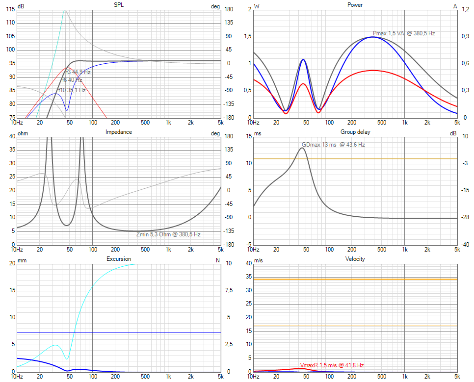

Unless you must have (~are married to) sealed, a 55l box tuned @ 45 Hz looks like this:
However, you could experiment with 'lossy/aperiodic' vents > oversized ports stuffed with open cell foam or something similar.
Example:
Since your cabs are 82l, some additional low-end extension is at hand. 82l @ 46Hz:
It's a matter of preference/taste of course, but especially with electronic music I find many sealed systems often sound too dry, depending on placement/space.
