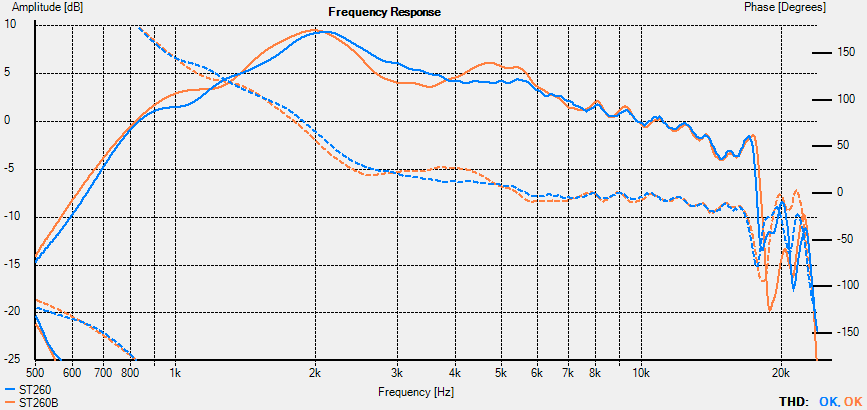

Except it actually makes a huge difference, neither are my own measurements but they illustrate the point, a few dB difference between 4K and 500Hz vs nearer 20dB.
HF108 ST260
HF108 on something that has a much higher radiation impedance to a lower frequency
I did not say it was, but it is about an octave above it's cutoff
In the first image, it's clear that the waveguide is 'fully' loading the driver around 2 kHz. Ideally, you should not use this wg below ca. 1200-1500 Hz.
It still seems like a semantic argument over terms, I tried to avoid using the word "loading" as it is the increased Radiation Impedance that is giving the increased output lower down which is what would be helpful to the OP if he wants to cross low.I think we've been here before, when Dr Geddes replied to your statement...

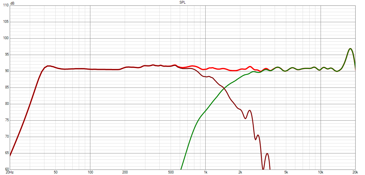

The two ways passive with high cut off is attractive cause less parts less monney and the high cut off reduce the expensive passive filter parts. But as some stay, too much trade offs equals not good enough equals too much expensive for what it is (Buy once cry once ?).
What Humblehomemadehifi hifi or Gravsen does not present is a more 3Ways classic but with horn from 1200 hz or above in spite off the classic dome ?

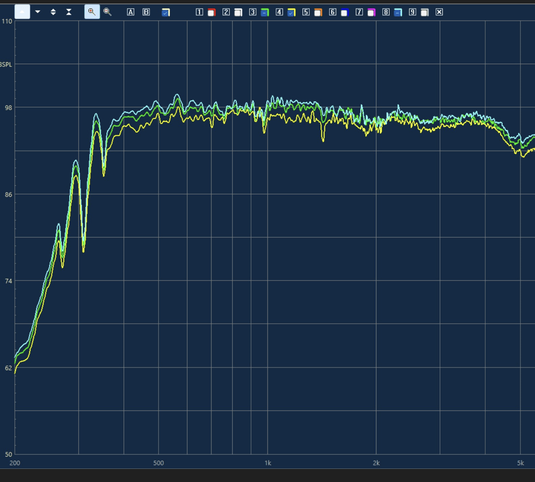

The data from the OSMC has a difficult to deal with dip, I don't see this being as bad in every measurement like this one of the mezzo Calpamos, so you have to decide how much validity you want to put into a basic sim using someone else's measurements unless you plan to copy exactly what they did.I had no coment about my naive try to low pass the 12pr320. So I surmise it is too much bad or unusefull as a choice factor (break-up trade off and cut off).

First there can be unit dispesrion, not ruled difraction and so on when testing the cab combo and sim have limits as sim tools. The most difficult to trust are third party T&S... I never see two people showing a close measurement of a same unit.
If you see 3 close design with the load of the 12pr320, OSMC, T gravsen, T. Gee. None has the same average dB level between 100 hz and their cut off, even liters load and BR vary, be it a choice by design or else. Not easy to be sure and very less easy to do it as good alone. 90 db to 93db average between the three designs. So you really want to know what to do... and advance carrefuly when a noob 🙂.
Sure there is a limitt to use else measurements. An impulse response should be good enough but seems it is maybe not due to testing environment.
