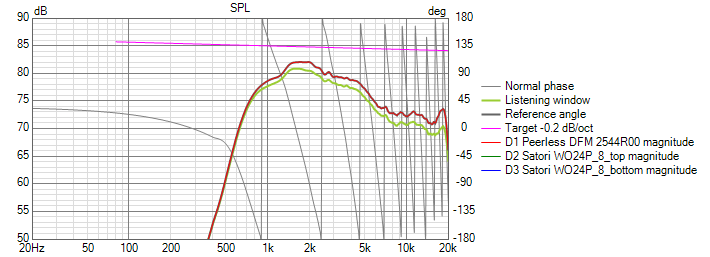

There isn't anything less flat about the BMS driver it depends heavily on the waveguide.

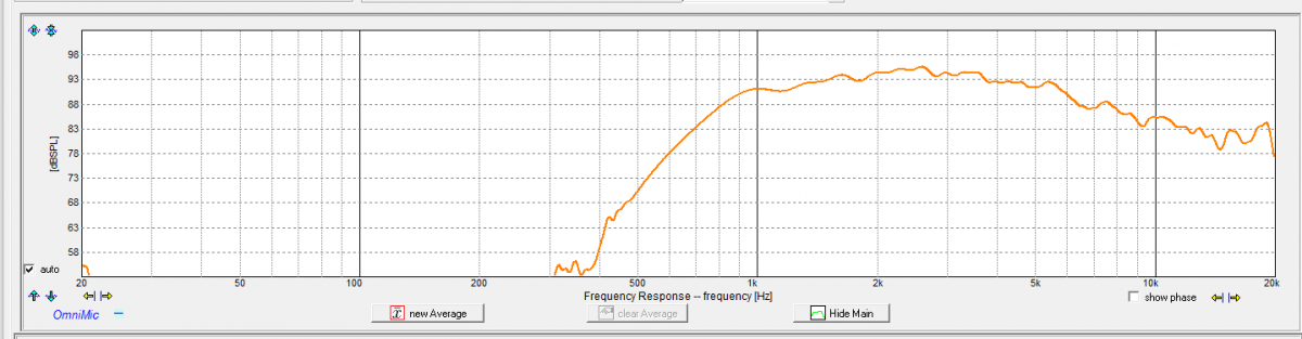

Here is a measurement (taken from stereonet) of one on the nice QSC waveguide you can't get anymore. If you can't make a passive crossover for a response like that you need to avoid passive crossovers 🙂
For comparison this is Vineeth's with all the EQ taken away, different scales but hopefully you can optically adjust for that

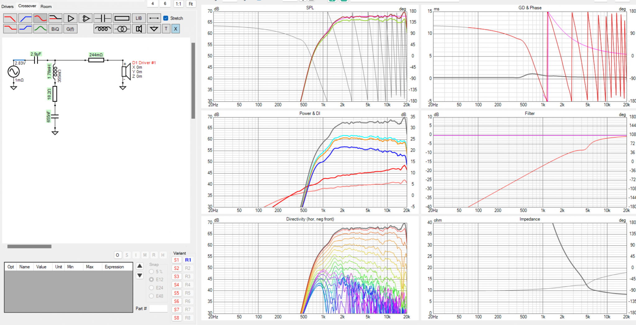

No, in a way that doesn't make much sense... however there is an optimiser which allows you to specify a target and it will try to get there.Is there an active to passive filter translator in Vituix
The problem with an optimiser is you need to know the type of circuit to use or it will not fit. Therefore an optimiser works best when you already don't need one.
For those interested, here is an easy tutorial on how a response shape is created from the circuit type used - https://www.diyaudio.com/community/...overs-without-measurement.189847/post-6910468
There is this that you can try to at least get you in the ballpark but be cautious that it might give you some things that aren't ideal from a practical perspective even though the response looks good.

Just as an example with Vineeth's data it doesn't take that much to get a good response to match an LR4 at 1200Hz. There is no impedance data so it is not reliable but as a basic example I think it illustrates the point.

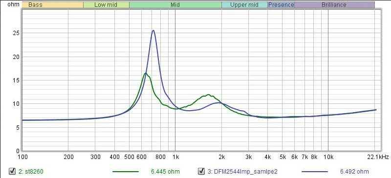

Just in case the impedance data is helpful, Here is a comparison between the impedance of the compression driver as it is and with the ST260KVAR horn attached to it 🙂
Blue is impedance of the CD
Green is impedance after attaching it to horn (in its current form bare printed in PLA form. Some postprocessing work on the horn itself is pending like sealing minute gaps after glueing etc)

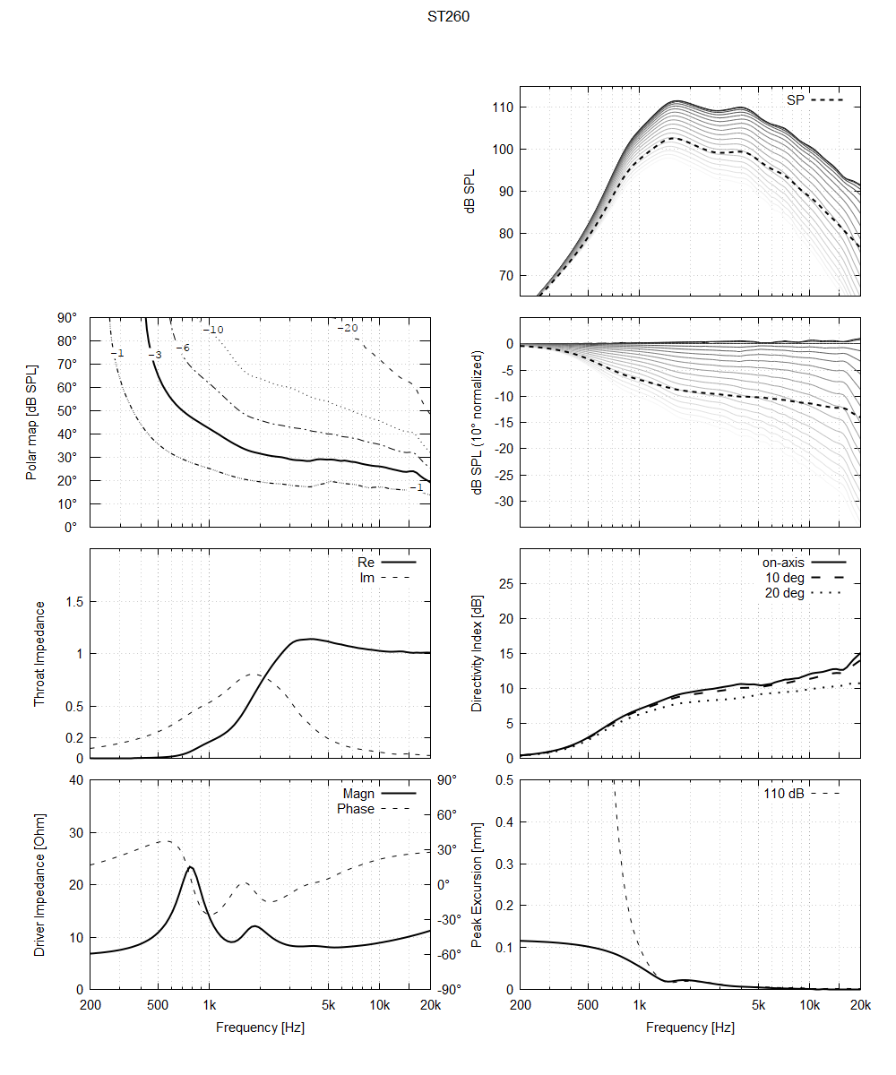

There are three DI curves calculated at different angles. The 20 deg ones are very similar in both, the ST260 has all three DI graphs being very similar the ST280E has the curves diverging at HF. You can see in the normalized graphs that the zero degree and near axis curves are trending up over flat in the ST280. So if you flatten the 280 at 20 deg the 0 deg angle will be bright.Thanks also for the ST280E thougth. I just looked the fact it seems to have a better lower constant directivity behavior but missunderstanding what fluid told about more beamier VS the ST260 and how it translates at listening spot.
If you set the speakers up with high toe in so the 20 degree axis points at the listening position, (with the ST280 tuned as in the graph) some of the sound sent to other angles will be brighter. I find this to sound a bit odd when the reflections can be brighter than the listening axis, but having said that it is only a dB or two at quite high frequency so it may not be a problem in this situation.
It is just a generic representation of a compression driver, I wouldn't try and draw too many conclusions from that aspect.About Marcel sims, I do not know what 1" driver is used for the exursion sims. I assume it is the same diag.
