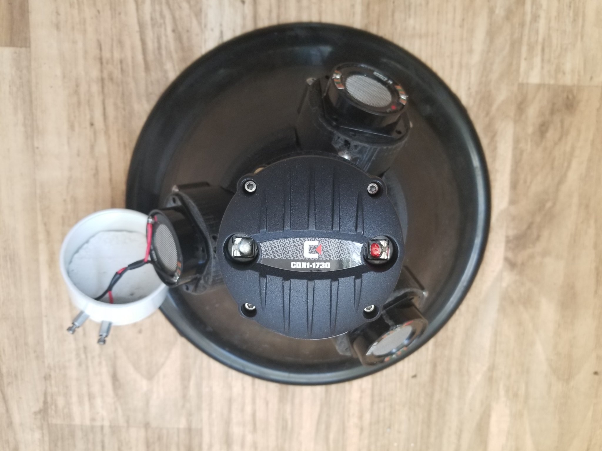

ah...this cdx-1-1730 is one of the 1" that goes low...900 hz w/o problem for domestic use. And less disto and IMD than a B&C DE250.

Hi diyiggy,
Before my REW decided to quit recognizing UMIK-I, I made some measurements, which indicated that on the pictured wave-guide the driver could arguably support about 900Hz cross-over. However, please note that several people recommended a cross over at quite higher frequencies - 1500Hz to 1800Hz - based on their assessment that "it sounded the best there".

I do not think that the frequencies I identified are "natural cut-off", and as you are probably aware, many people cross-over about 900Hz the (correctly selected) 1 inch drivers.Yes, I realise that is my folly wanting to cross a 1" below the natural cut-off you're talking about.
I have difficulty to decipher the "those horns are a little to straigth expansion and edy at the mouth", but I would encourage you to listen to one if you could before you make a final decision.That said the MEH is certainly a solution, but those horns are a little to straigth expansion and edy at the mouth... trade off, trade off !
