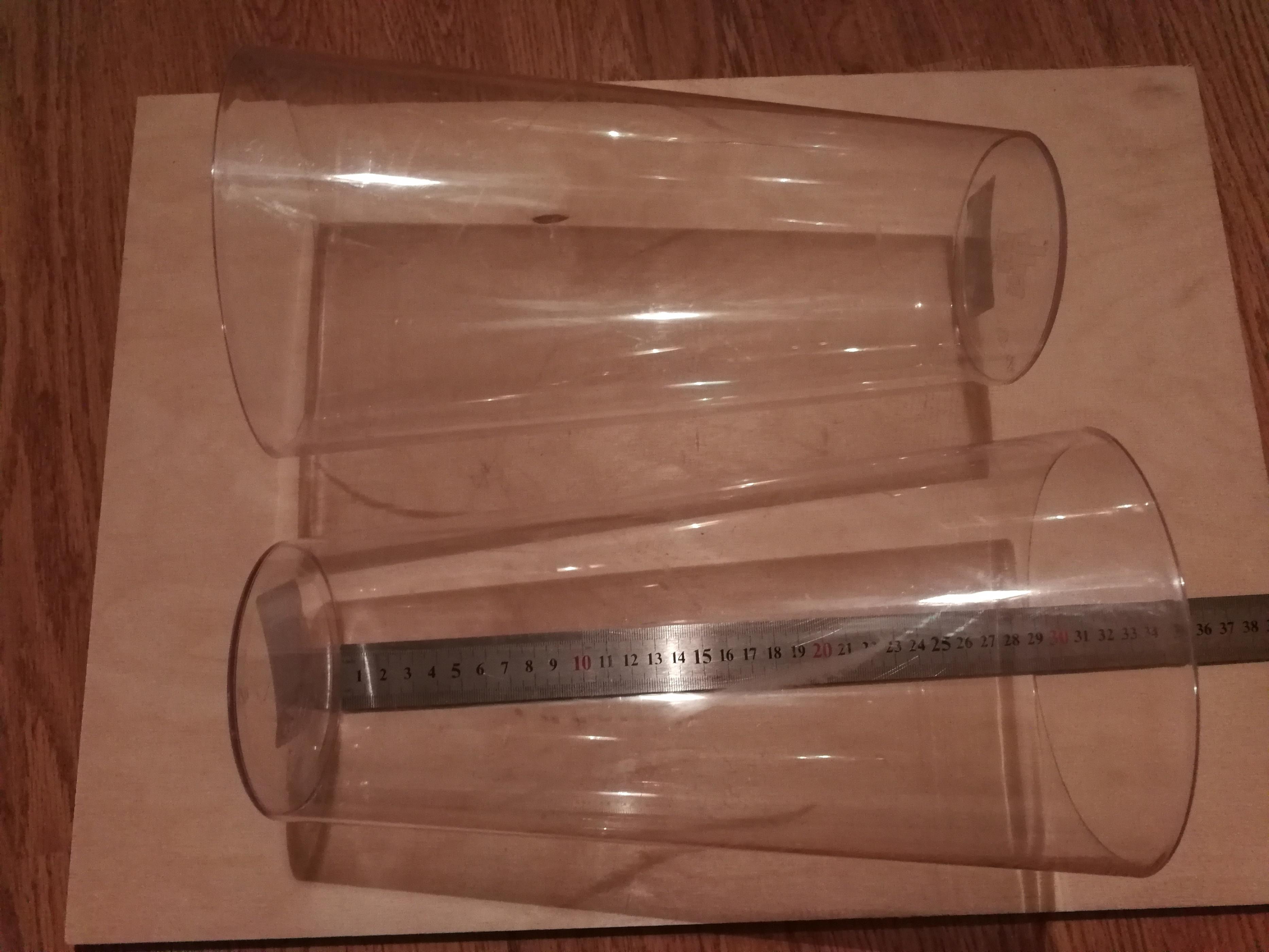

What do you guys think of this for a midcone? Found them in the flowerpot section, ideal dimensions and seem to be quite sturdy. Walls are approx. 3.5mm thick
That can work, I would add a thick disc of 1/2in felt at the flat end or use melamine reticulated foam cleaner pads. Ideally it should come to a point but this can work. Don't forget to line the first 2-3in of the mouth with felt or foam. Making a 3 or 5 sided Dagger out of whatever material is also very easy and gives the best result as it avoids the round resonance mode of the cylinder.
