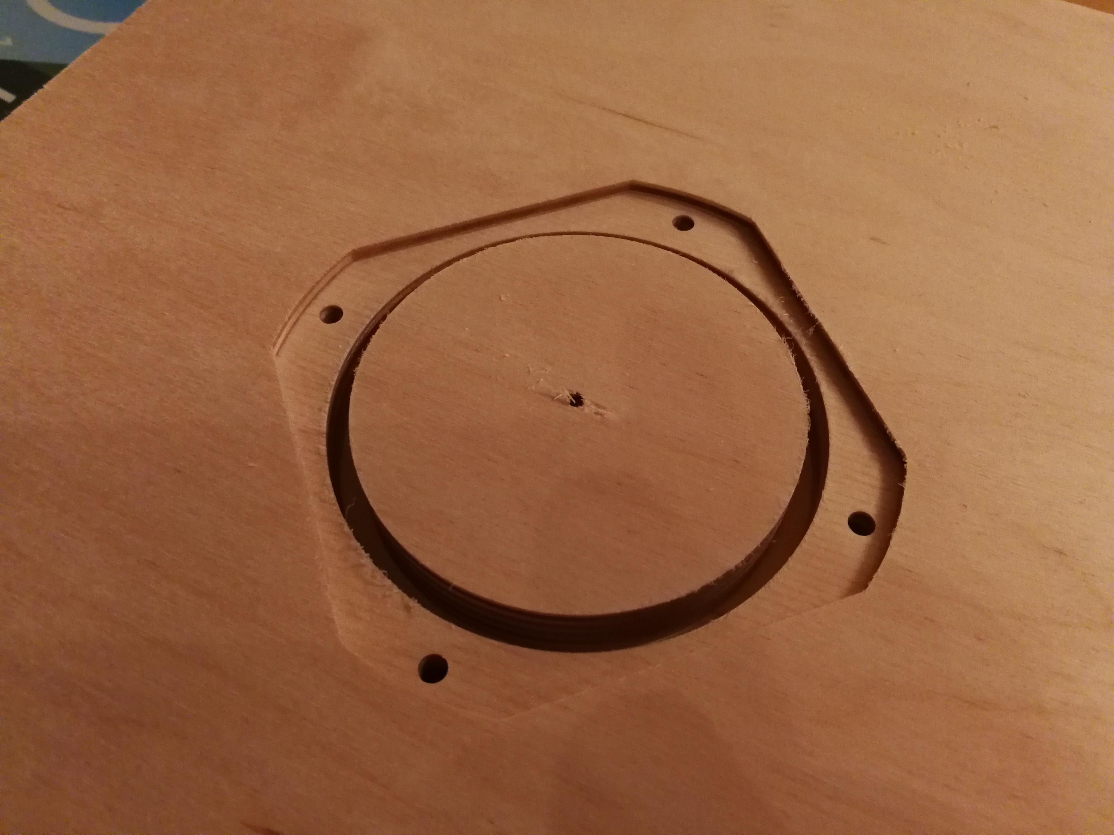

Good luck with your build but beware that the passive XO for the SB23 has not been sorted out yet from my standpoint. I actually have a pair and a baffle with a cutout for them but no time to install measure and test.
Hehe no I'm not interested in passive solutions, going to finally put my DCX2496 to some good use
Absolutely, all the slopes one could wish for, as well as EQ bands, shelves and delays. The only thing it doesn't support is LT or other custom biquad filters like minidsp but I can live without that. Oh and linear phase filters but that's not my cup of tea either

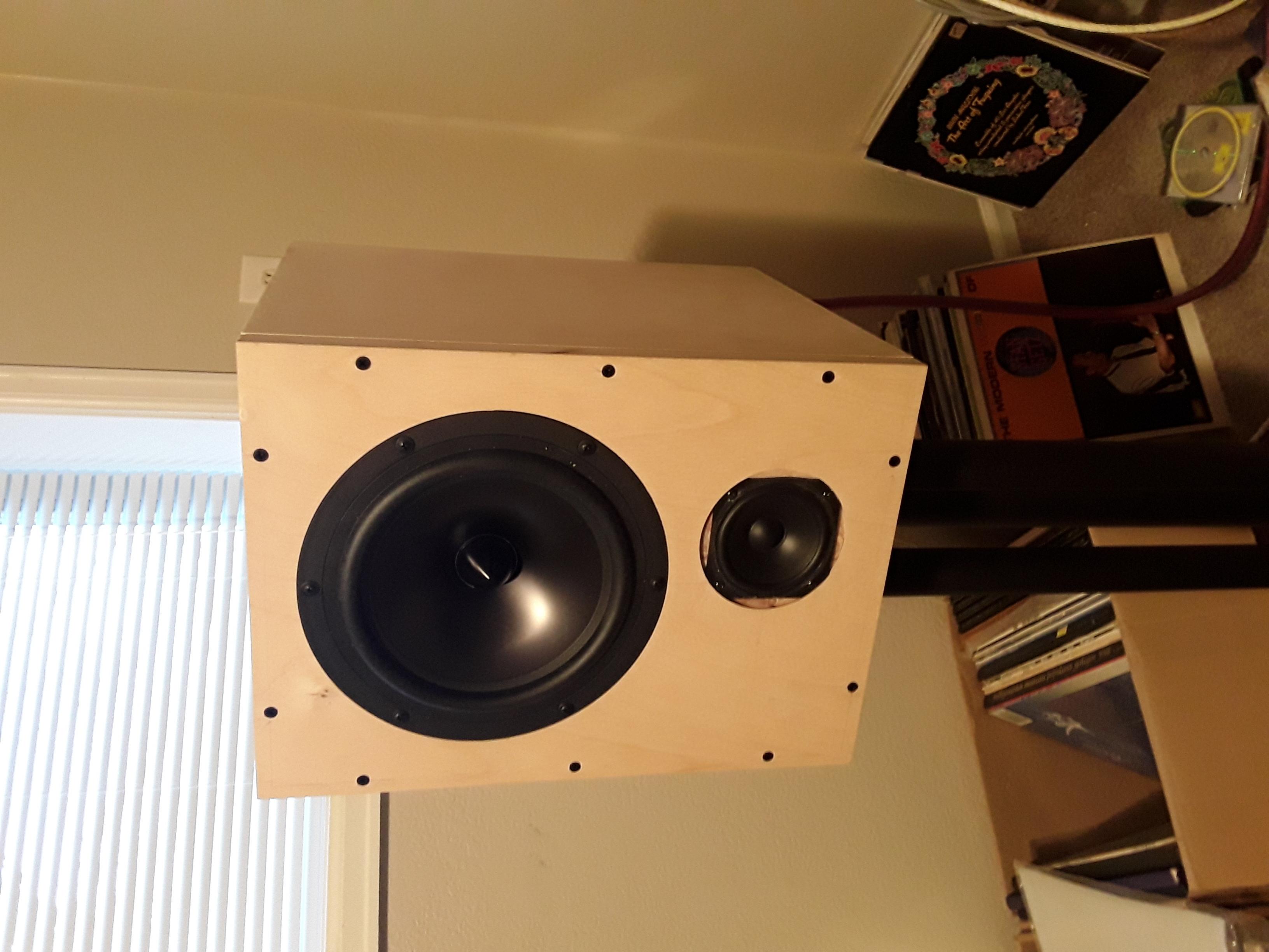

New Build
My shorty-box passive FAST speakers are up and running. Kind of funny looking. No damping or absorptive materials installed yet, so sonic impressions are a little early. Widerange drivers are TC9FD, fitted into recess for a 10f/xxxx.
(yes, image is sideways even after rotating and re-inserting, several times)
Ended up using plastic cones for the daggers for the speed and ease compared to constructing 3, 4, or 5-sided pyramids, Inside is the requisite stuffing and felt surround.
Boxes are 18mm BB, cut by a local wood and woodworking supply. Not great cutting, lots of tearout, and of course my dimensions were a bit strange.
Padding resistance is 2 paralleled 4.7Ohm resistors, and so far that seems about right for the TC9FD. Considering going to 10f/8414 eventually.
I'm hearing several impressive aspects so far - a notably neutral response, very nice persussion, low distortion, and an overall refined sound. One of my favorite loud rock tests is Dire Straits' "Ride Across the River." Good dynamics, clarity, and low distortion. Fun! Efficiency is very low, not too surprisingly.
Question for X: did you compare before and after cabinet treatment? I'll probably use Noico pads as you did, then acoustic foam in 2 or 3 phases.
