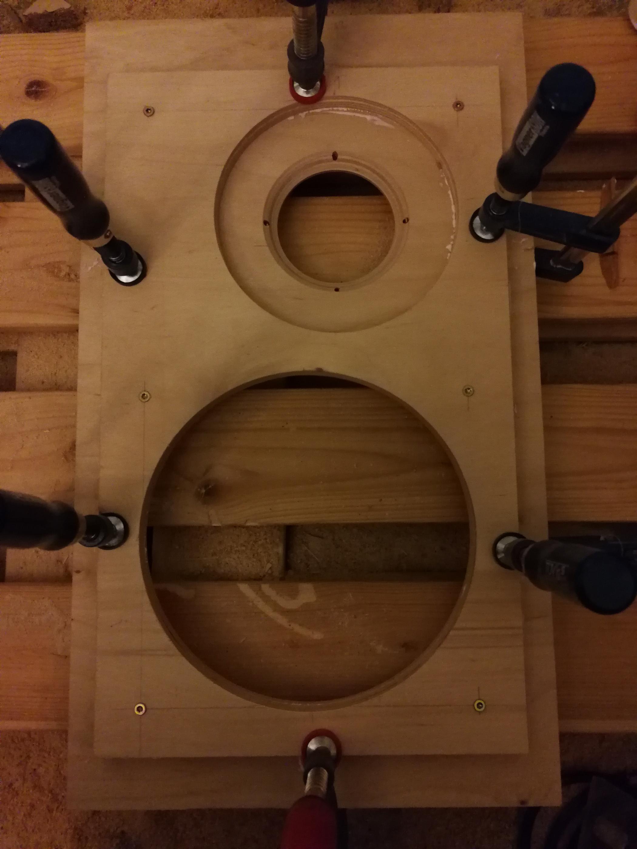

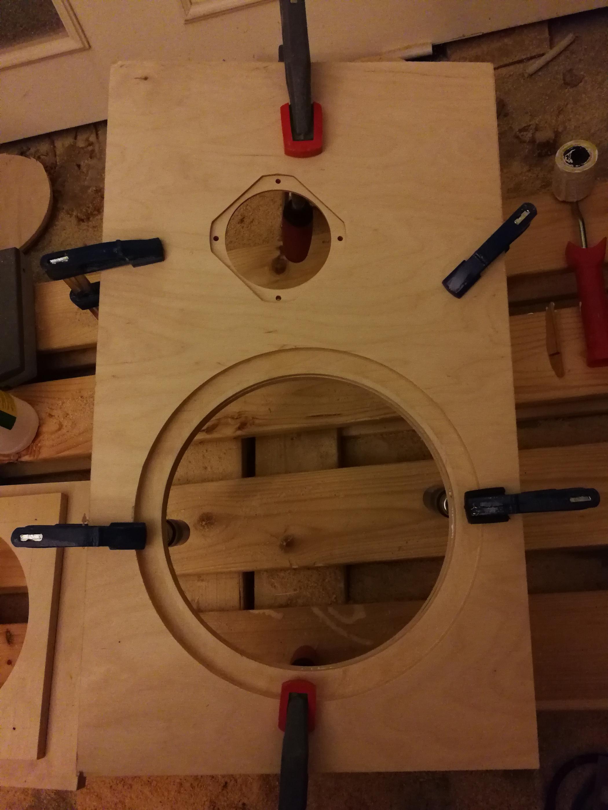

Nice backside chamfer for the driver to breathe. How did you make the perfect TC9 rebate?
Thanks! This thing is coming together nicely. The rebate was done on a cnc, I posted a closeup a few posts back. In retrospective I should have done the woofer contouring too but oh well, live and learn. By the way, what would you suggest for a finish? I'm leaning towards nitro lacquer as it dries fast and hard and doesn't change the colour of birch.
