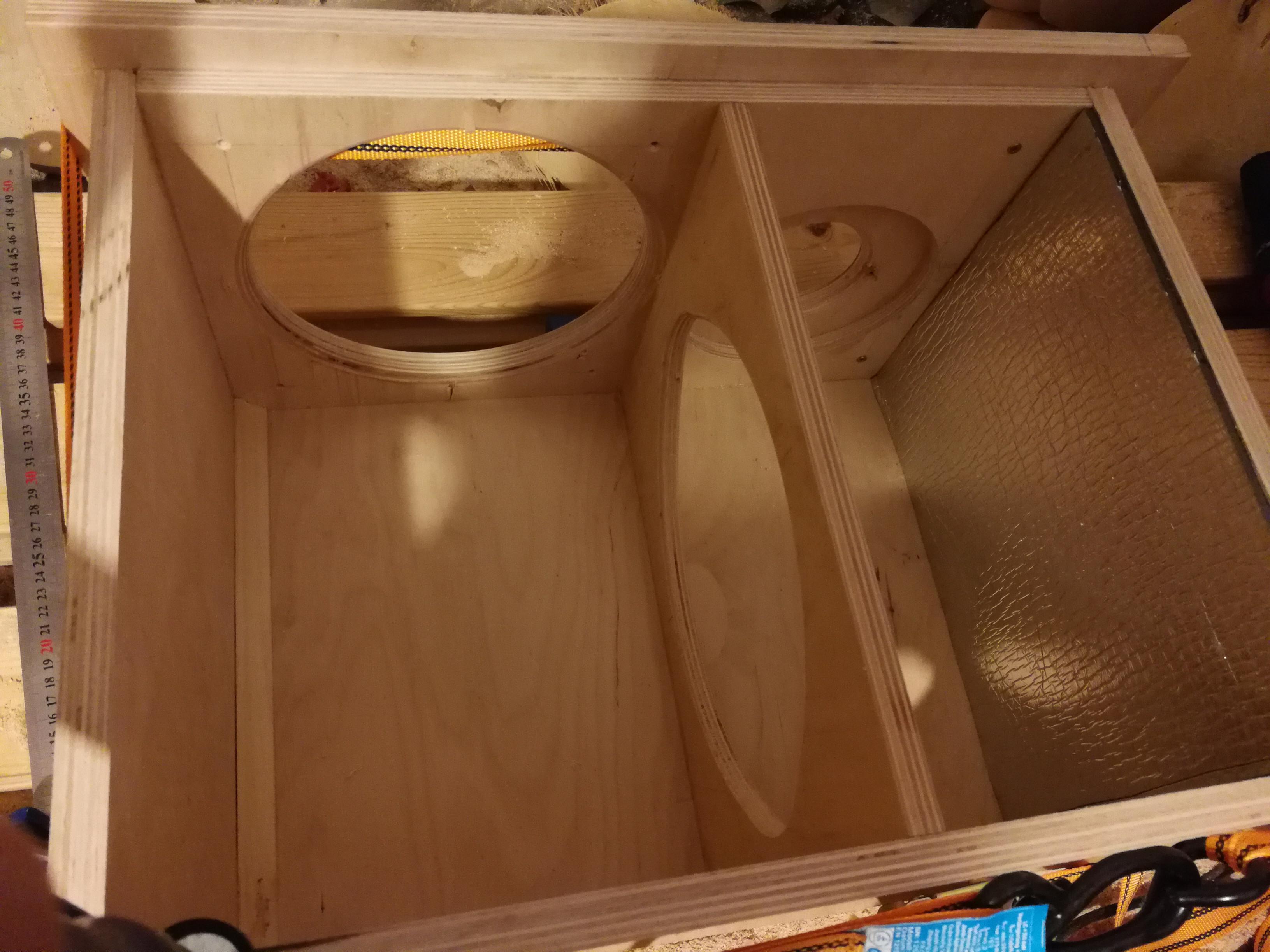

Nice work, Sadik. It would have been better to go with odd number of walls to reduce symmetric bell mode - but that’s ok as round cone seems to work too. Dagger should be sealed at end to prevent woofer from pressurizing it. Although if you tapered it and vented to outside via penetration on back wall, that would work too. I found no advantage to this though when Dagger was outside. I tried vented actually.
Everything will be as per the design, thanks to Mr. XRK for sharing the same. The dagger will be closed at the conical end. the total length of dagger is 300 mm.
does the venting out of tapered end means the enclosure becomes aperiodic?
Then it should help with flattening the impedence but again the driver is operated well away from impedence peak.
Slowly but surely the boxes are coming together. Had a few problems with dimensional accuracy of my cuts. Turns out 0.5mm is not good enough for really nice joints. Another lesson learned - do driver mounting holes before routing rebates and chamfers
Sadik if the dagger is 300 mm then the foam thickness is 13 mm, correct?
Which Foam? The dagger is made from 8mm thick MDF sheet.
sorry from the pinkish color (at least on my old monitor) i thought the material was an xps foam!
oh, oh, my ocd is kicking in looking at that "last photo" (where's my scotch...) i would have put the unfaced damping on the back of the enclosure.
Nice work Wxn! Don’t forget to add a good ball of fiberglass inside the cabinet. Put some around the crevices around Dagger too. You can of course, add that through driver cutout. I would add a piece of that padding on back wall where terminal cup is. That will ensure that back wave is absorbed substantially. And if you have more, add another on at least 1 sidewall. 3 walls will ensure no resonant modes are supported.
Thanks for the input, yes that's the plan. I will add some more layers of absorbing stuff through the hole and then a healthy amount of loose stuffing. I also have a large sheet of 1cm thick felt, not sure if I need to add any of that. We'll see
