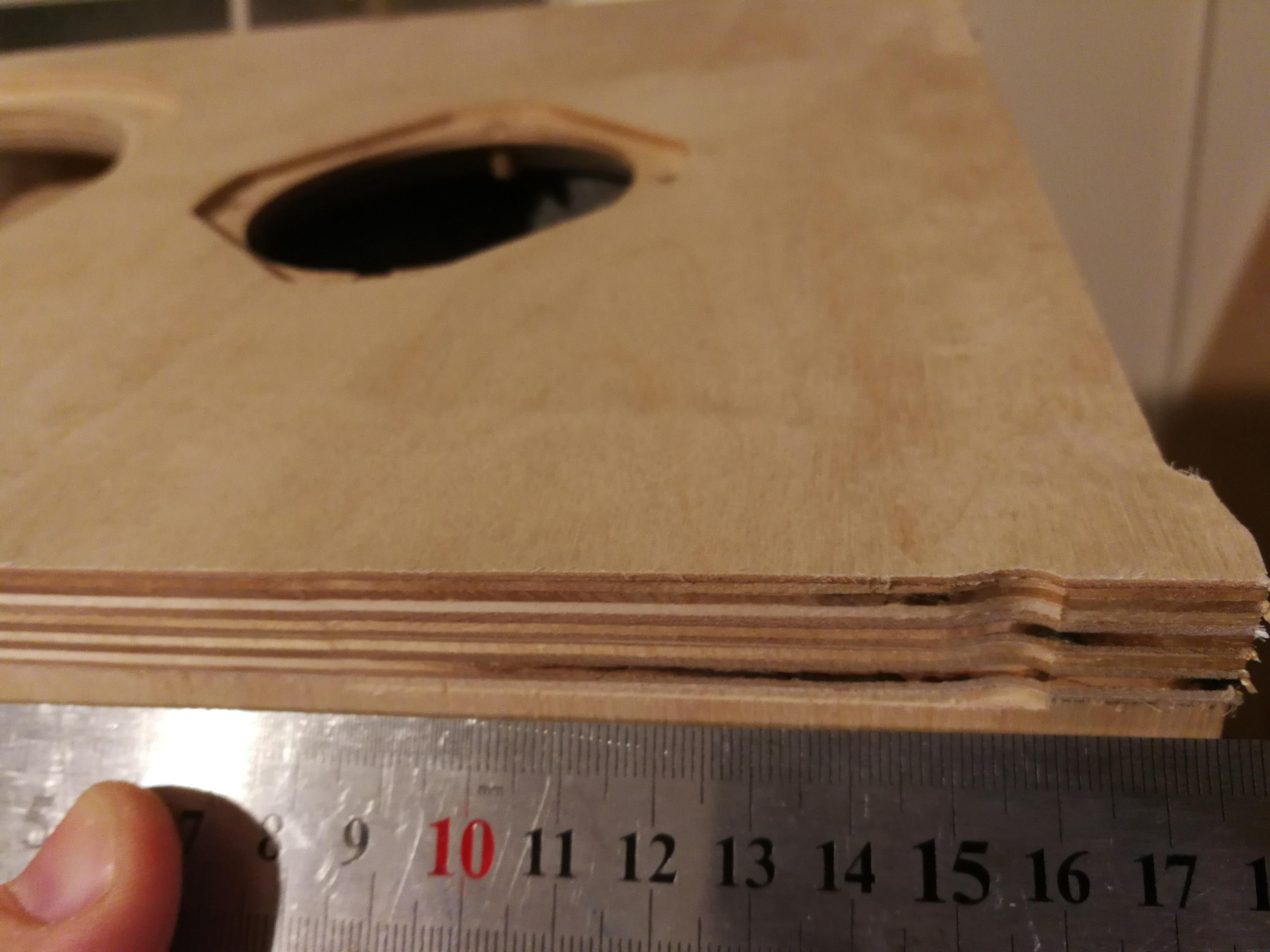

I messed up a little, my flush trim bit disassembled in mid operation and the cutter went into the front baffle before I could react. Now most of the dent will go away with chamfering but there will still be a mark at the bottom. My plan is to use wood putty to fill it up and then paint some ply lines with a pencil. Othet options i thought of are veneering the whole front chamfer or route a groove along the edge and inlay a piece of wood (e.g. Oak).
Would appreciate your thoughts guys
Sorry about the big router bit explosion. If you want natural wood finish either veneer or the oak edge frame. Both are time consuming. But veneer is faster?

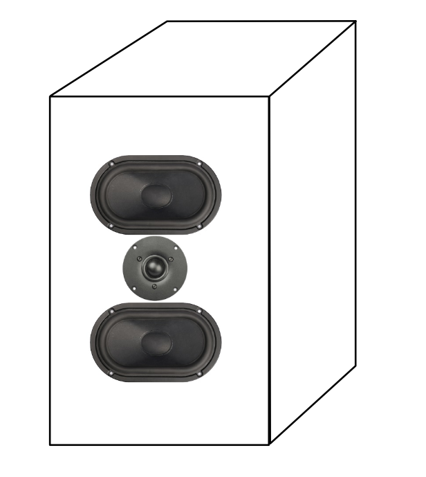

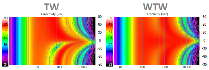

RS225 sealed is about 52Hz/27liters, above sealed is about 52Hz/23liters and because its a 5x8 incher have smoother polars up high to sum with 3 inch polars plus a improved ctc distance, now with improved ctc distance use two per side in WTW config as Dunlavy did and non symetric tilted height polars gets uniform perfect.
perceval, agree we are not used to see that 5x8 incher look but using WTW config combined 1st order slope in spirit of Dunlavy improves the weird tilted non symetrical vertical height polars that happen using odd order slopes and seen into below dirty quick simulation example, also effective woofer piston area increase to 356 sq/cm and imagine it should help on low end distortion numbers. About a fun mid tweeter from SBA look at their relative cheap SB65WBAC25-4 : )
That does look interesting !
So, maybe weird is a good thing! 🙂
