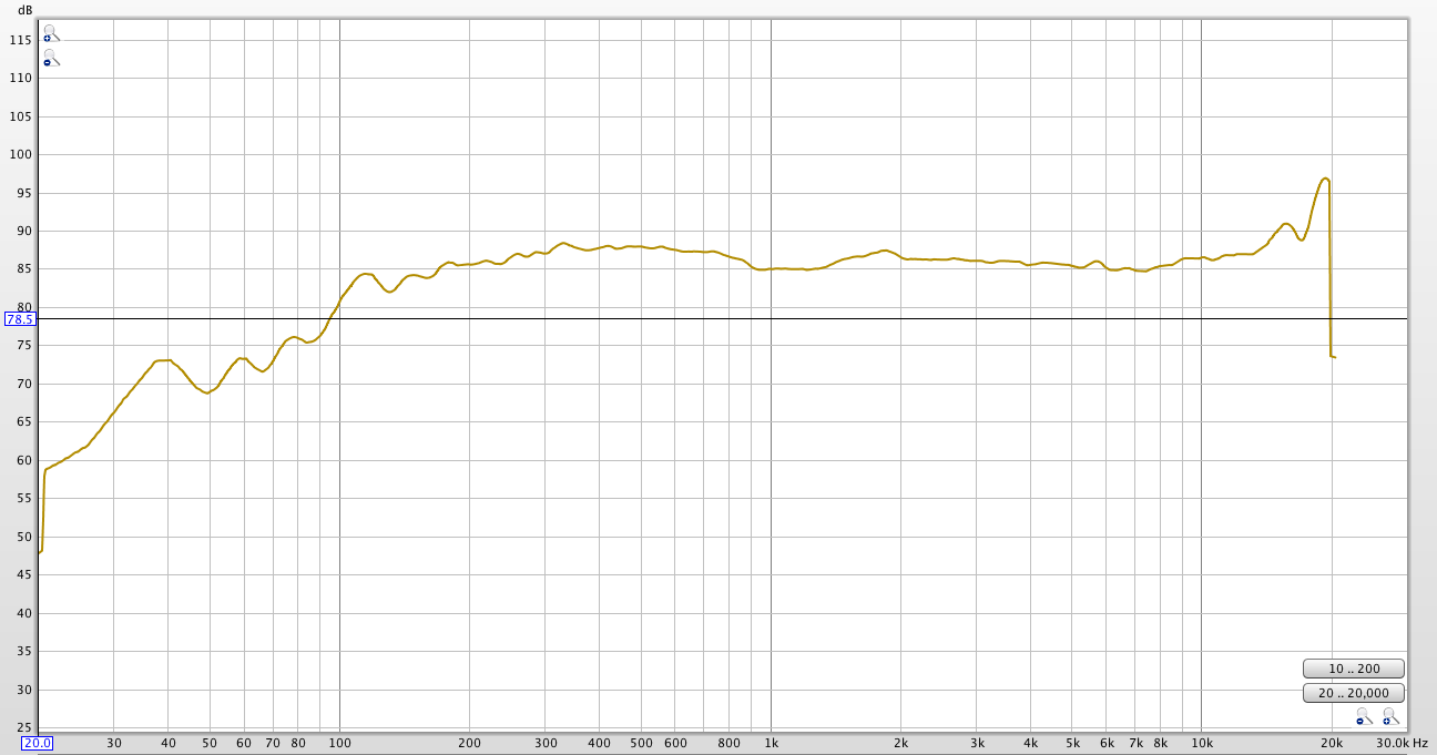

I quickly played around importing frd and zma files into REW, moved the 2.5" midtweet over the side of the baffle, and the baffle step filled in the slight broad dip in the middle.
Added that in REW, and it looked nice enough.

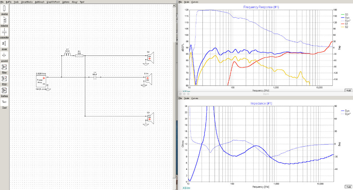

Then, in XSim, I added the two woofers and a simple 1st order XO. It gave a sharp peak at 110Hz on the small midtweet which didn't look good, but, inverting drivers replaces the overall FR, but losing the linear phase...

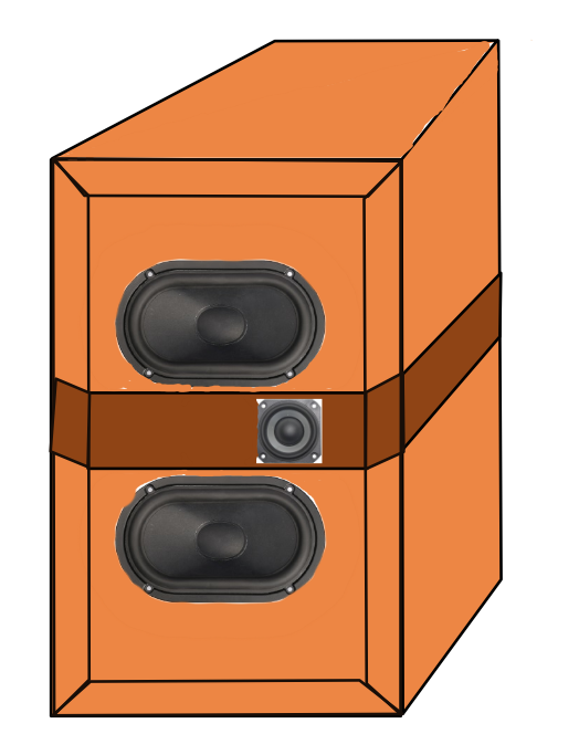

It's as simple as it can be. I do believe there's potential.
I think I can improve things a bit by adding a Zobel or two.
Also wondering if the woofers should be in separate sections, or share a common volume.
Still twisting my brain trying to come up with a more elegant solution for the oval woofers... Just looks plain strange to me... but then again, maybe strange is good.

Hmmm... Continue the Dunlavy path by surface mounting & adding felt?But, with the oval woofers, and the square mid tweet, I can predict nightmares just thinking of routing them in....

I'd say equipping this concept with a passive radiator (or a port for that matter) would rob it of it's Dunlavy spirit.Oh-oh! My next project looks already in concept phase.
There's also a matching passive radiator for the "racetrack" 5x8 driver, just add to the mix. Could make it better to mate a single SB15SFCR39 to an 8Ohm mid-tweet.
If you can tolerate speaker grills that would be a simple solution.
I usually don't, but in this case, it might be the easiest solution. Thanks!
I did think about that. Make a wider rebate and fill it with foam or felt... easier to cut to the size of the SB 2.5".
Using only one woofer, you'll have to pad down the mid tweet, lowering efficiency. And mostly, losing the wonderful radiation pattern Byrtt showed us earlier.
Learning more about XOs and trying to apply it.
Now, this one has a lot more parts in it, but impedance and especially phase are nicely controlled.
The resulting FR is quite pretty as well.
My best take on an XO so far, I think. Won't be cheap, though!
Nice work Perceval. Your complexity is not bad. Price should be reasonable with values you have. On large caps you can save by using non polar electrolytic and bypass with a small value film cap. For example a 50uF NP and 10uF film can work and save a bundle. Sounds quite good too. Coils for woofer can also be ferrite core and save some there as well.

So, a Dunlavy kinda setup, using SBA drivers with two 5x8" SB15SFCR39-8 and a SB65WBAC25-4 2.5" in the middle. C-to-C distance is really low, but it does look kind of funky, so a grill might make it more pleasing visually.
I'm wondering if the woofers should have their own space, or share a single volume.
It's the WMW that Byrtt hinted on, showing really good dispersion.
Same volume is actually best as they are acting in unison and any minor differences between woofers will average out better - plus less complex to make. The tweeter will require a setback or some sort of waveguide, What is the distance you are using to get the phase alignment? Circa 3in? So the baffle will have a step or a waveguide which will increas CTC distance.
You can estimate the acoustic center (AC) by about where the voice coils are. But that’s good there was no additional delay required. This is why sometimes coaxials that have the tweeter as a CD driving through a hole in the voice coil of the woofer automatically have better time alignment. I would guess maybe only 1in or at most 2in is needed then. A lot less drastic than 3in.
I was surprised by how affordable the racetrack woofer is from Madisound is $42ea. My concern is that the 84dB SB65 may not be able to keep up with the two woofers. In parallel as 4ohm load, they have about 92dB sensitivity at 2.83v. If we account for a circa 5dB baffle step loss, that’s 87dB at 2.83v. That would match an 87dB 10F or a B80 much more. But then you don’t get the nice aluminum dome tweeter like top end of the SB65. Maybe a waveguide can buy +3dB and get the needed 2-3in setback?
