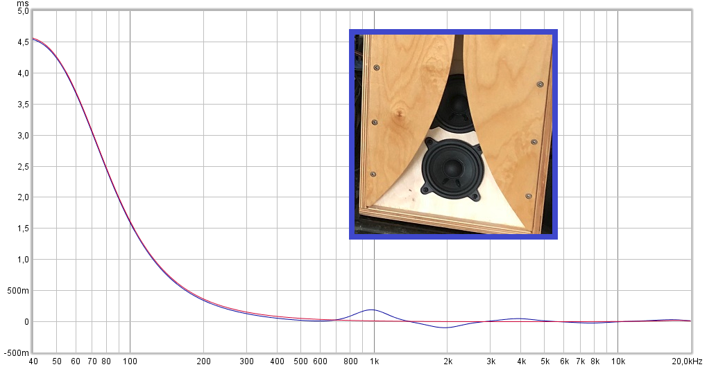

If on subjective front is happy as is maybe let it be 🙂 on objective front will imagine there is more to sensed psycho acoustics than ampltude curves from manufactor datasheets on its own, for example when that driver array sit behind such slit can't imagine first wavefront is a super clean replica of a supposed minimum phase domain, probably some difraction and out of time reflected waves is in that first wavefront as simulated below in blue trace verse the red trace which is a correct minimum phase group delay had driver sat in front. Will guess what we hear is in the charts somewhere but hidden deeply so we have to zoom in and trick with filtered windows plus smoothing and look into other charts than the usual frq response.
