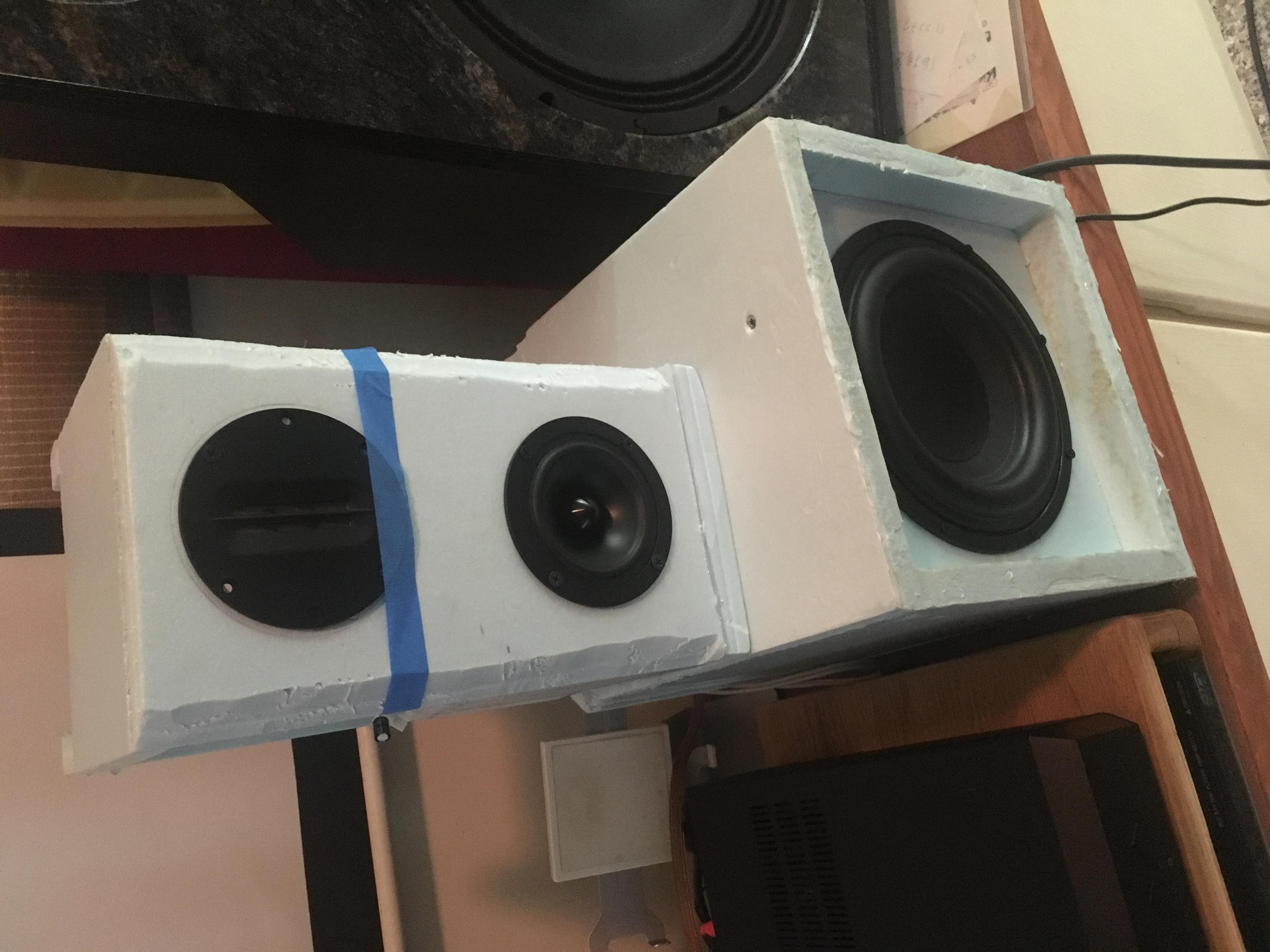

When I was back home last summer, I came across a shop selling electronics, and they had some cheap iron core inductors, so I grabbed a couple of 4.8mH. Over here in Taiwan, I can only get up to 1mH aircore. Recently, I found a place selling enamel wire by the kilogram, so I might try to make my own inductors!
So, picking up the W8-1363sbf, and adding the 4.8mH inductor isn't the prettiest. I think it would work better with a 3mH, for a more natural curve because the W8 starts falling off at 100Hz. The 4.8mH makes it even worse.
Moving on to the mid range. I had the Nola Brio clones with TC9s. I tried to see if using B80s instead of the TC9s would improve the sound. Not so much. The dual B80s in a Brio has a wide bump in the mid range, and it would need a pretty broad notch to sound good. So, I set them aside. Also, the volume for the B80s in a Brio is too small at about 2.7 litres, and it starts falling at 200Hz.
Since I got a pair of ribbons last month, I swapped the top B80 for the ribbon, added a 2.2uF cap, and a 10 Ohms resistor to pad it down. Made a REW sweep, and found some magic!
So, as it stands now, it is the W8 with a 4.8mH, the Visaton in a too small enclosure falling naturally at 200Hz, and running wide open on top with only a resistor to pad it down. The ribbon has a 2.2uF cap and a resistor.

Hi Perceval,
You can always unroll some turns and measure the inductance with an LCR (or DATS). A coil that is too big is not a problem, in general.
Your box looks great - that XPS is working some magic. A good trick is to take a thin layer of foam core and cut a hole in it to match the outer bezel of the mid and tweeter and make them flush mount. You will reduce your baffle diffraction ripple by -3dB to -6dB sometimes. It is audible and sounds smoother.
I would not take the B80 below 250Hz, if you can push your woofer up a bit that would be much better. Unwind that inductor! The B80 distortion really starts climbing below 300Hz.
Rounding the XPS edges is a good idea to reduce diffraction. Your tweeter maybe could use some setback behind the mid - although your step response shows it to be well aligned.
This looks really nice and I can imagine the sound you are getting.
X

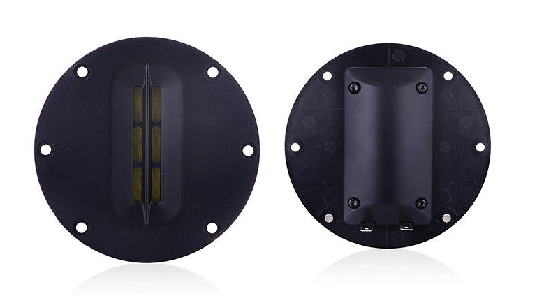

Hi Perceval,
Thanks for sharing the pic. I am not sure, but that driver looks more like a planar magnetic tweeter.
Those look like AMT type tweeters and not ribbons. AMTs sound very good actually. My best tweeters are Heil AMTs. they sound so natural.
Another similar alternative on Ali for $30/pair are 94dB and XO at 3.5kHz. Also no-name.
Sounderlink 2PCS/LOT Hi Fi Planar audio speaker unit AMT ribbon tweeter-in Speaker Accessories from Consumer Electronics on Aliexpress.com | Alibaba Group

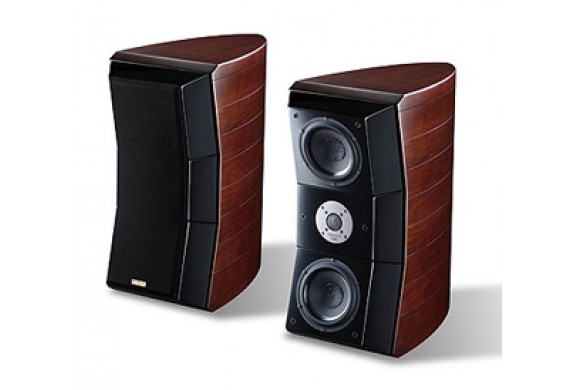

Hey X,
Have you thought about making a MTM version of this?
Reason is, I'm enamoured by the Usher CP-777, and it could emulate this using your version of it.
So, the 10f (or equivalent) sandwiched between two 8" RS225 ( or equivalent).
That could have some punch!
In an MTM, the 10F or tweeter will need to be recessed in a 3in deep waveguide as you can’t just put it underneath anymore to get the time alignment. But with miniDSP it would work very well. It would get +6dB more sensitivity which would bring it to 88.4dB at 2.83v overall. It would sound quite nice.
Even better would be to make the Bushmeister style point source horn with dual 8in woofer and the 10F/8424 as full range with 600Hz XO. The waveguide would be one of those huge 2.5in throat JBL cast aluminum ones. It would sound fantastic. Perhaps the SB23NRX45-8 as woofers.
At first, I liked the air that they brought to the system, but after more listening sessions, they are starting to annoy me with some sibilance. I'll try to EQ out a bit between 5-8kHz, see if that helps.
I'm not a huge fan of the "horn" sound. Completely the opposite, I prefer OBs.
But, I agree that a dual 8s with a FR on the horn would probably be good... just not the sound I'm looking for.

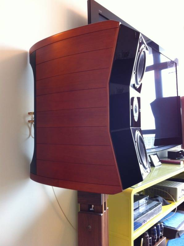

Hmmm... I don't think the tweeters are 3" back in there.
