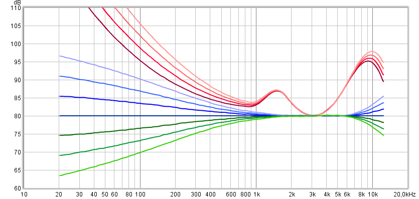

Thinking over situation a bit more maybe below point can be reason why that new OB setup sounded superior one day for later on they are starting to annoy you with some sibilance and you'll try to EQ out a bit between 5-8kHz.
Say the good or perfect sounding day you where listening to system at a perfect SPL relative to equal loudness curve study ISO226-2003, in below illustrated by the dark red 80 phons trace and your system plus room is now illustrated by the perfect flat dark blue trace at 80dB line, now as the red curves go brighter in color means lower steps of -10dB SPL per trace so into red curves section we look at the 80/70/60/50 phons curves and the 70/60/50 differences or needed EQ correction relative to 80 phons is the brighter blue ones relative to the perfect dark blue. Now lets say after that perfect sounding day you start listening -10/-20/-30dB lower that the perfect flat dark blue trace and what you listening at is the three green curves showing they overshoot pretty much into 1-7kHz area, those green traces are simply the error or reverse of the blue ones that are needed for our hearing threshold to hear the same, and what for example JRiver can correct for if its SPL calibrated and feature turned on.

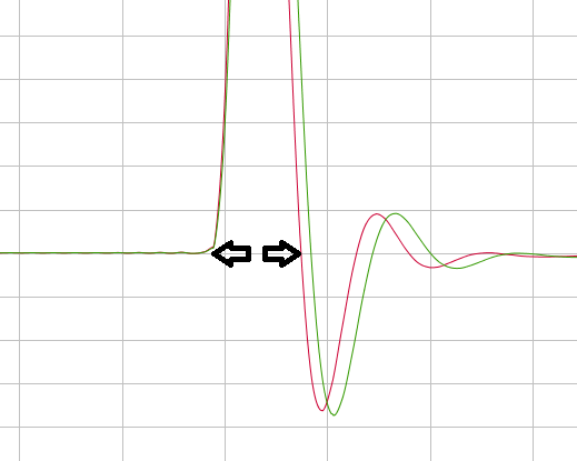

About timing it can be most don't care and do anything about it but in reality change a little bit on slope be it passive or active correction and timing needs attention once again.

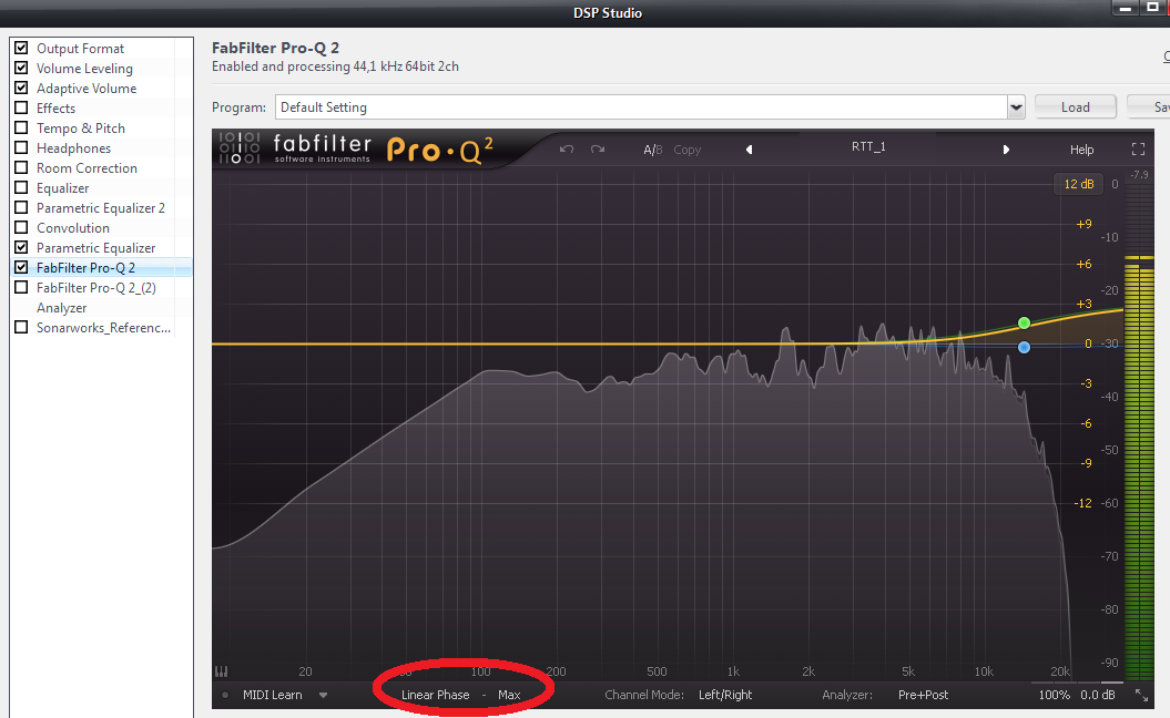

Byrtt, I think we have our posts mixing up..
The OB setup does not have sibilance, it was the planar tweeter that annoyed me a little.
But you are right, if I set the EQ to make the W8 flat, it does become a little dull and lacks sparkle... now, I am not a fan of "bright" sound that shouts like so many call "detail" in the "audiophile" world (wow, that's a lot of quotation marks!)... but I do enjoy a bit of clarity to the sound, and your post demonstrate what happening in the room. Thanks.
I did have a chance to try the Linear at Max filter, and it makes the music sound fuller a little. It was pleasing, but the latency at Max setting destroyed the sync I have with my sub. So, if I listen to 2 channel only, I'll have it set to Max, but if I want the sub, I'll have to revert to a less latency setting.

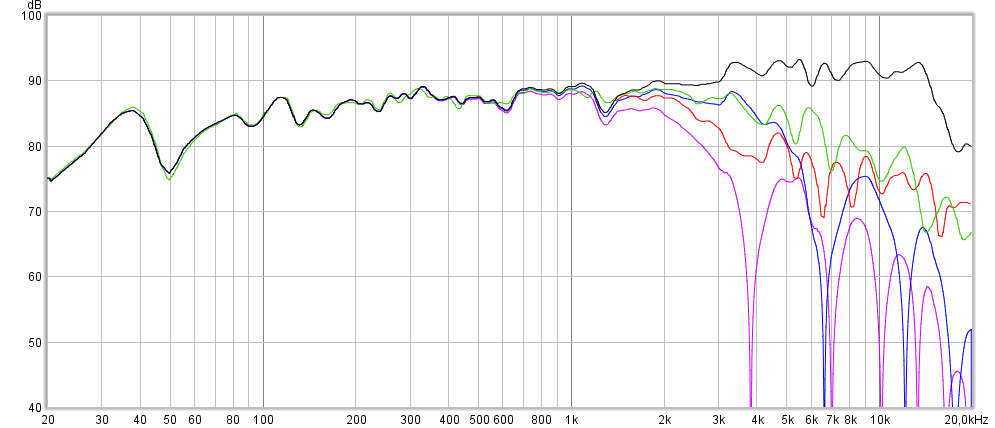

Here's the FR and impulse at the listening position... No EQ, no DRC... just results out of the simple XO. The 50-ish dip is a room node. I can't move the speakers around due to several constraints. 🙁 and I think I need some toe in as the B80s fall off quite fast at 11kHz.

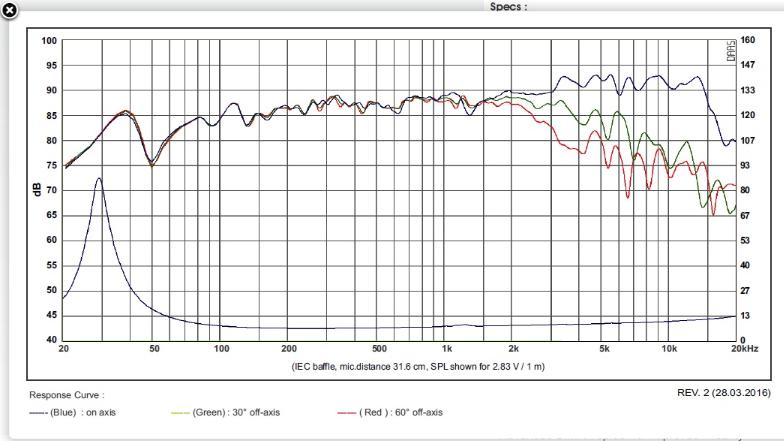

You right on paper those graphs from their top series looks over avarage surprising good for full range use, whether its real world reality or caused by smoothing of graphs is not to know before someone try it out, think not its physical possible that so big a diameter piston perform so good but who know if for example their dustcap is kind of decoupled and stand for that good looking patterns, again someone will have to buy one driver and test it real world. Name convention at SBA look that MW stands for mid woofer so mw16p it not a mid range category but a mid woofer, in past had same focus as you for full range use on their SATORI mid range driver MR16PNW-8 which is nearly same look and build as the models you point at except its a mid range category and cone is white color, first graph below is a homemade trace of the factory curves for that mid range and second graph is how it theoretical would look if on axis is EQed flat.

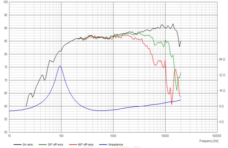

Member «Gornir» did some measurements a while back, for anterior model revisions (latest i found was 2017 revision).
In any case, they LOOK «ok» within 45 degrees listening position. Beyond that, dips start to appear. But dips are less annoying than peaks, in my opinion, and it still extends to or near 20khz, contrary to the discovery,on paper. Also, i listen(end) to headphones with worse overall response than these which strenghts nevertheless made up for the downsides. In any case, i believe the particularity of the design, what makes it unique is not using a midrange/midwoofer to replace a tweeter, but to make it less necessary, and ending up with a sort of «super composite fullrange» speaker. But the strong point of the discovery midrange is that it also behaves like a good tweeter it seems, additionally!

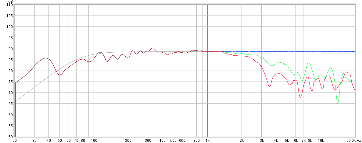

For our eyes probably scaling ratios means alot so as a experiment traced their curves so as to compare closer into same ratio and at same added the theoretical diameter curves for off axis 30º and 60º for a pure piston diameter 68mm and 126mm.

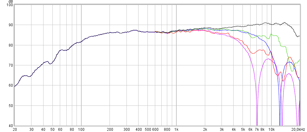

If you look at the graph of the TC9FD and its cousins TG9/10F/etc they all fall off around 18kHz. The response curve for the 3FE25-8 actually goes past 20kHz. Where this helps is in the attack and transients rather than actually hearing notes above 20kHz. It does sound like it goes higher though.

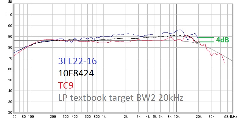

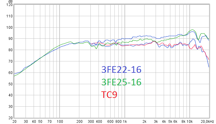

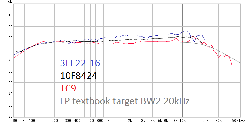

Hi X can you take a new look at case or comment because cant ignore there looks to be something is off into this public statements translate how real objective data is interpreted to subjective statements, know below 3FE22-16 is not 100% exactly same as 3FE25-8 but it has nearly a same response into public factory datasheet as 3FE25-8 also cone/frame/dustcap/surround have semilarity.
Now at Faital Pro graph ratios we add 10F factory graph and also take TC9 verse 3FE22-16 from over at comparison thread offset below, these diameters is all into break up area and fall off but how is Faital stated to go past 20kHz if TC9 plus 10F is not.
At these ratios lets add a higher reach curve for TC9 from over ZAPP plus a smooth BW2 20kHz textbook target curve, looks its low cost TC9 that is overall winner if we talk smooth and high reach native out of box response.
It should be possible find out what one or another driver has the real world higest response reach even graphs are cut up there because of rate, zoom into small detailed numbers for IR at zero crossing line where the wider it goes there the slower it is relative to the other up higher.

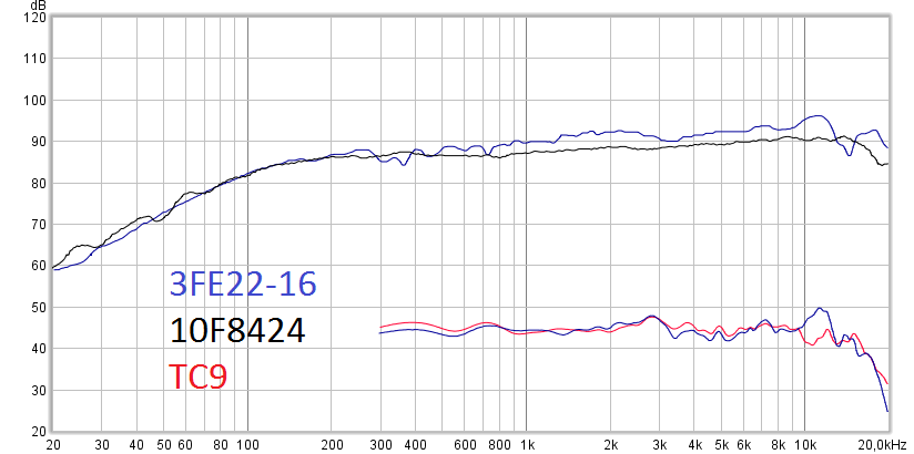

Hi Byrtt,

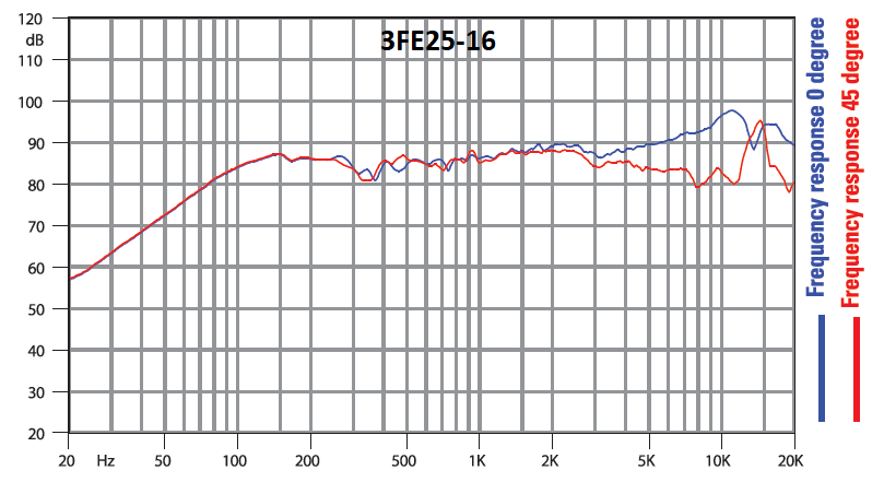

Thanks for showing the detailed comparisons. The Zaph extended data looks great, With you side by side comparisons, maybe the difference is not all that great - and I love the sound of the TC9FD, don't get me wrong as I have been using that from day 1 on 3 dozen projects. If we look at your detailed graphs, we can see that the 3FE22-16 has about 4dB more at 20kHz, and maybe it is also due to its higher sensitivity rated at 90dB at 1w/1m. It sounds qualitatively to have more top end to my ears. Albeit, not as smooth of a performer as the TC9FD overall.
Here is your data (which I think you are using 3FE22-16):
And here is 3FE25-16 (different motor and different T/S parameters with Qts of 0.82 so not really the same driver) - its response at 20kHz is even a bit higher, so maybe even +5dB more at 20kHz?:
But these are all very minor differences. I can say that the 0.53x Karlsonator with dual TC9FD's sounds fantastic, from my memory.

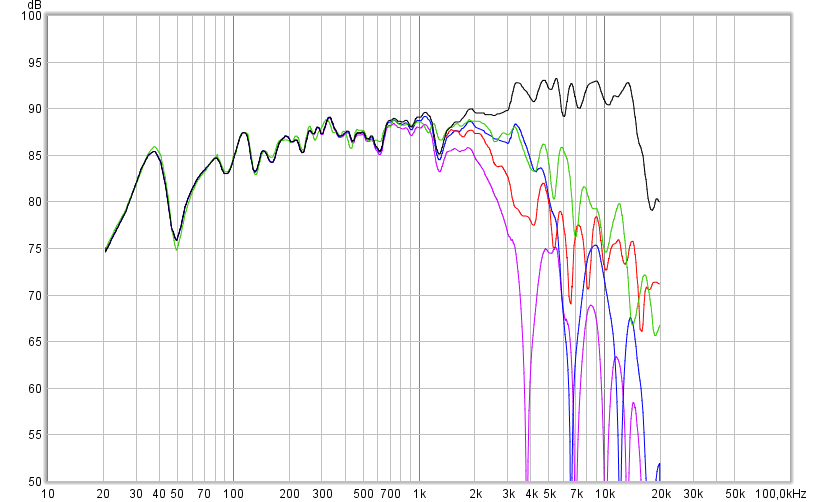

Thanks looking case again, think it points we should conclude if highest reach is supposed help in the attack and transients rather than actually hearing notes above 20kHz it should be heard better in a TC9 domain then, and if Faitals happen is sensed a higher reach it must be either their hotter rising response or peaks as frq goes up, included 3FE25-16 together 3FE22-16 from their datasheets and they close viewed into these ratio of axis numbers, below that look at 3FE22-16 from your own measurement setup from comparison thread where it falls off much steeper than TC9 indicating TC9 is not only the smoothest also its superior in highest reach that we see better into ZAPP graph in previous post.
