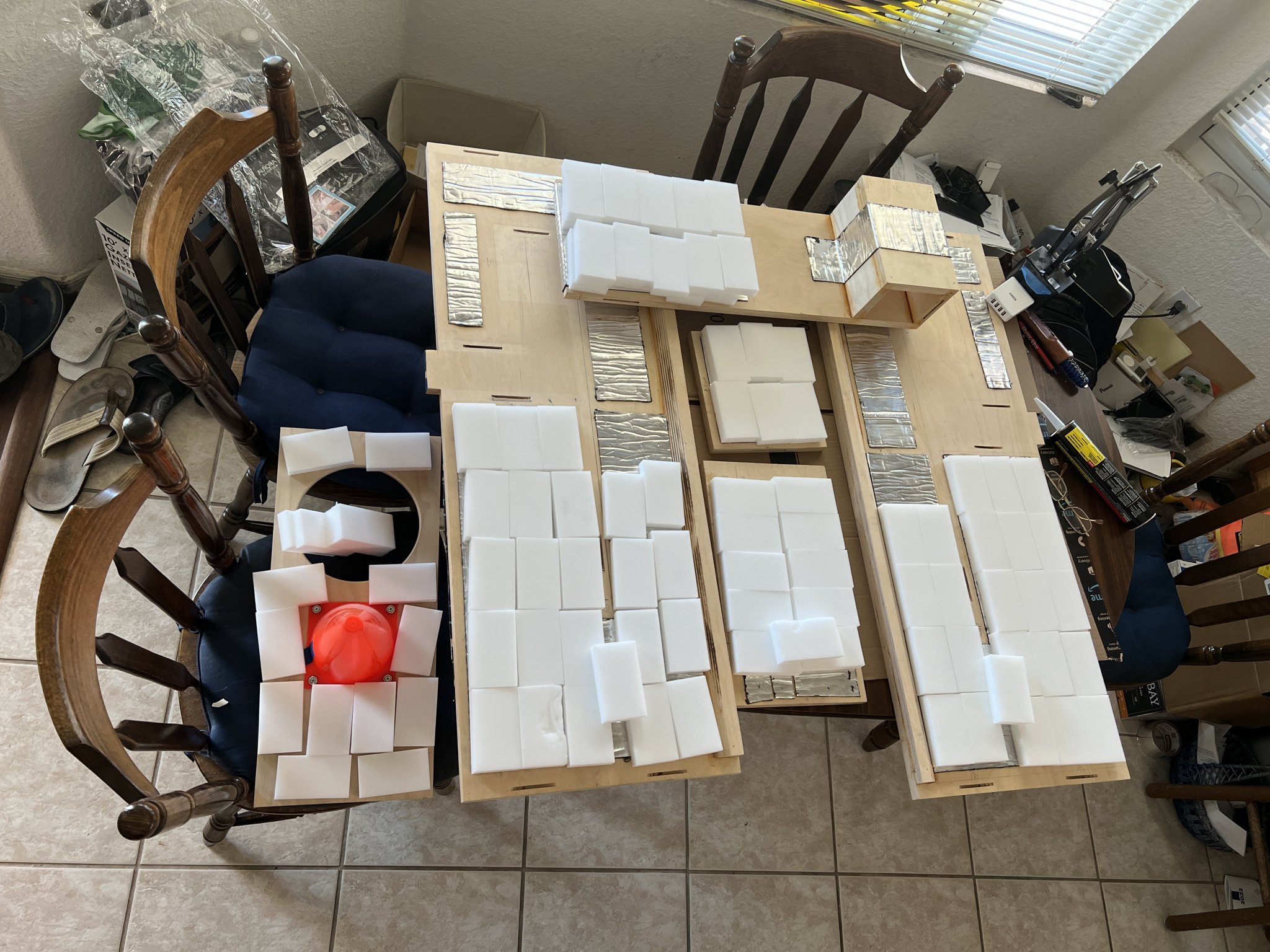

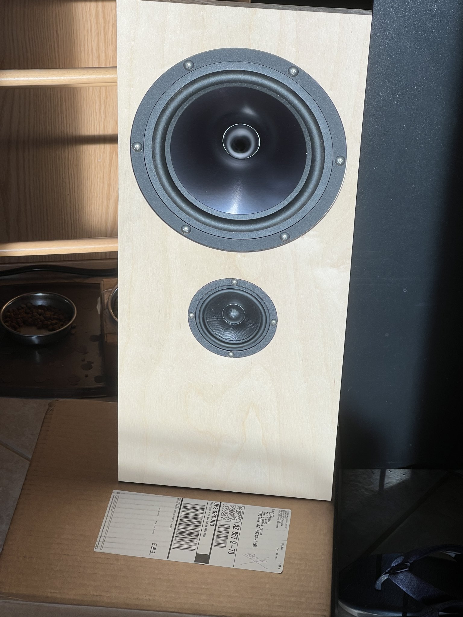

It has been quite a long while. I haven't given up, I've just been distracted. Learned knifemaking (my first one is in the third picture) and done many other things. But now we're back to working on the speakers. The lumber was cut a few months ago (before I got a commission, made my own forge, finished the commission).
First photo shows a rough estimate for where sponges go, but I forgot to account for the back surface, so I'm a few sponges short.

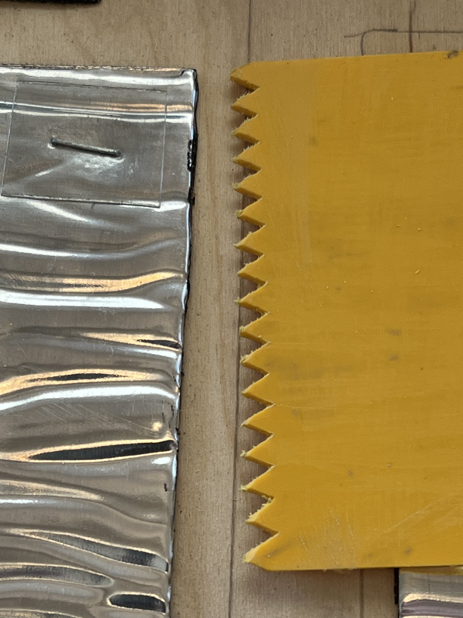

Second photo shows a detail of how I added confidence that the butyl foil would stay put (small bits of 2 liter bottle with a staple in it) and of the scraper to smooth out the construction adhesive I used to attach the sponges

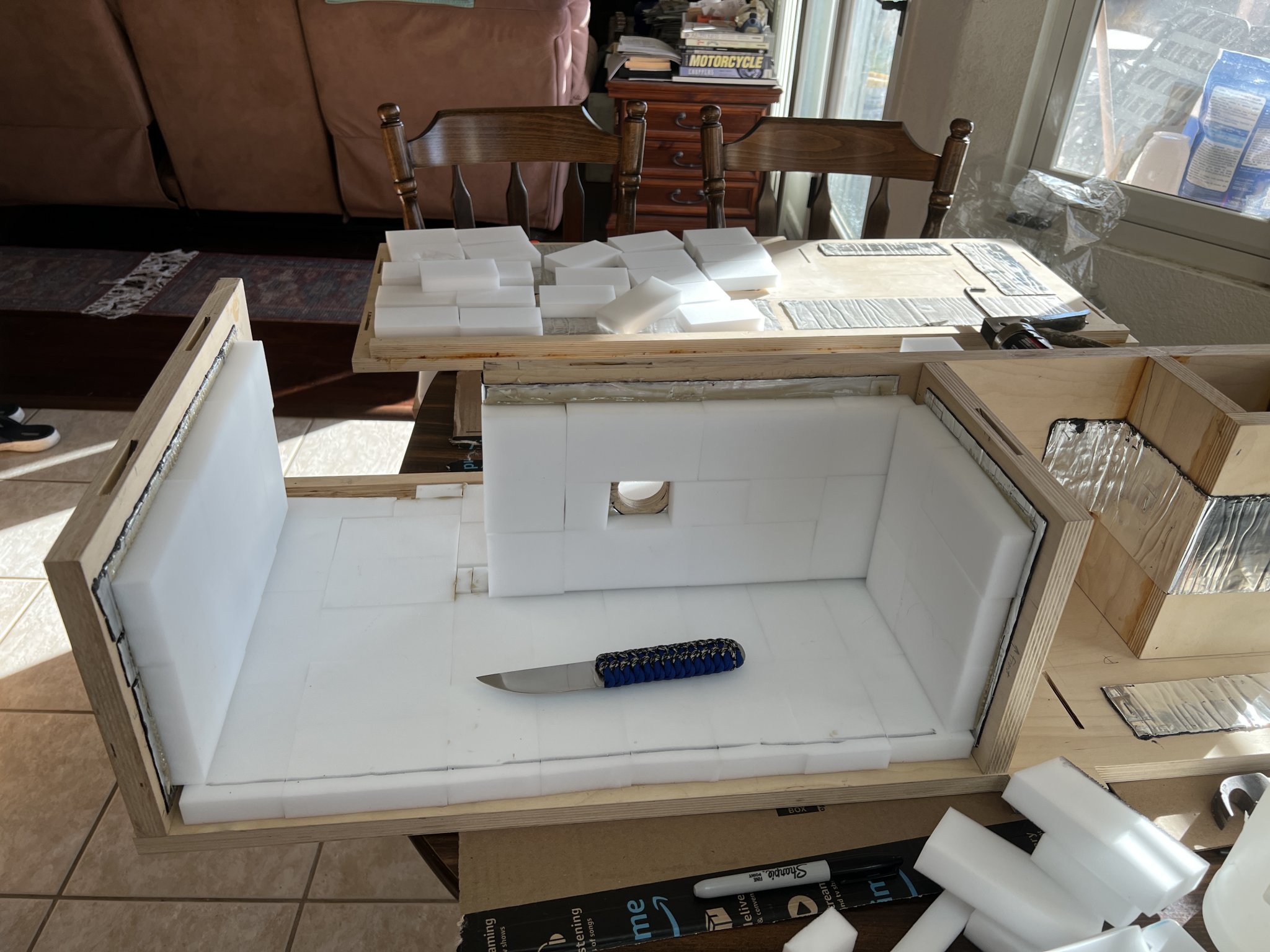

Third photo shows a partially assembled (dry fit) with a line marking excess foam to cut (and the aforementioned knife)

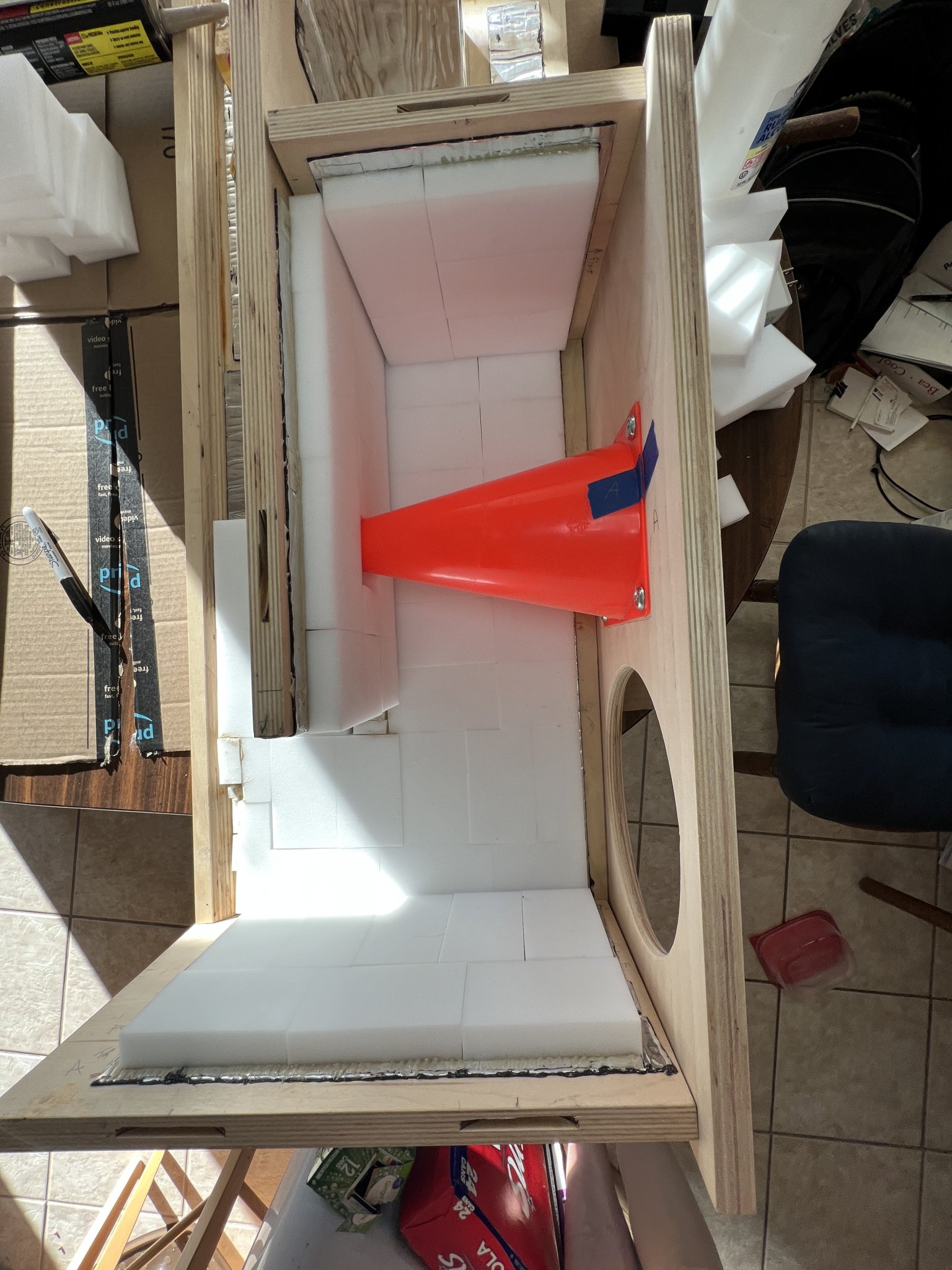

Fourth photo shows a large portion of the upper portion of the speaker and one of the two sides, but note the lack of the back panel or any sponges for it... oops

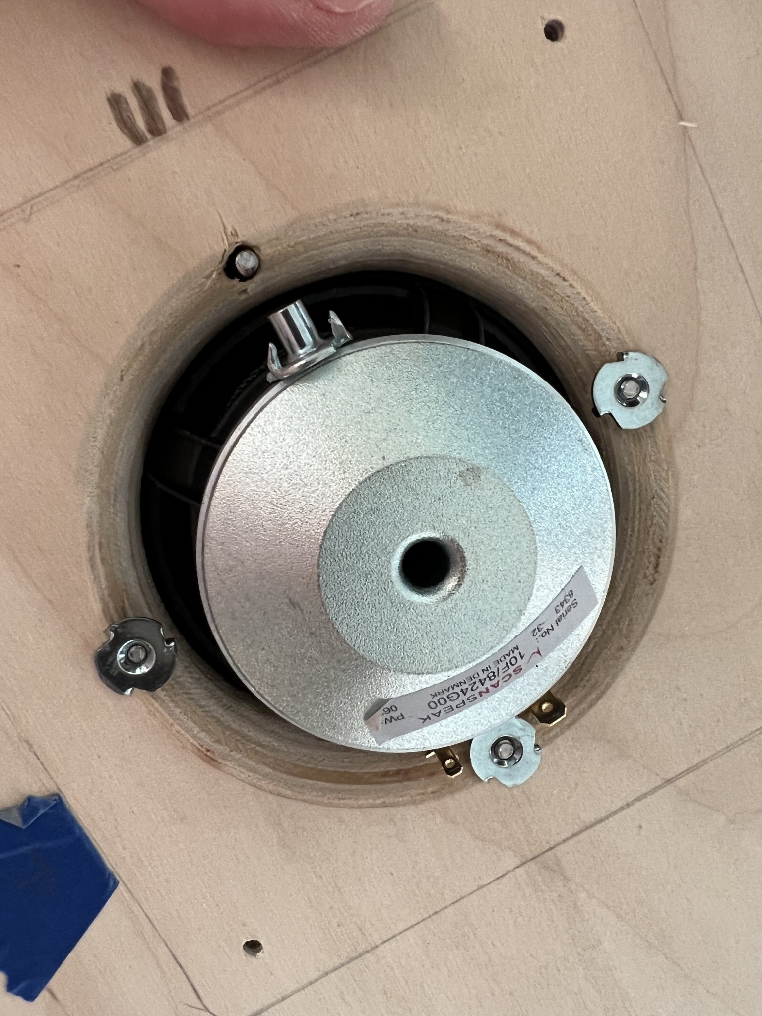

Fifth photo shows the back of the 10F, along with the T-Nuts, which happen to be steel and pointy and stuck to the magnet... Fun!
Sixth photo is the speakers in place on the front panel, looking sharp. For an improved WAF, I allowed her to select the orientation of the screws on the front. Need to find some black-out hardware (shown are stainless #10 and #6 at 3/4" long, both 32TPI)
Progress will be in spurts as time permits, but getting closer to having the first one done! Note that there is still a LOT of mattress foam to be installed in the lower half of the cabinets before gluing (and sealing of inside corners) begins.
A question: what are people using for gasket materiel for removable panels? My local hardware store seems to have a lot of real squishy foam, but nothing like I'm used to seeing for speaker gaskets (which I presume is the kind of stuff we want for sealing the back or any other removable panels). Any tips on what I should be looking for? What worked? What didn't work?

Nice work Kking85743!
Don’t forget to seal the joint between the cone and the divider panel, and seal the cone to the baffle (caulking). You got the full melamine foam treatment!
I used weatherstripping gasket. Squishy foam with adhesive back.

thanks!
Indeed, lots of caulk will be used, this was just a dry fit to ensure clearances. I'm planning the assembly around being able to caulk everything. First step is the glue-up of the top, spine and both halves of the mouth, with jigs to hold it all square and plumb. Once the glue dries, all the inside corners get caulked. Then the lower front is glued, dried and caulked. Then the bottom goes on, and then the upper front (which should be able to be completed via the back or the large speaker hole). The back will be screwed on last (thus the question about how to best seal it). HeHeHe, yep that's nearly all 100 sponges. Why just "do something" when you can OVER DO IT?!!!?! hahaha
By "squishy" do you mean the open foam that's about 1/4 to 3/8 thick for window frames? I was expecting something more like what typically comes with car audio, a thin neoprene-like gasket material, perhaps 1/8 or a bit thinner. Actually, there are probably two use cases, and I am conflating them. For the speaker gasket, the thin, neoprene material may work well. But it probably isn't the best for sealing the whole back. Is the open cell stuff sufficiently resistant to leaks when screwed down tight?
Yeah, a of mine friend had been "heating and beating" (making knives and trinkets) for a few years and invited a couple of us over, and now it's a regular thing. That was my first creation, made from a chunk of coil spring. Due to my big hands, I went with a double thick weave of paracord for the handle. Wood handles always felt slippery in my hands. I'm just picky (and a little bit weird).
Hmm, can we improve WAF by asking the wife to decide something about the design? How much more WAF does that give us, in percent?
That depends on the wife, I presume. She is picking the color for the wood, has asked me to use wood tape to cover the exposed plywood edges and wanted horizontal lines for the speaker screws (equatorial looking), so that way she can say she helped contribute.
I am considering painting the throat in flat black, but I'm worried about accumulating dust, so I may go with semi-gloss or similar. Provided I get the OK, that is. She is a real sport for putting up with my crazy shenanigans. Fortunately her brother once owned a high end audio store, and so she understands what I'm trying to do, and knows how much this stuff would have cost in the 80s.
