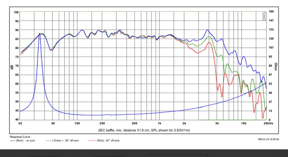

I guess I like the RS225-8 the way it is. It is a unique driver and I have not found an equivalent performing one by another manufacturer, at any price. I like it’s sound and enjoy the synergy it has with full range drivers as a mid tweeter.
If you have a suggestion for another 8in woofer with a flat response from 100Hz to 2kHz, and relatively low distortion and 7mm+ of Xmax, let me know.

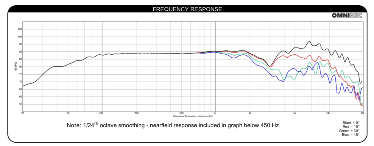

Same as my post about the racetrack driver. It has a peak at 4kHz, so might be harder to implement using 1st order XO. But it allows for a much narrower enclosure, which was a factor to get them accepted by my wife! And in a MLTL, they easily dig down to the mid 30Hz, which for many people, is low enough and won't need subwoofer support. Not me thought! I like subs! From deep organ notes to movies. 😀

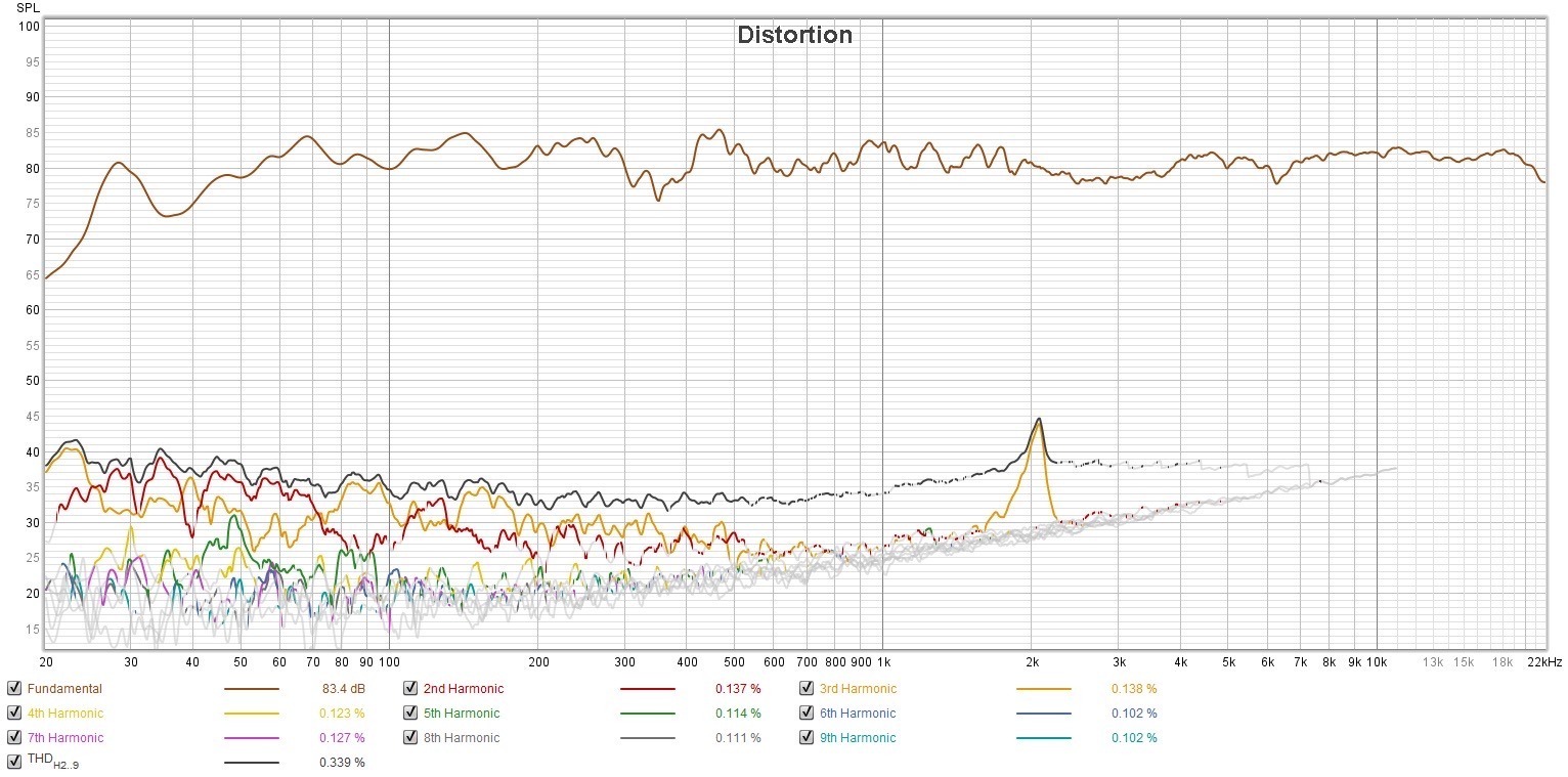

A woofer I like very much that has a linear motor and measures well is the XBL aluminum cone 6.5 designed by Dan Wiggins. I used one on the new Statement 100 speaker that I designed.
Notice the very low levels of distortion. This is only at 2.0vrms but still beats many other drivers. The peak at 2kHz is the usual bell-mode resonance distortion often seen in aluminum drivers of this size.

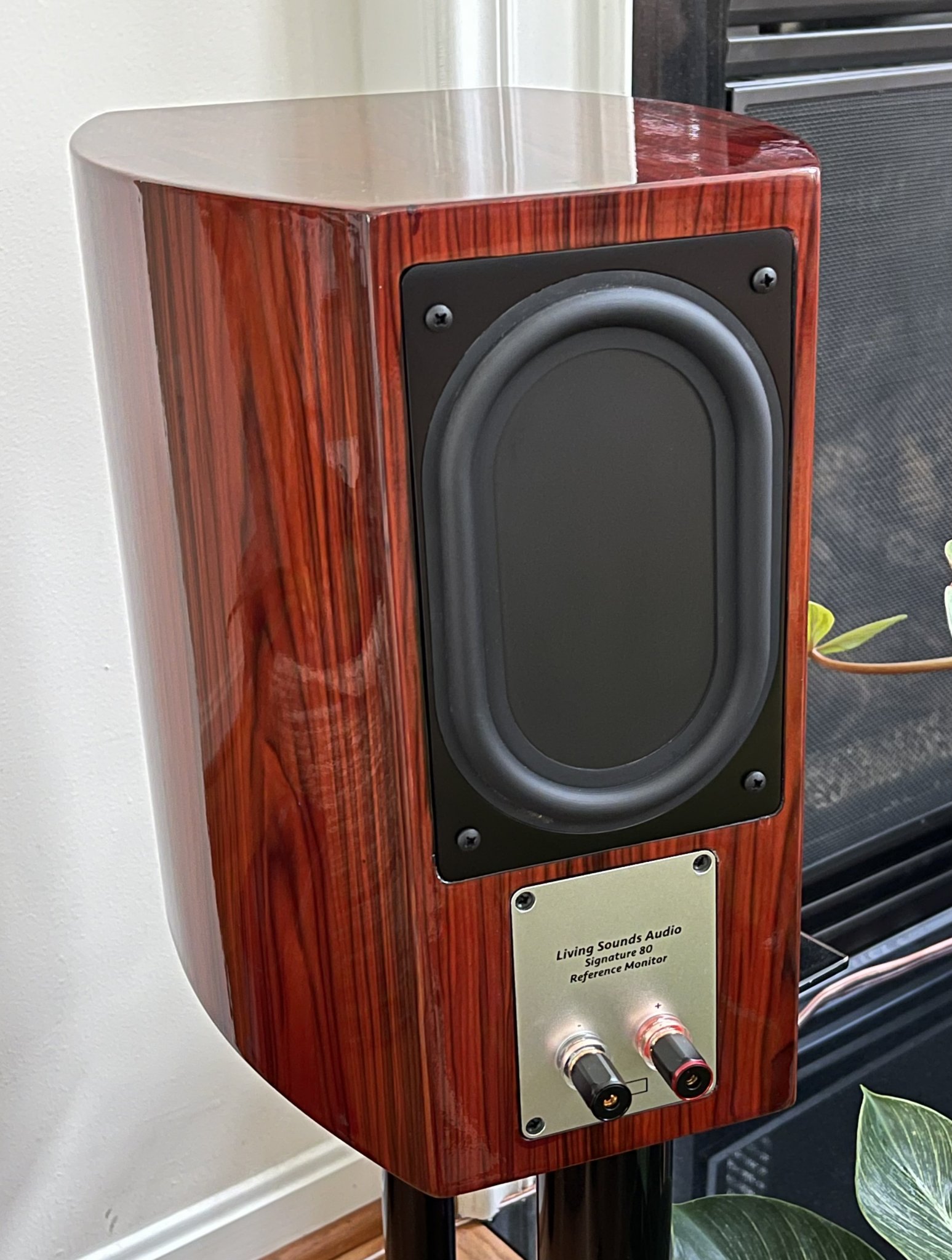

Perceval might like this, it’s got a 5x8 racetrack passive radiator on the back.

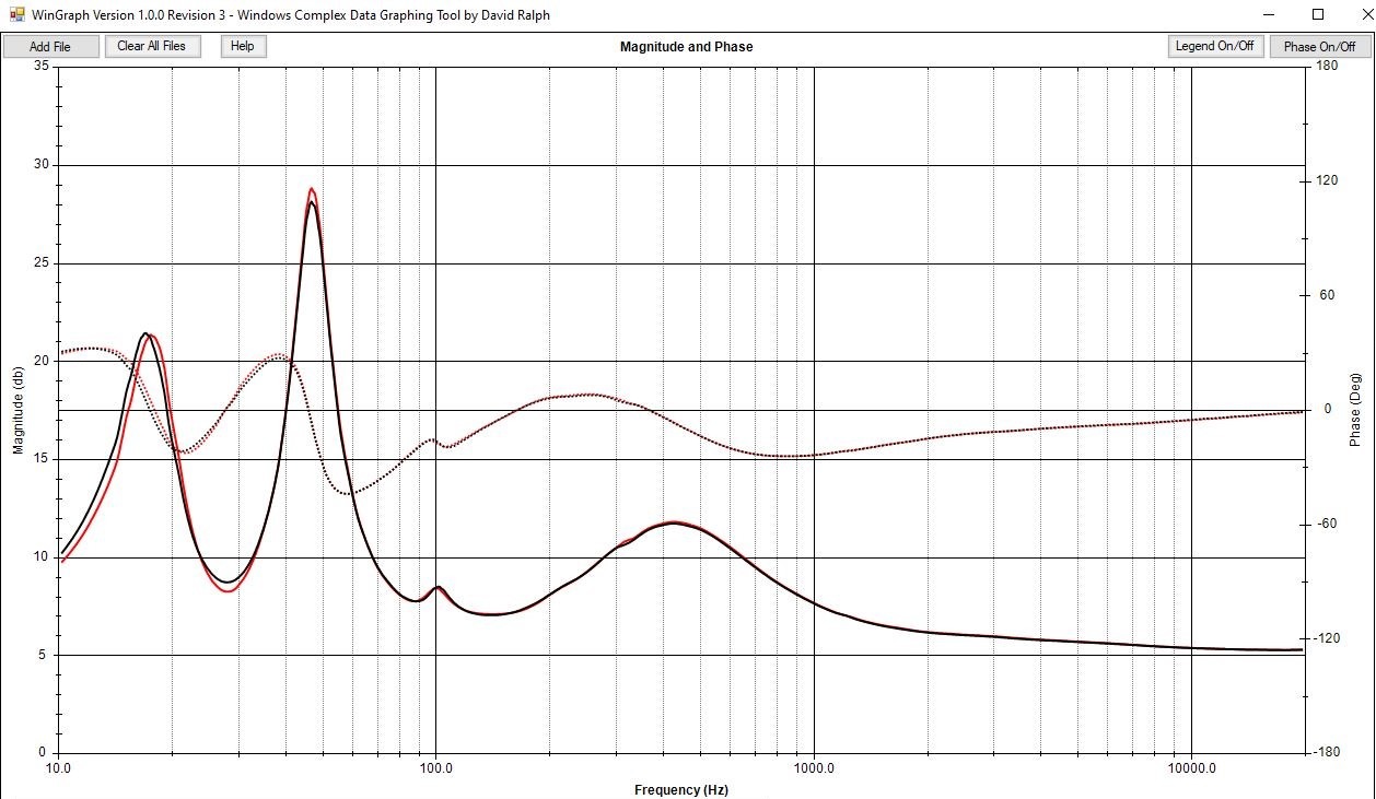

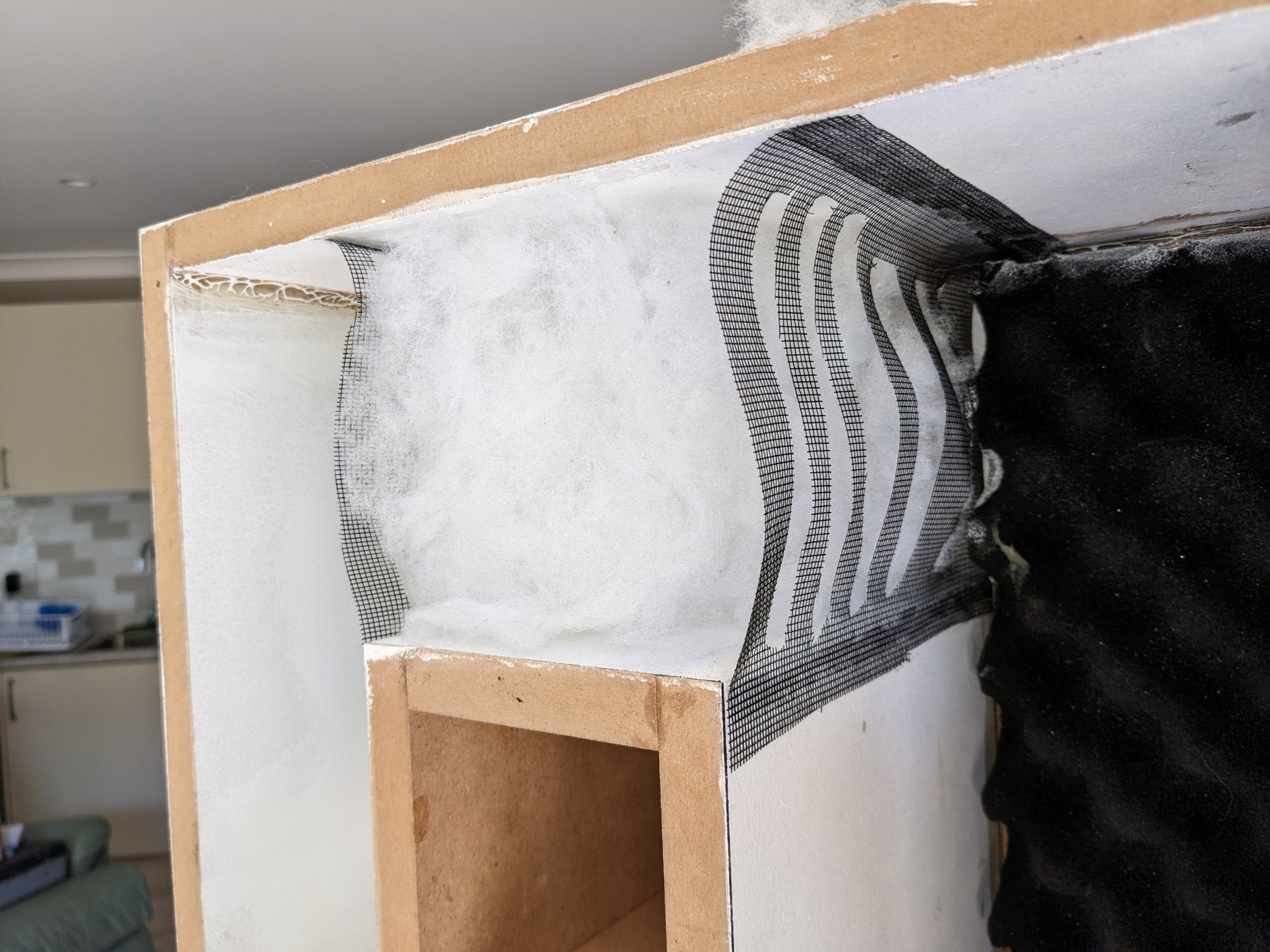

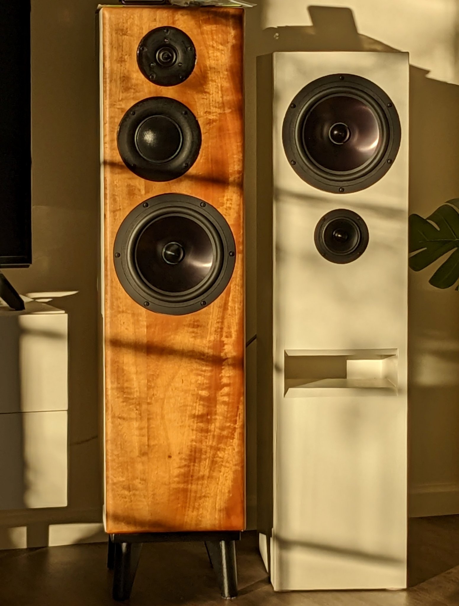

Finally got my TLs done to the point of listening – nice 😊 Great to have something sound so good straight off the mark !
At first they sounded way too bright to me, but over a day or so my “learned hearing memory” adjusted & I realised the 3ways I did a coupled of years ago had the mid/highs rolled off way too much in comparison. Adjusted 3ways & now have a much more interesting comparison on my hands.
ATM I haven’t adjusted the TLs at all. Curiously I got Z plot lower peaks around the 21-22R region with no stuffing apart from the “ball” at the bottom of the line. I’ve started with 12g in the cones for the B80 & will experiment with more. Sorry now I didn’t break out 2 wires to shunt the series B80 atten resistor for easy adjustment. (currently 1.65R for a 0R22 XO inductor – XO board screwed into rear top side)
Thanks X for a very interesting and high quality build !

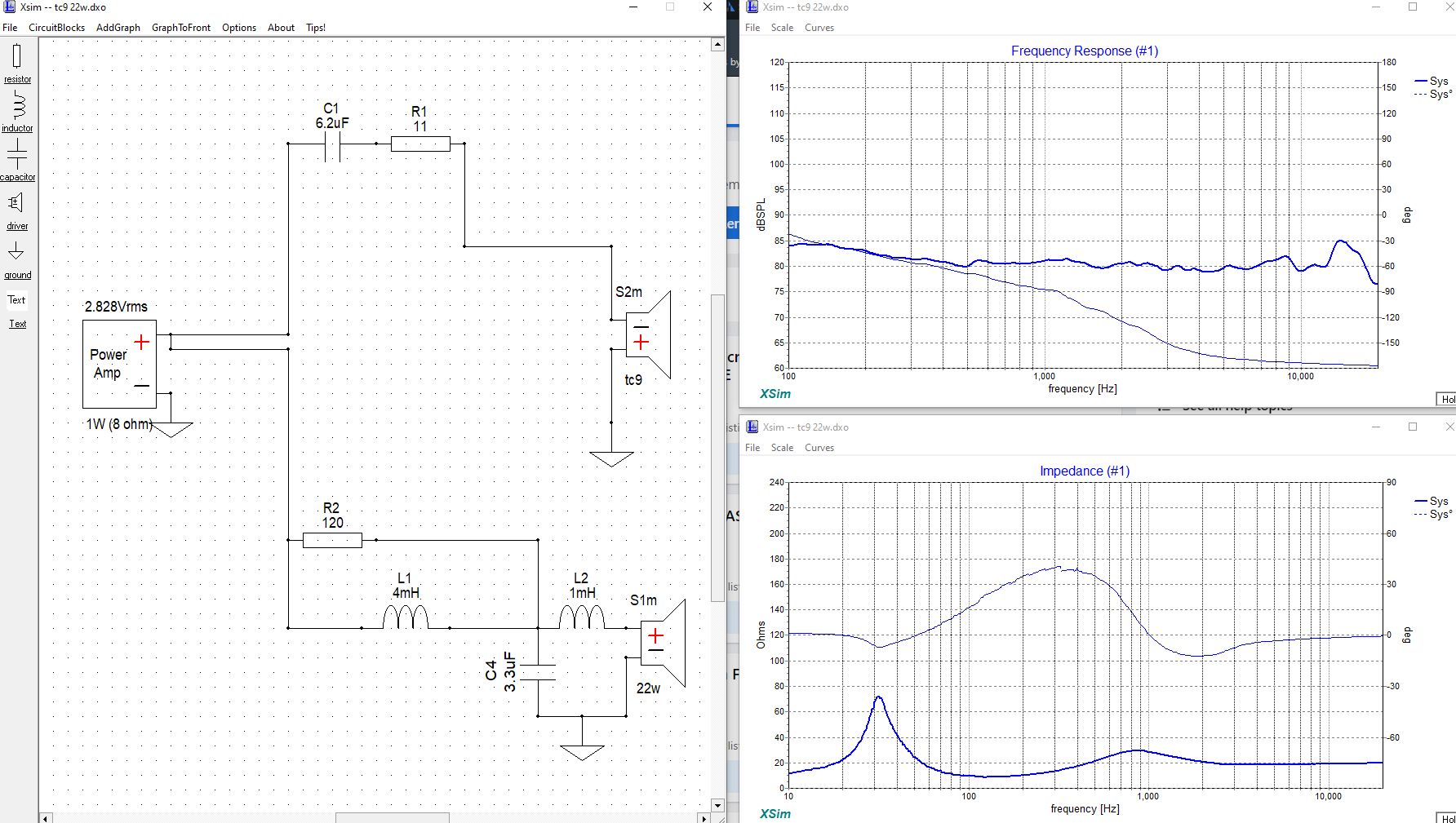

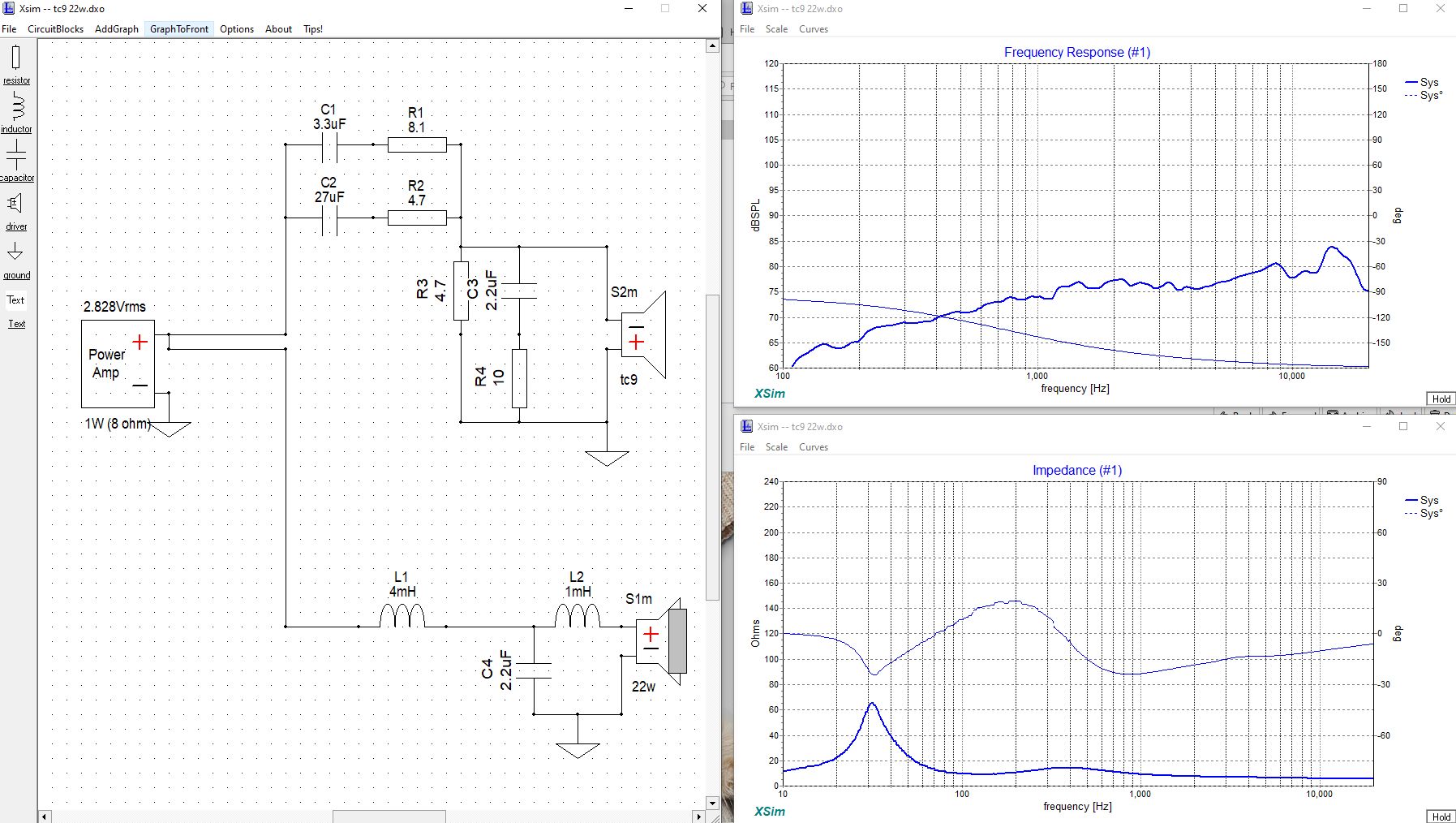

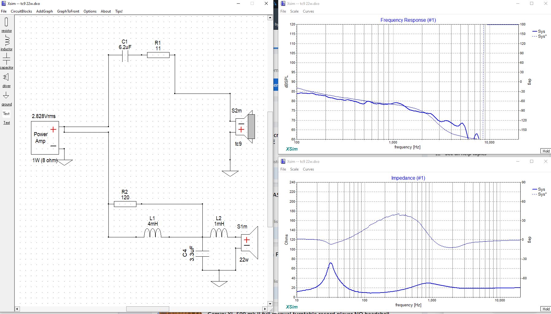

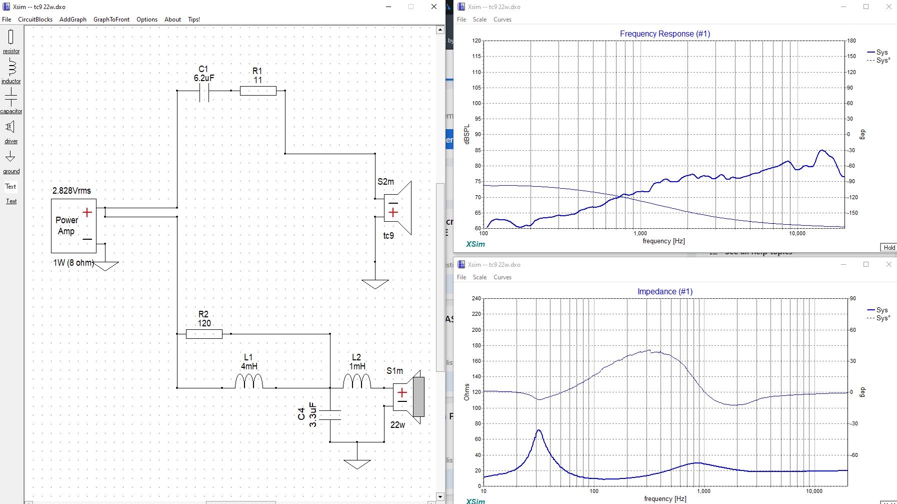

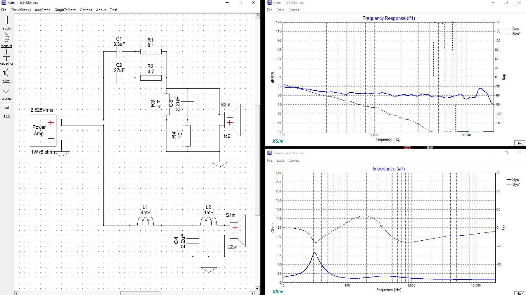

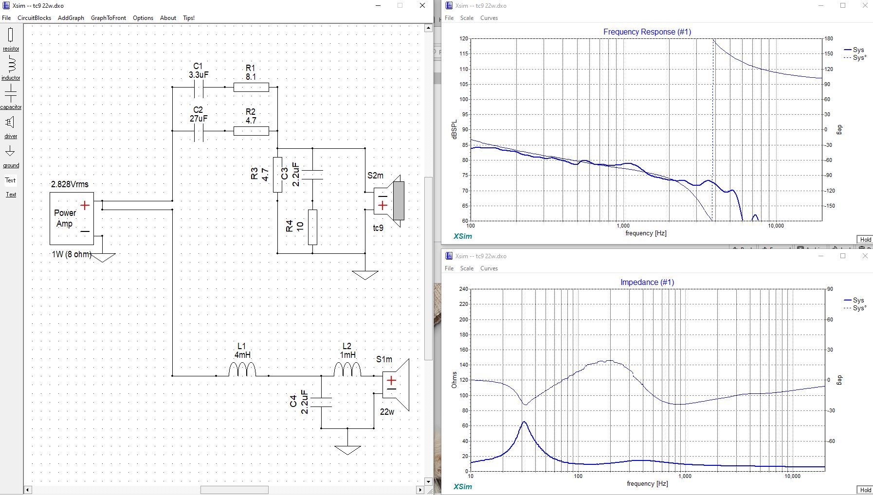

Peerless by Tymphany TC9FD18-08 3-1/2" Full Range Paper Cone Woofer
ScanSpeak Revelator 22W/8857T-00 8" Woofer, Aluminum Cone
(2) cross-over looks better.
TC9 is down an extra 12 dB at 100-200 Hz.
22W looks better also.
FRD and ZMA files are attached to this post.
IN XSIM -- 22W "mod sensitivity" is 21.25 dB
IN XSIM -- TC9 "mod sensitivity" is 25 dB
Took me 100's of tries to create these.
Mainly the graphs Y axis scale was off when transferring from FPtrace, so I kept having to redo FPGraph tracing.
Also I had to use a lot of photoshop for the 22W graphs, so FP trace would trace the FR correctly.
FR curves look pretty spot on, impedance are close enough.

Wow that’s a lot of work. Can you show a crossover curve with woofer, tweeter, and system on same graph?

I never can design a good XO using published FRD files. The measurement needs to be made in one’s own actual baffle and own ZMA curve to be truly accurate. The FRD files give an idea of where the curve falls off etc. - the intrinsic limitations.If you build it, show us the measurements. I've been usng SS drivers for over fourty years, crossovers built from their measurements are never more
than vaguely related to the finals.
I think they measure prototypes, and publish that. Or there is some parameter that's different, and not mentioned.
Very nice work, GUJoe! If they sound bright try adjusting R1 to a larger value.Finally got my TLs done to the point of listening – nice 😊 Great to have something sound so good straight off the mark !

I don't think even changing the woofer matters, that much. See graphs.
You can literally drop in different woofers without changing cross-overs, nevermind measuring the woofers myself.
One of the reasons I actually made the graphs to show that putting in a different woofer (or FR graph) doesn't change the response that much.

In xsim you can add a curve trace, S1, S2, etc. I like to use green for tweeter and red for woofer and blue for mid and black for combined system.
Changing woofers certainly matters. They have different response smoothness, breakup frequency, distortion levels and peaks, TS parameters like Vas, Qts, Fs, Xmax, Le, Re, all affect the response. Aluminum vs paper vs fiberglass vs plastic cones all sound different. It matters a lot more than changing cap brands in a crossover.

So will measuring my drivers help me make a better cross-over? Maybe.

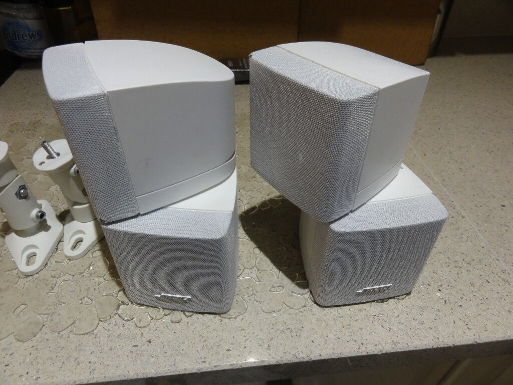

Why is it a had Bose 301's that sounded better (to me) than my Usher 9950-8948a 2-way speakers I bought from Joe D'Appolito himself?
Actually as he was nice enough to measure them for me in his house; I told him that I was not interested in that as soon as he started.
See if you do blind A-B testing and people say the Bose 301 is a better speaker than the Usher 2-way, the Bose is a more-liked (better) speaker, no matter what your graphs say, that's what science is.

Instead of hating Bose 100%, just hate them 80%.
Want to improve your FAST, build this:
In some seriousness, I do like the Bose swivel cube design.

You can confirm online that people who have measured the ScanSpeak 22W, aluminum, paper, 8 ohm, 4 ohm, they don't get much different results than ScanSpeaks published FR, in my humble opinion (as "audiophiles" say).
Certainly won't affect your cross-over design, especially in this design.
