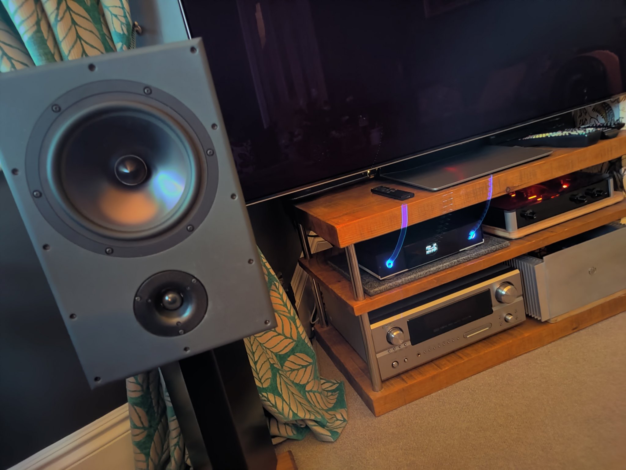

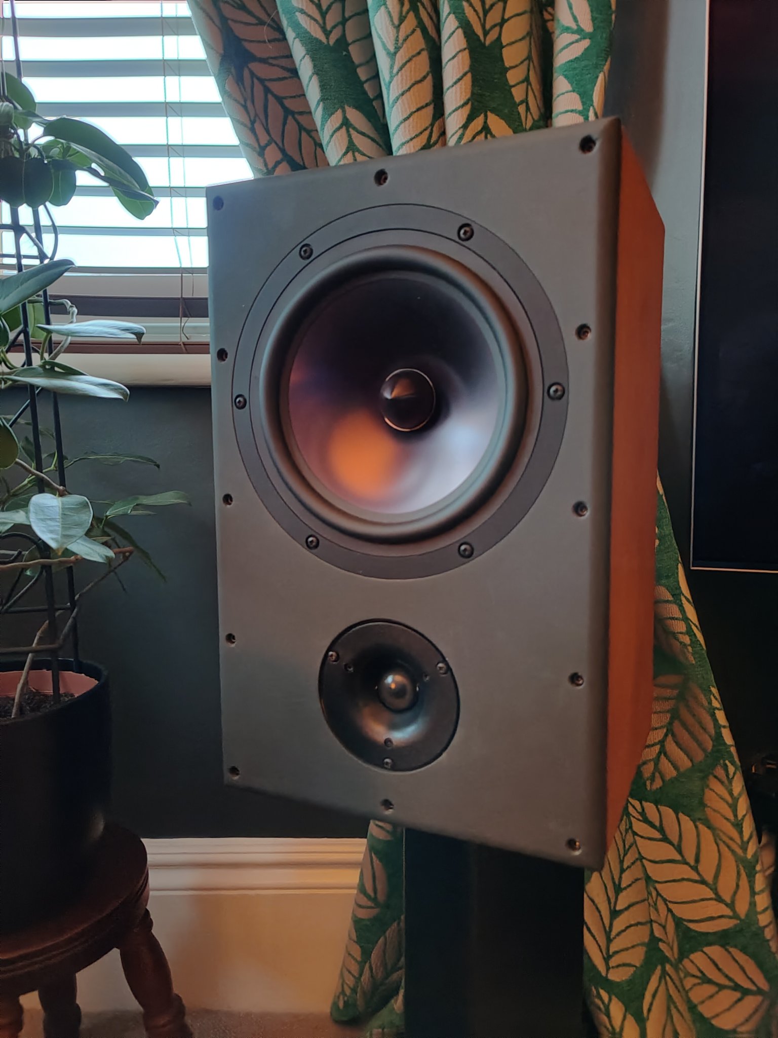

Speaking of first order, and the nay sayers of crossing 8" to a dome tweeter.....
I was finding my PS95s lacking a little bit of life and a recent purchase of some Morel CAT378, I decided to try them in my XRK speakers. Looking at the DS for the Morel it seems feasible to use 5uf for a 1st order. I simmed it in Xsim and the result wasn't ruler flat but acceptable. And to avoid taking the baffle off to get to the XO, the Morel is seeing the whole network designed for the 3"fr, I just added a 4.7uf in series. Tweeter is reverse phase wired.
Listening now and its really very good. Moderate levels at the moment as not to blow them up! Playing via Google Chromecast, Miro AD1862, Salad DCG3 and an Aleph 30....well more a 20 until I sort the heat out !
