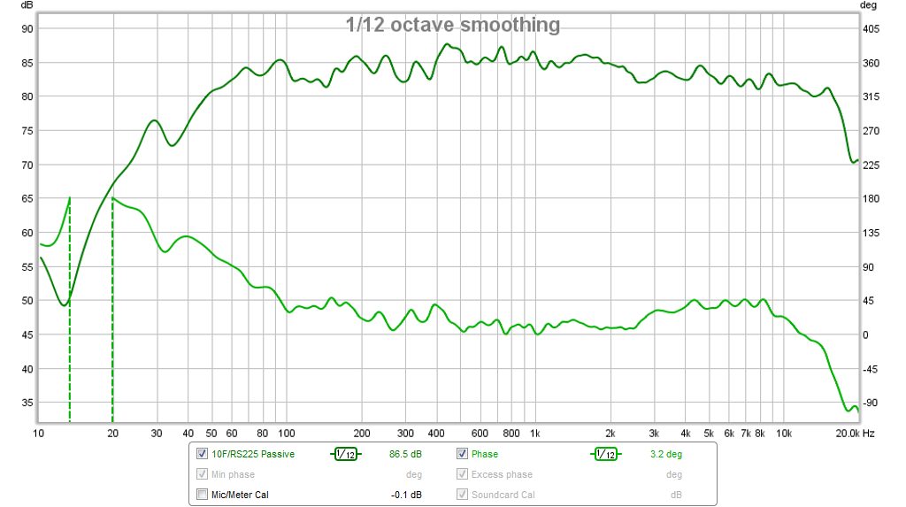

Not sure what you are referring to when you say “annoying rising top end response”? The raw driver may have that, but in this speaker with this crossover, the response is anything but rising. I usually voice my speakers to have a downward tilt to the highs - the so-called Harman house curve which has been found to work well with all genres of music and not sound fatiguing based on countless hours of trained listener feedback and also matches my own preferences. It’s because of good measurements that we can design great sounding speakers based on theory and science. Our ears are important but in the end, the measurements provide quantitative means of consistently attaining and optimizing the system. Factory FRDs are fine but they neglect the effect of the baffle step loss and diffraction of the particular cabinet that the driver is mounted in. It also won’t account for the acoustic offset between the drivers which is critical for designing the XO accurately.
There is about a -5dB drop from 100Hz to 15kHz.

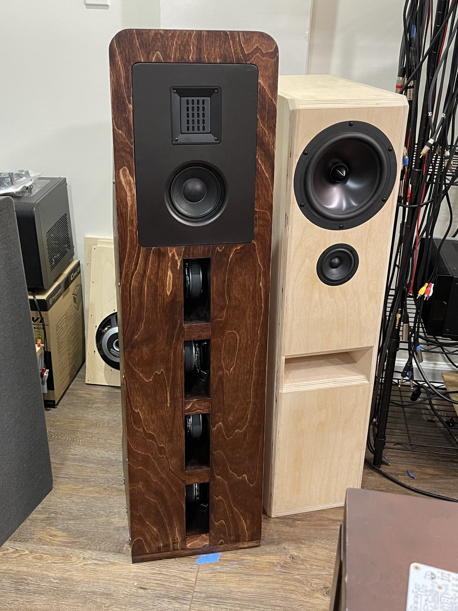

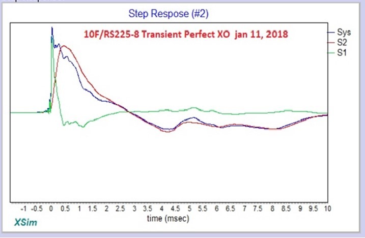

I understand wanting a "better driver".
Stiffening ribs, copper cap, shorting rings help, and measurably help.
However, the 225 works for this 6db alignment best.
Otherwise you'd need much more stuff to make an 8" measurable 6db roll off.
I've looked.
Short of zobels ckt, you'd need a flat Z curve, so a copper cap woofer could work.
But in this design I think the even is baffle step.
So, for a 2-way crossing to a 3" full range, this may be one of the best options out there.
Also, If the 3" is above the woof, the level may be higher, maybe not back 10' away.
I also prefer eq adding bass and treble, so seeing -5db at 10khz, I know I would want to boost the hf for my preference.
Dynamics ?
Well, at least you have good alignment, that helps with the sharpness of highs lining up with lows such as a snare drum, wood block.
Slam, dynamics, you may want for more drivers (maybe 6db crossed say 200hz to another 225) or driver size (different design).
Myself, I think compression drivers help for dynamics, as with low qts woofers.
I'm into punch, so 10-15' away (room 13' x 26' with openings on either end), I need a 12" per side, still not my double 15's, but not bad either.
Just my opinion.

"Slam, dynamics, you may want for more drivers (maybe 6db crossed say 200hz to another 225) or driver size (different design)."
I was thinking about a 10" but it narrows choice for a suitable driver even more.
Perhaps best is indeed to just copy XRK's design (with supertweeter facing upwards or backwards). Who knows I find the Dayton / Omnes Audio at a giveaway price like the 10F's; that might help to forget about 'wanting a better woofer' and would sound even better.
To XRK: the XSD woofer looks promising for sure; unfortunately not for sale here yet as far as I know.
Question about your 225 / 10F design: you said distance between the drivers should be respected. I haven't read the 193 pages, so perhaps you repeat yourself, but what nasty thing happens if closer together? You would suspect less lobing, especially with flat filtering.
Thanks.
Thanks.
It will work with closer distances for sure and ideally it should be a coaxial with the 10F sunken back 3in behind to get the correct time delay. If you change the driver spacing or the baffle width, the XO as published, won’t be ideal anymore and you will need to do your own. If you are using DSP and active drivers then all is good and you can do as you wish.
The closer together, the vertical polar will be more uniform (less lobing) but the time alignment will be worse. I don’t find the lobing to be an issue. You can simulate that all in Vituix CAD or Akabak. There is a need for a rear chamber so that was part of the reason it’s a bit wider plus the need to get some extra time delay with woofer on top.

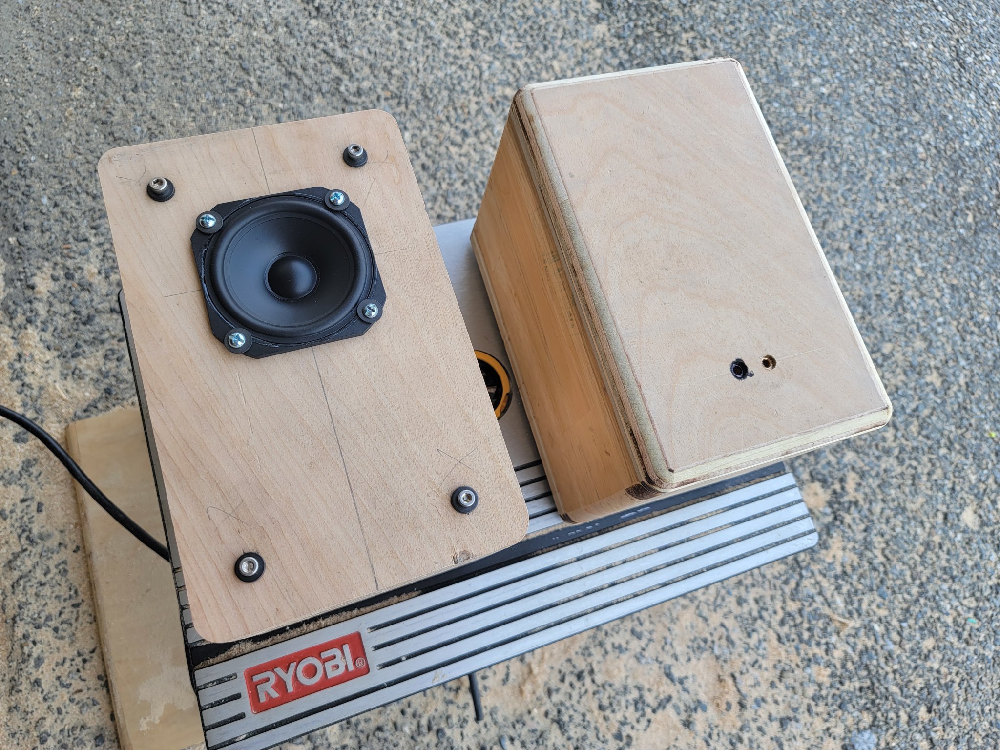

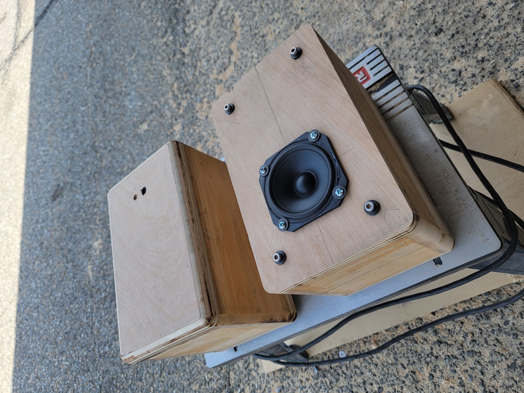

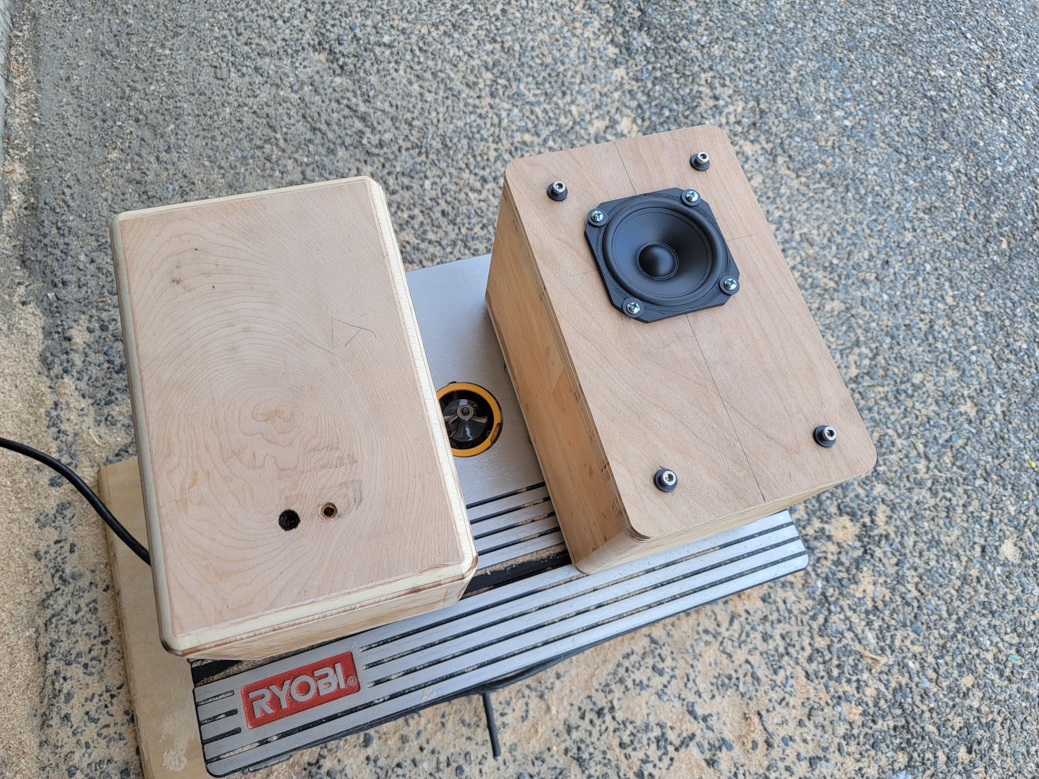

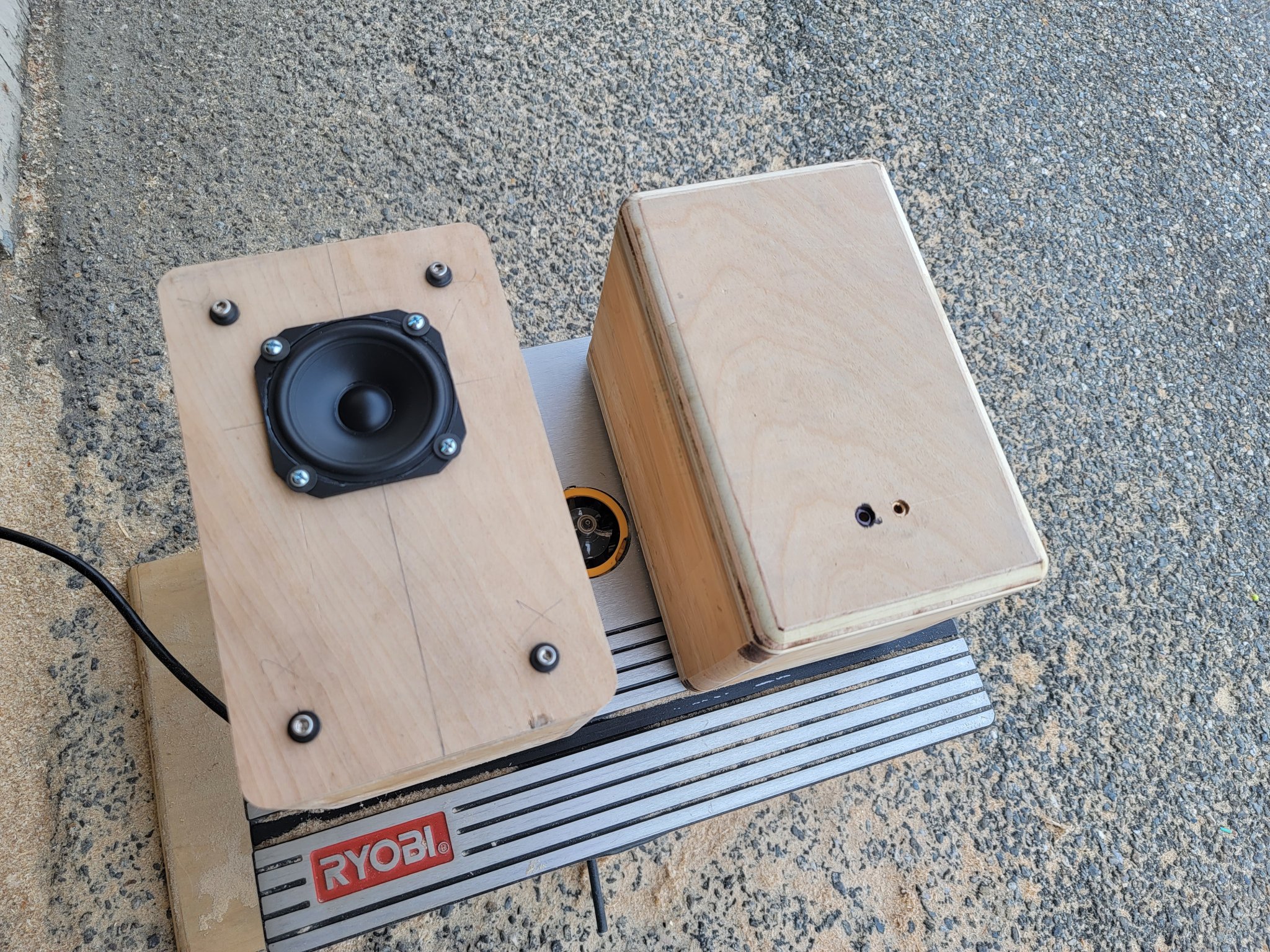

No I have the TC9
I built TC9 computer speakers (pics attached) to see how they sound and I needed speakers
I hear a lot of "Ssssss" in this video:
My TB 25 mm tweeters connected to my TV have a lot of "ssss"
So do the TC9
I'm going to go listen to some Vifa XT25 and 2 Hivi AMT drivers I have to see how they sound
And maybe some other drivers
I think the TC9 will sound best for TV and voices. I mean, that's what it was made for right?
The AMT driver and Dayton RS52AN-8 I have before were great (pic attached) , but had cross-overs at all the wrong places and the RS52 was crossed at 800 Hz (and 4KHz) I believe

TC9 or any 3.5in 8ohm driver in a small box like that will have a lot of baffle step compensation needed to not sound fatiguing.
Try 1mH air core plus 6.8ohm in parallel to start. Might even need 8.2ohm. That will tame the highs above 800Hz and maybe the sssss sibilance will not be as apparent.

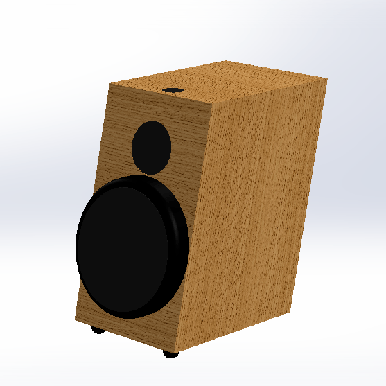

Why would you want to boost hf in this case? What's your expectation of adding a supertweeter to boost hf?
What are your thoughts on the position of the supertweeter (like a cheap and small AMT facing upwards) in the attachment? How would you filter it?
What is your distance between the 10F and the top of the enclosure?
In the drawing I used the same distance that you use (vertically) between 10F and 225, while the offset is 3" (divided over an angled baffle and a protruding ring for the woofer).
Do you have experience with a variovent to lower the impedance peak of the woofer?

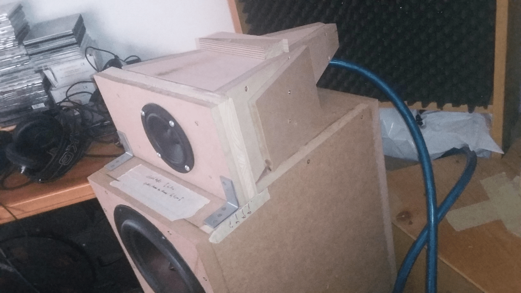

10k pole, single cap, aiming up or back ?
Couldn't tell you on alignment (spacing), but it may be so high that it doesn't do much.
ghosting in a dome or amt forward may add some horizontal dispersion if you need more sparkle in a wider listening area.
post 2024 calls for a 3" offset for the seas.
I think a cap pushes the tweeter forward in time forcing it to go back further than acoustic centers, but idk.
post 2025 "If you put both drivers on a plane baffle, the voice coil of the Dayton (woofer!) is about 5cm = 2in behind the voice coil of the Scan Speak (horizontal distance). I have attached a more the less true to scale drawing: You say, that you put the speaker upside down, and that the woofer is on ear height. At a listening distance of 1,5m = 59in = 4,9ft, the woofer's (!) acoustical center will still be 1,6” behind."
post 2079 "Still I have to say, that outdoors it sounds way better with the offset, compared to no offset and the listening height = woofer axis. I assume that holds true for indoors too. I go with the offset. It sounds way more transparent and true 3D like."
If you look at the 2nd picture, ideally the 2 peaks will both hit top at the same time.
So the woof needs to be a squeek further back.
Now how much of this is audible on music, not just on hitting a wood block, jingling keys, audience clapping, rain, or the sharp leading edge transient of a scnare drum ? I couldn't tell you.
I always thought 6db helped intelligibility, but my 2 way with acoustic 24db slope is very intelligible, so I have to rethink my preferences.
And remember, this is just my opinion.

(on if 1st order is phase coherent) "It is phase coherent in that all signals at all frequencies are 90° out of phase. I know that you have seen web sites that say that there is no phase shift through a 1st order crossover, but this is simply untrue! At crossover, the high pass section is leading - the signal appears to emerge from the filter 45° before the input. This would not seem possible, but is normal behaviour with all filters when a 'steady state' signal is applied - you don't have to really understand it, so I suggest that you just live with it.
The low pass filter has a lagging response, so the signal emerges 45° after the input. This is easier to comprehend, but may still seem a little strange (which I suppose it is for a filter that many claim has no delays)."
post 2222 "as the woofer is slower, as you said. The point is, that the highest points of the slopes need to be together, and this means, that the woofer needs to start earlier!"
