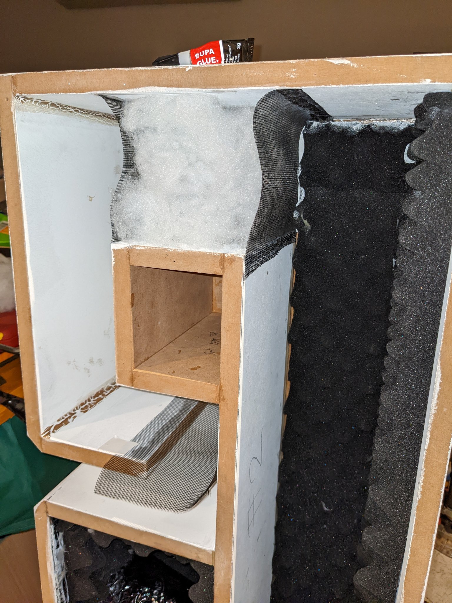

Hi All,
My TL's are coming along & about to glue last panel/side on. Have a couple of build related questions.
1/ Has anyone got a recommended polyester fibre stuffing mass for the sports cone using a B80 driver ?
2/ Thinking of using plastic insect screen either side of loose soccer ball stuffing in cab base + to add some as a bug screen just out of sight below the vent.
Does anyone know if this may cause audible output due to air movement ?

The stuffing in the sports cone is not critical - just add enough to what I would call, moderately dense (not fluffly, maybe a ball the size of a large grapefruit when fluffy). You can adjust as needed through the driver cutout. Line the mouth of the cone wall with felt or melamine foam pads (first 2-3 in). Leave a small 1in air gap between the driver magnet and the rear stuffing for breathing room. A bug mesh screen if not too fine will not affect the sound. Something like window screen probably too fine. Another one is coarse (low 15 PPI) reticulated aquarium filter foam. You can use the thickness of it to tune the impedance curve and get a nice combination of bass extension and low group delay and it can be done at the vent aperture. Tune until the double impedance peaks are reduced and straddle a minimum in between circa 10 to 15ohms. But listening with a song with good kick drums and adjust by ear works very well too.
Thanks for quick reply X.
Was hoping to get stuffing pretty close first up - because I've used 18mm mdf, don't want to be pulling drivers out too many times.
Screen I've got is probably what you're calling window screen. Flexible fibre glass with squares around 3 x 3mm size.
