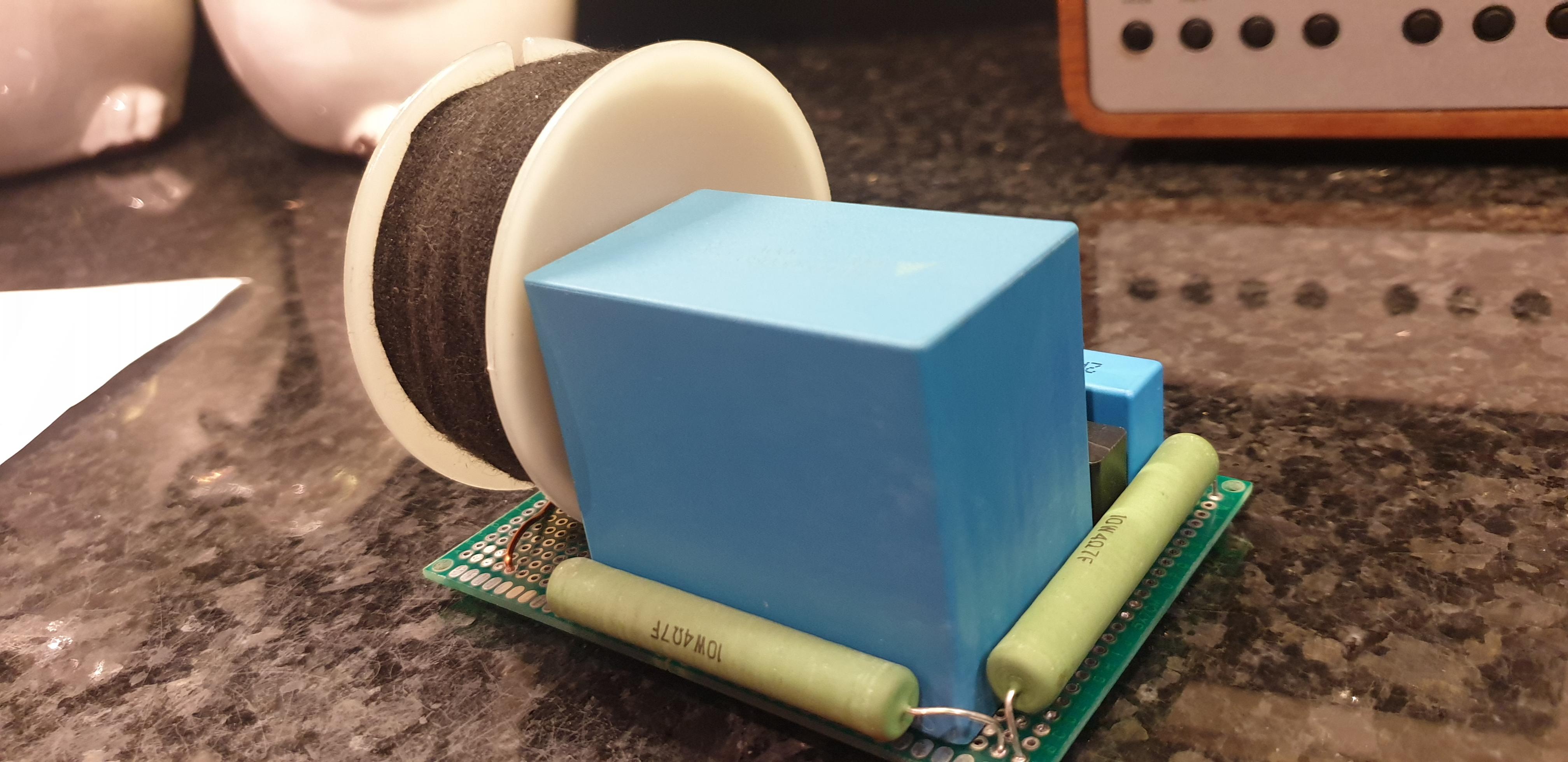

Slow progress but have managed to grab a bit of time for the build.

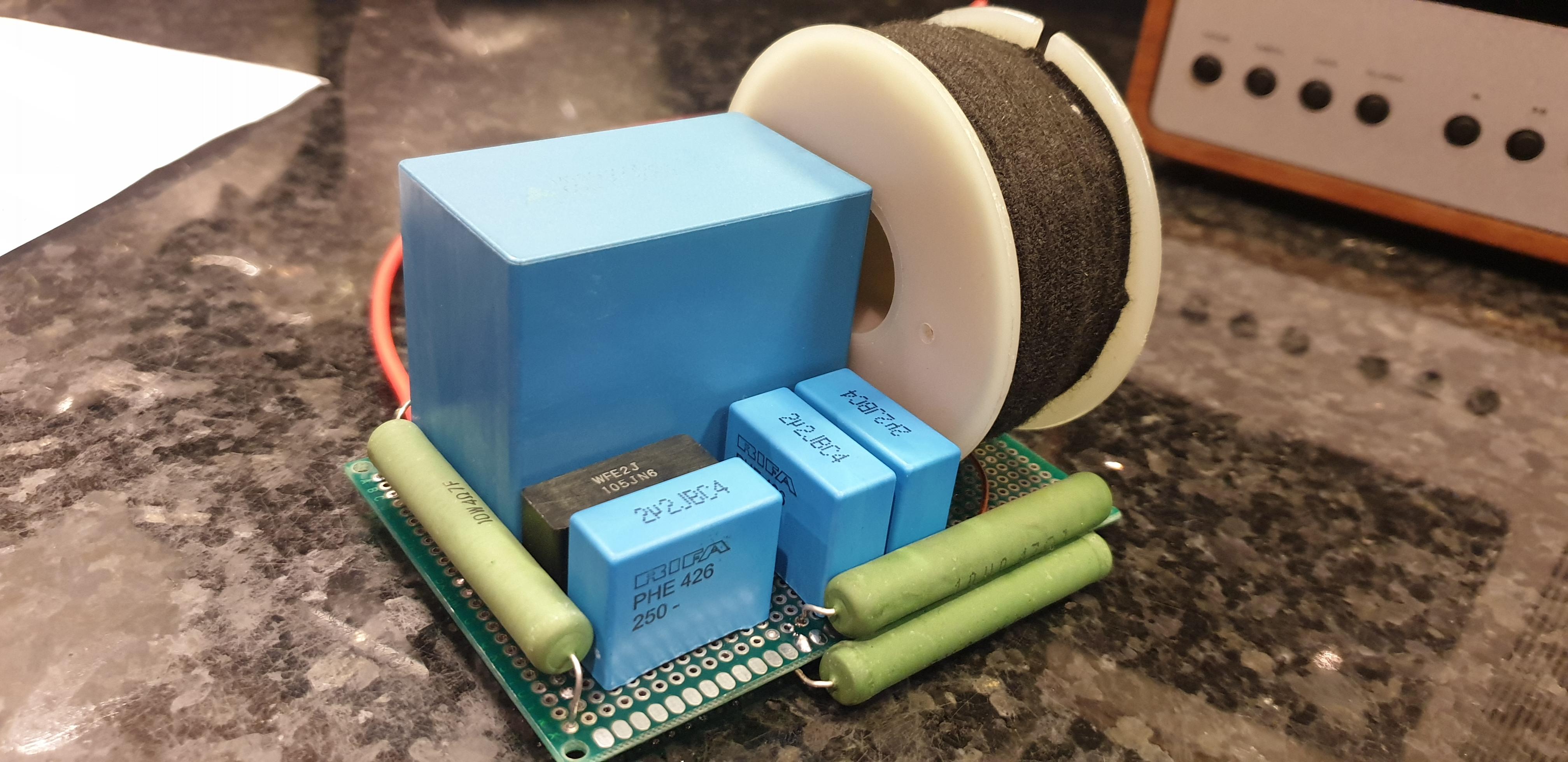

One crossover built, just need to finish off the input and output leads.

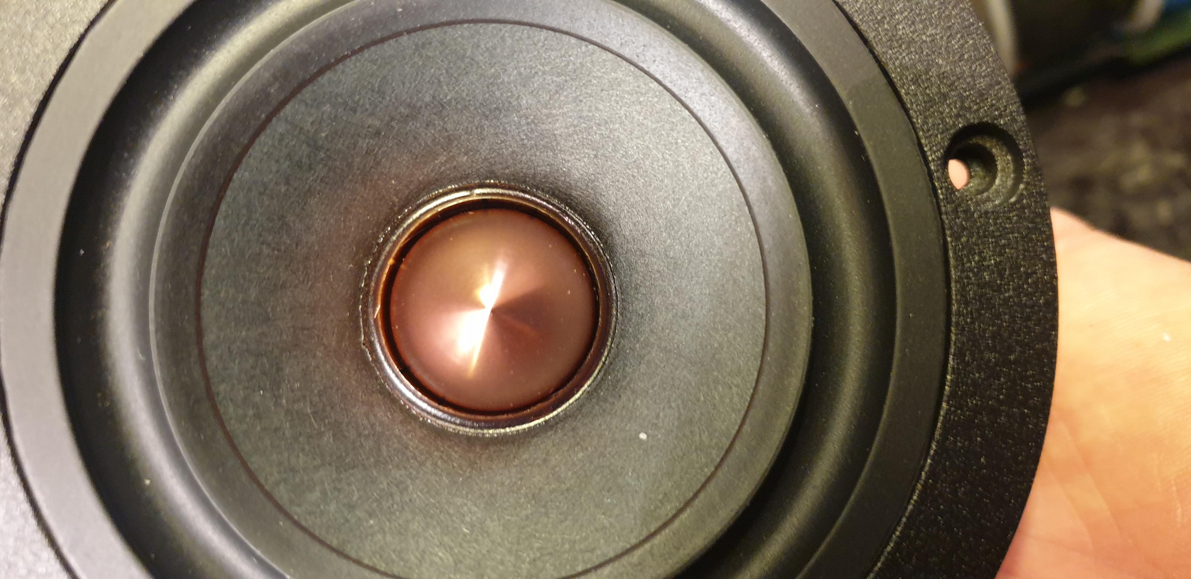

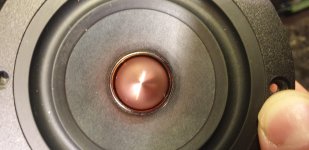

I succumbed to the PS95s aesthetics and they came back in stock on Amazon UK via the importer so I took the plunge. They will look a heap better than the 3fe22 but I shall try both. The 95s i notice are slightly off centre with regards the phase plug. Hope it isnt an issue.

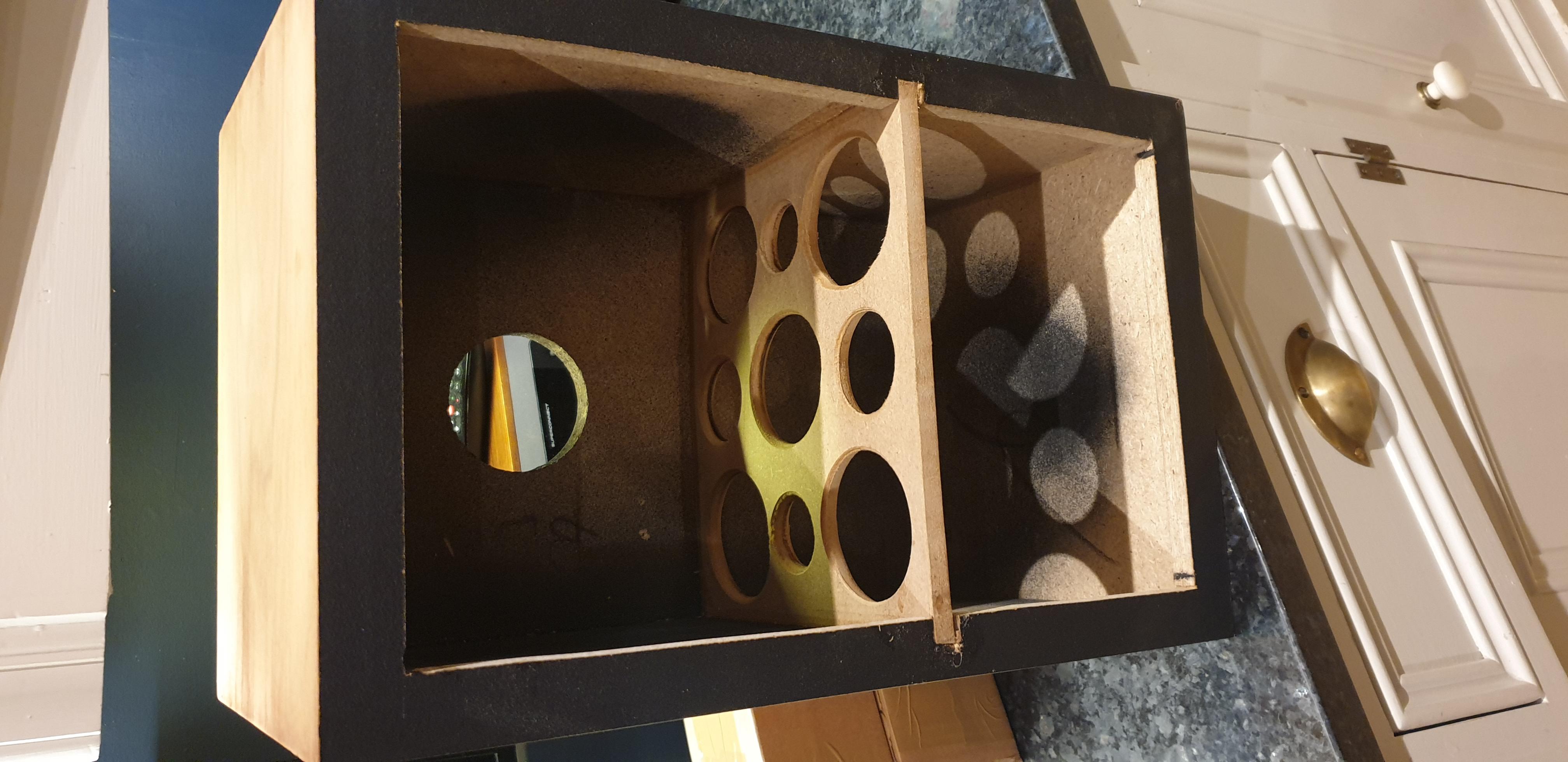

Started some work on an enclosure too. Couldn't decide how to tackle the baffle but in the end I cut the existing one off, leaving enough to fix my new one to. I will probably use some kind of rubber gasket to attempt to isolate the drivers from the box. I think my bracing was a waste of time as its bendy! Didn't want to go too thick to pinch too much volume as I am already a bit smaller than the 22litres of the proper design. Doing a knuckle wrap test though the brace doesn't seem to have achieved a fat lot. I have some Noico bitumen sheets and eggcrate foam to go in.
Enjoying the build so far....the crossover is testing my ability to read schematics somewhat at times. And I learnt something just today....if you turn your fancy soldering iron up to 400+ it will actually solder thick wires nicely!

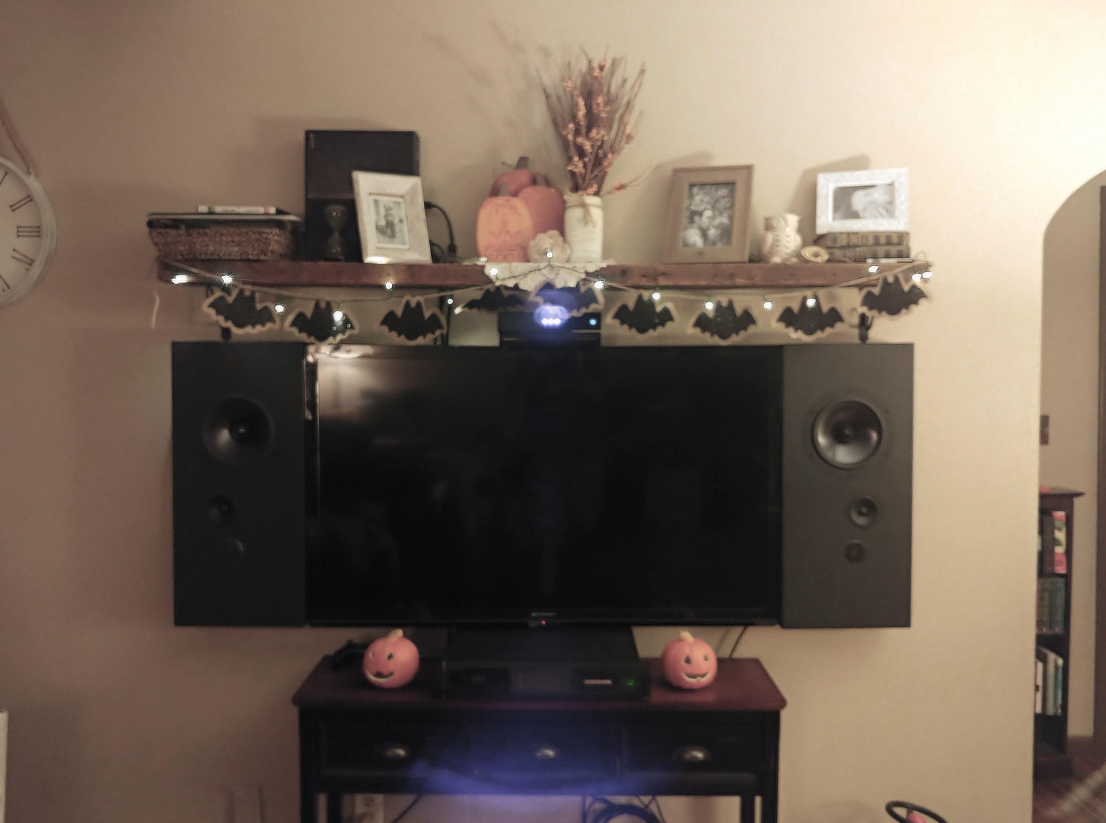

I strayed a bit and added tweeters, but I figured the post still belongs here. I don't have the luxury of aiming the boxes with this setup, so I figured I need the HF coverage. The AMTs seem to sound good, but frequency response is pretty unusable without DSP (also, both are different, and neither matches the spec response). I'm using DSP, not a problem. Crossing at 4k for now. I'll give some impressions after comparing different crossover points and TC9s alone.
Box is a little undersized, I'd imagine the bass is a little less tight than it could be. No problem getting bass to go low and loud enough. Of course, I'm also effectively infinite baffle (on the left side...) Boxes sound good, room is fairly bad.
Strange placement is based on baffle diffraction simulation, the extra spacing is obviously not ideal for lobing though. I can do brickwall crossovers to minimize the lobing, still experimenting with options. Right now I'm at something like 64db/ocatave linear phase LR, with phase response mostly flat above about 200hz and some correction below that.

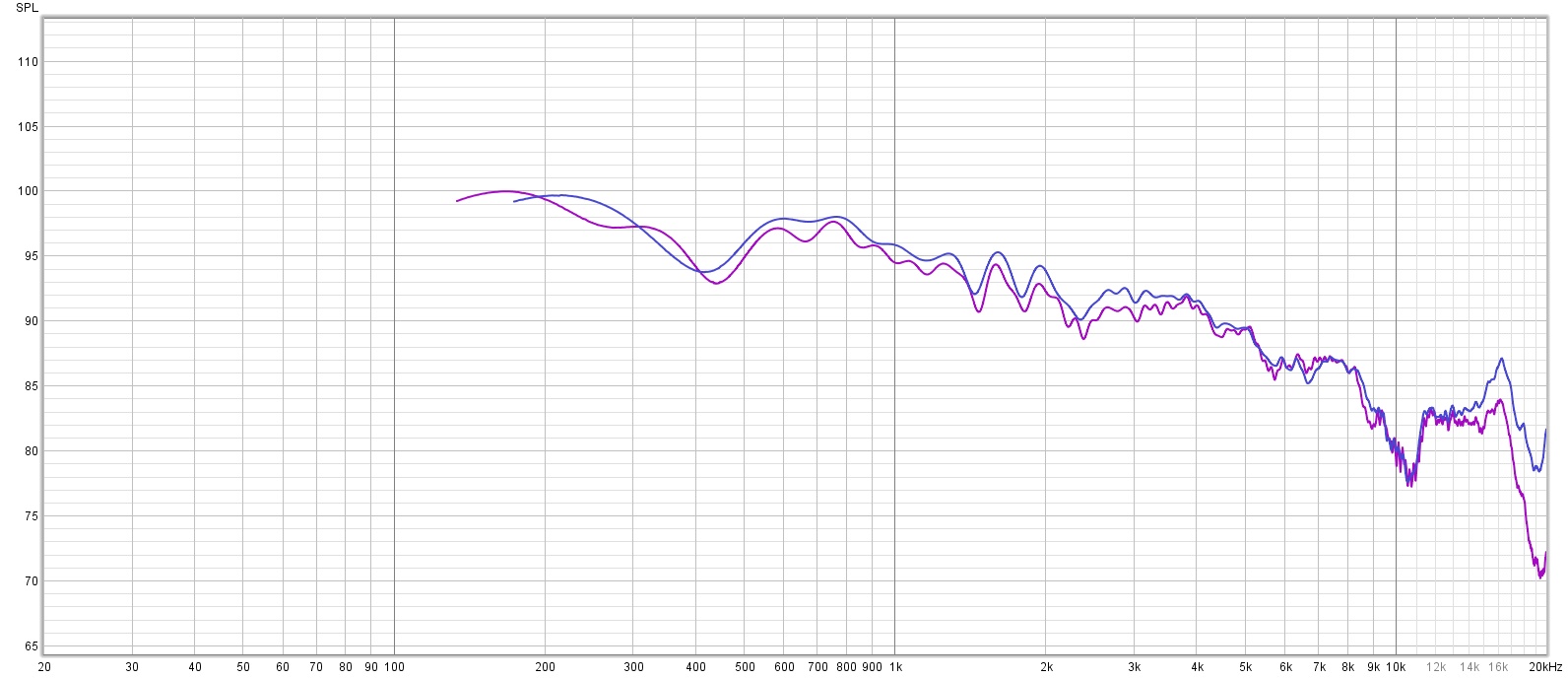

I think i know why I have issues with these(RS225-4 & RS100-8) this is sweep today. Even with inverted RS100 still drops like a tone of bricks. Went over Xo 5 times and its all the correct layout.

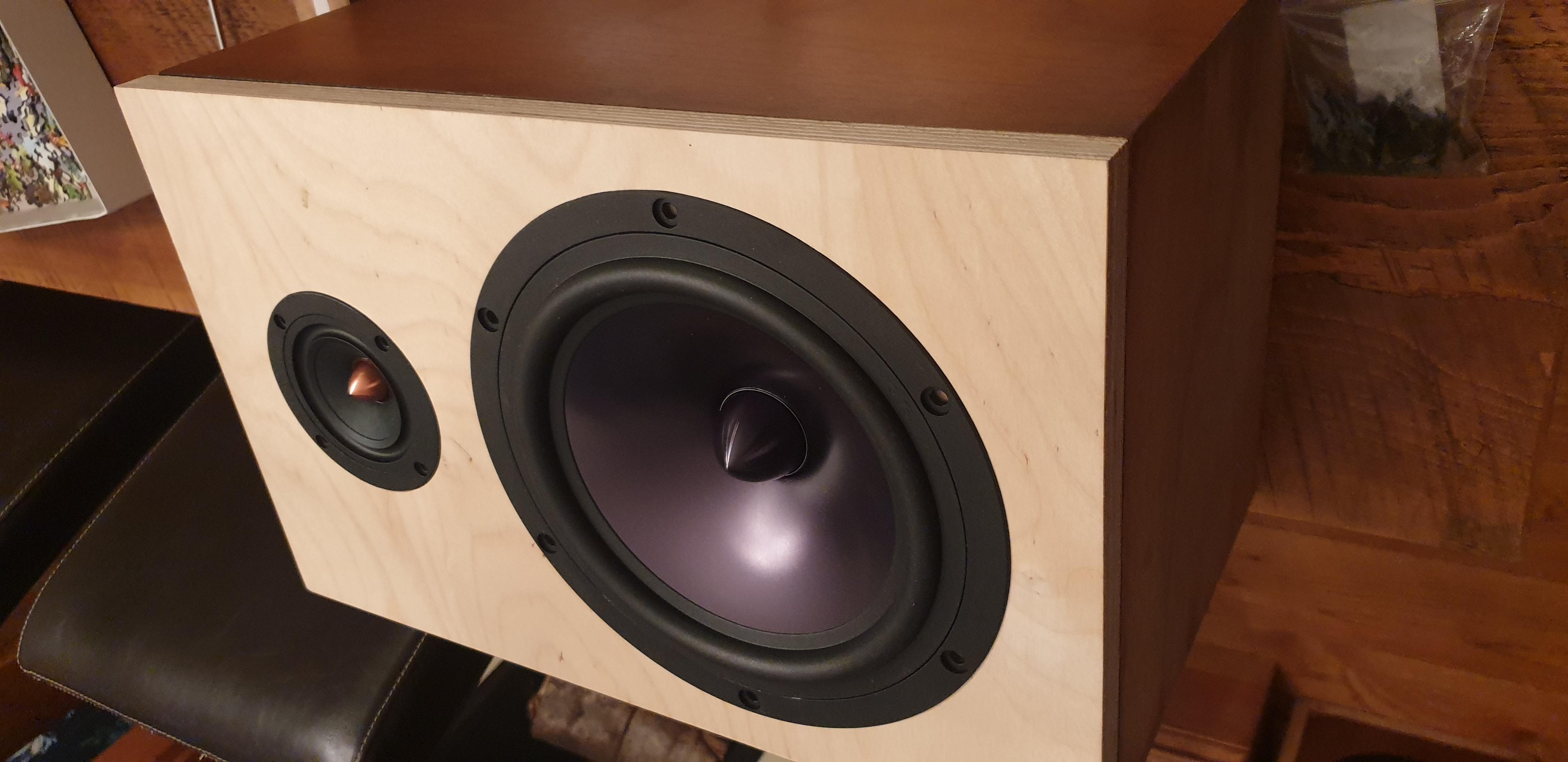

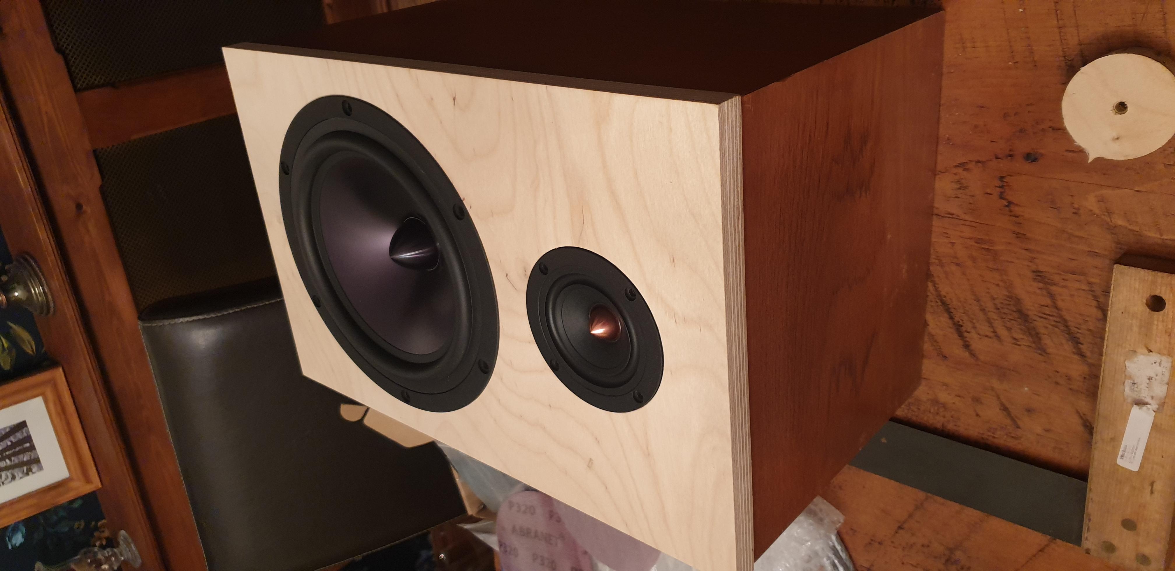

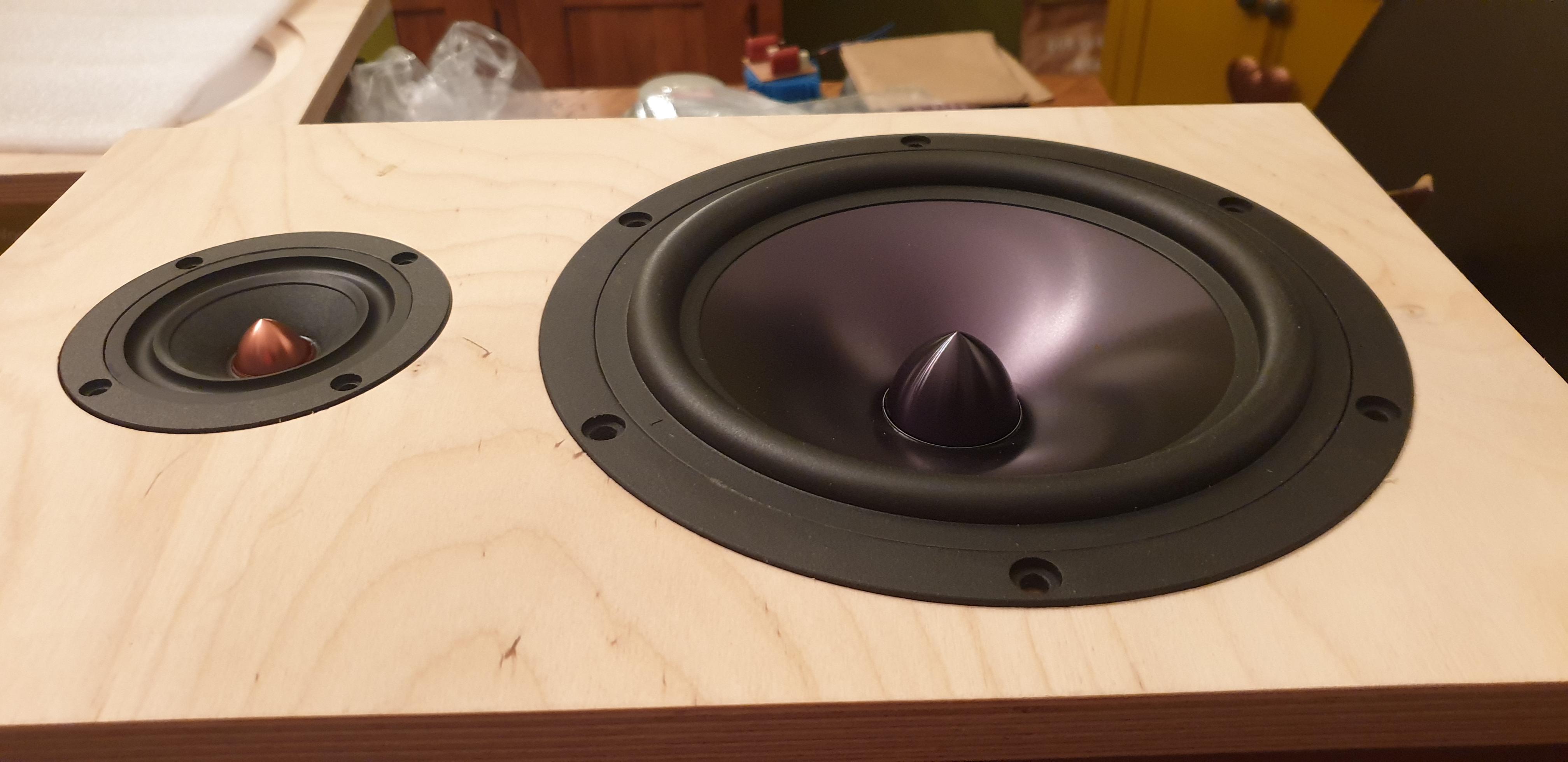

A bit more work done on my 'compact' versions. ...work on the baffles. 18mm BB ply that a kindly neighbour cut to size as I lack decent tools for straight edges. And so spent a good few hours myself routing the holes, rebates and driver breathing chamfer on the back side....although the 225 looked like it would have been ok so I just made a small chamfer thru 360deg.
First proper baffle I have made and boy isn't it time consuming! Learnt a lot though and the cheap Chinese circle jig worked a treat.
I got one of the rebates for a 225 the tiniest amount under size and so the driver is a little push fit. It makes you realise once you have the main hole cut out that there isn't much you can do about that afterwards so it did make me think!
Just deciding on how to mount the baffle. Was going to use rubber well nuts but I didn't leave myself enough of the old baffle left and I don't really want to add any more wood back in there as it will swallow volume . So I may just end up with some beefy screws along with my rubber sealing strip. Once I have drilled the mounting holes I shall round over the corners
And the wife seems to think they look OK too!
