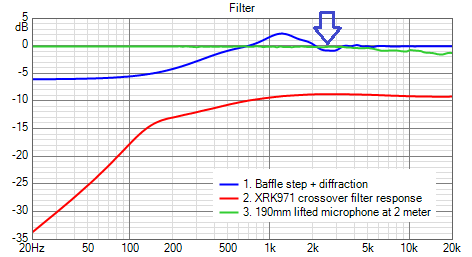

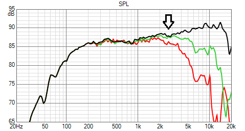

Thank you, Byrtt! Is that dip at 2.7khz supposed to be caused by baffle diffraction? I think the falloff below 1kHz with my xo is shallower than shown?
656204d1515700364-10f-8424-rs225-8-fast-ref-monitor-xrk971-10f-rs225-fast-freq-jpg
Thank you, Byrtt! Is that dip at 2.7khz supposed to be caused by baffle diffraction?...
Welcome and right its baffle diffraction but also 10F have inherent same spot little dip in factory curve that adds up, real world diffraction will dynamic move around little bit with distance and angle, in model used on axis at 2 meter and for dimension eye balled dirty quick baffle dimension to be 240mm x 480mm..

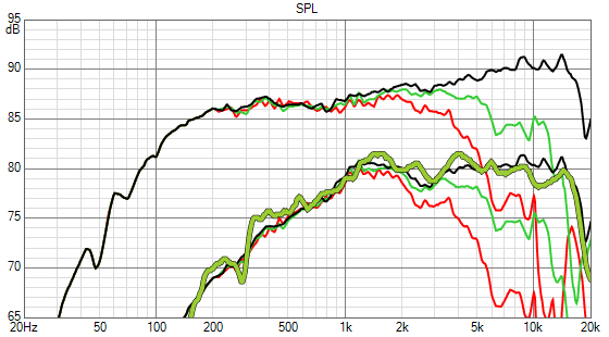

...I think the falloff below 1kHz with my xo is shallower than shown?

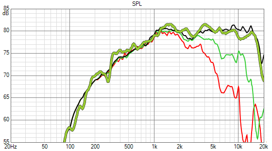

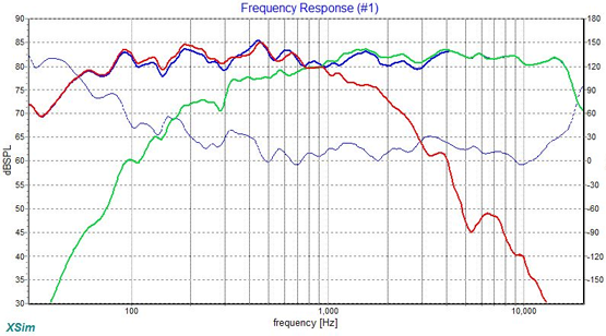

Think its known problem for interpreting X/Y scale ratios in graphs in there are no standards, so often many strech as wide as possible because it kind of interpollate graph to look bit nicer 🙂 plus yours is cut at 30 Hz where mine cover 20Hz and follow ratios as in SS broshures because it resolute the small bits, overlaid yours to mine below..
attachment.php
attachment.php

Here is some modeled visuals using datasheet curve and probably why it goes relative more flat, the three effects modeled are graphed and listed below plus their summing filter effect..
Static plot of datasheet curves with overlaid sum of filtered model..
Animation of the three filter effcts normalized in SPL to target curve..
Well, I did ask what the mechanism was for achieving a flat response. I never expect such detail. Thank you very much indeed!

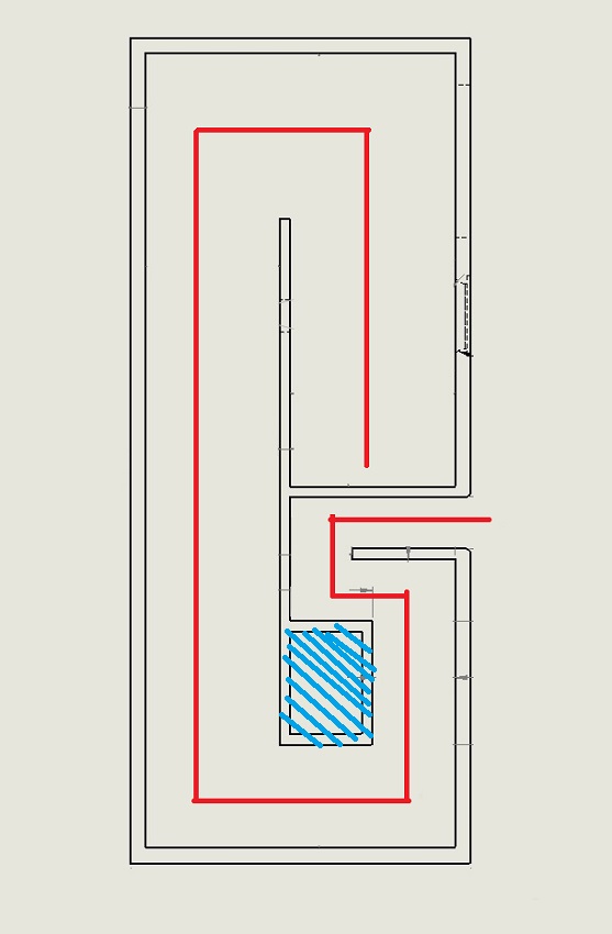

Sorry, should have made the thicknesses more clear. The 5 oak pieces (top/bot/back/both sides) will be 3/4" total thickness w/ a 1/2" BB 1/4" split. The interior structure will be 3/4" as per the standard design. Hope the following image helps, didn't post it initially as I haven't 100% figured out the interior.
This is a cross sectional view, I know this will be a pain assembly wise but cuts are no effort with the CNC, only the stacking and alignment. On the upside it should be stiffer than the original. I'm still working on these sections to keep the port volume as true to the original as possible.
Let me know if I'm misunderstanding something, cheers

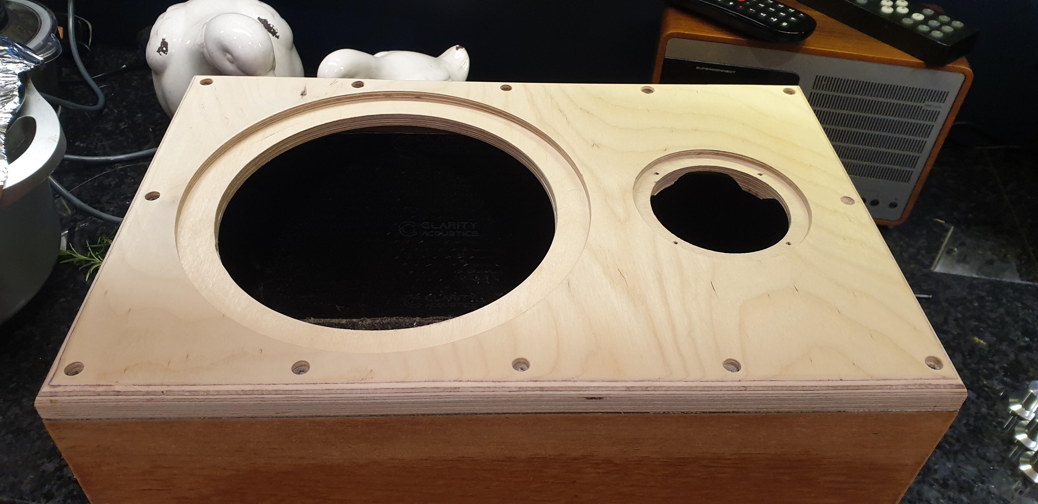

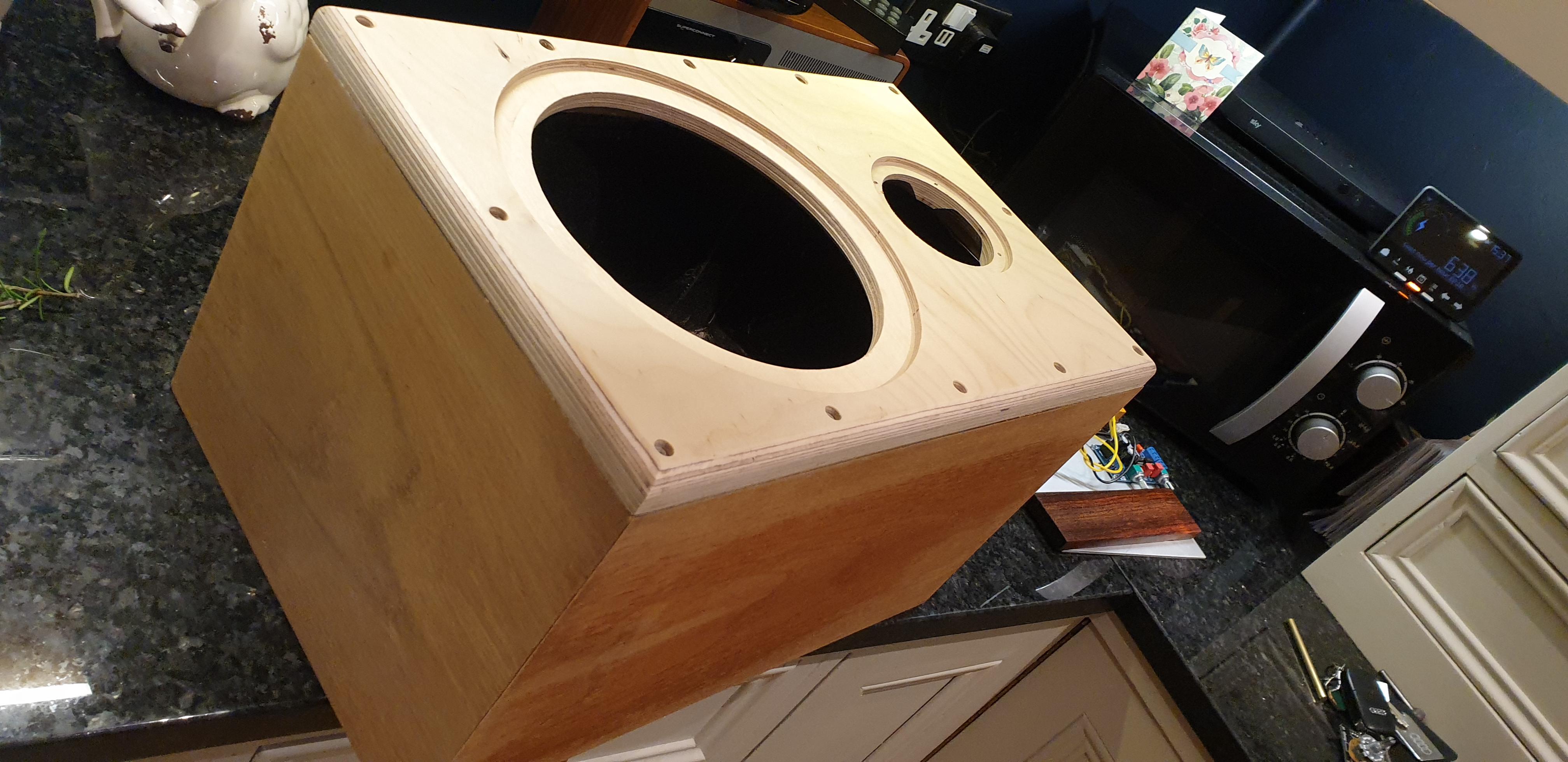

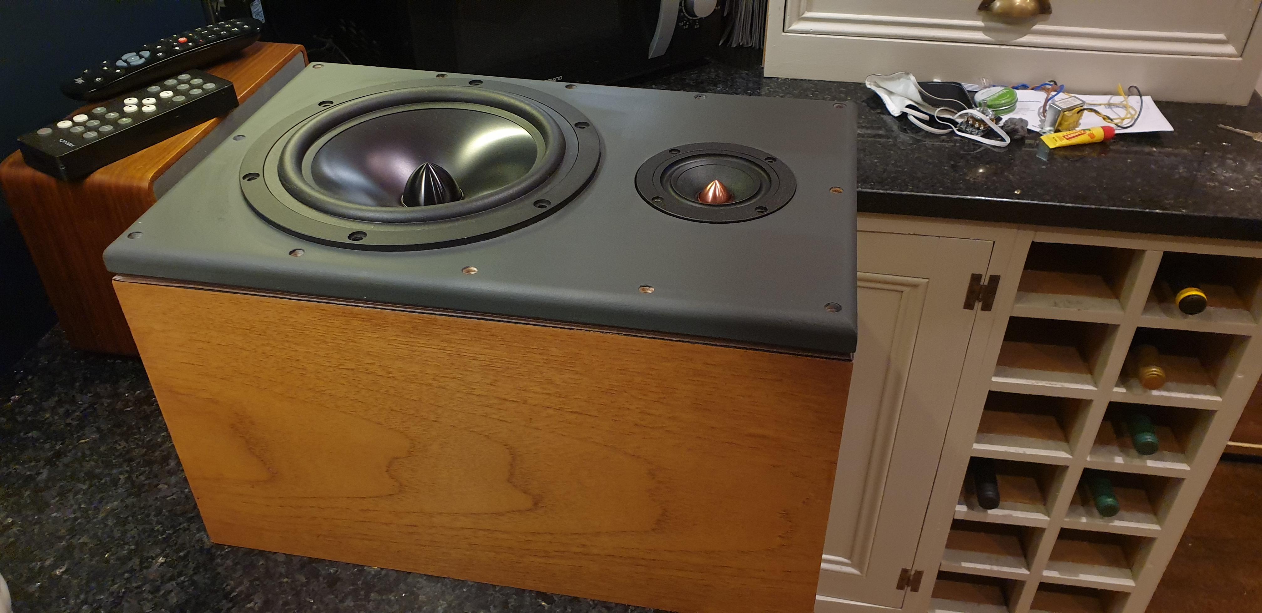

Slow but sure progress with my 'compact ' build. Spent more hours on the baffles. Drilling and counterboring and aligning the fixings in the box isnt easy....not without a pillar drill. And now I'm priming/sanding/priming to get a nice finish ready for the final paint coat.

Regarding the port in your 3D design, does the port area width of the rounded section become a bit smaller vs what it was when it was rectangular?
If yes, the the port area will become smaller and vs the original design, and at same length, will have lower tuning. Not what you want.
Yeah, currently it's a bit smaller (18.65in^2 vs 21.25in^2 on the original. I'm going to play around with offsets to make the volume/surface area the same. I believe if the volumes/area is the same, then the rounded corners should benefit vent noise to a small degree if I'm understanding this correctly.
Having messed around with the numbers super quickly, I should be able to get it to 21.15in^2 by increasing the width. This would also mean inlaying the stacked vent pieces into the sides which would far more accurate construction.
Alternatively, increasing the height of my vent from 2.5" to 2.87" would result in 21.25in^2 vent area. Would increasing the height have much effect?
Annoyingly have done my woofer rebates a little too tight...bugger!
Spent a good while trying to get a good finish on the baffles which I have now done. Using a gloss roller with water based emulsion. It marks easily though so I may wax it.
Now how to relieve the cutouts a bit.!
