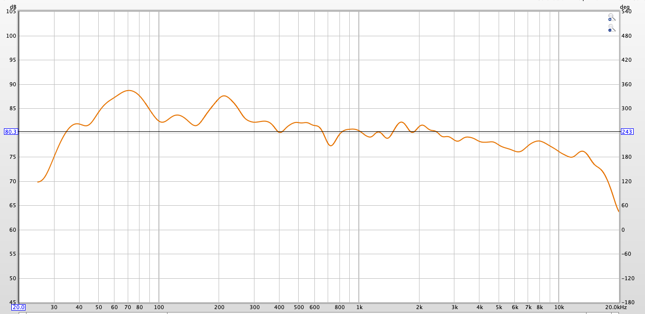

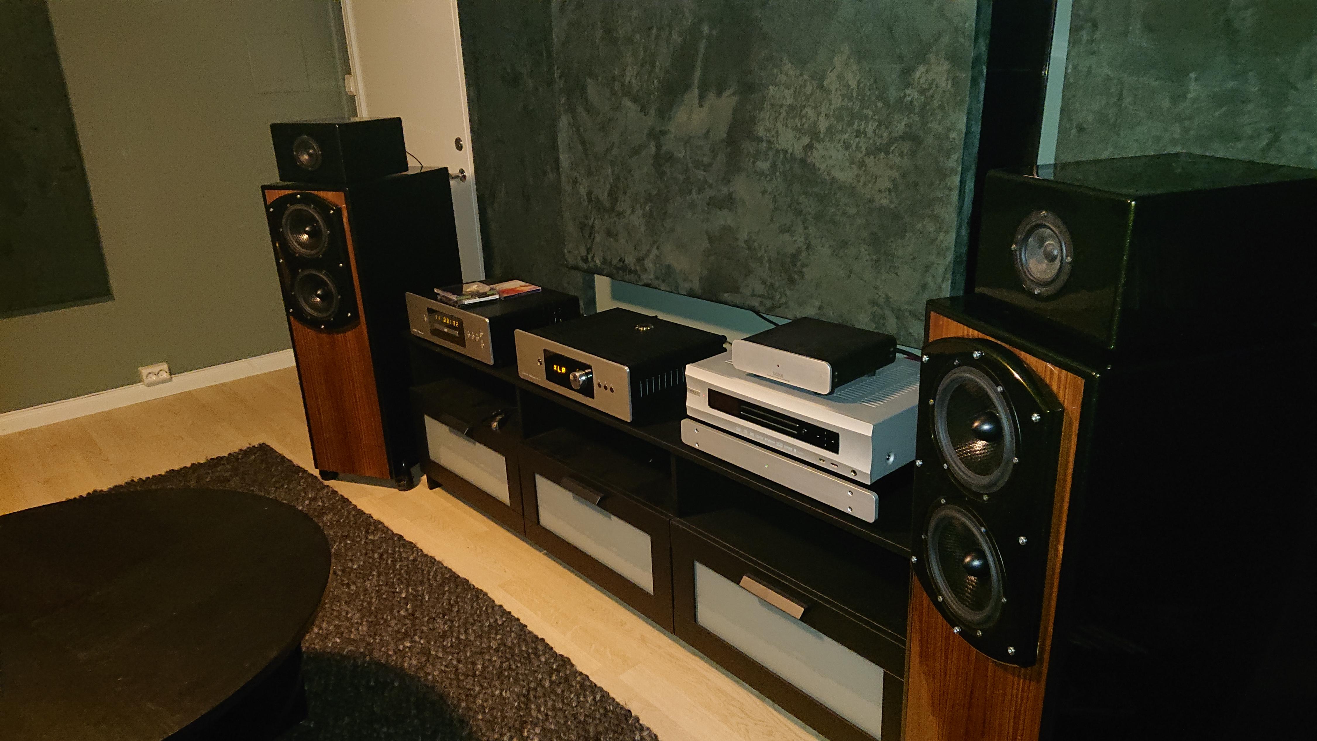

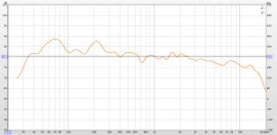

So, I've been experimenting with a MLTL version similar to the one in this thread, adapted to my driver, and I have been testing with a lot of drivers, mainly the B80, SB65, SB10, TC9 and even some ceramic and ribbon tweets.
Funnily enough, the one that meshed the best with the least amount of tinkering is the TC9. Plus, it sounded great, too.
So, if one wants to try X's design, but doesn't want to shell the big bucks for a 10F driver, the TC9 is a very clean and snappy driver alternative that would not disappoint. It performs way beyond its price point.
I really like my other drivers, and some perform better in certain circumstances, but in this design, it was just so easy to integrate the TC9 with the MLTL that it made it a no brainer.
The peaks at 70 and 210 are room nodes... didn't bother to move the enclosures so much, more interested in the meshing between the woofer and the TC9. Still need to tweak the XO, but came up with this within 15 min of tinkering, so can only get better with a little more time spent on it.

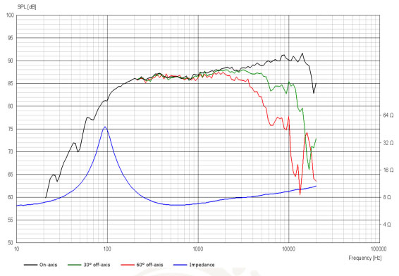

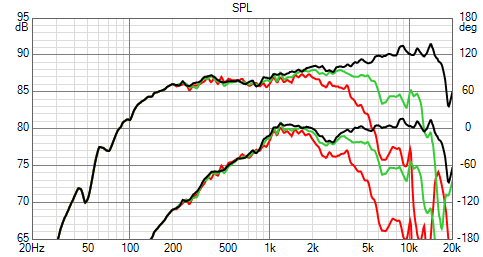

I’ve been following this thread over the years, and I would like to thank everyone for making it so interesting and informative.
There is one thing, however, that I’m not able to get my head around. I’m hoping that someone can help out. Here is the issue:

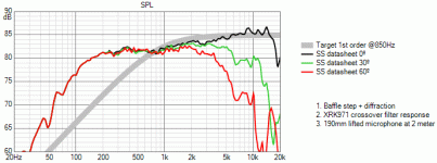

If you look at the frequency response graph that the manufacturer publishes for the 10F, you will notice a steadily rising output from about 900 Hz. And yet the frequency response measurements in this thread show no such rise — the response stays more or less flat. I may have missed something, but I seem to recall that no equalisation has been applied in the implementations described here. If that is indeed the case, what is the mechanism by which the response of the driver is flattened? Just trying to understand the physics behind it all.
There is a cap and resistor around the 10f (2.2uf and 10 ohm).
That sends some of the hf to ground.
See the schematic on post #1
Ah, ok, thanks for this.
So the crossover circuit is also behaving as a fixed "tone control," as it were. Interesting.
(Forgive me, I have long since forgotten what I once knew about electric networks.)
Also, the speaker is designed around the woofer axis as the principal direction. Mic measurements of the 10F at woofer axis is slightly off axis and this reduces the effect of the rise too. That is listening height dependent but I suggest placing woofer axis at or slightly below ear level.
Or, I suppose, one could place the 10F at ear height but don't toe-in the speakers to face the listening position.
No, you want the woofer at ear height to get the proper time delay for the transient perfect aspect of this speaker. Else I would have placed the 10F on top and not below the woofer.

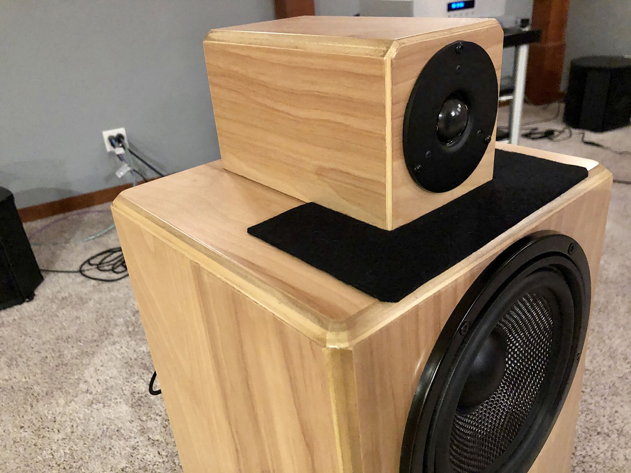

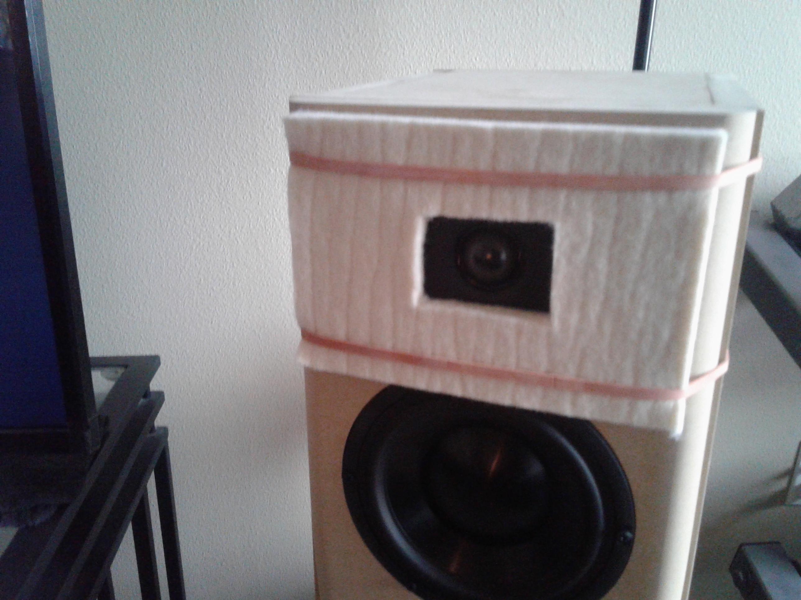

Add 1" felt around 10f and cover top of rs225 box, may sound even better.
Worked well with my dome tweet, not sure with a 3.5" driver, try a bunched up towel first ?
Nsmt does this (i think) in the model 100 speakers.
Model 100
Model 100

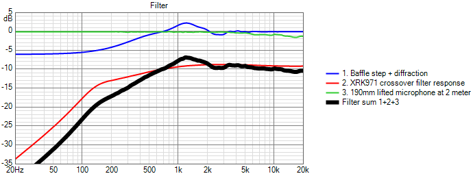

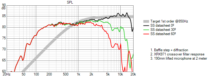

Here is some modeled visuals using datasheet curve and probably why it goes relative more flat, the three effects modeled are graphed and listed below plus their summing filter effect..Understood. Thanks!
Static plot of datasheet curves with overlaid sum of filtered model..
Animation of the three filter effcts normalized in SPL to target curve..
