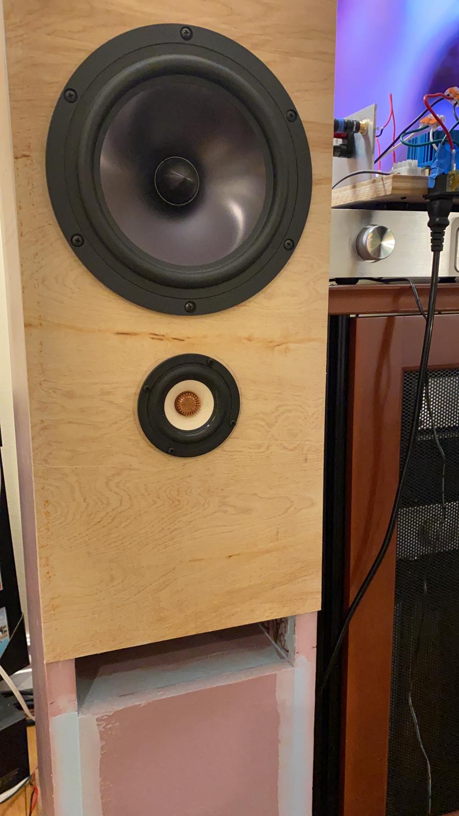

Hi X, I would like to build your speaker (the TL version) but I need to keep the overall height at 35 inches. Do you think there's a way to fold the line differently? What are the constraints that I need to stick on?
You can be creative and fold just keep total length and cross sectional area (vs length) the same. To reduce the height by 5in is tricky as the bottom 90deg turns occupy 5in. perhaps have the line folded back up and out with the terminus forward above the woofer.

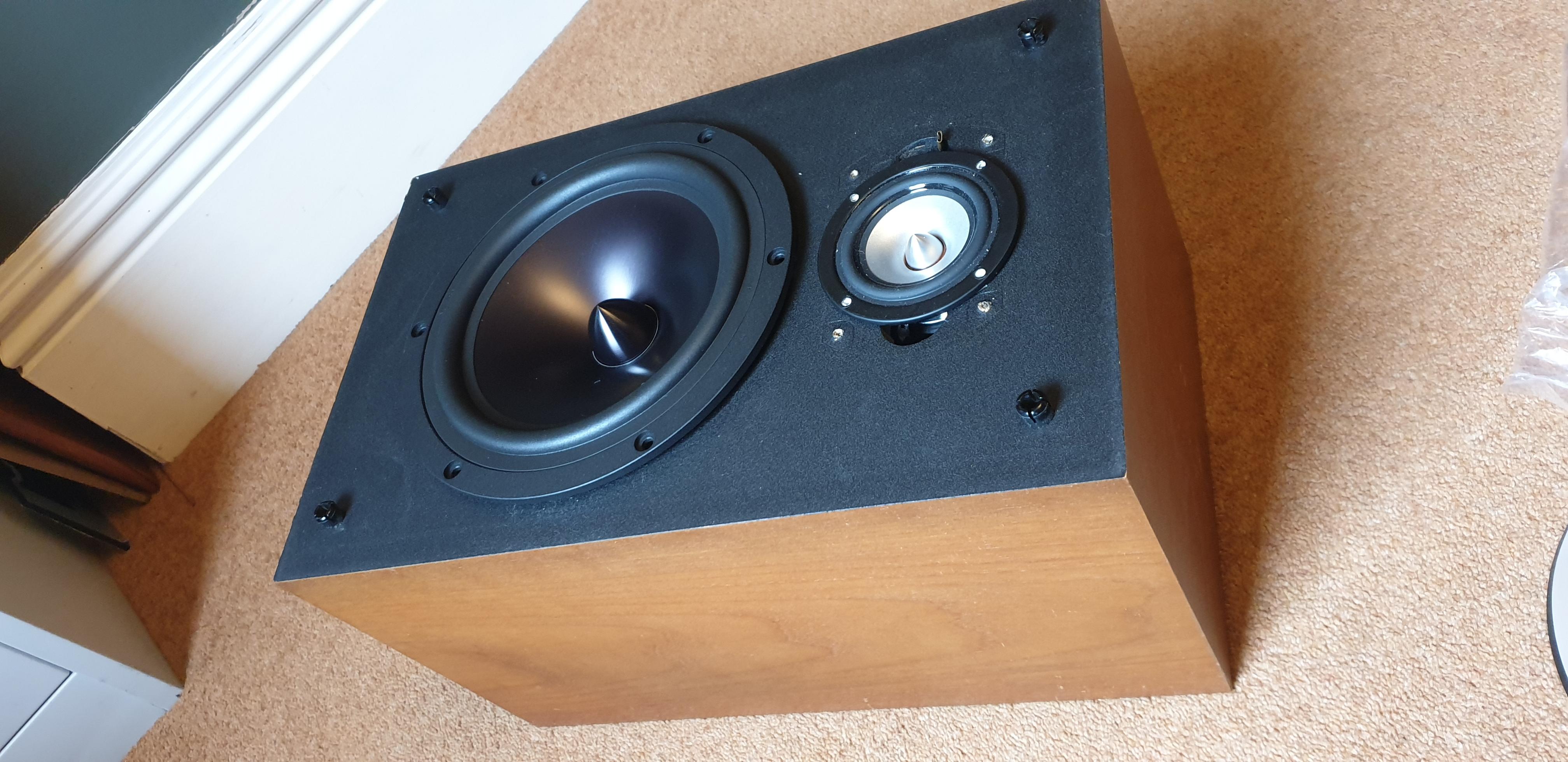

So i just threw them at the enclosure i have in mind and offered up the W3-871. I shall make some kind of 'super' baffle to deal with the cutouts and flush cuts. Pity to lose this nice black finish though!
Interesting how the RS225-8 seem quite benign to the enclosure volume whilst simming in winisd..to a degree obviously. The response from 23 litres down to 17 litres doesn't change all too much. The Q value also remains sensible.
I know i am deviating from XRKs original beautiful design but I do have my constraints so we shall see how my bastardised version develops!

Looks promising Jimk04! Maybe you have found a more compact version of this speaker. Make sure the Tangband has its own Dagger rear chamber or a sports cone sealed off from the woofer. It looks nice.
It turns out that a Tang Band W3-1878 is almost a drop-in swap, size wise relative to the ScanSpeak 10F. On paper, it’s about 1dB more sensitive. Vunce is trying it out now so we will have to wait for a report on how well it may or may not integrate with the stock XO.
I think I may try my 3fe22 first. I was bowled over by them when I built my very first super simple diy FR speaker and so it makes sense. I have 3fe22 and W3-871 here to try so its a no brainer for me! I would like some PS95-8 though from as aesthetic point of view.

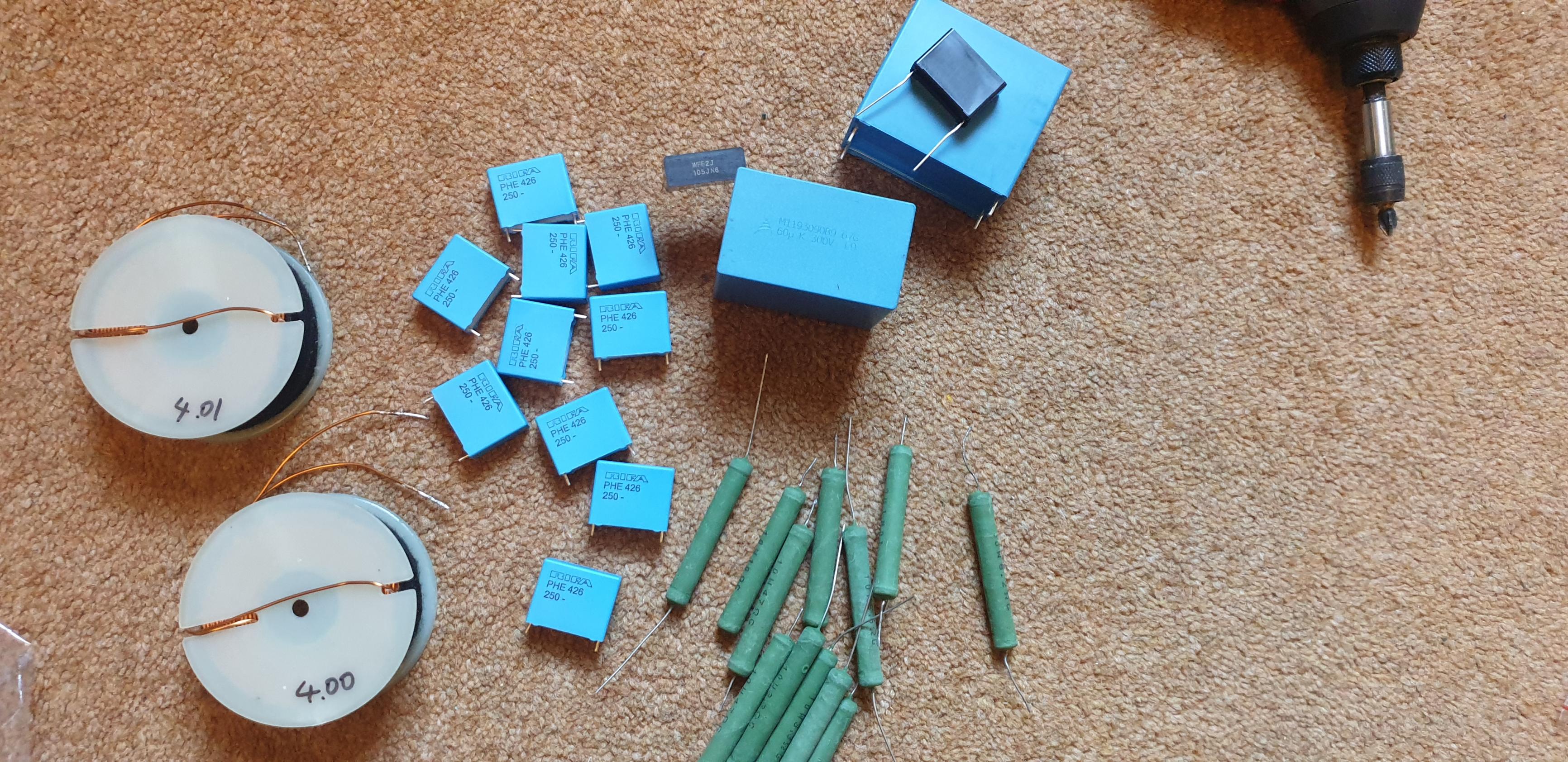

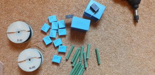

I have the crossover components now and I am busy trying to sort baffles etc.
