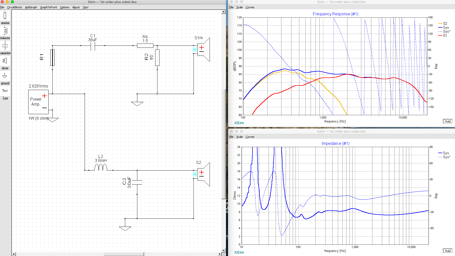

I use the 8ohm version. Although a XO was designed for 4ohm version at someone’s request by scaling (2mH vs 4mH for the low pass, etc.). I have not personally verified it works to my standards. If you are looking for more sensitivity, it would seem like 91dB at 2.83v is better, but I think that’s 2w (2.83v into 4ohms) vs 1w (2.83v into 8ohms). You will also need a 4ohm capable amp. Amp power is cheap - a 50w or 75w amp is plenty for this speaker.

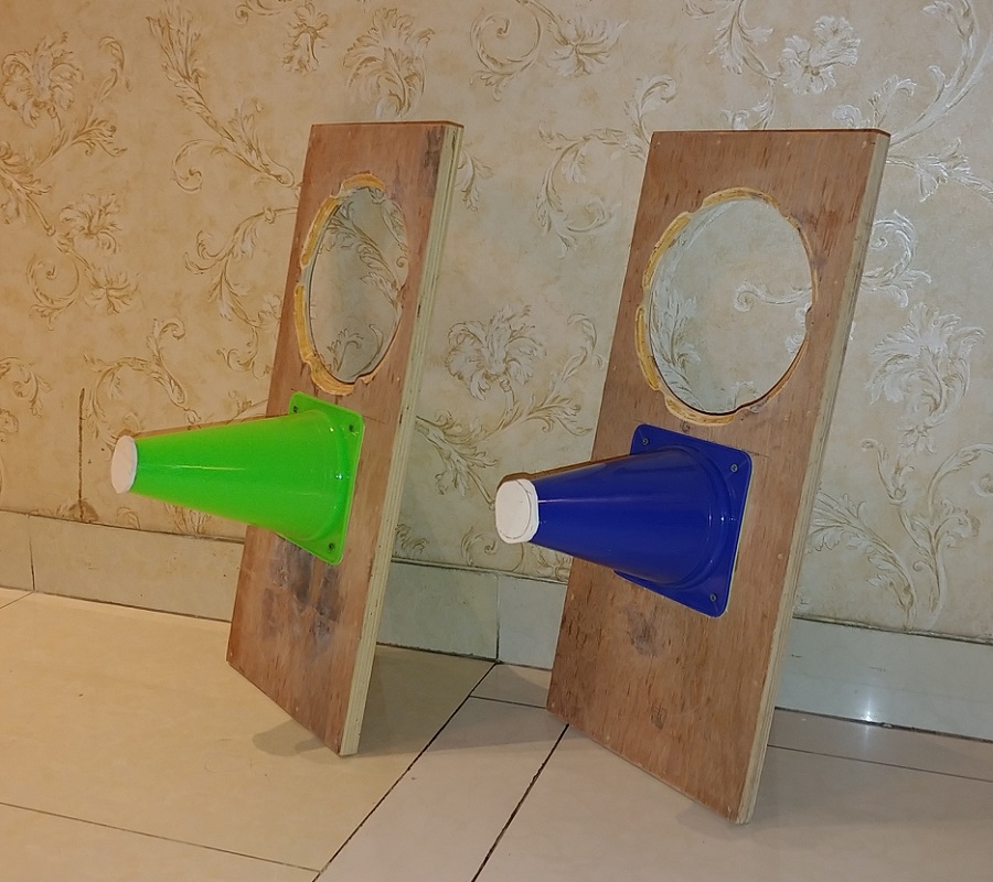

I apologise if this has been covered but I am new to speaker building and had a couple basic questions. I am looking at a B80 build due to cost. This would be my first build, so I'm finding it a little more complicated to follow than just buying a kit. That said, go big or go home..
I have seen at least one design using a sports cone, it seems it would save some time. What size is recommended? I see the initial post mentions 1.1L for the dagger. A perfect 9" cone with 5" base is just shy of a liter if my math isn't off, so I would think a regular 9" sports cone might be approximately close enough (since these are all essentially slightly larger comes truncated rather than a sharp point)? Does it require any reinforcement or is stuffing it sufficient? Would it make sense to wrap in dynamat or similar?

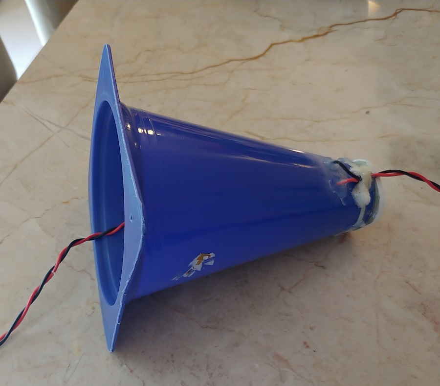

I recently finished my build, and used 9" sports cones for that. I actually cut 1.5" off the narrow end of the cones, so that I did not have to make a hole in the divider panel. Even after cutting off the small piece, the volume was around a liter.
And I used a Visaton B80 as the mid-tweeter - probably the first xrk971 RS225 FAST TL build with the B80. :)
Here you go with a couple of pics.

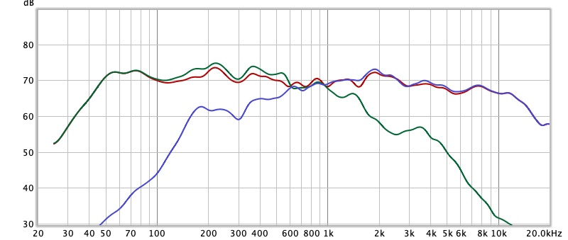

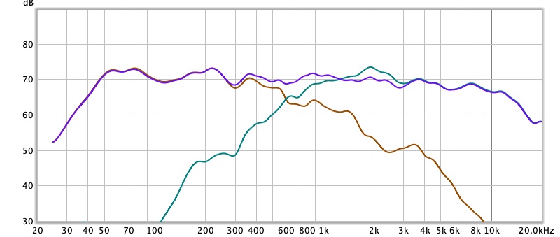

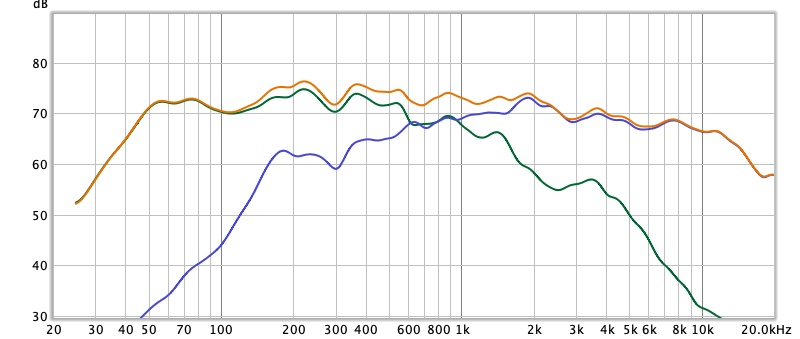

I've been using XSim to simulate XOs but today, I decided to try on a more hands on approach.
Enter the miniDSP 2x4HD. And started to play with some curves.
Ultimately, I should say, I want this to be a passive design.
So, started with something easy, 1st order, LP@400Hz - HP@500Hz.
I got this.
attachment.php
So, phase is wrong using two simple 1st order, and yep, if I invert the FR, I get them to sum up, but way too much
attachment.php

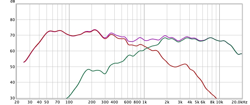

Changing my mind, I figured I coud mix curves, so tried a few things and ended up with a 1st order LP@200 and a 2nd order HP@800. sounds weird but with the FR inverted, they sum up ok.
attachment.php
The B80 has a hump at 1800Hz, and I really don't like that, so adding a little notch cleans it up.
attachment.php

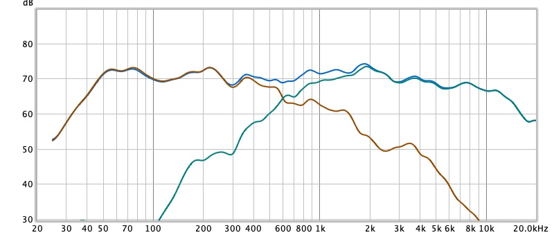

But, I was hoping to work with the drivers responses instead of adding extra notches, so, I went back to 1st order and tried to conceal two bumps, one from the woofer and one from the FR.
Ended with the extreme LP@200 and HP@3,000 ! Both 1st order.
It does look good while looking at the FR, but it crosses at 1,100Hz, which is a big no-no for many people, being in that sensitive hearing range.
Since they are 1st order and do not have big phase inversions around that 1;1kHz, I don't really hear anything troubling though, when playing some music, in mono... wondering if playing a stereo setup would make it worse.
Here's what it looks:
attachment.php
I guess I still have work to do.
At least, it was fun not just clicking things in XSim, but the more hands on miniDSP approach was kinda refreshing and turned boredom into something fun.

Founder of XSA-Labs
Joined 2012
Hi Perceval,
Try adding time delay to get the acoustic centers matched. You can check what this needs to be by measuring all three combos (W, T, W+T) and adjusting delay to the T (or full range) until the interferogram predicted in Xsim matches the measured W+T. This is necessary for any Xsim crossover simulation in any event. In miniDSP, simply add delay to simulate physical off set of the drivers. Tweeter will need to move back usually at least 3in or more. That should get the phase to sum flat.

With DSP there is no need to physically displace the drivers - they can all be on a flat baffle, unless you are trying to aim the vertical polars for the bestsweet spot. In which case it is helpful to have the woofer on top.
The tests are with DSP, but I want this to be passive.
If I put the woofer on top, then the FR is at ear level with the height of the enclosure. Placing the woofer below puts the FR above ear level, the inverted version of your transient perfect placement.
Can dsp do .1ms ?
If 1mS is around 1', then 3" would be .25ms ?
miniDSP can from 0, in 0.1 increment.
I time align the drivers when I put a 2.2ms delay... which is weird as the mic is at woofer level, so the path to the FR is longer, but it doesn't happen in the measurements.

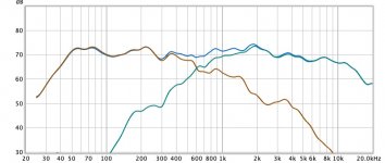

Hi zman,
I tried to do a search in this thread about the B80, but I think the search function is broken, and it says no find!
May I ask which XO you used with the B80? I'm trying not to have a small peak between 1-2kHz but it is giving me problems...
Had a quick go, tried the B80 and RS225 XO as mentioned, but it was very wobbly.
Decided to keep the B80 almost as is (had no need for the Nobel there), and went 2nd order for the SBA 5x8.
The wiggles in the impedance is the lack of bracing and vibration from the XPS enclosure, which was done rather quickly as a test. Should clean out just fine with a real enclosure.
