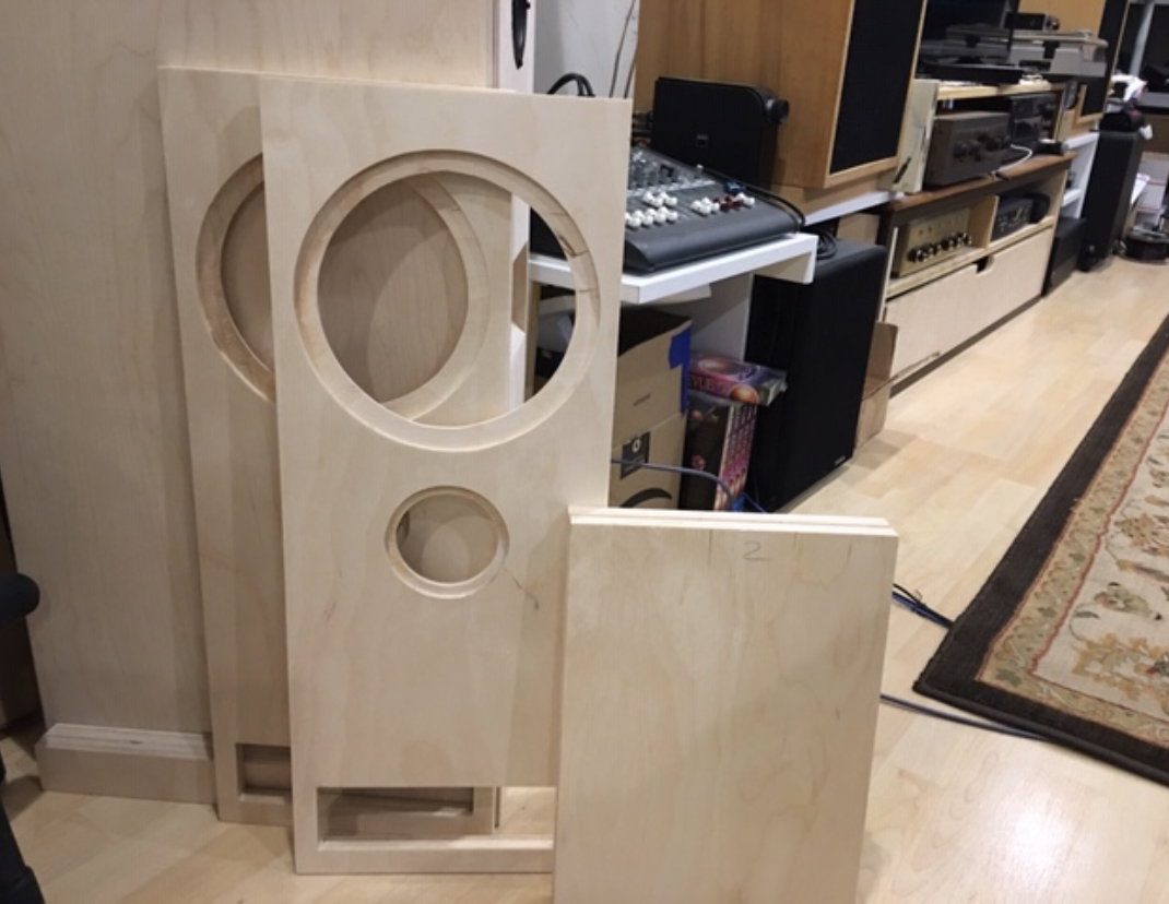

No, swapping the fullrange with RS28F and waveguide. Although it’s not easy because the TL does not have a removable baffle. I could do it on the sealed version as I have spare baffles for that one. In hindsight, the baffle of the TL should have been removable also. Vunce is building his with a removable baffle made by my cabinet maker.

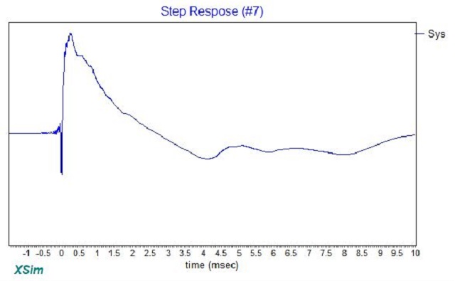

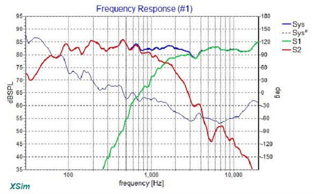

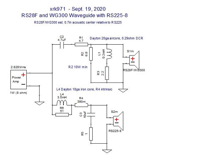

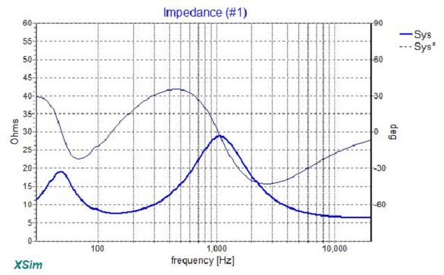

Just for fun, since I have the FRD and ZMA files already for the RS28F-WG300, and the RS225-8 (but in different speakers), I decided to see what they might look like together. The RS28F loaded in a waveguide can be crossed pretty low at 1.5kHz and I wanted to cross a little lower to take the hand-off from the RS225 as it is 8in and will start to beam if we cross too high. With just a few minor tweaks to the existing crossover PCB, this can be accommodated and it actually looks really good. I don't know how I did it, but both drivers are positive polarity and the phase shift is very flat and smooth - almost dare I say it, transient perfect? If we look at the step response, it exhibits a nice right trinagle shape with a negative overshoot on the tweeter leading edge. When I flip the polarity of the tweeter, it has a deep null at exactly 1.5kHz, so I suspect that this is just no more than a time-aligned 2nd order crossover. The impedance never dips lower than 6ohms and is reasonable behaved with a smooth peak near 1.1kHz that is at abou 30ohms.
This might be a worthwhile speaker to try out - and if you put the RS225 into the TL, bang! A great sounding speaker, I predict.
Here is the new XO design:
attachment.php
Here is the predicted frequency response and acoustic phase:

Here is the predicted electrical impedance:
attachment.php
Here is the predicted step response:
attachment.php
Any takers? 🙂

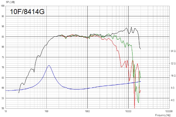

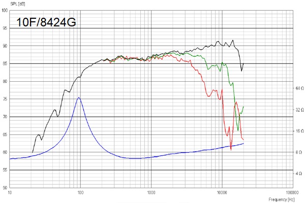

xrk971 or anyone,
This question may have answered before but there are so many pages here it would be time consuming to hunt through all the discussions.
8ohms Version
Discovery 10F/8424G or 10F/8414G
What is main differences between these 2 drivers, it appears 8424G costs 30% more and why?
I suppose similarly for the 4 ohms 10F/4424G and 4414G, Does a 4414G exist?
Thanks for your help.

Thanks, Zman. You probably won’t hear a difference just tiny bit less sensitive so maybe make R1 4.2ohms vs 4.7ohms, etc. - adjust to taste.
It’s more expensive because of larger magnet and ability to be used in smaller chamber. But that’s not an issue here. It’s a tad bit smoother maybe.
I would get 8414 if you had a chance to try.
