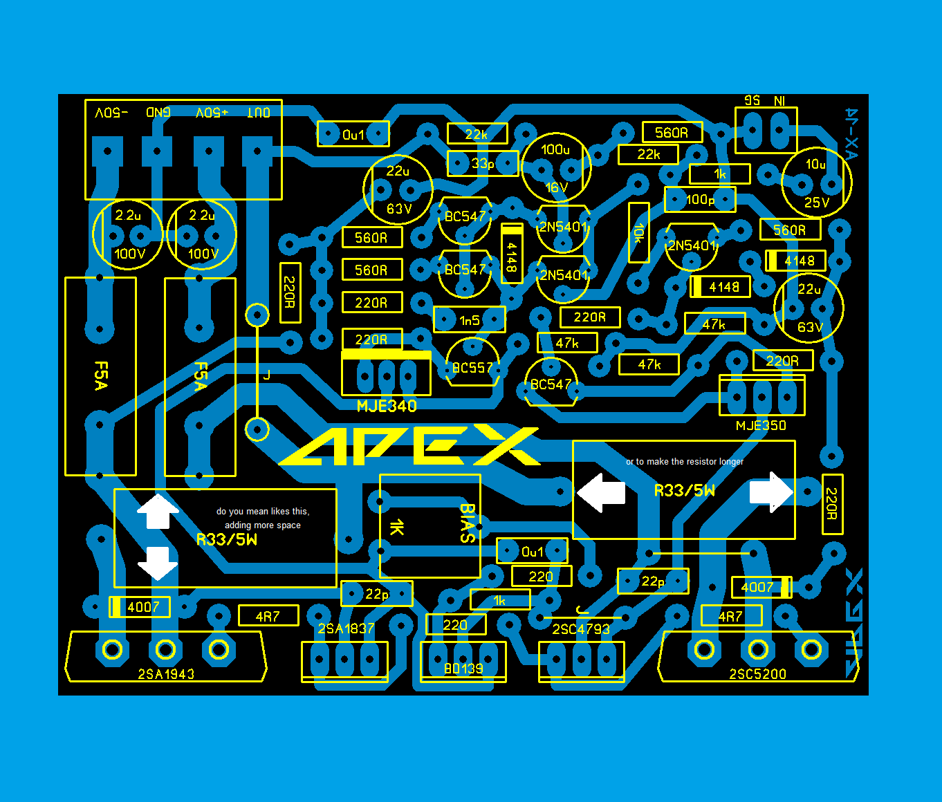

I like you AX-14 model and I want it to try it so I copy the layout and save it here is well I hope there are no errors lol. also the file if some one want it to look at it here is, and the software I use is Sprint Layout 5.0.

Hi Juan,

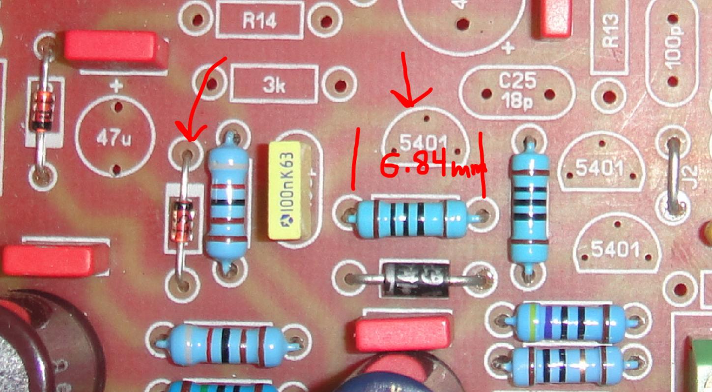

Very nice PCB. Do you have the bottom layout? Can you make the resistor spacing wider so it can accomodate Vishay RN60 series resistors.
Thanks.
Rey
Well I'll check let see do you mean make the resistor longer or wider? I'm a bit confuse here lol. 😀 you mean the 5W ones? the R33 5W silkscreen is 22MM x 9.52MM size

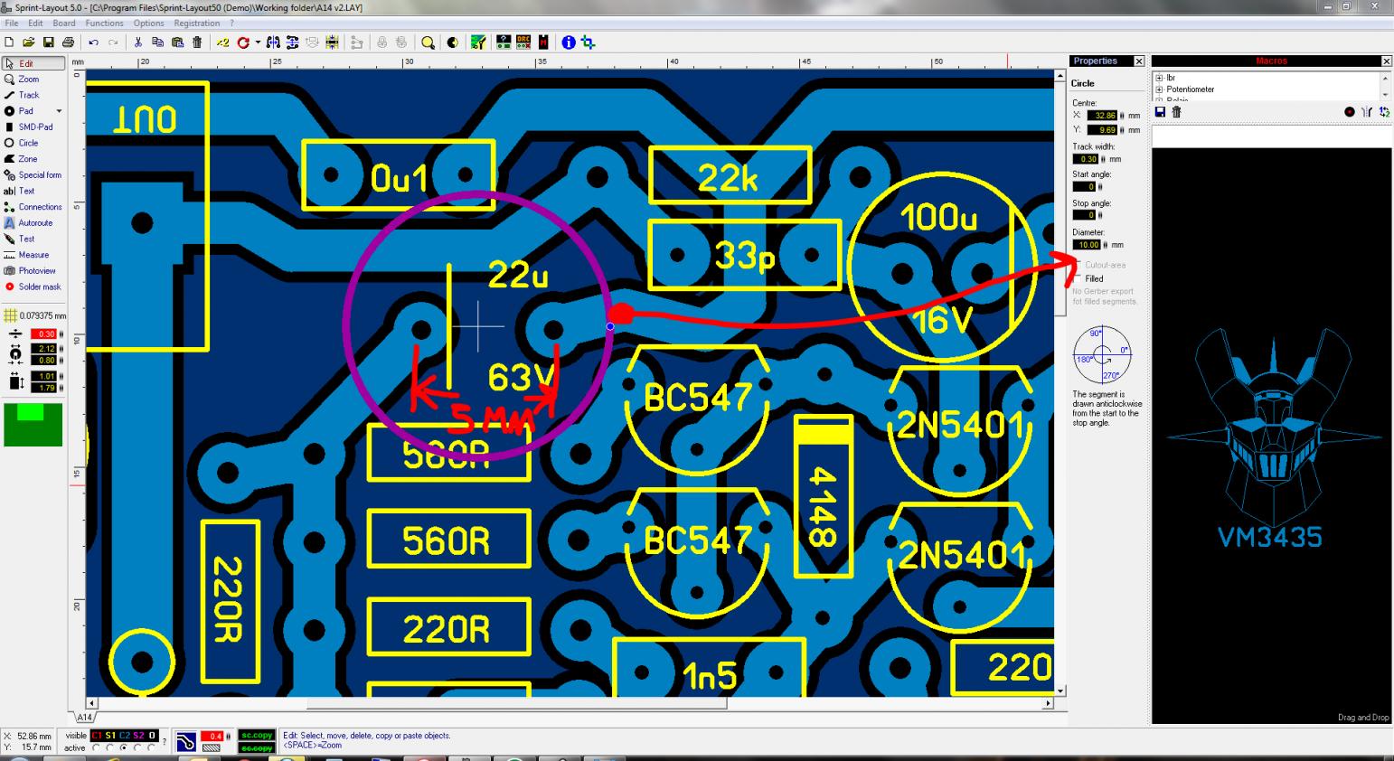

I was referring to 1/4w resistor with L=10.8mm and W=3.68mm. The present PCB it is to tight to be accommodated. Also the elco it's to small can we increase it to 8-10mm. Thanks.

OMG! I guess I have to check pith distance of components and sizes ok this is going to take some time as soon I got I posted.

I have made my AX-14 before you have shown your design but I like your design and I know you can do something to accommodate the parts I like to use. If you can make the revision of the PCB I will try it with my parts. I will also try to replace the elco input with film of lower value and see the difference in sound.

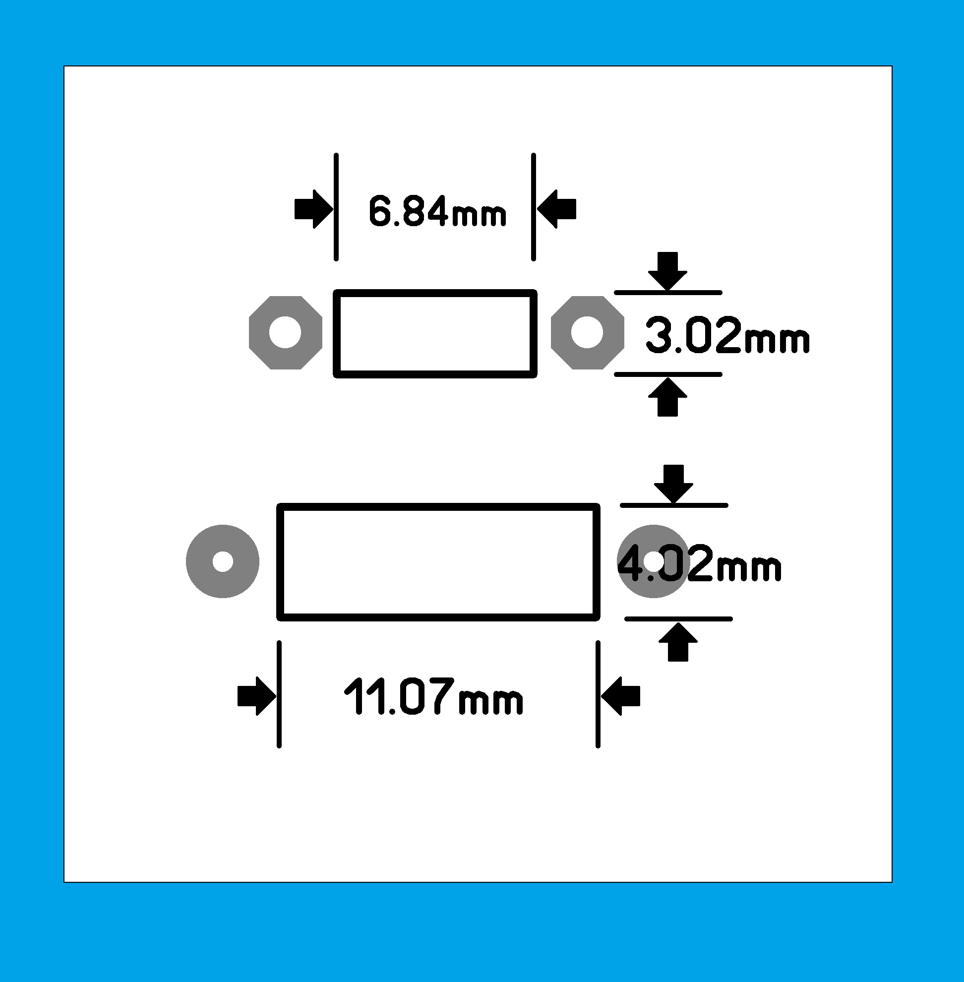

I did this one today not sure
:scratch: I came out with this idea not sure still undecided, I think the resistor size is too big is about L-11.07mm W=4.02mm the first resistor is the one I use on my first board for other projects. the size of the resistor made the board grow so I didn't like that much I will try later to see if a came out with something better. maybe I need a :drink: weeeeeujuuuuuuuuuu!
2.2uF 100V 8mm diameter
22uF 63V 10mm diameter
100uF 16V 8mm diameter
10uF 8mm diameter

sorry, board sizes is 100mm width and 102mm height all the 1/4 watts resistors have that measurements L=11.07mm x 4.02mm that is why look so different.

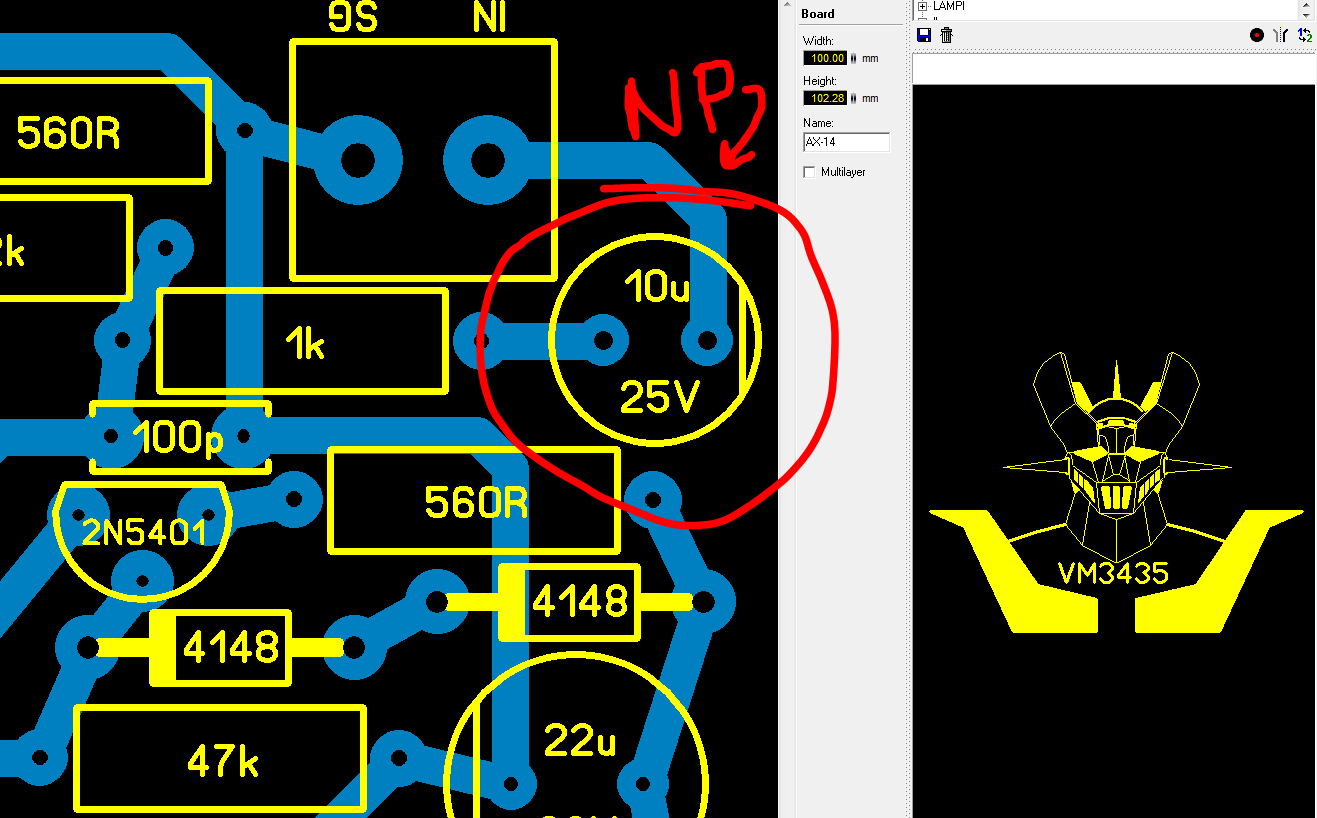

I think it is already good but can you still adjust the 10uf input capacitor to accommodate up to 10mm pitch for film capacitor as suggested by AndrewT.

10uF 10MM pitch
Sure I can my friend it doesn't bother me at all just give me some time and I will make the caps for the 10uF input 10mm pitch to see how it looks, alright then.
that 10uF cap is suppose to be NP ?

Thank you for your time my friend. I decided to use Wima Capacitor 4.7uf 50V X 2 instead the 10uf elco. The dimension W=8.5 H=14 L=7.2 PCM=5mm. Is this possible?
