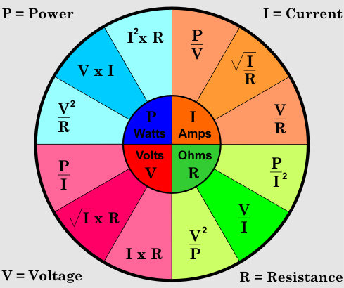

How about to measure corect bias Sir..?
Measure voltage on 0,22ohm resistor. I=U/R , 10mV on 0,22ohm is 45mA bias current across output transistors.
Great.... Thanks Mr Mile.... this is very useful info...
