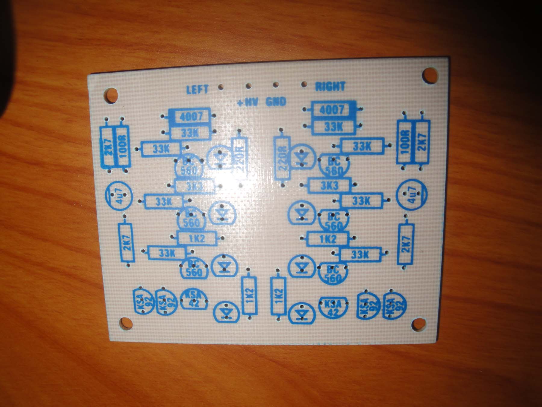

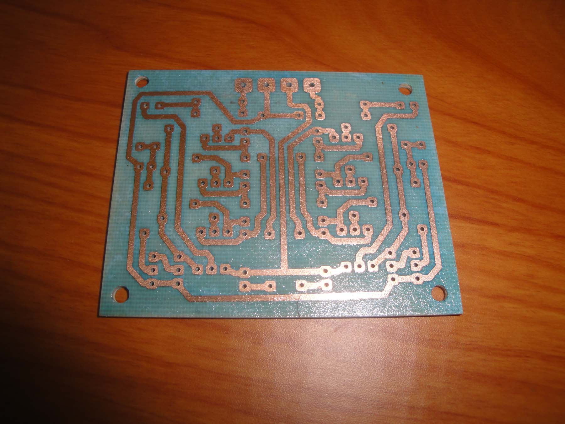

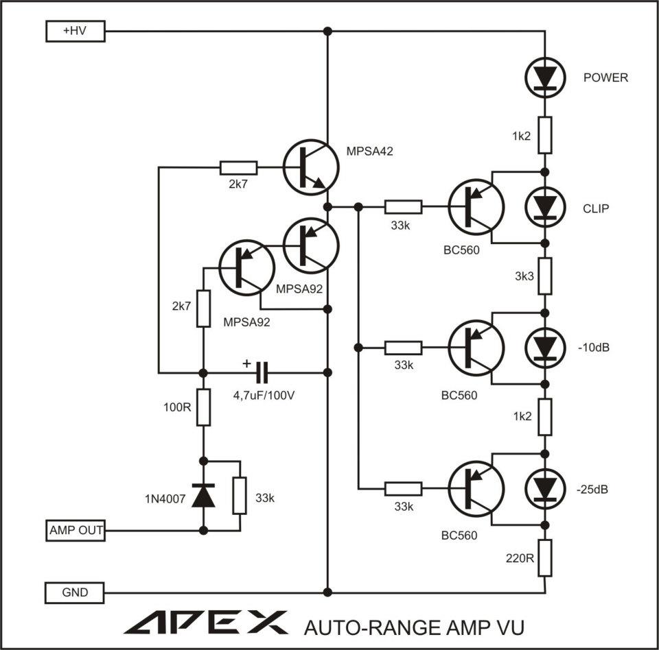

hi apex sir,
i connect the vu meter to ax14, the three lights permanently on. why is that.
supply voltage to the amp 50-0-50vdc.
here are some images.
Is this your PCB, there is another version with -HV suply.
yes ,this is the one.
Try VU without conections to amp out
amp is working fine, but the vu meter lights on.
here is the pcb image.
Measure voltages on transistors pins and post values.
No that's not the problem, connect input GND to PSU GND and offset will be about +/-10mV.
i got it sir its working thakn u sir. . .

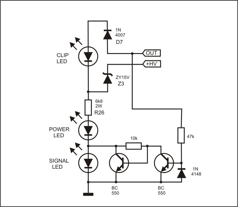

hi apex sir,
in this schematic bc550 used instead bc560. is this correct?
This cicuit work with any NPN transistor similar to BC550, BC560 is PNP and can't be used instead BC550.

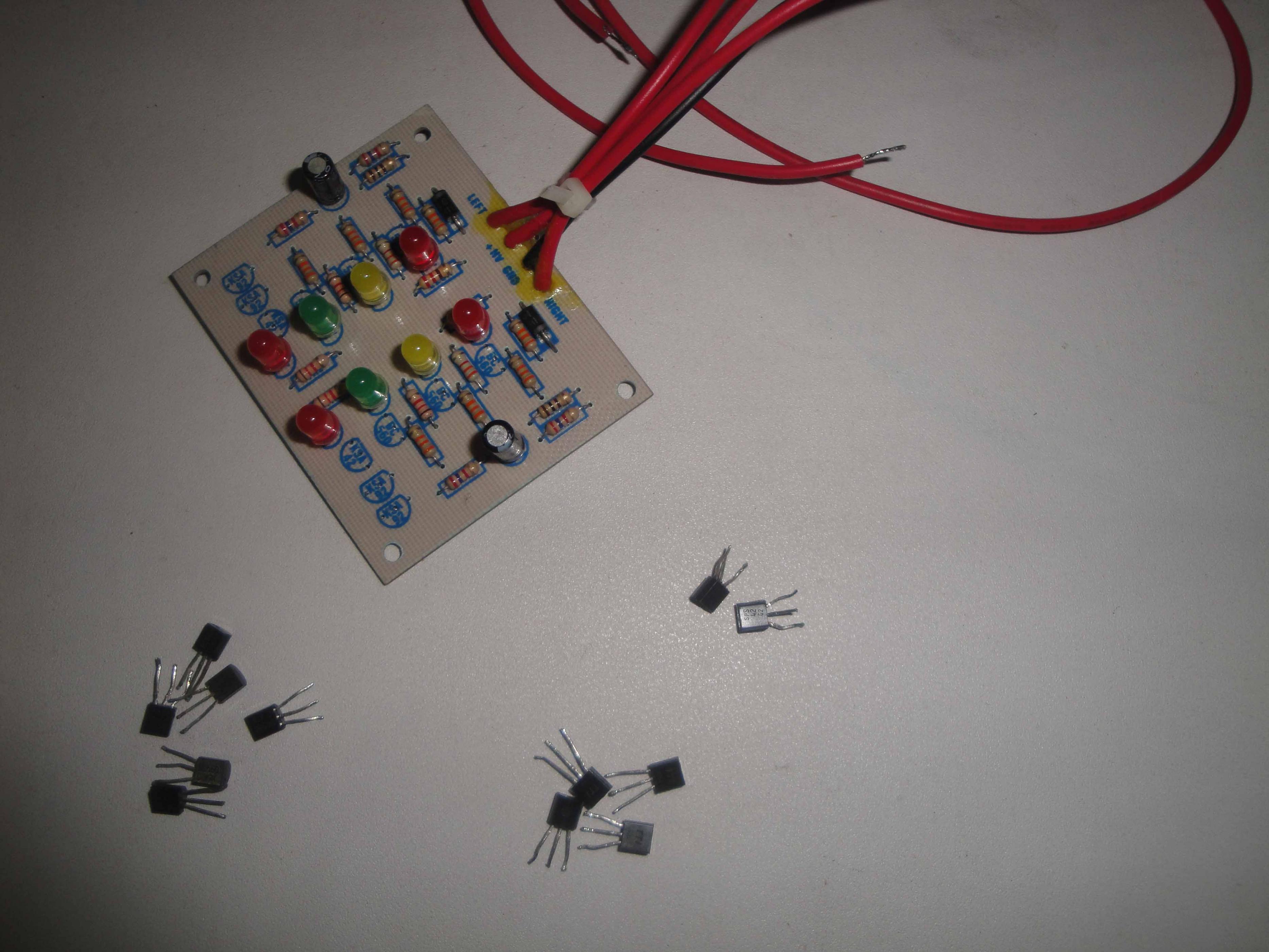

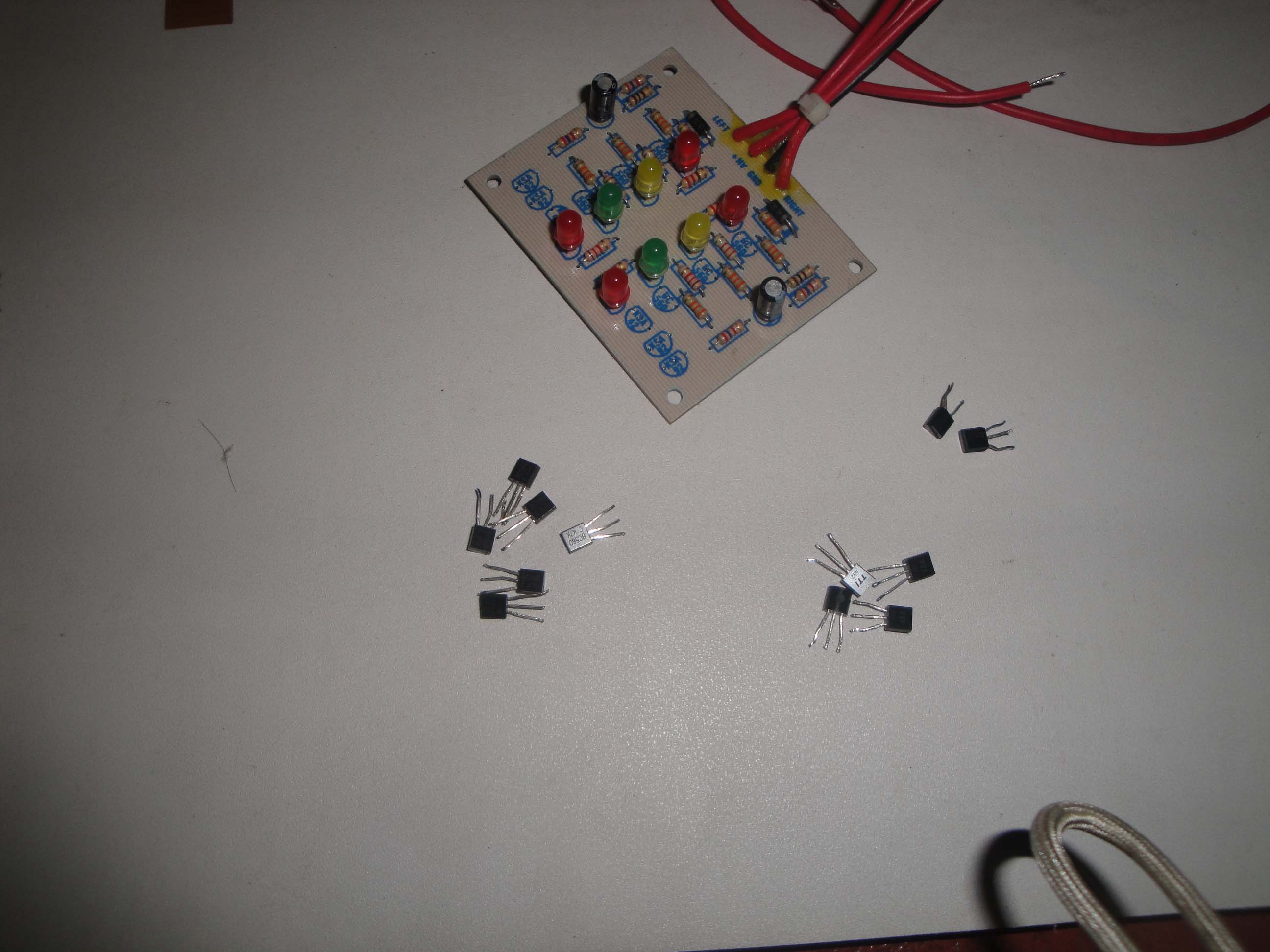

hi apex sir,
i remove all transistors and checked ,the transistors are good.
click the image to see large view, to see transistor numbers.
I need information about voltages on transistors pins in cicuit with suply.

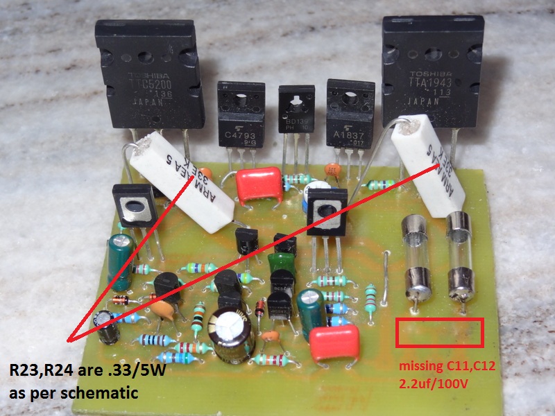

hello frineds AX-14 is working but i am getting noise in the music
Hi Sharavanth,
You need to post pictures as Apex said and measurement, if possible with wiring connection, otherwise unable to comment without posting your work, However see attached picture for correction, hope this will help.
what caps i need to use there
i have changed 33ohm to .33ohm amp is working but voice is not clear
What is bias current and dc offset on your amp?
