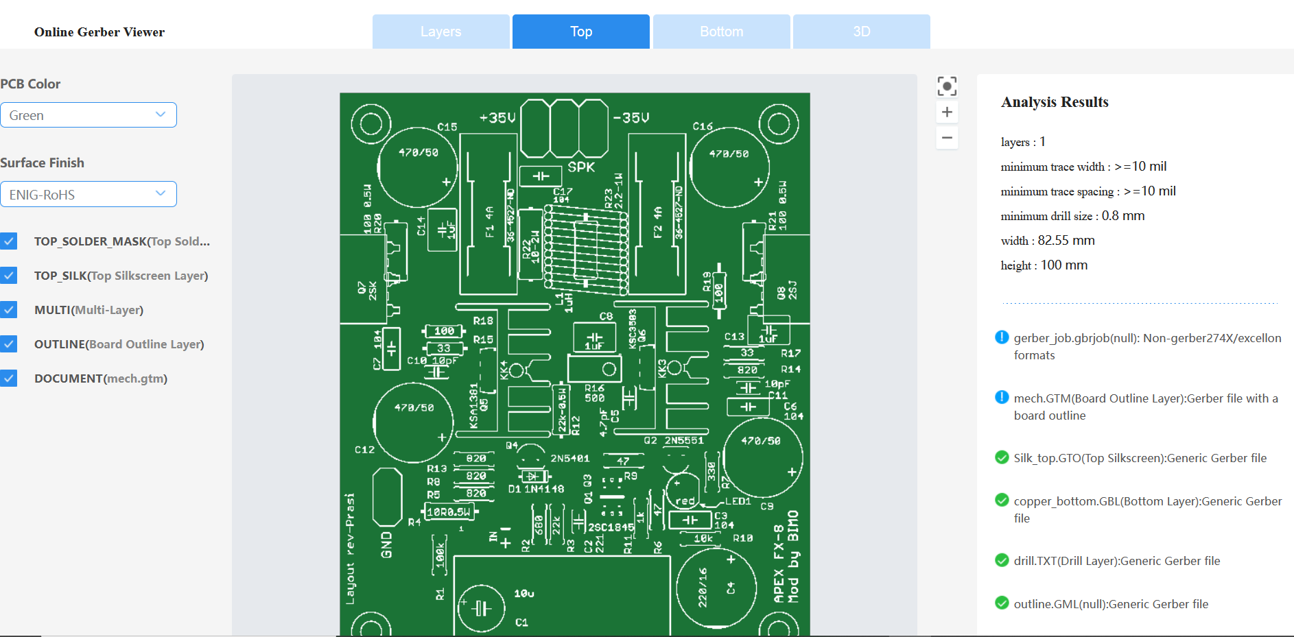

https://www.diyaudio.com/forums/solid-state/164093-100w-ultimate-fidelity-amplifier-post4686633.htmlFor some reason JLCPCB can't seem to figure out the gerber files from post #7150. (FX8 Bimo Mod.) It complains about non-standard gerbers, etc.
Could you please replot and post the gerber files so that we can try again with JLCPCB?

try with these gerbers, this should work.
Ok. Thank you.

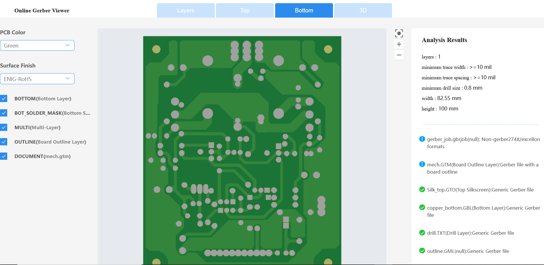

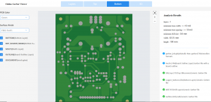

I uploaded those to JLCPCB (see attached) and in their gerber viewer I wonder if their software is having a problem with the drill holes? In the gerber viewer it looks like the drill holes are missing?
They changed gerber view. Not as good as ex one. I have checked gerber in ViewMate Pro and all is OK.
You can check also with gerber viewer placed here China PCB Manufacturer & Assembly - NextPCB
Just load them in any Gerber viewer like gerberlogix .
The holes are there;
may be a bug in their online rendering tool
