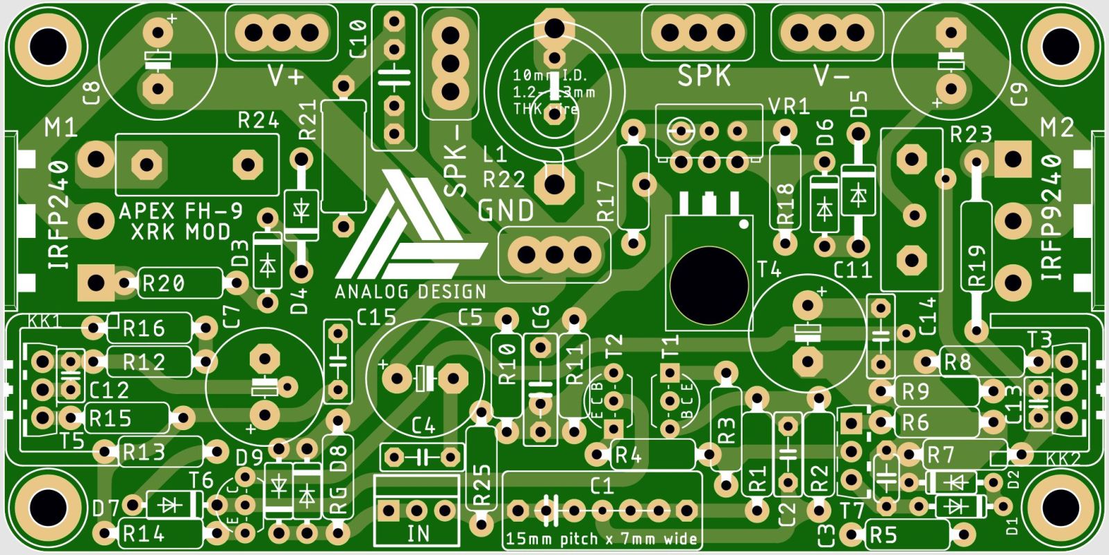

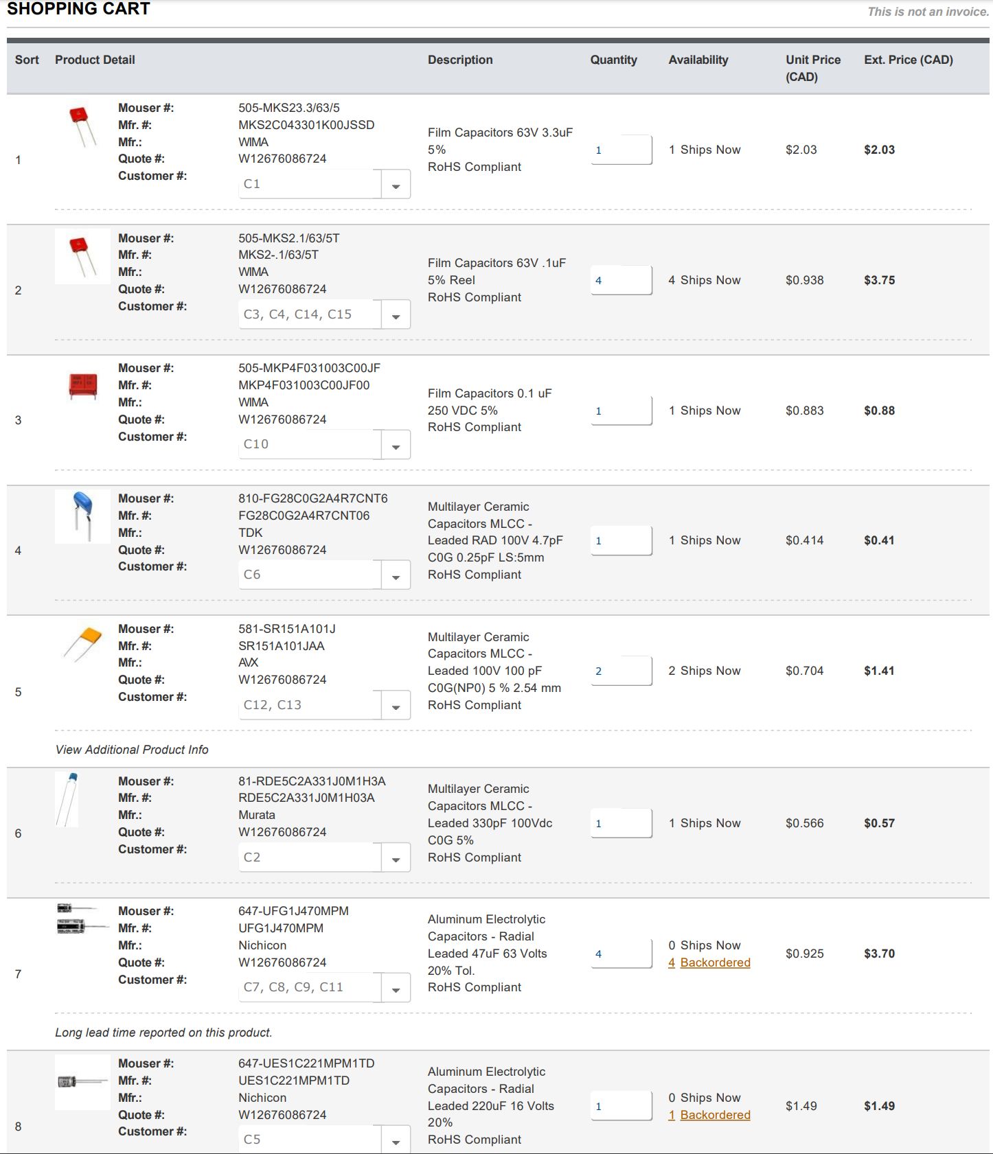

I was wondering if I could get some help choosing Caps for Prasi's Compact Apex FH-9 XRK Mod amplifier board?
The Nichicon electrolytic caps I wanted to use are on backorder for ever and I was wonder would would be good second or third choices?
As for the ceramic and film cap choices, they were just my best estimates based on what I have been reading around the site.
Any suggestions for better film and ceramic cap options?
Space restrictions are rather tight,

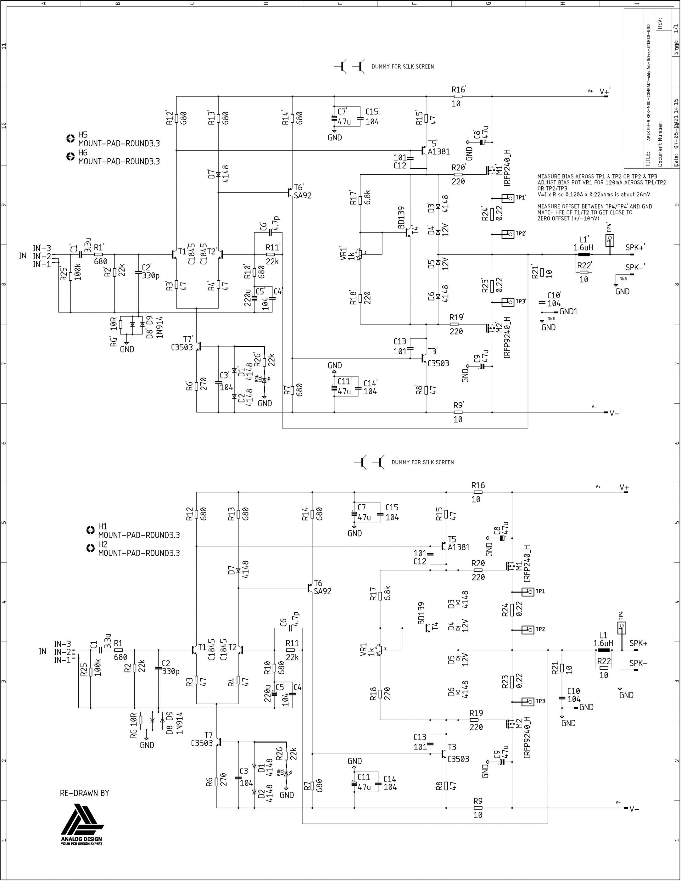

Schematic to see where they go,
If you want to see them on Mouser,
*** Here is a link to the cart ***
Also, either my sight is worse than I thought, or R26 resistor and the LED have been deleted from the compact board.
For the SMD caps C16 and C17 on the back of the board, what values are supposed to go there?
The KSC1845FTA seem to be sold out everywhere, is there a decent alternative?
Or do I just have to wait 6 months for them?
Thank you,
David.

Can someone confirm that schematic by prasi is the latest one and also suited for HV xrk version? Is there any impornat difference between them?
referring to this layout and sch , R26 and Led are indeed present.
100W Ultimate Fidelity Amplifier
100nf

As far as caps , except input cap of 3.3u, others can be general purpose film caps.
For electro, use good quality for C5, others caps can be from nichicon VR or similar
ceramic to be NP0/C0G 100V

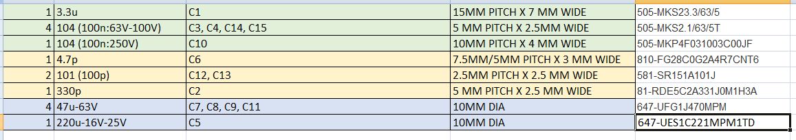

To the best of my knowledge there is no official BOM for Prasi's single channel Apex FH-9 XRK Mod amplifier board.
I have stumbled along and tried to make a BOM, but I am not sure about some of the caps...
Link to Mouser Cart
View attachment DaveFred Sept30-2021 Apex FH-9 XRK Mod Mouser BOM guess v0.1.pdf
Zipped Excel
View attachment DaveFred Sept30-2021 Apex FH-9 XRK Mod Mouser BOM guess v0.1.zip
I have the boards, just not the confidence in my picks to place the order and build them.
David.

David,
Thanks for posting your BOM - it looks like a great starting point. The PCBs I ordered came in so I was able to take some measurements (in inches first using a pair of calipers, then converted to mm, so perhaps not exact...) and most of the parts seem like good choices. There seem to be a couple missing / mislabeled resistors, and your chosen C5 was too small of a value, but perhaps we are looking at different versions of the schematic. One issue I did see was that the SMT resistors on your original BOM are too long for the solder pads on the rear of the PCB - I've added an updated link for these and a few other items in the attached BOM (see the "updated" sheet) and included Prasi's schematic which I was using as a reference. Hopefully that is useful...
Regarding the output inductor, does anyone have any info on its construction?
Thanks,
Kellis
