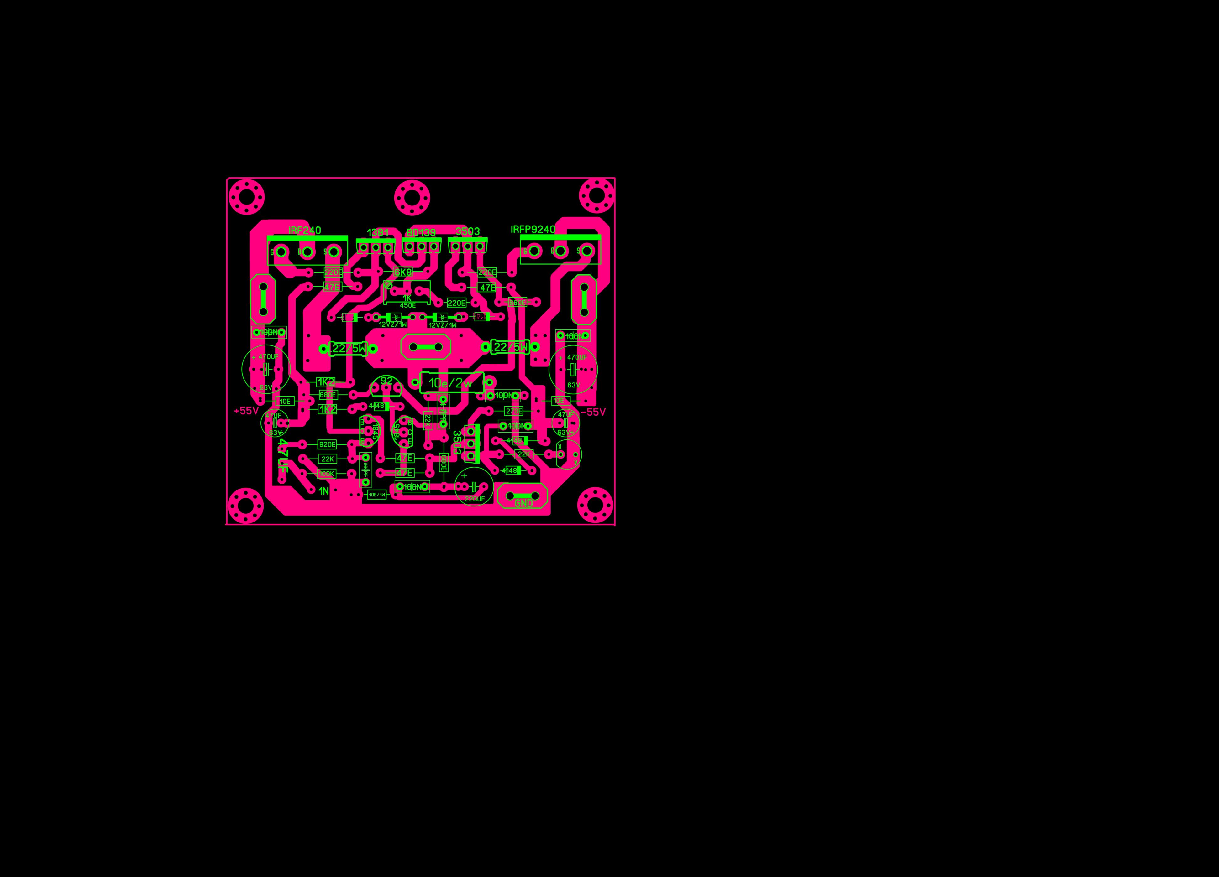

Hi all. I need the wiring connection diagram for the APEX A38(40) amplifier please. The two ground connections at the rear I dont know what they are for
hello ballisticz4,
referring to this pcb design 100W Ultimate Fidelity Amplifier
the 2 ground connections at the back are to be connected to psu ground and also PGND to PSU ground.
