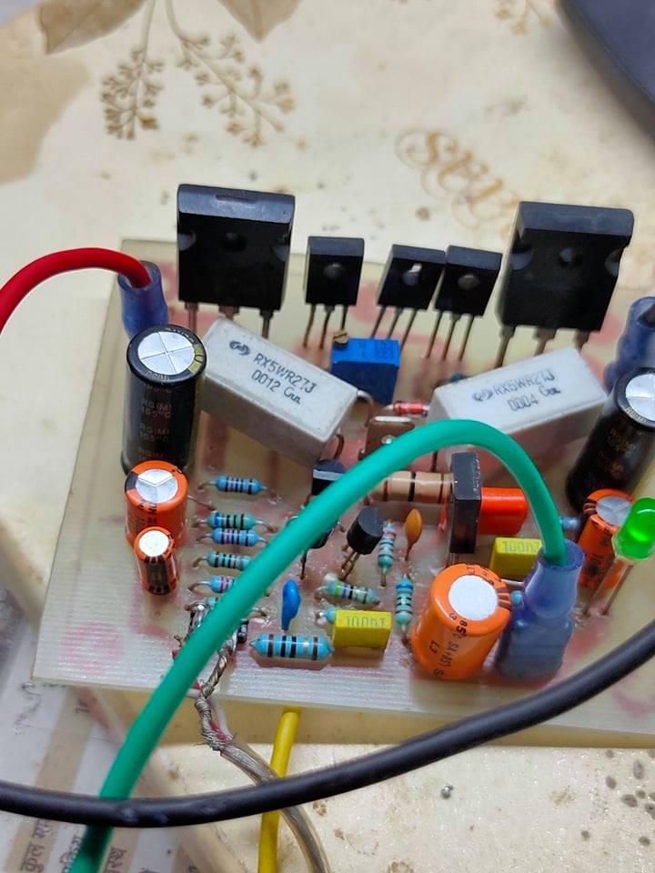

My old Apex Ax-14

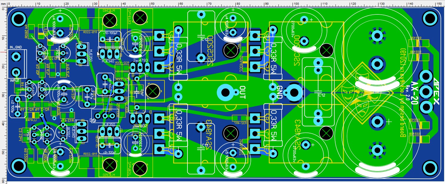

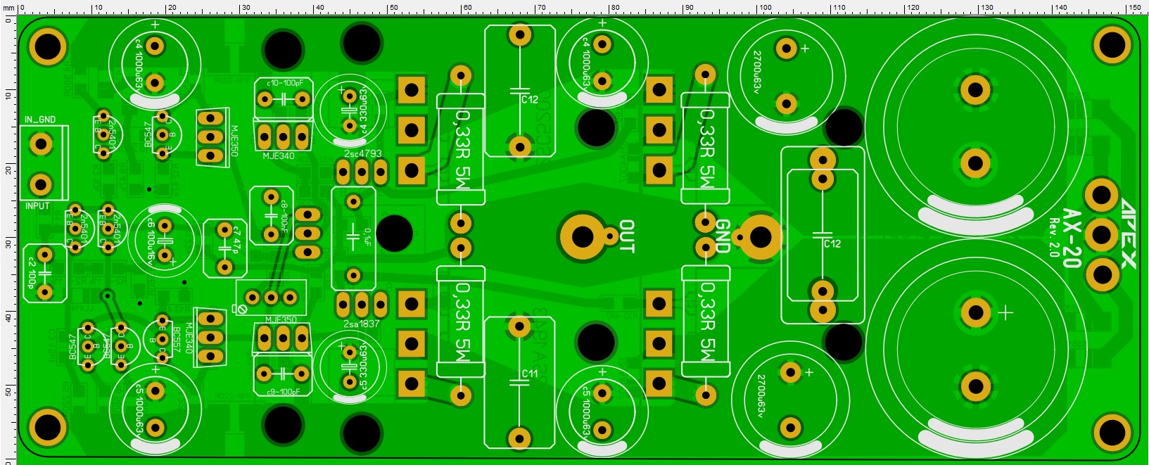

My old Apex Ax-20
What kind of psu are you using? Looks like there is nothing between the transformers and the boards.
Yes, there is psu on each board. Here, for example, is the AX-20 board

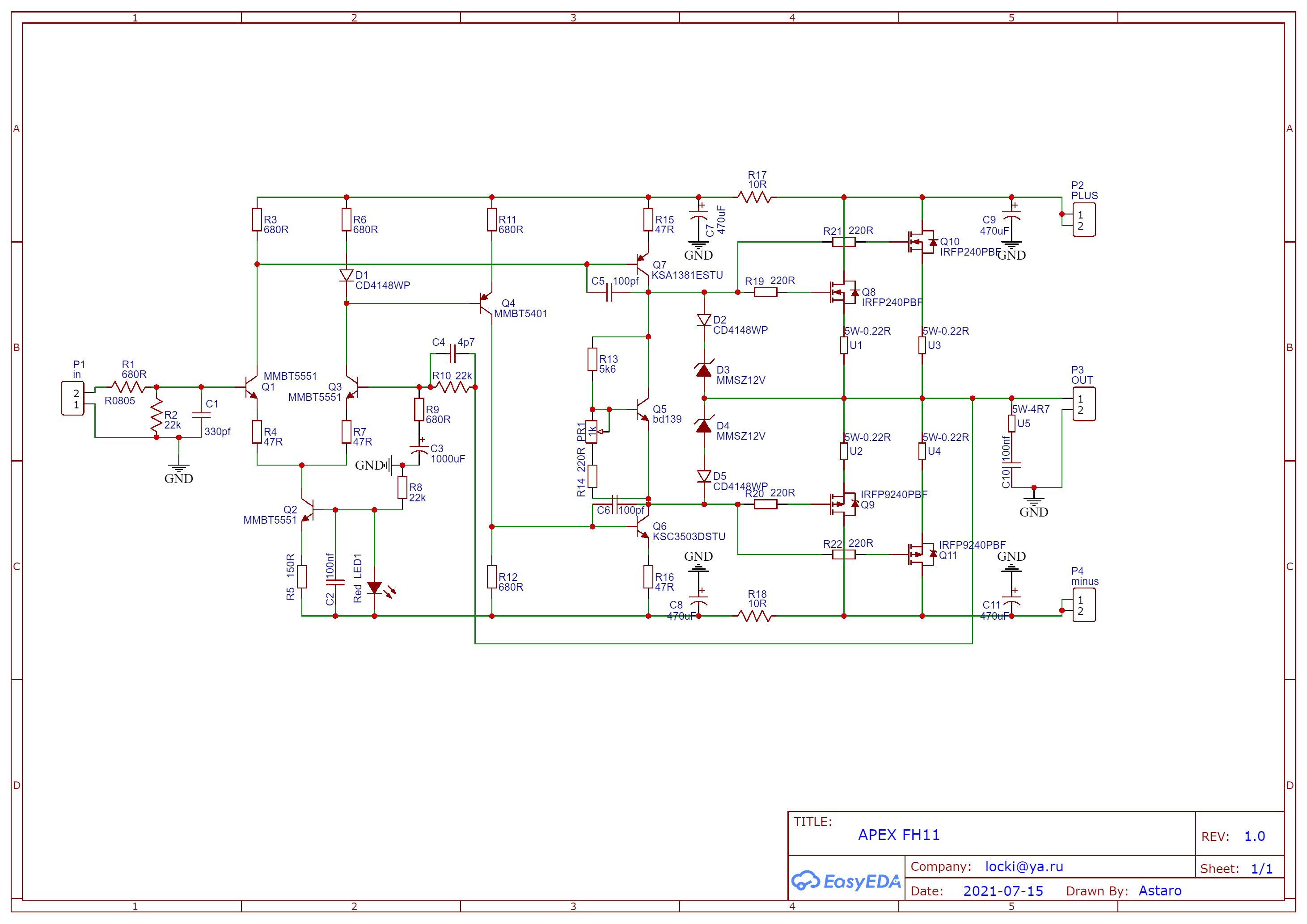

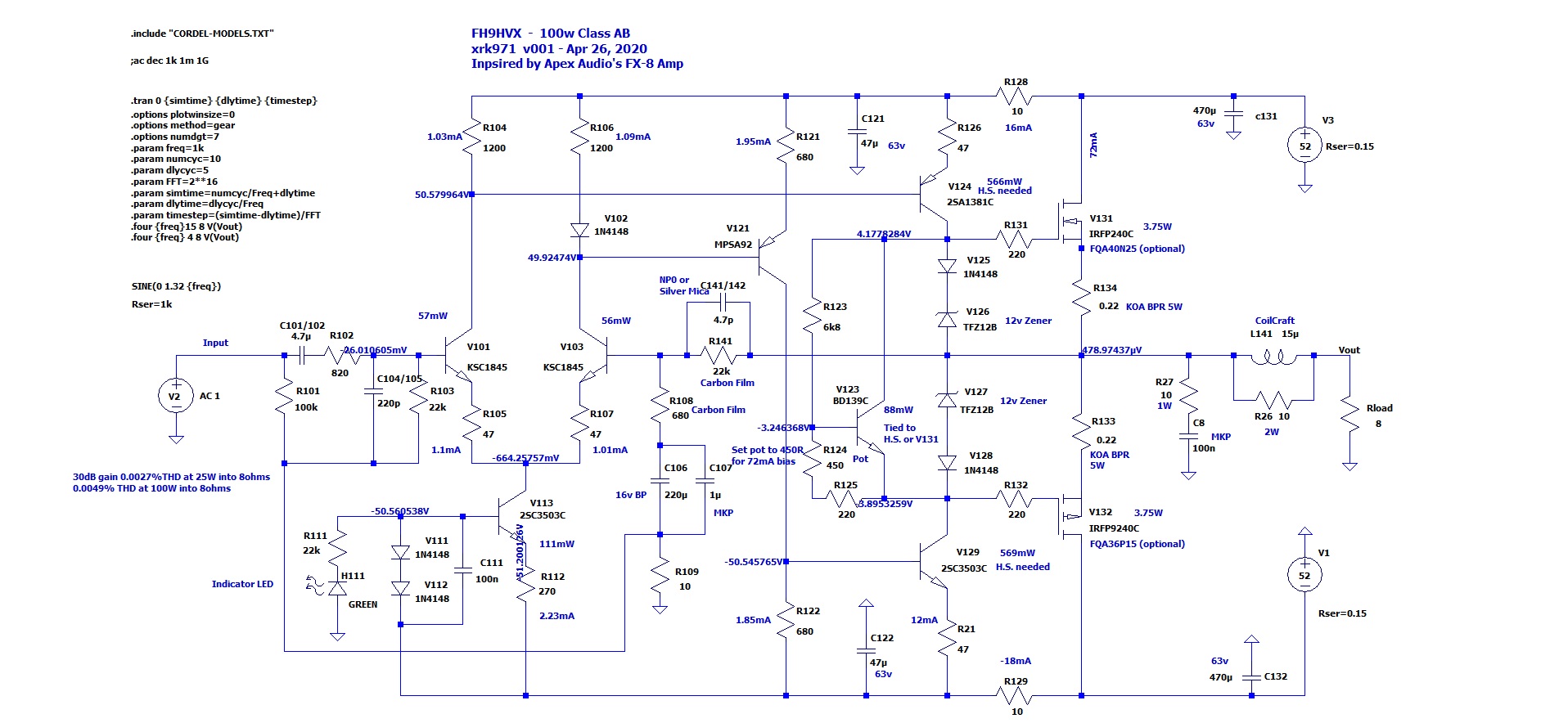

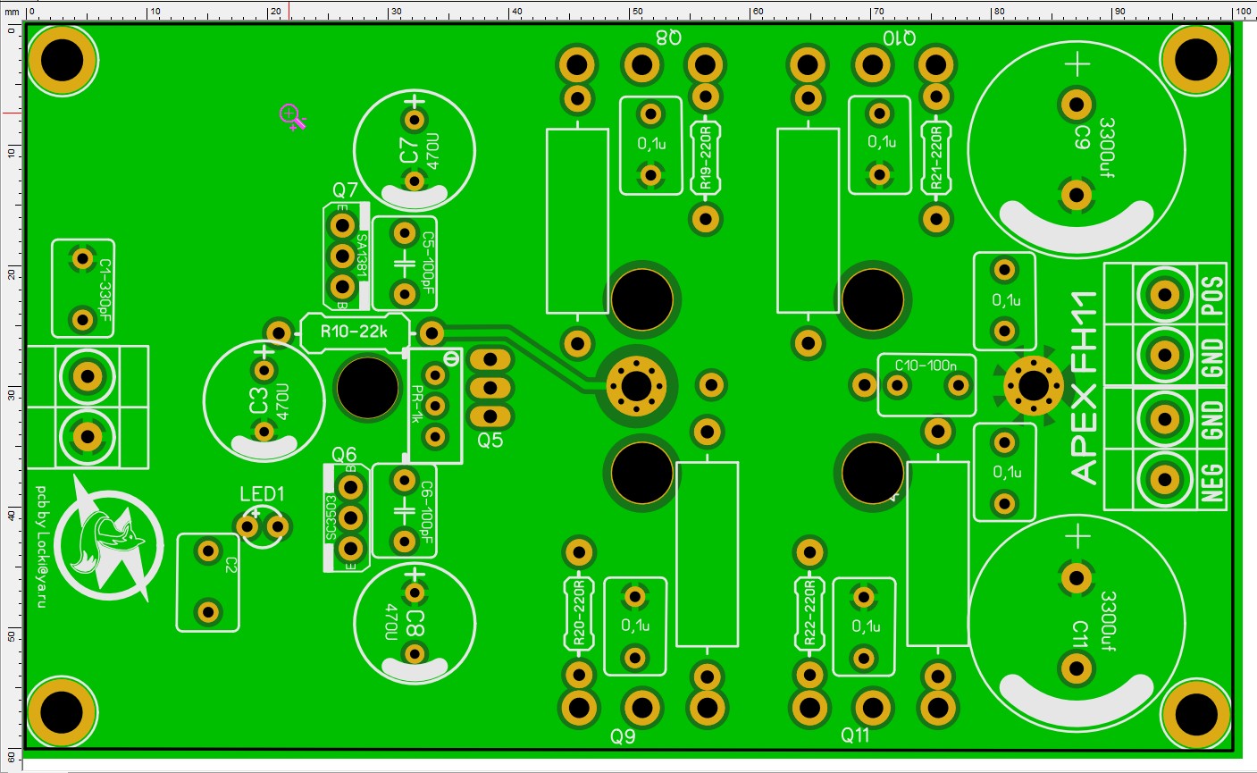

100W Ultimate Fidelity Amplifier
this one is same as 2 pair FH-9? sonal has posted sprint file also somewhere on the thread.
FH11 Ver1.02.zip, Sprint file for FH11.
"many thanks to sonal for his wonderfull pcb desigining and apex audio".

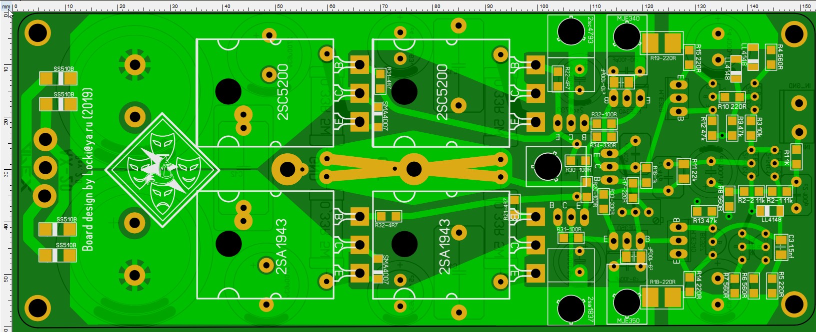

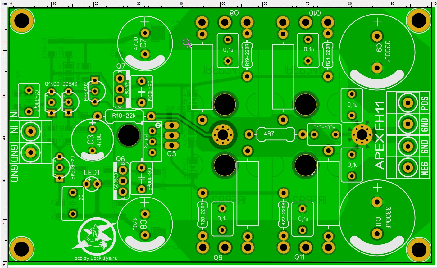

Learn how to use PCB/Schematic drawing software is easy. But learn how to make good PCB layout is difficult.
As long as you keep connections between components short and thick, you will do alright. And do not use ground planes in amplifiers.
Using dual side pcbs is fine, because you will be able to shorten your connections between components.
These basic rules are a good way to start designing.
Add other tips you may find useful.
Q2 USE KSC3503 see schematic # 13806

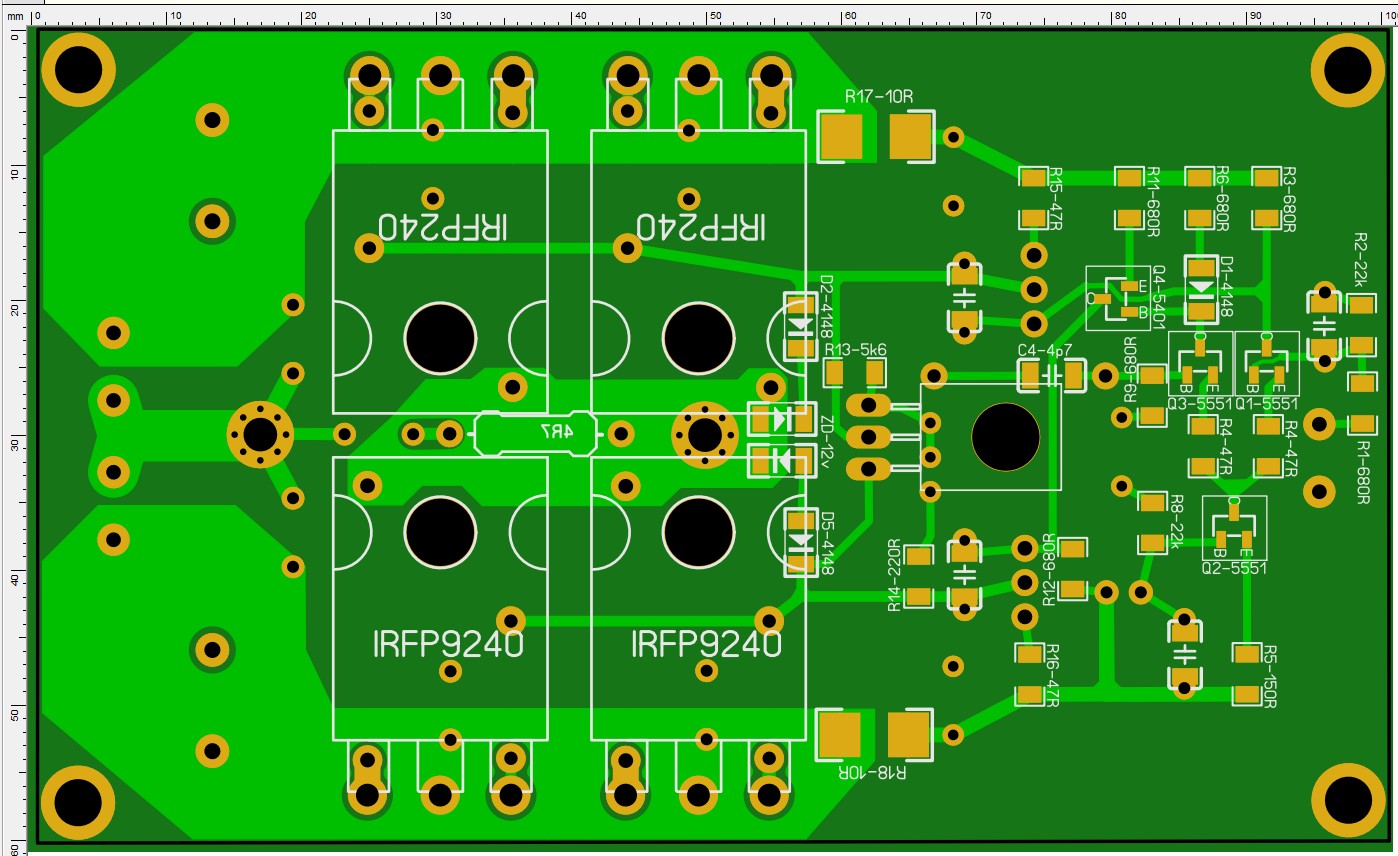

Is it so heated there that a large form factor is needed??
Hi Nick,
here are the files🙂. be very careful in soldering as components are in close proximity due to compactness of pcb.😉
Another thing, if you want quickly the pcbs for this amplifier but different pcb design/size, xrk 971 has already his version of pcb in his store , have a look at GB section or his store here FH9HVX Amp PCB | Etsy
