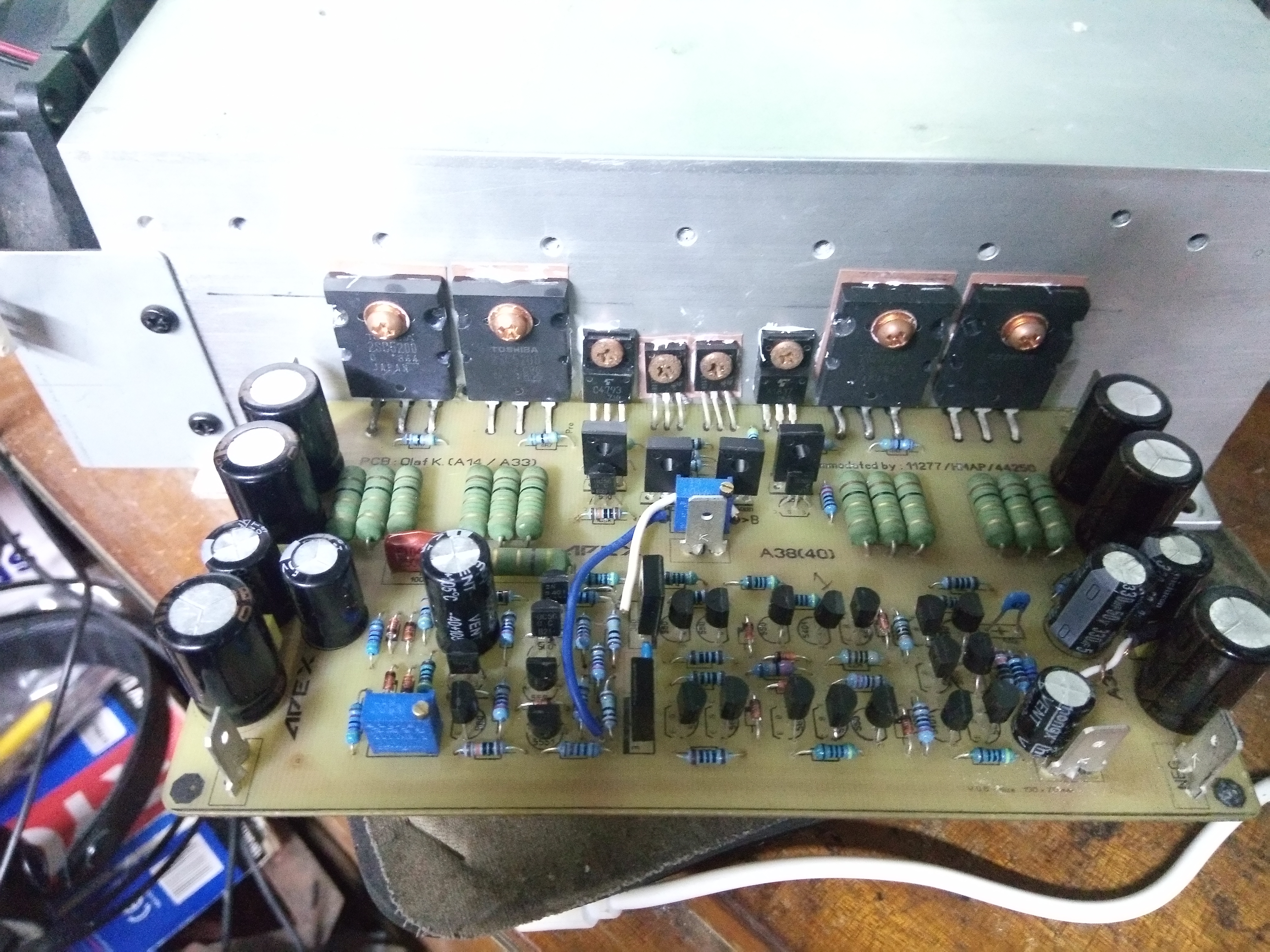

Hey all. I need some help with my A38(40) build. So last night I hooked it up to my power supply, 54vdc. But I cannot bias the amplifier and I get about 32vdc at the output. I went over the boards, no broken tracks or shorts, no grounding of any of the semi conductors etc. Not quite sure what is going on, but the 1R 2w resistors get quite warm, not hot but very warm. Please can someone assist. Here is a pic of my build
Hi
I havent. But how would that effect the heating up of the 1r 2w resistors and not being able to bias it
Hi
You said you have 32vdc on the output. Let's try to fix that first.
I was under the impression that I was suppose to short the input pins while setting the bias? Willing to try whatever it takes to get these amps working. Please advise on what to check further
Yes you should short the input but the input ground must be attached to the PSU ground as well.

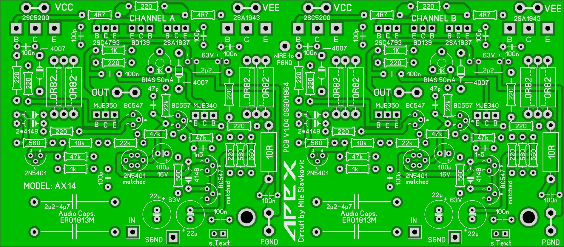

Please solve my problem in ax14 ampl.
I measure voltage across npn .33 ohm resistance 5.2mV and at pnp .33 ohm resistance is 4.7 mV
Dc off set (out put to grground is 13.5 mV(200mV range)
How can i get equal volts at npn and pnp side emitter resistance.
Dear sir
Everything looks good.
I can't see a problem here.
You can't get exactly same voltages for npn and pnp.
Any of the little transistors, I mean just now. In the negative half-wave amplifier. I would check their pins for resistance with ohm-meter.

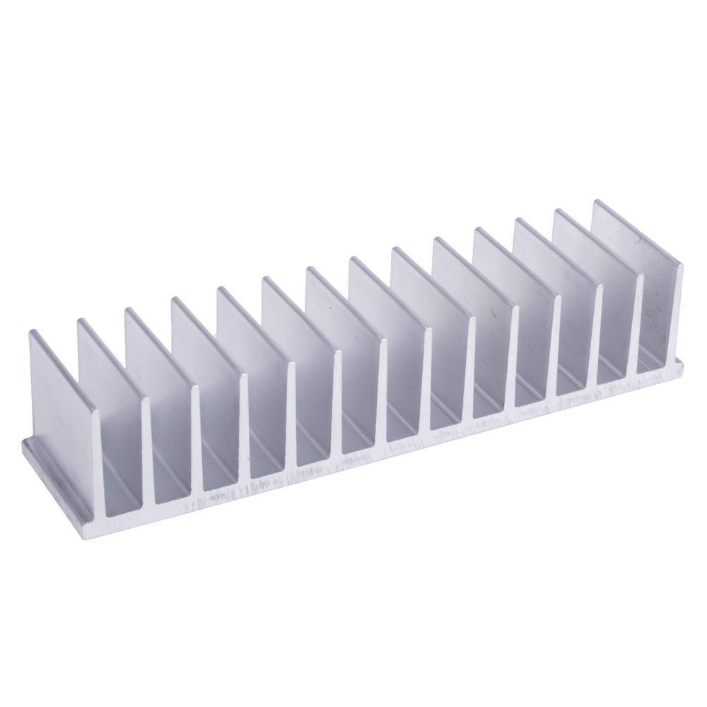

For the amplifier I will use an equalizer body as in the photograph (body height 55 mm) and radiators with an area of approximately 600-800 cm2 per channel.

2x28Vac for 4Ohm load or 2x32Vac for 8Ohm load. heatsinks you have should be more than enough - you could post images of them?
