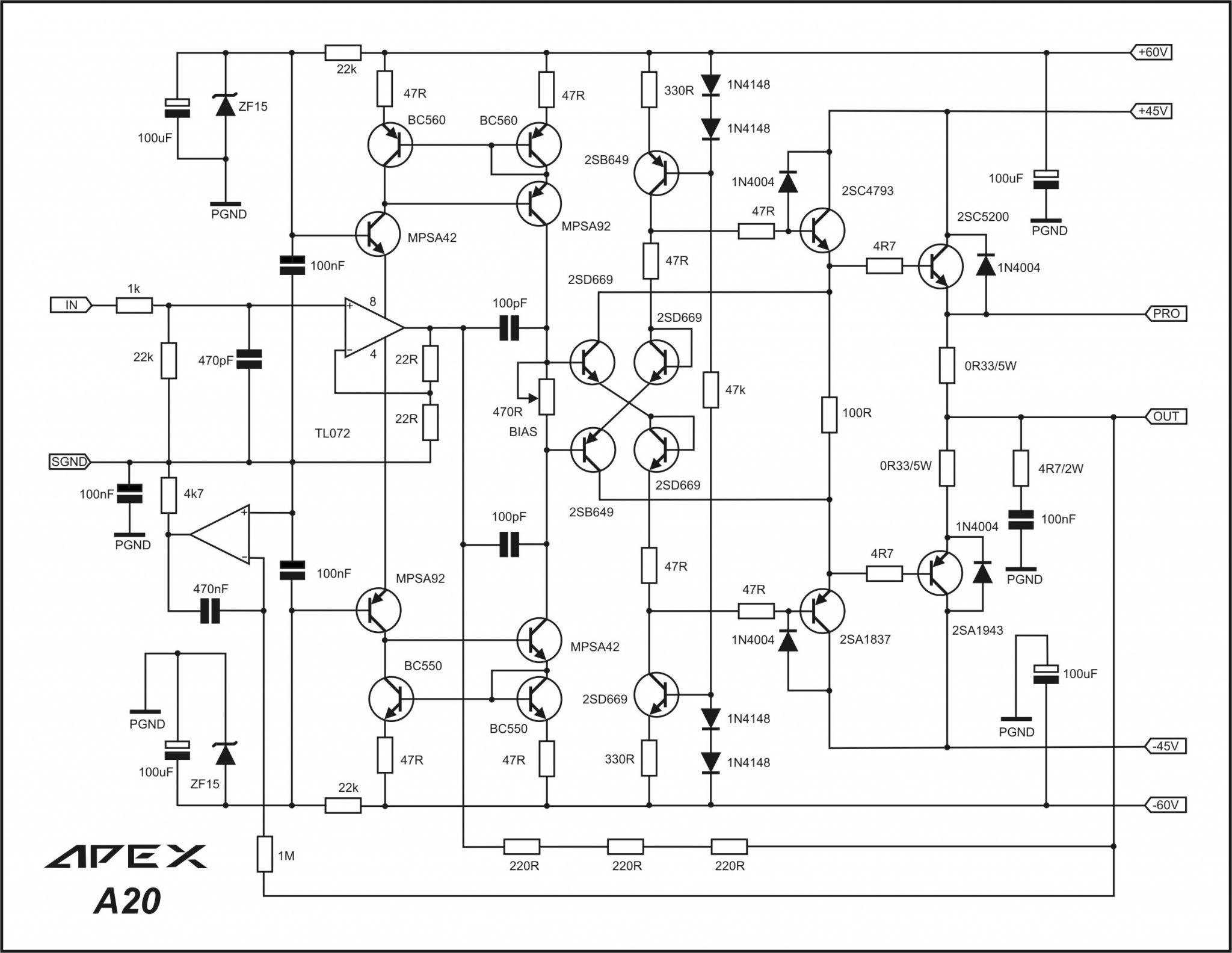

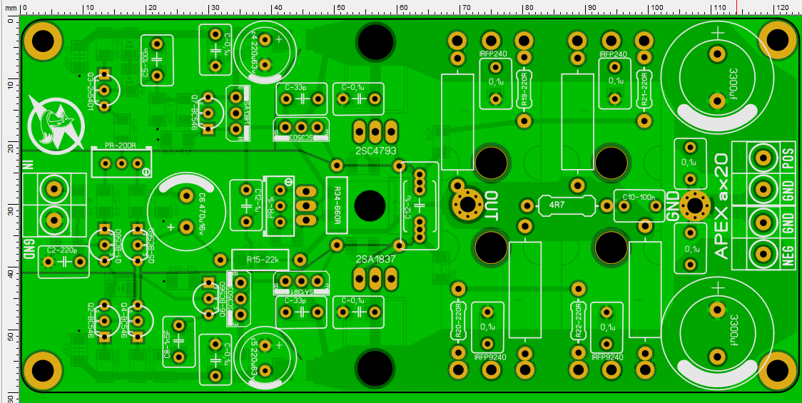

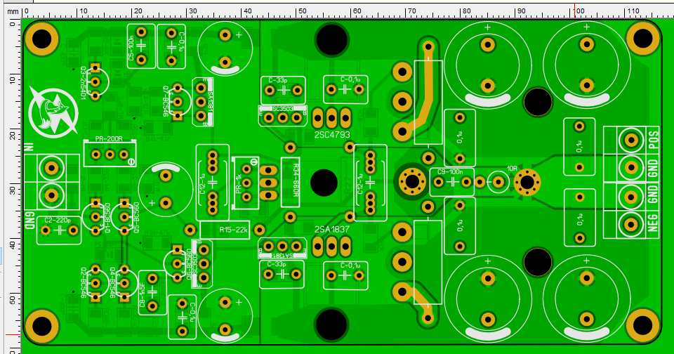

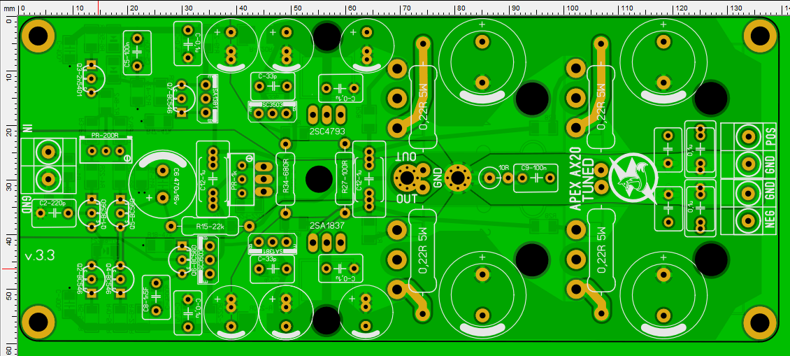

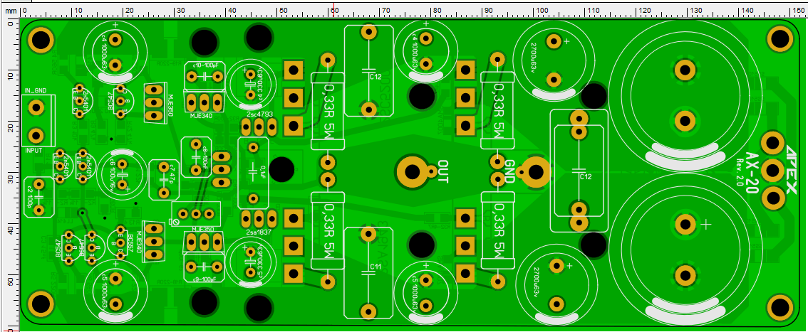

Thanks Astaro, such a lovely PCB design, but I need A20.if there is one of these options that suits you, I can post it
Oh, what kind of amplifiers Apex does not have - for every taste 🙂
Very low distortion at high frequency. Not for everybody taste, but I like it.

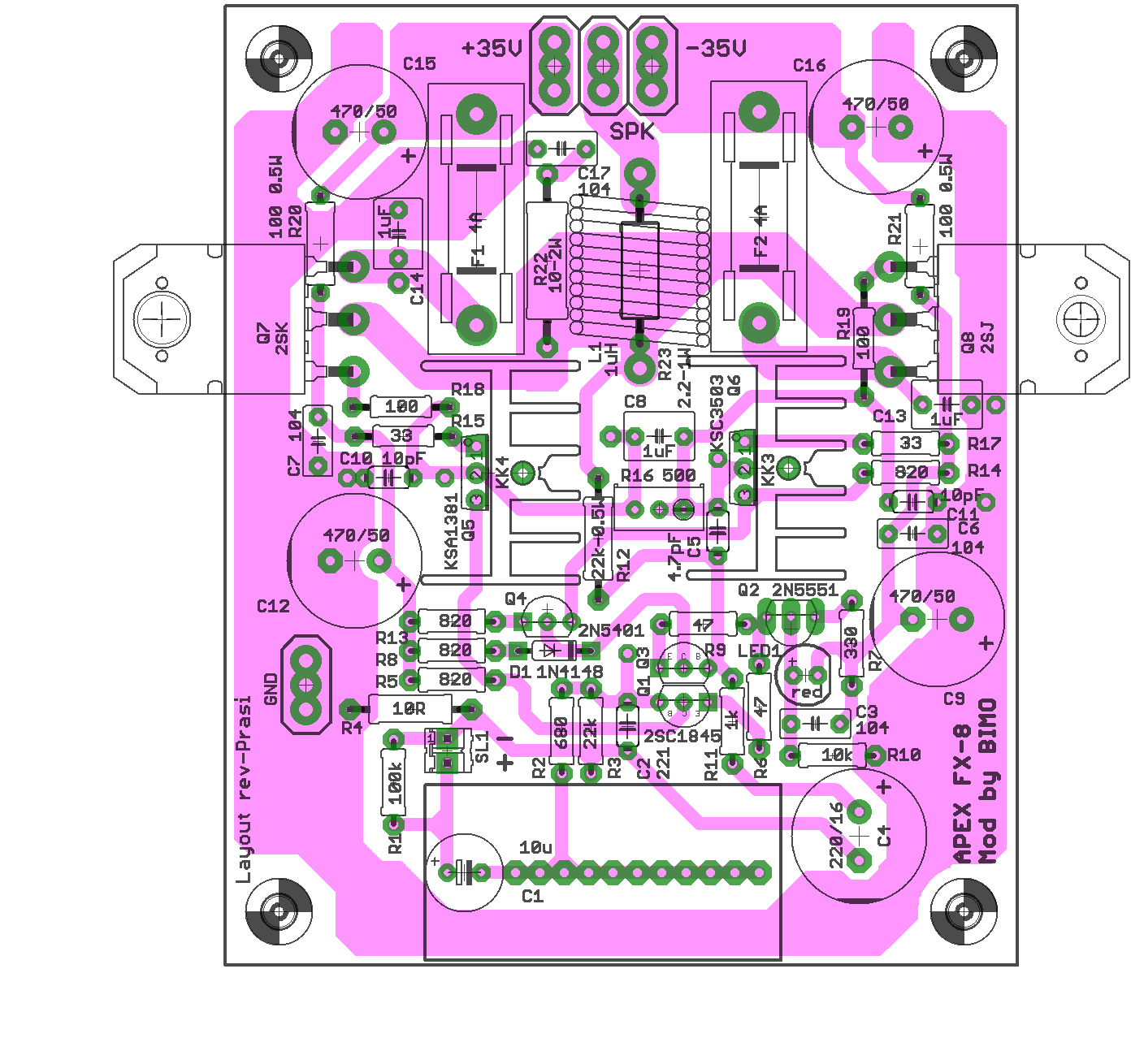

Bimo, Which model has low distortion at high frequencies? what scheme are you talking about?
I'm looking for the schematic of this pcbBimo, Which model has low distortion at high frequencies? what scheme are you talking about?
Some members of this forum design such amplifier. Example: OStripper, Valerie, Dadod, Edmond Stuart, Astx, etc.

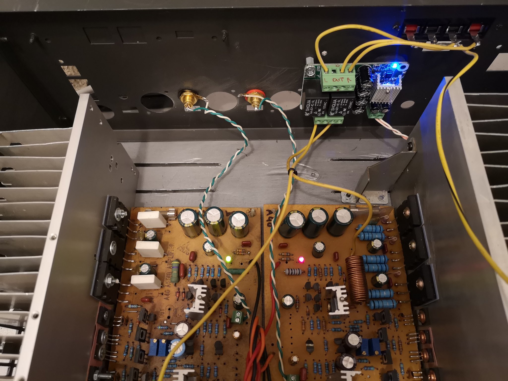

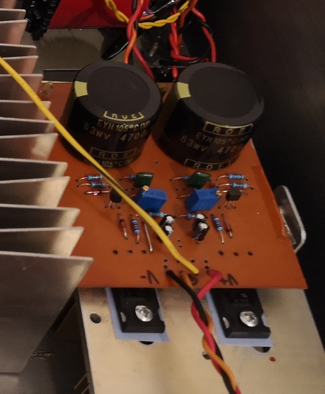

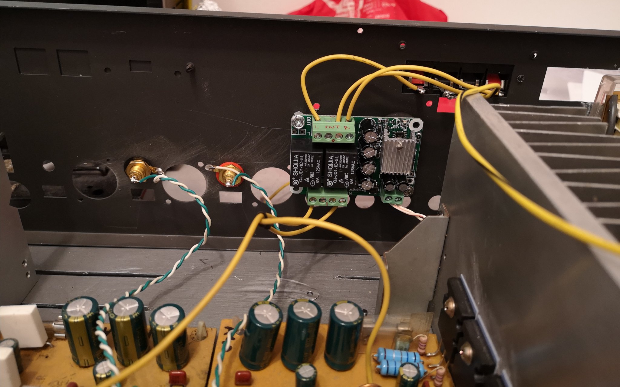

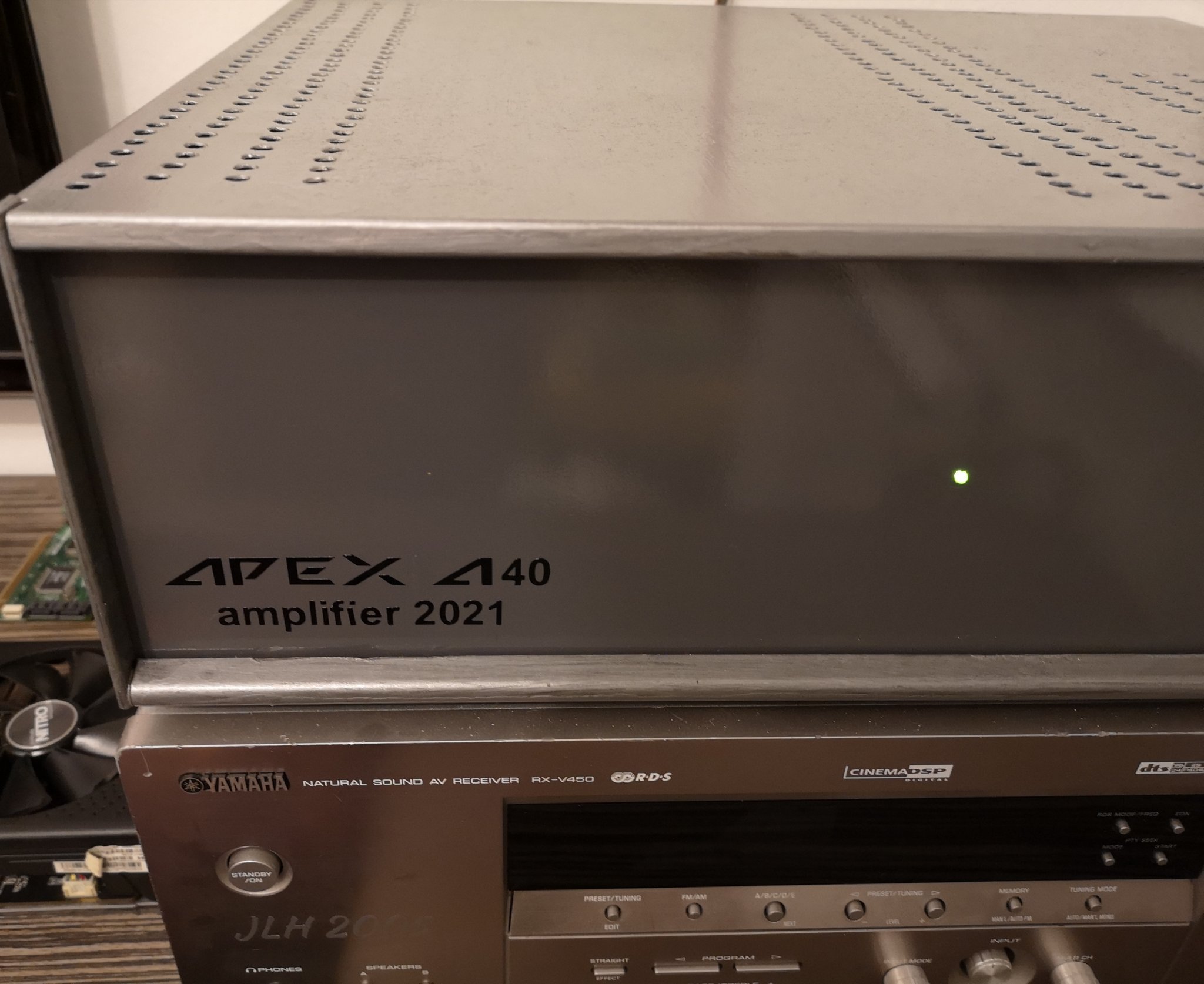

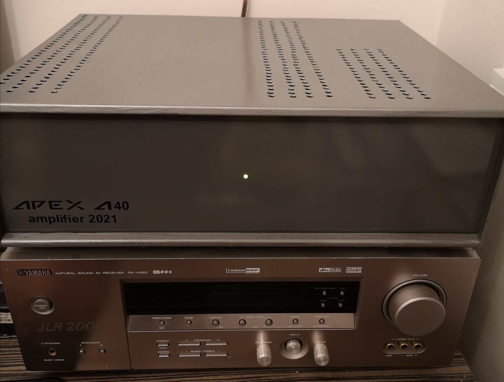

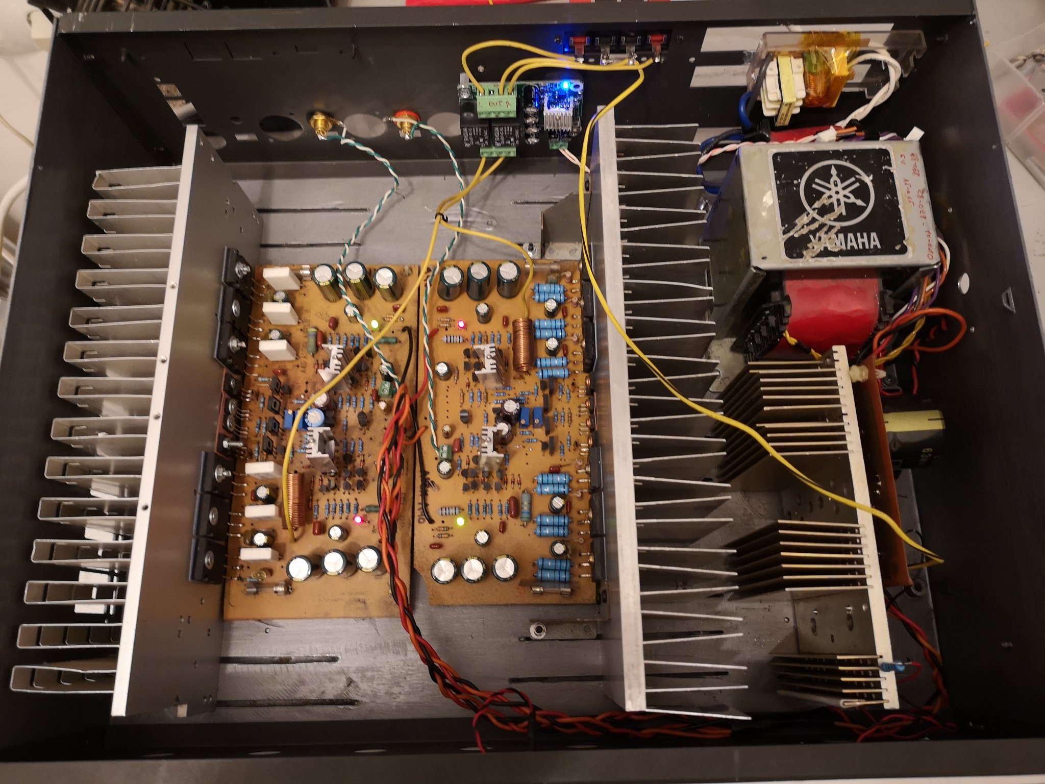

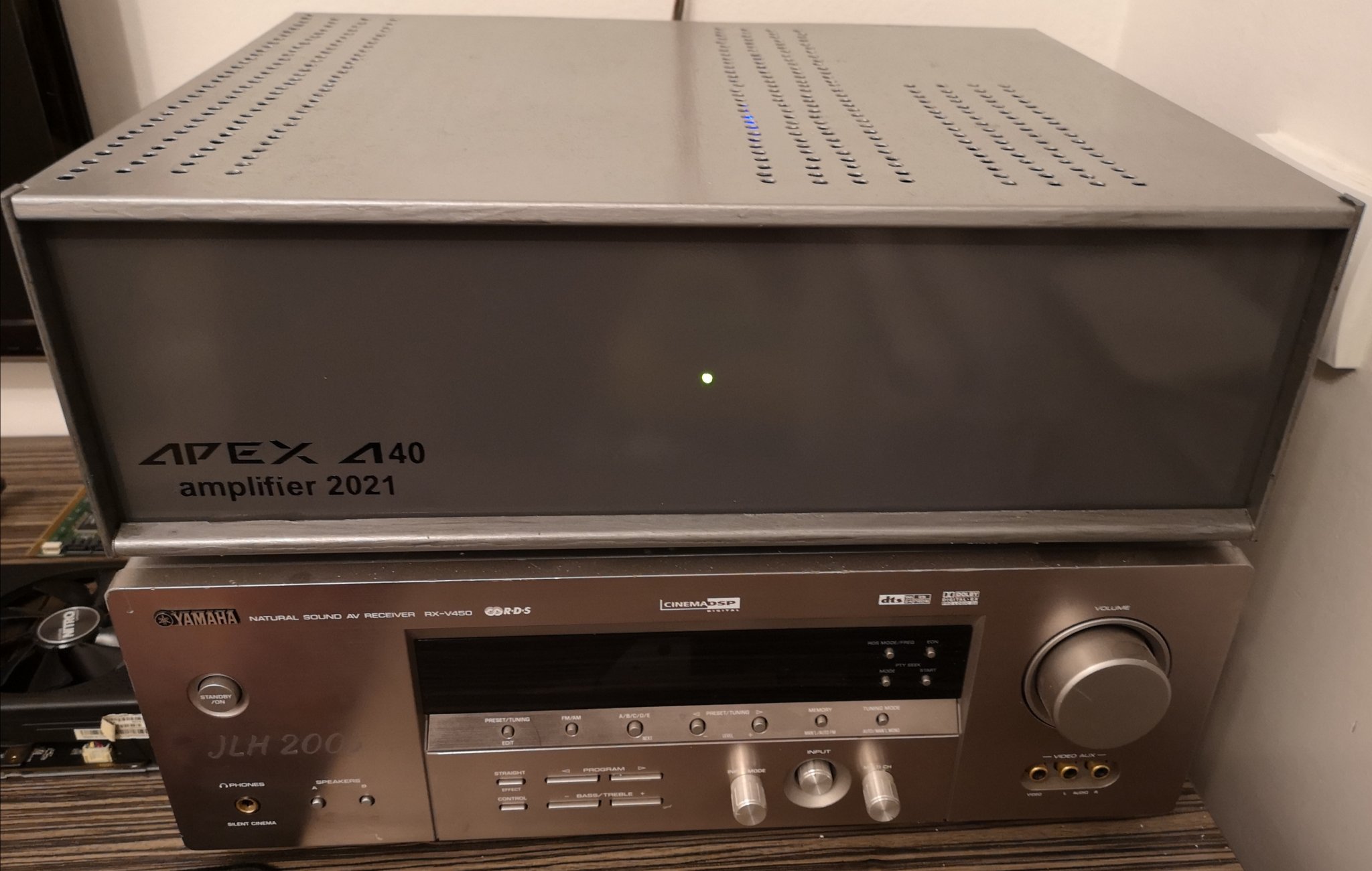

I'm listening Apex A40 for the better part of 2021, +/- 45V for now. Apex PS 15, speaker protection. I still have some work to do, but I just enjoy it for now. 🙂

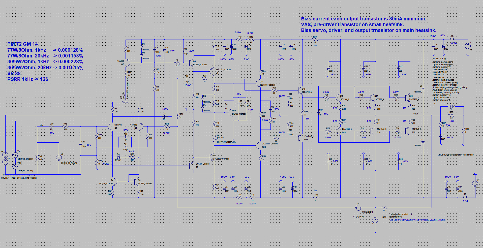

I modified AX20 for you. I did not make many changing as possible. For compensation, I use TMC. And output transistors I use 3 pair, so it can drive 2 ohm speaker and reduce distortion a bit at 8 ohm. D3 to make a clean clipping, I add resistor in series, because this diode reduce the slew rate. So the result, slew rate is relative high. I'm not a fan of super-pair Baxandall VAS in this topology, because using 2EF as VAS in this topology can reduce distortion in high frequency. But super-pair Baxandall VAS can add more H2 distortion.Bimo, Which model has low distortion at high frequencies? what scheme are you talking about?
You can improve this modification with cascode in the input, bootstrapping in pre-driver and driver transistors at output stage, etc. But of course it make complicated.

Here I see a more complex correction (c33, c34, r52, R51) - did it not work with the usual one, as in the original scheme? is this a two-pole correction?
C7 - is definitely needed for such a large nominal value? is a 1-4 uf film not suitable? C35, C36 - not too big?
"modification with cascode in the input" -let's add this, too, how to calculate it - where can I read it?
It is TMC and I already implemented in another amplifier.Bimo,
You need to read a book from Bob Cordell, Douglas Self, or Dr. Arto Kolinummi."modification with cascode in the input" -let's add this, too, how to calculate it - where can I read it?
how does the abbreviation TMC stand for?
I didn't see the methodology there, although I may have looked at it inattentively...Douglas Self
TMC = Transitional Miller Compensation.how does the abbreviation TMC stand for?
You can ask Douglas Self and Bob Cordell here, because they are member of this forum. A thread in this forum talk about Bob Cordell book. If you do not believe me, please do not PM me and ask some help. I have design amplifiers with many topology with many compensations. Not all of them I build my self. Some built by local audio community here. Although, if the schematic is good it doesn't mean the result is always good. Because pcb layout, components choice, and the power supply have influence to the result.I didn't see the methodology there, although I may have looked at it inattentively...
