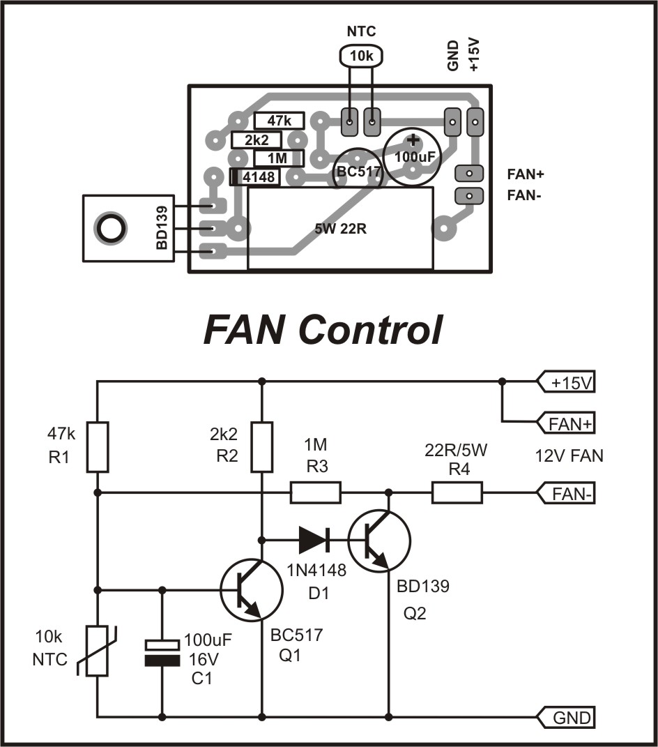

Hi Mr. Miles!
I dont understand, this layout you gave has also diodes in between collector and emitter. Should it be between collector and output or may leave like that?
Regards, Toivo.
It is irelevant,
Regsrds

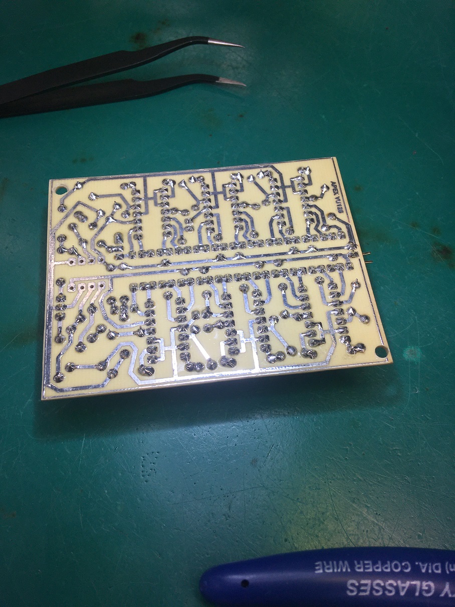

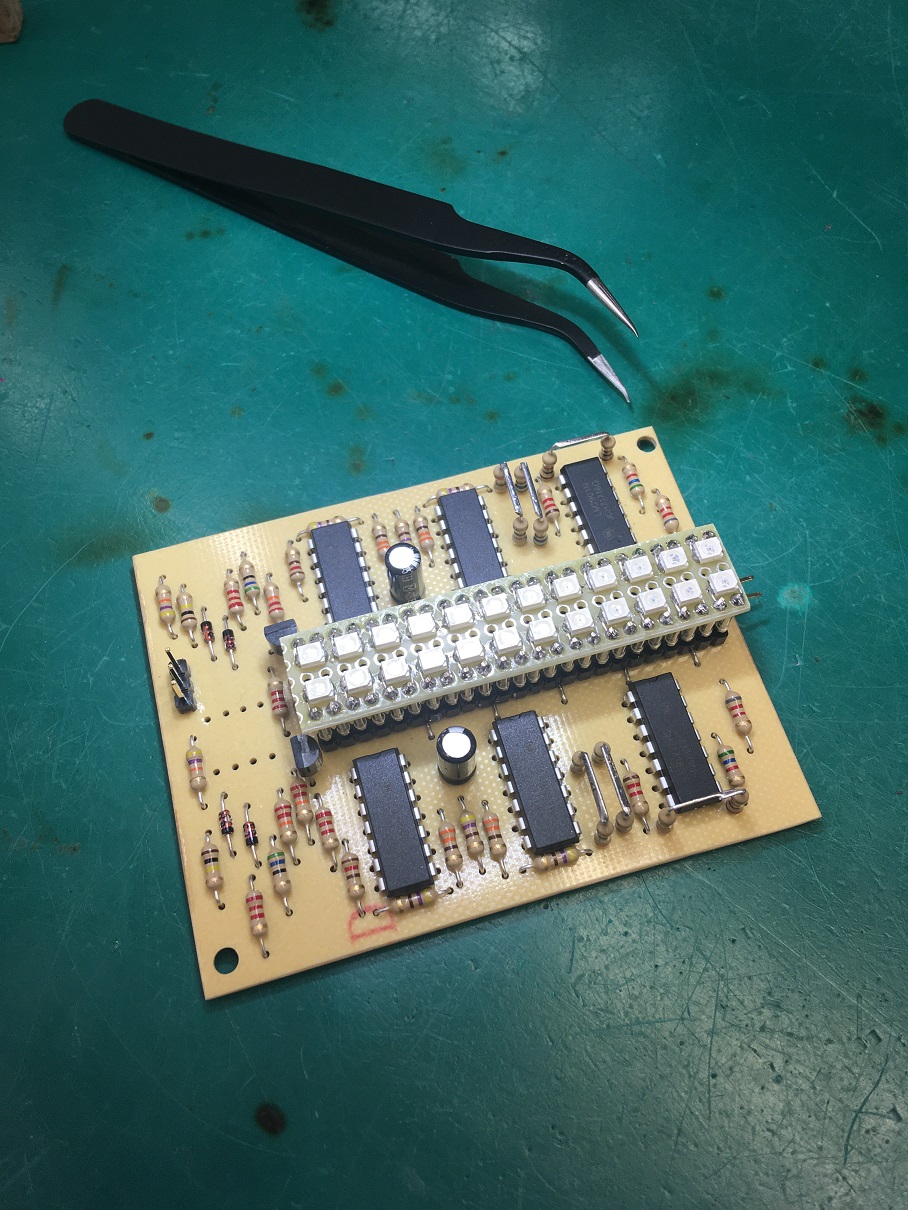

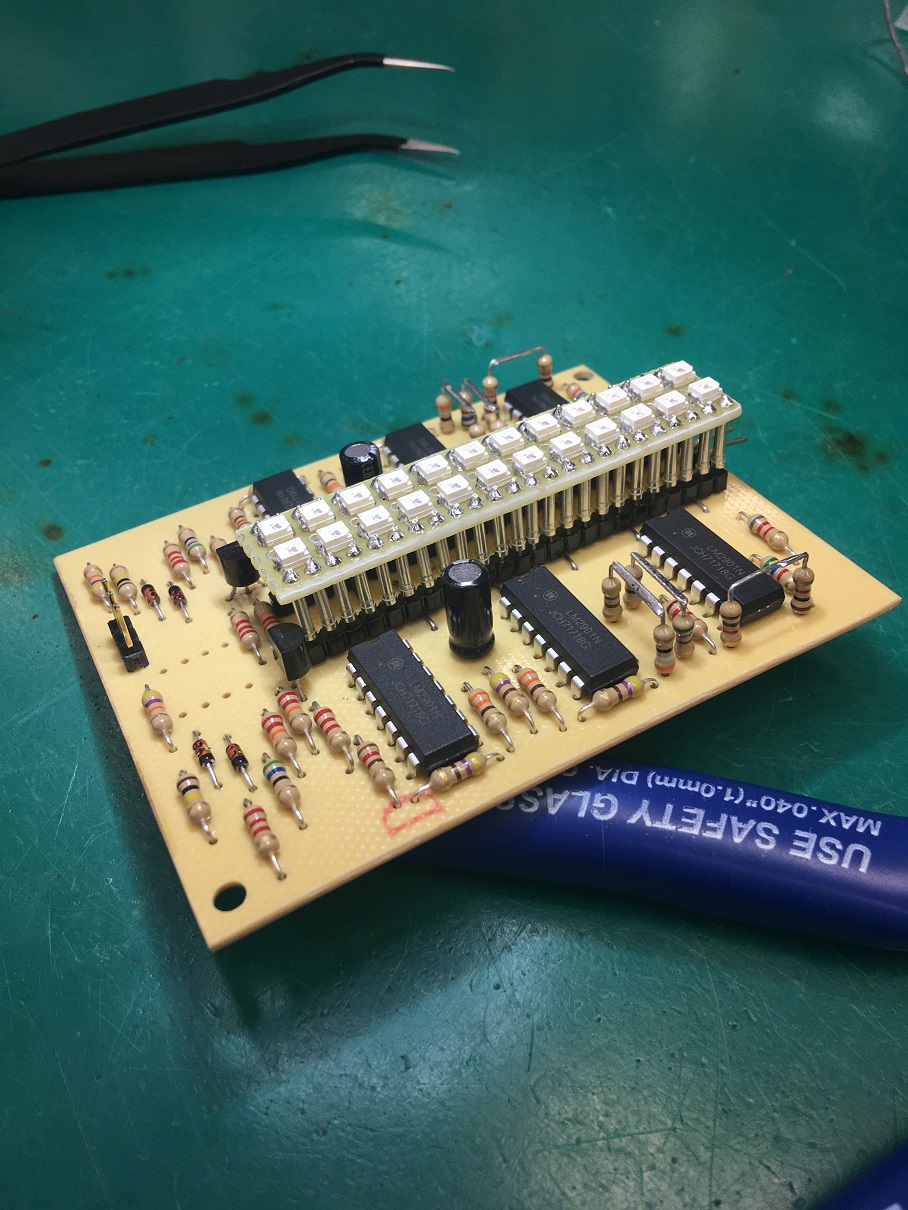

APEX VU12S PCB size 82,5x65mm.
the circuit diagram can also be posted.
thanks.
