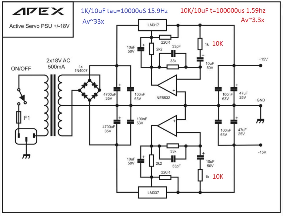

Apex LM317 Active Servo PSU
High sir,
I make 4 this PSU and on 2 have problems on negative channel.
I put trimmer 5K instead of 2k2, and can not regulate the minus voltage.
I have full voltage of 21V on output.
On one change opamp and it becomes stable.
On second after four additional opamp behavior is same.
I put 100n instead of 33pF and then
if put on i have 21V and
if put off and after put on the power switch, I got 15V.
I think it is oscillate. Is correct this value of 1K in feedback.
Can help if I put 10K instead ?
thanks

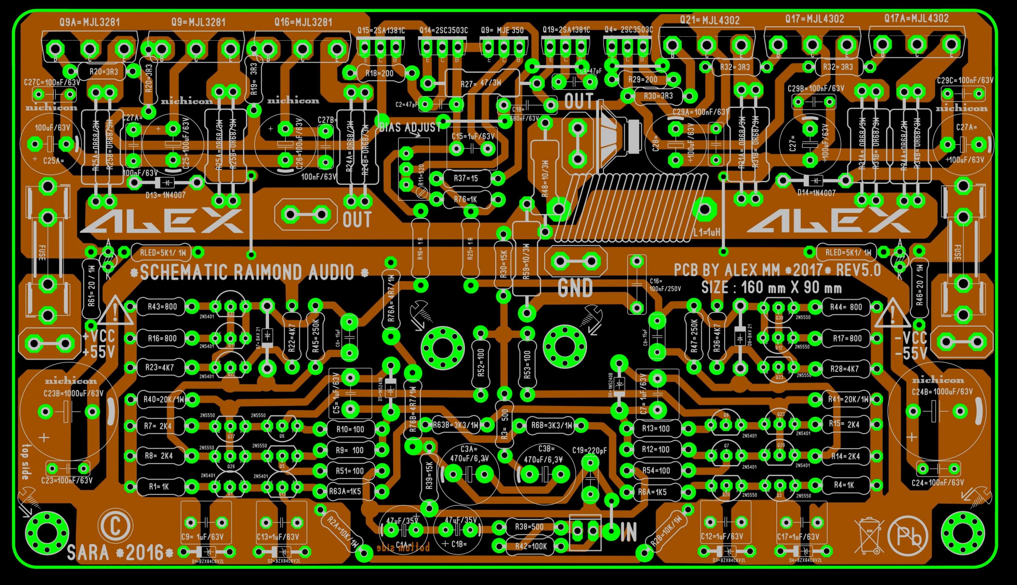

Hello,
90% progress on VU12S😛
R8 and R2 values are reversed..
R8 must be 560R and R2 22K...
C7 value ,is plain wrong , and should be much lower,
something between 3.3 and 18pF..
As i pointed it with many of his designs, R5 and C3
must be removed as they create a hard rail sticking when
the amp is overloaded.
There s better means to achive stability.....

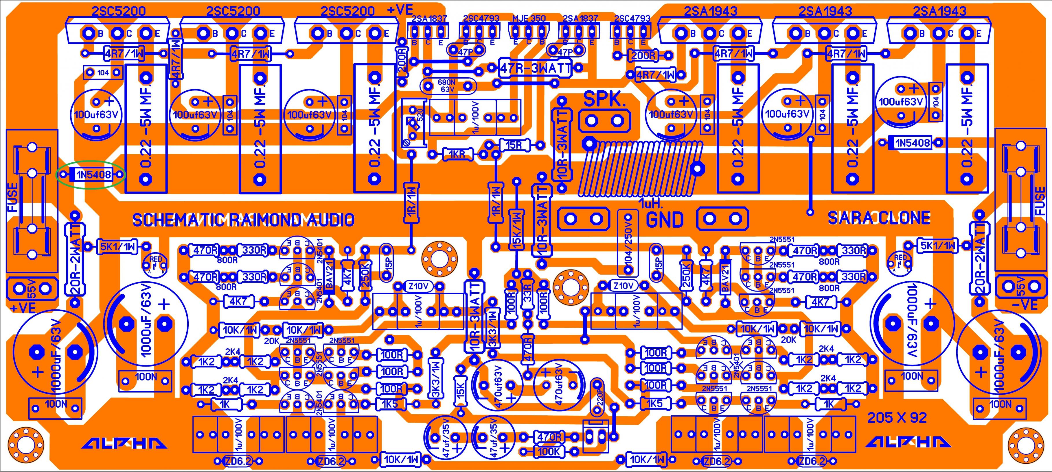

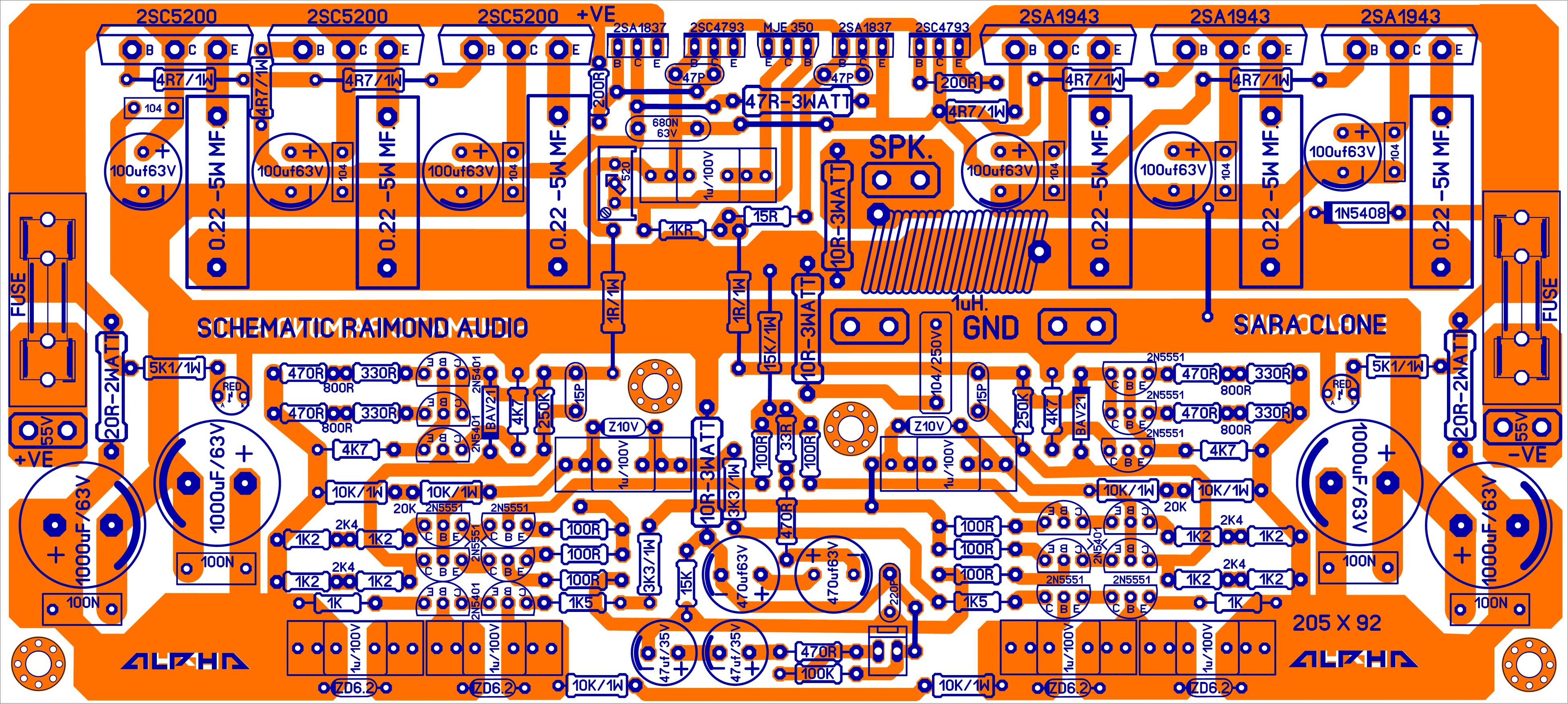

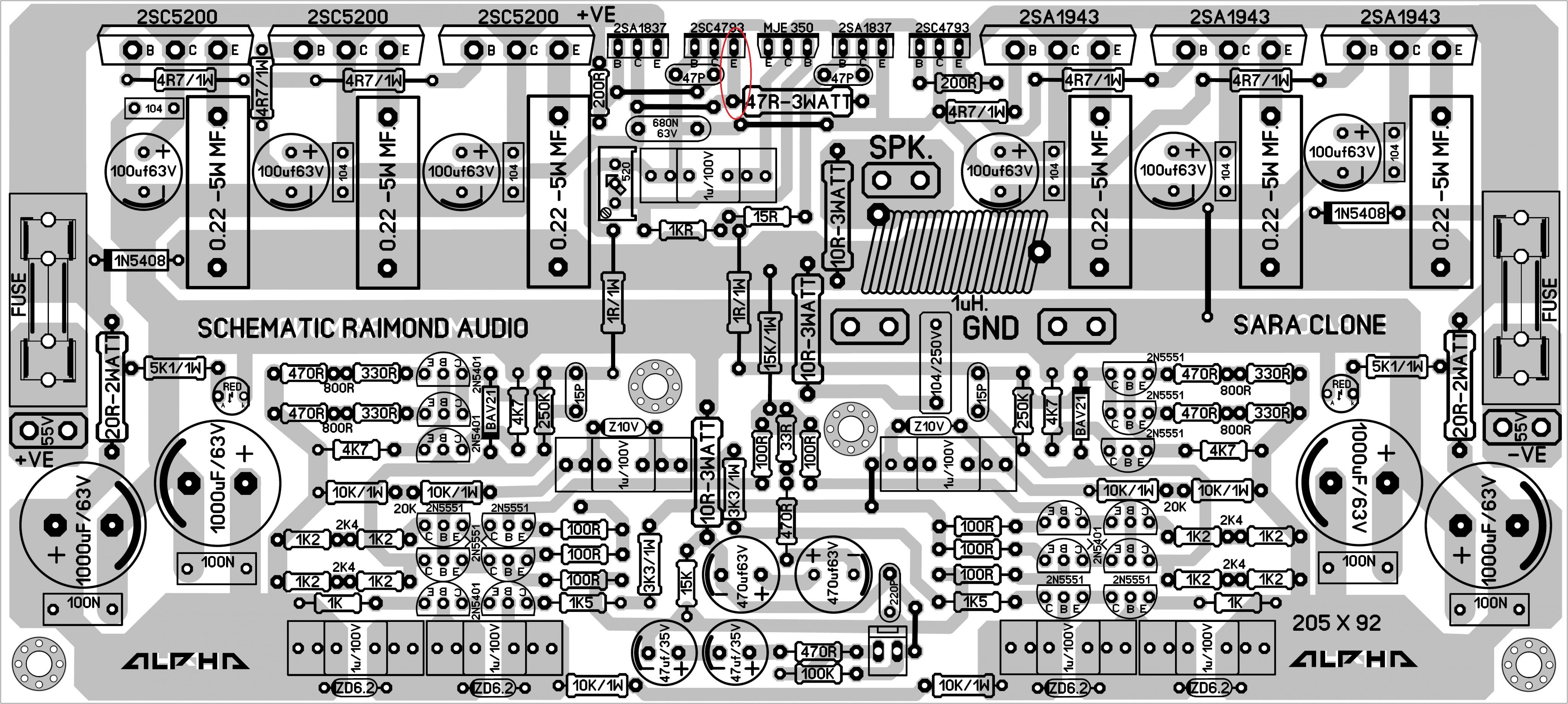

Friends I have cloned SARA Amp , P.c.b. designed by Alex MM.revised version 5 , 2017.Changes I have made are because of the availability of the components on my end , Experts please check.
Sorry friends just found a small mistake corrected it, Experts please check for any other fault.Diode on positive side , now added.
Is signal gnd need psu gnd?
Replaced zeners with correct value and added 1N4148 on layout.

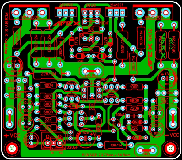

Can't find the Apex NX12 gerber file, can you help me.

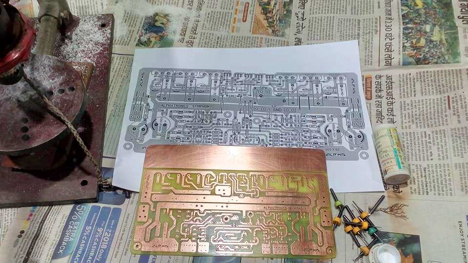

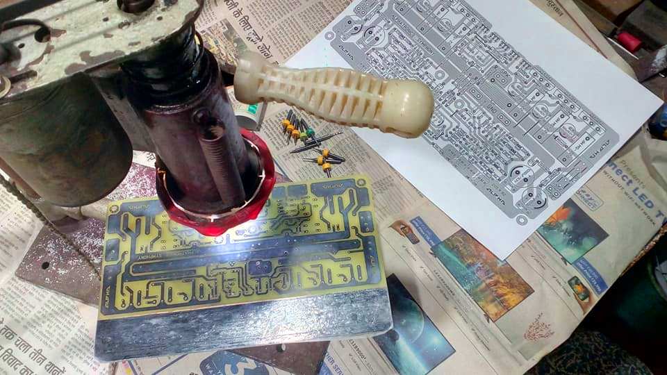

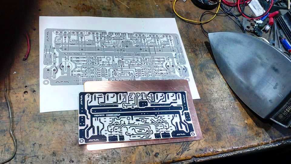

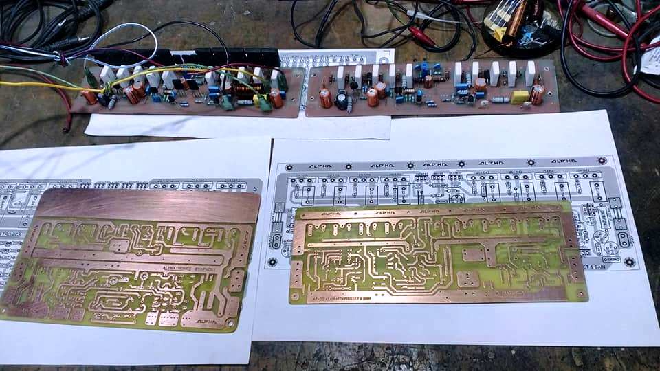

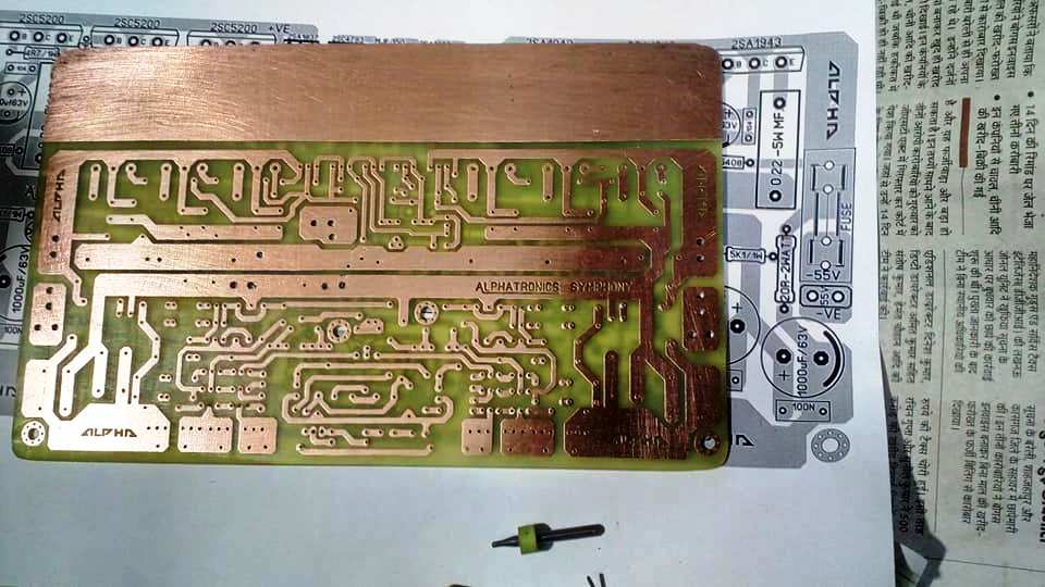

Since didn't get any response from Experts in the Group I decided to print, etch drill and make Sara and 2 more projects.Alpha Darlington 5 pairs out , one channel completed and tested, So it is now make and test.
