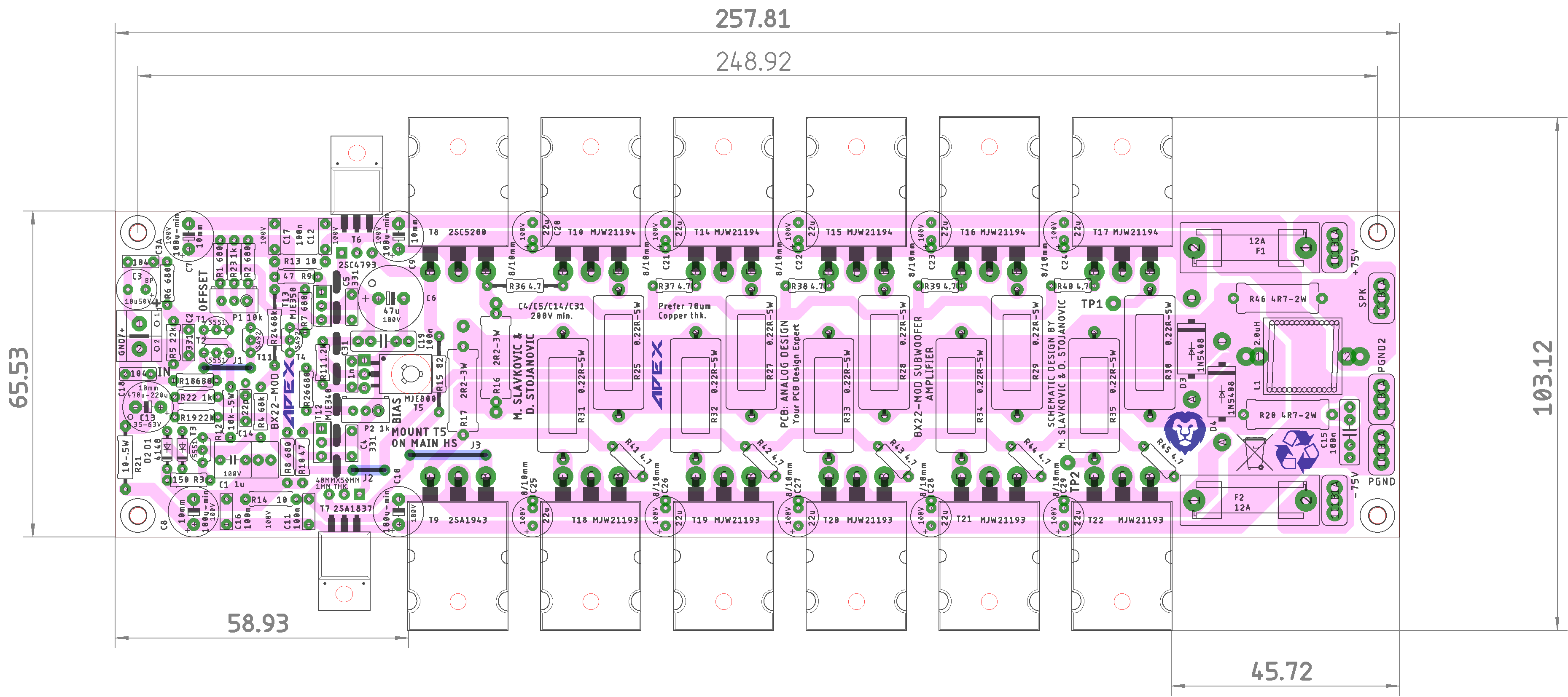

here you go Andrew.
i do not know if someone has already built, so i am assuming its not tested.
  • APEX BX-22-mod by Dragan-R5-total mod-bottom copper.pdf
  • APEX BX-22-mod by Dragan-R5-total mod-top silk.pdf

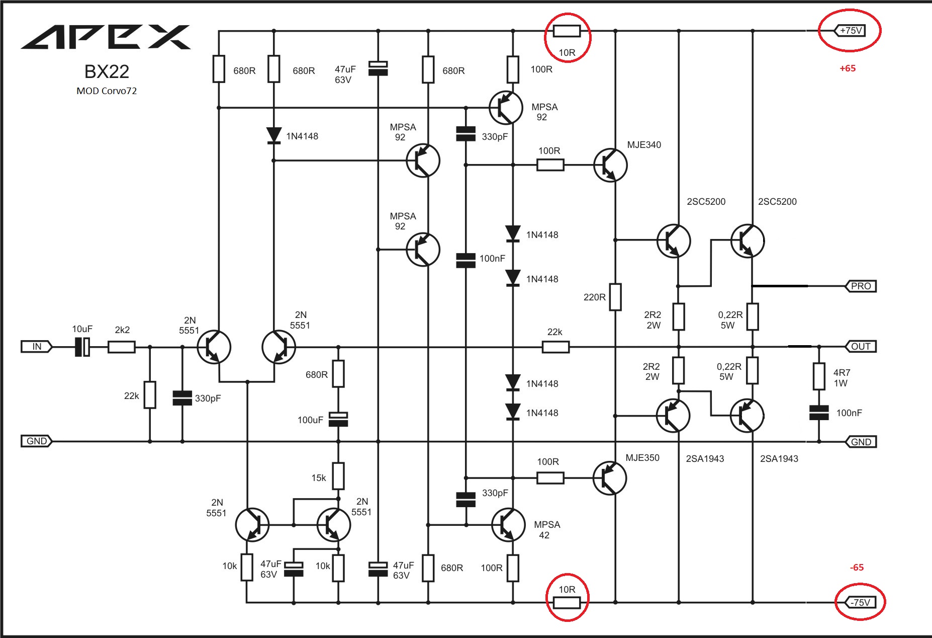

Depends on your speaker impedance (load)
+/-65 for 8-ohm and I wouldn’t use at 4-ohms often or at high volume.
For 4-ohm stability and 2-ohm dips I would suggest +/-55Vdc.
You can use higher voltages, but will decrease SOA and dependability. I usually push the limits, but I also don’t mind rebuilding an amp if it blows up.
using as an example, originaly BX22 with 2 pair of power transistors 2SC5200 & 2SA1943 as per sheme attached, if I decrease the power supply to 65V, the 10 ohm resistors in series to the supply of primary stage, must decrease theire value?
To build the AX40 should I use the v1.4 gerbers in post #2 of the AX40 build thread? Are those the correct/best/latest?
The top copper has a single arc (looks like to indicate the jumper wire location). Should these be ordered as single or two layer boards at PCBWAY or JLCPCB? I ask since I don't see capture pads on the top copper layer, only the arc for the jumper wire location, so I am not 100% sure.
