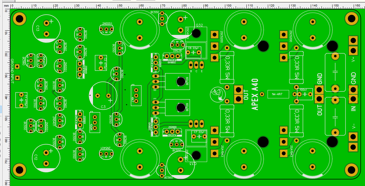

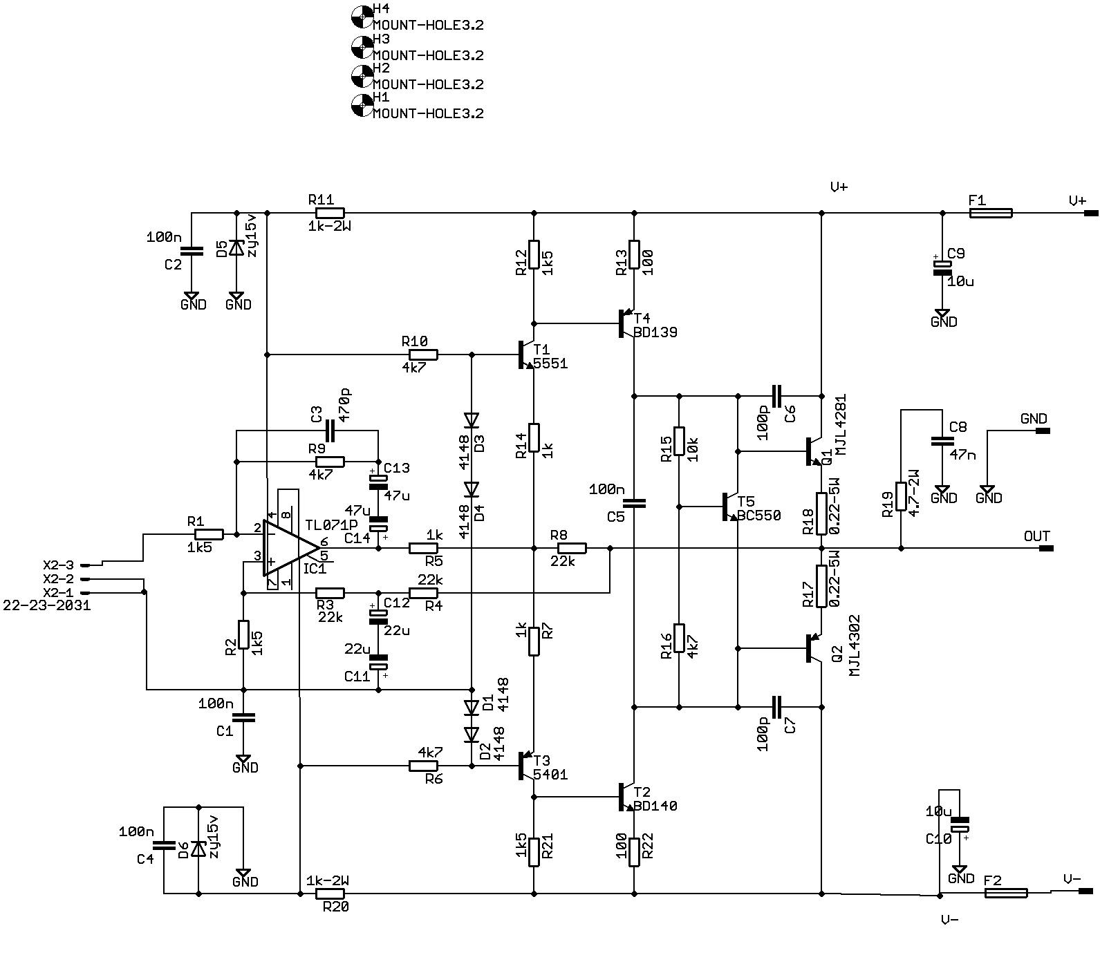

I have try to make B50 PCB layout without darlington output transistor. I am used c4793/a1837 as as a driver and to c5200/a1943 as output just like B500. Please check for any error.
Regards
hello Gurpreet,
I dont know if it will work with 5200/1943 output devices as the gains for BDW devices are very high compare to C5200/A1943.
Also there is much scope to optimize the PCB with regard to traces and component placement. Over the weekend I will try if I can do the layout and share here.

Ok. I have two transformers with 25-0-25 VAC, about 200 VA each. How is my transistor selection above specified? How can I connect SGND with PGND?
Thanks for your reply.
It just means that you take your input signal ground wire and connect to power ground, meaning run the ground to the ground of your PSU board. For me, it’s easier anyway because the PSU is usually closer in most of my builds

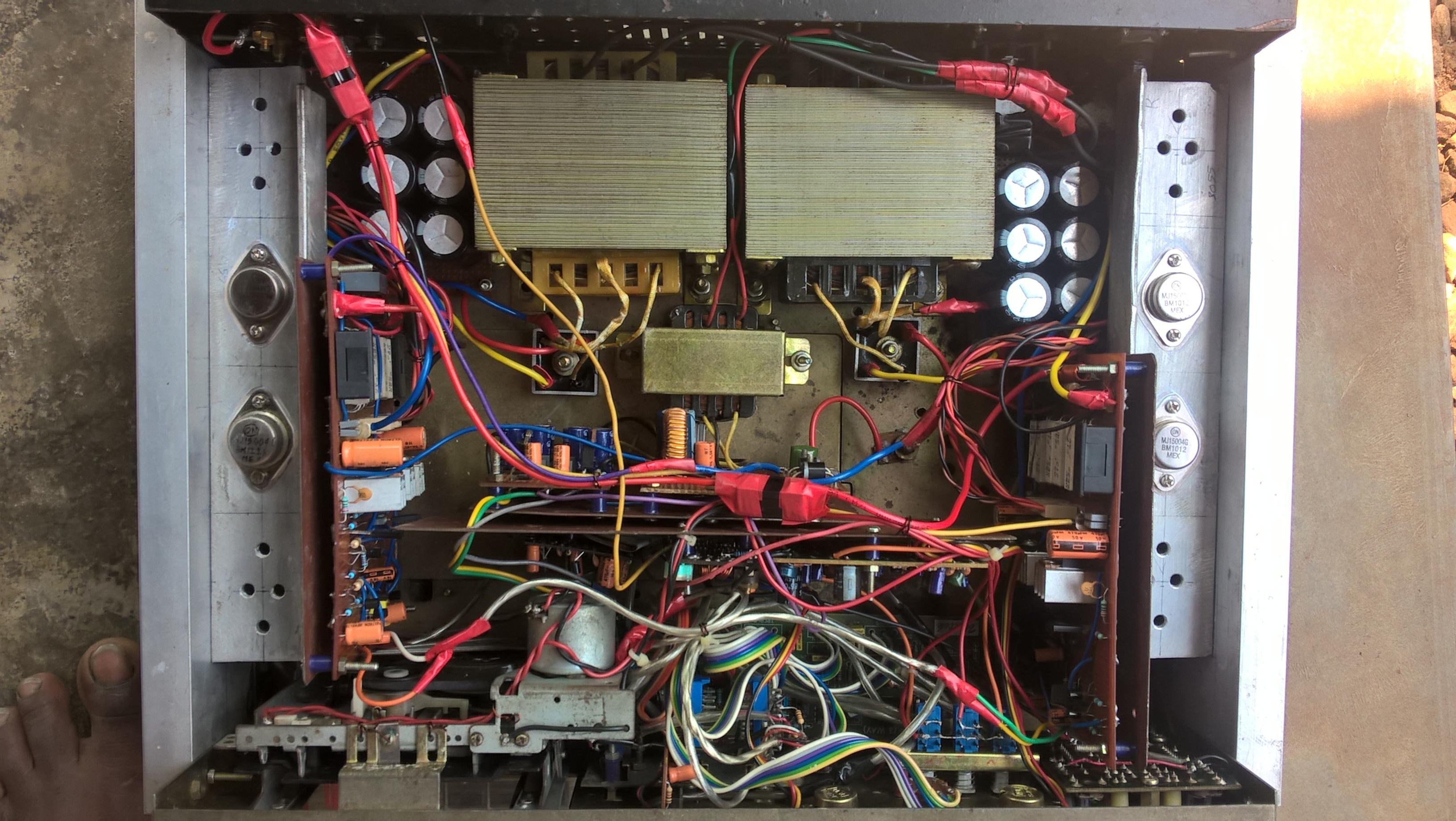

AX14 Amplifier

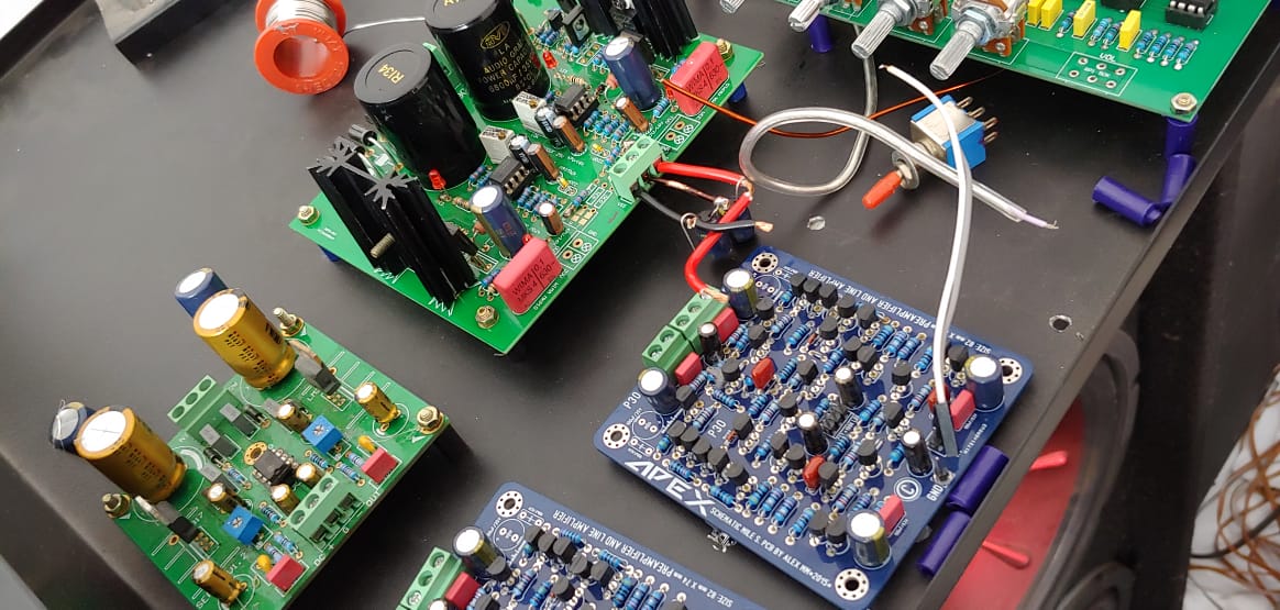

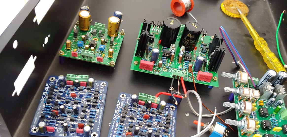

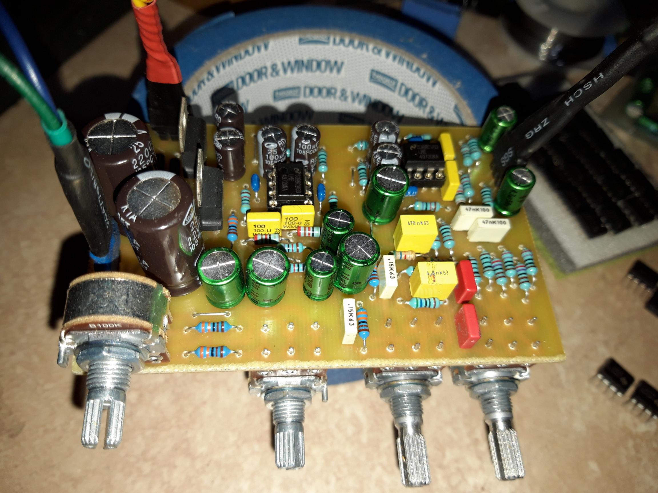

Nice pic sir. I Understand the wirings and completed the system semi finally. Amplifier sounding superb and no humming. Thanks to apex audio for the excellent amp design. Now I need to construct the preamplifier. I am using a tone control with TL072 op amp. Thanks to all once again. Here is some pics.

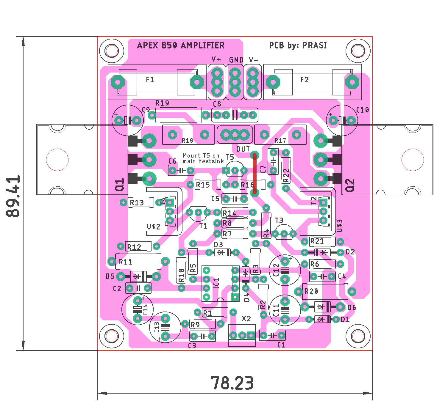

Hello Gurpreet,
here is a rough b50 layout.
Whatever pcb.... ask to Mr. prasi!
We are lucky that we have an expert!!!
Hello brother, long time, no see. busy building any other amp? let me know if i can help with something🙂

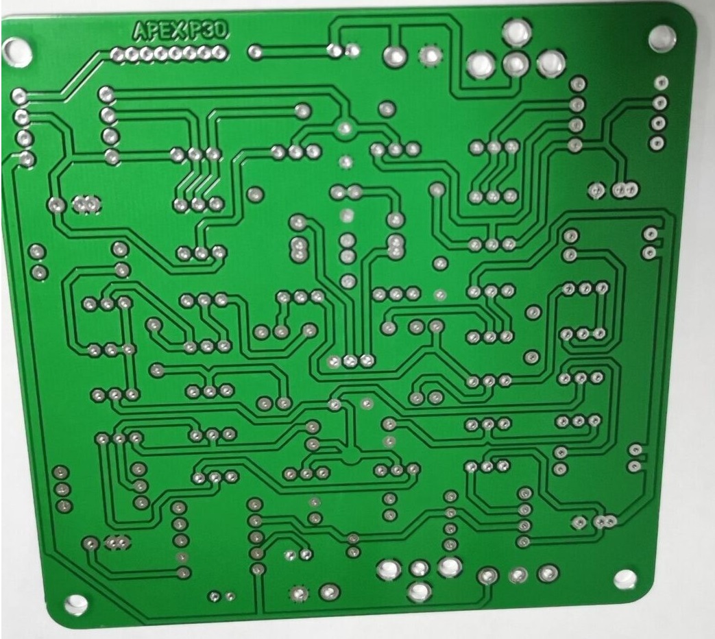

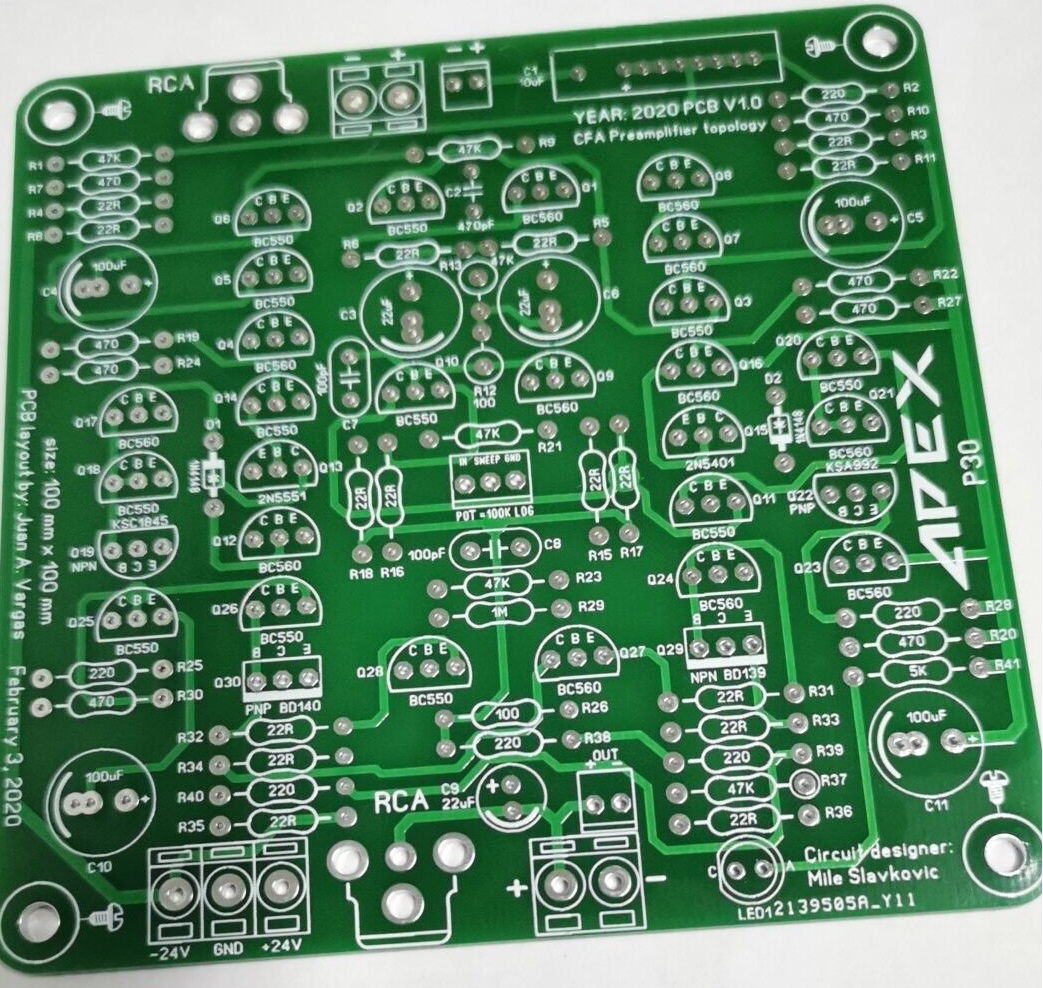

really thimios? what about me? I do my things too lol 😛 I'm just joking bro 🙂 I have the Apex P30 but since the corona virus all shipping are in hold
nice work on the P30 vargas, all the best for your build.
regards
prasi
