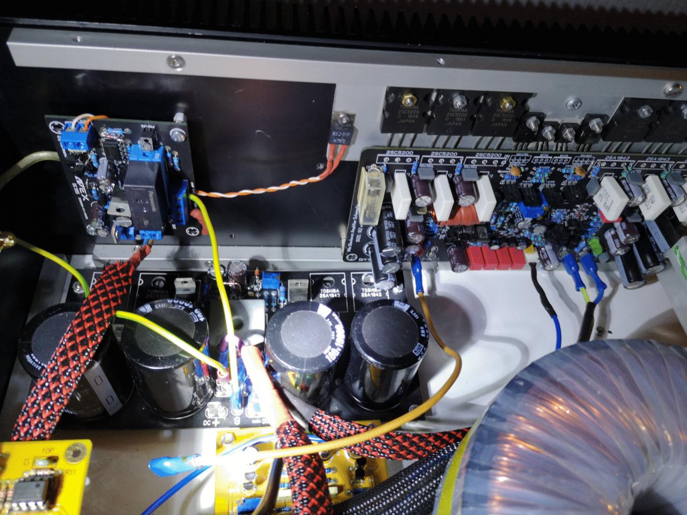

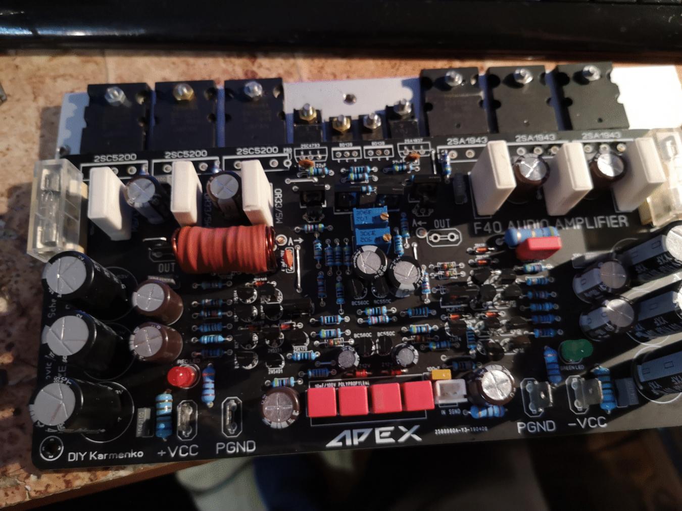

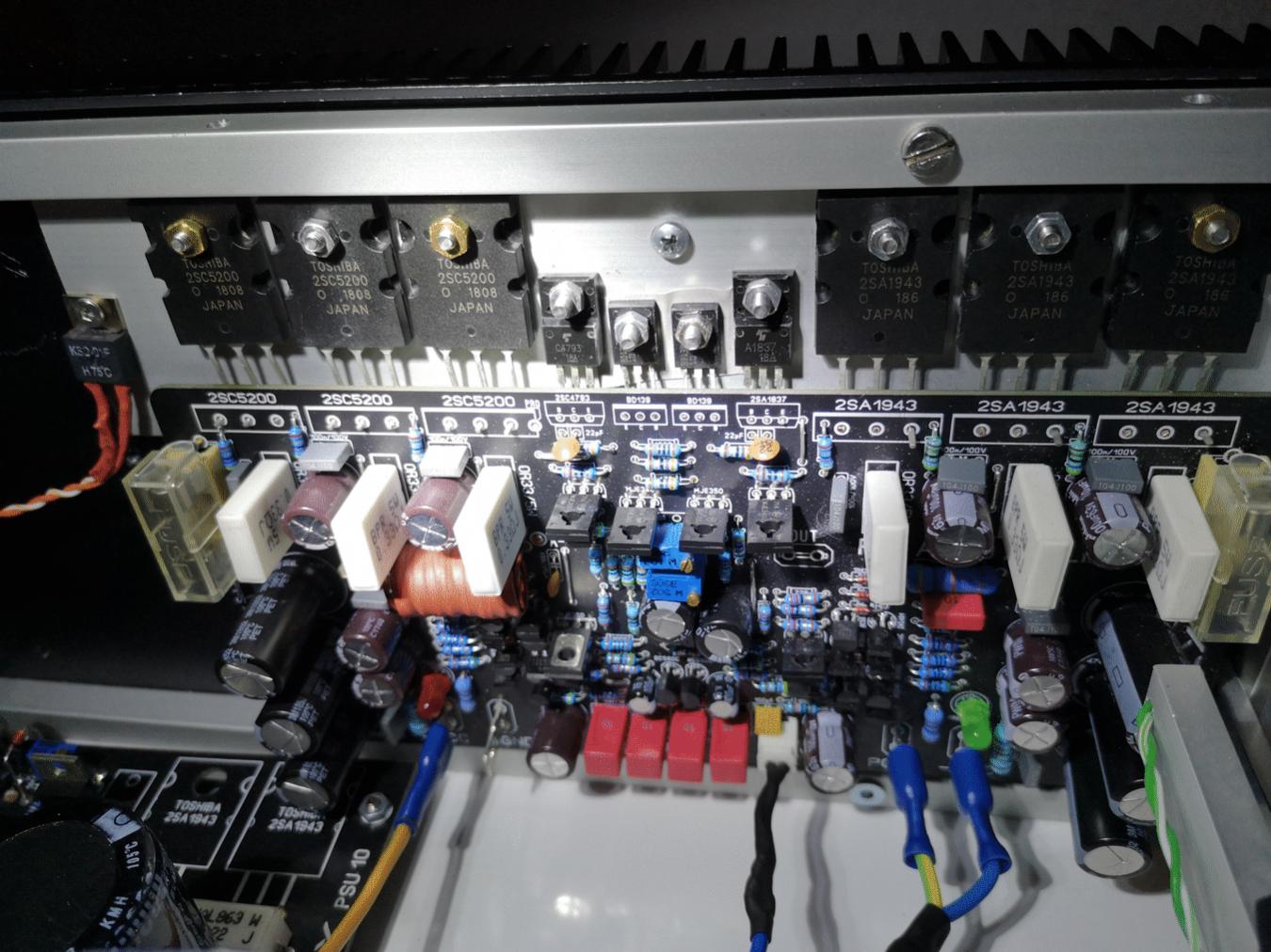

My F40
Is this A40? How does it sound? Bias and offset on it? Voltage you are using?
no it's the F40 that has a mosfet at the entrance
