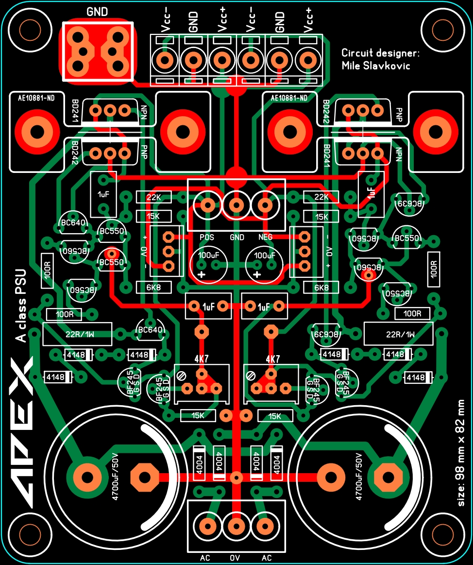

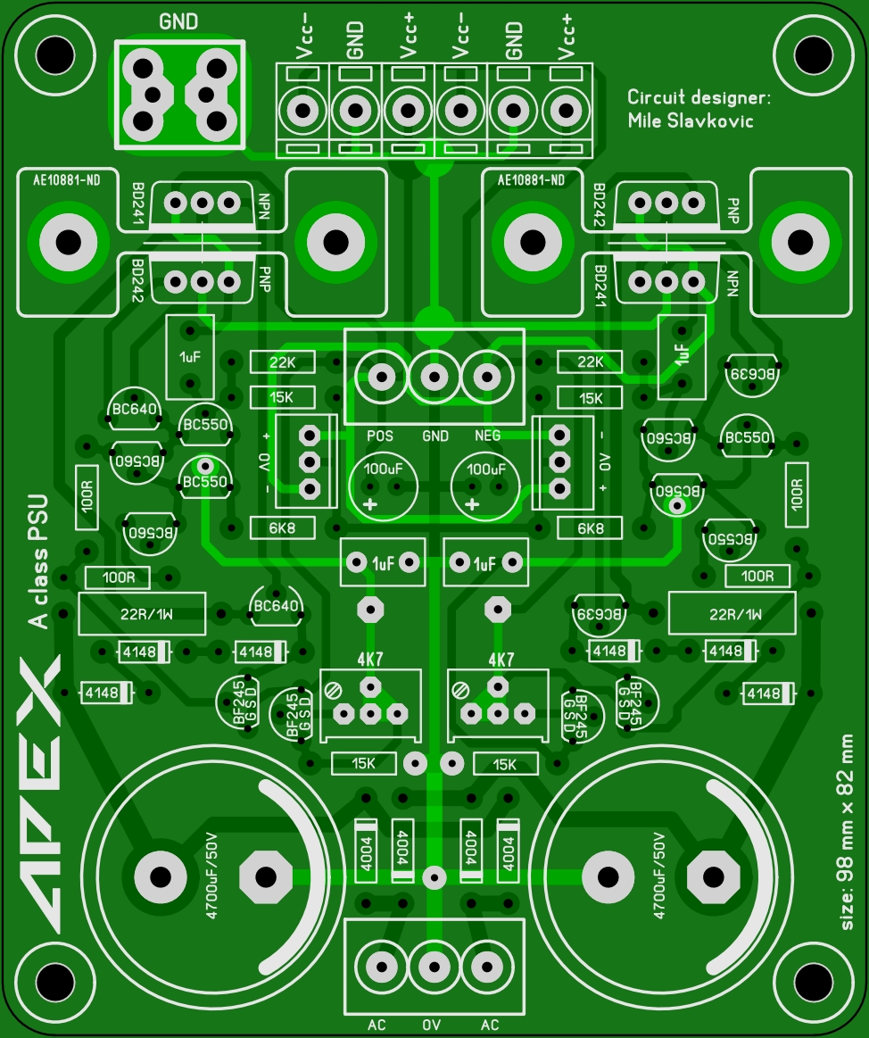

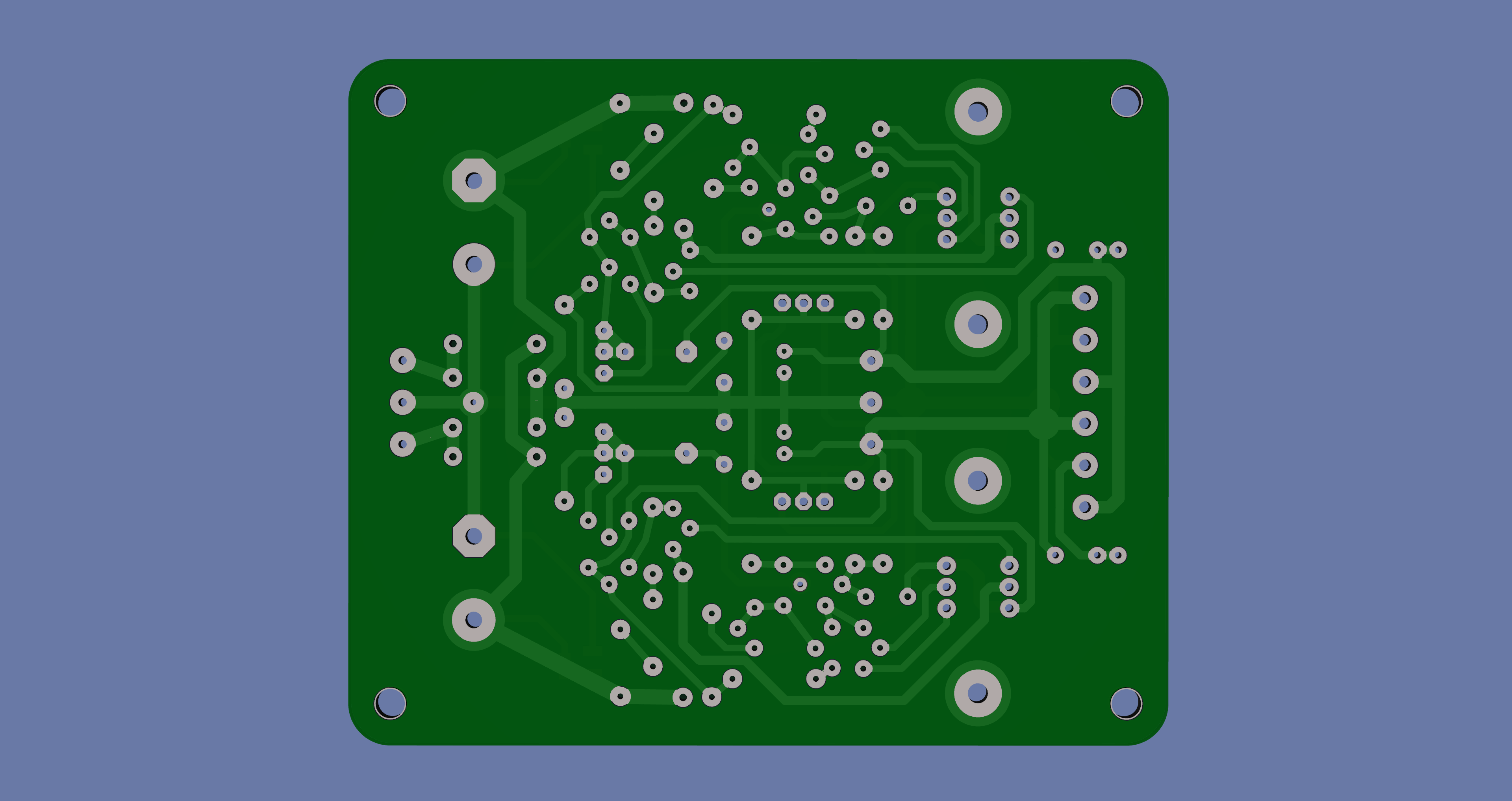

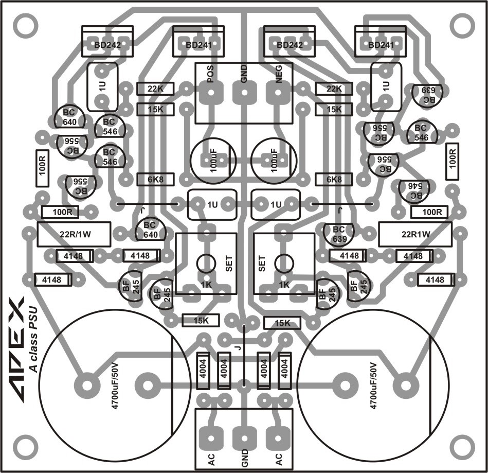

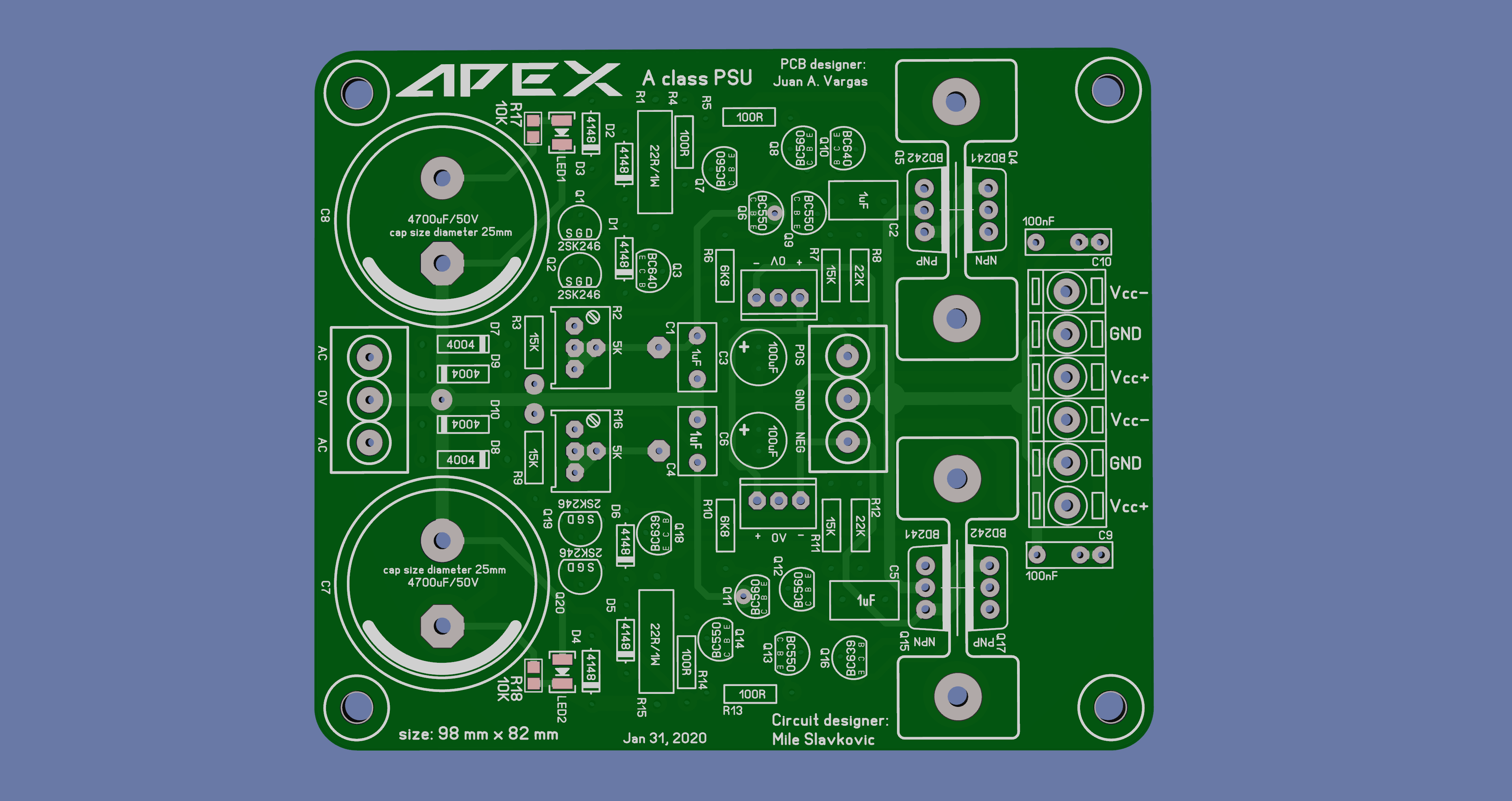

hello guys I kept on re-drawing the A class PSU that Mr. Mile made and I just add a few modern options I would like to know if the BF245A can be replace by other ones or equivalents here are some images and original layout

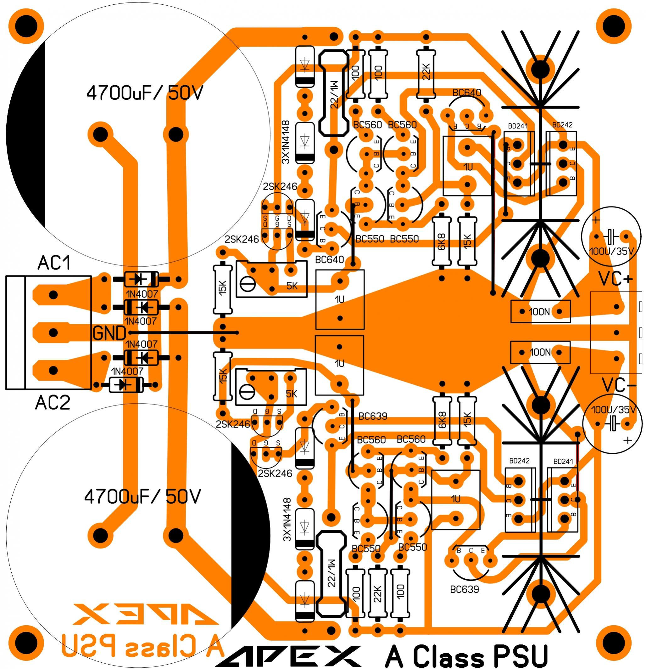

Hi Juan,
I built it with 2SK246 and it works fine but they have a different pinout.
Hi Juan,
oh thank you I can then re-trace them to the 2SK246 pins I was searching online and wow they are gone, and they are some on EBay but I'm afraid of counterfeit semiconductors they scare me

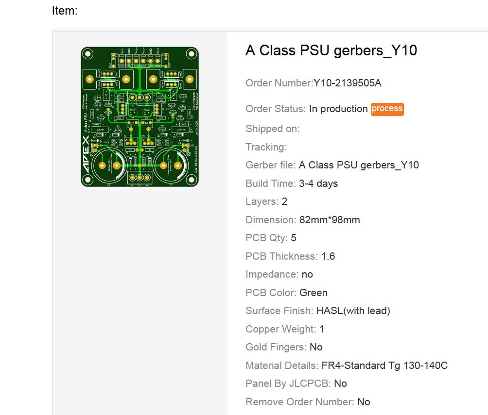

A Class PSU prototype PCB ordered

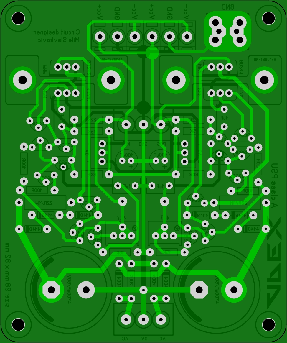

hey guys I check the layout for a few hours and is completed I order just a few to test if all goes well and some one is interesting on the gerbers let me know I don't mind to share at all

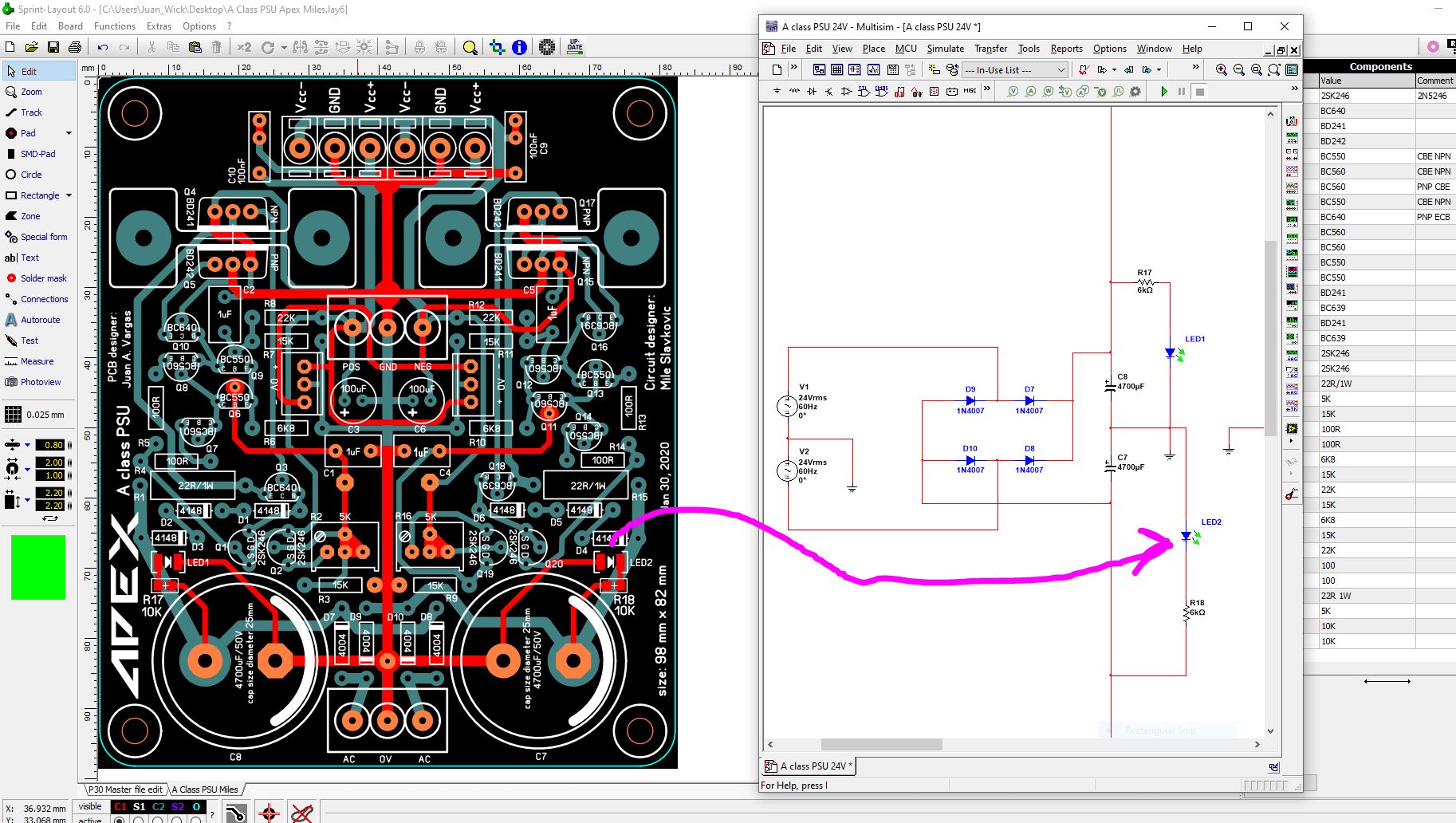

I ask the question about the LED and no one replay is fine I hope all goes smoothly
hhello Vargas could you share me on sprint
sure here sprint file 6
