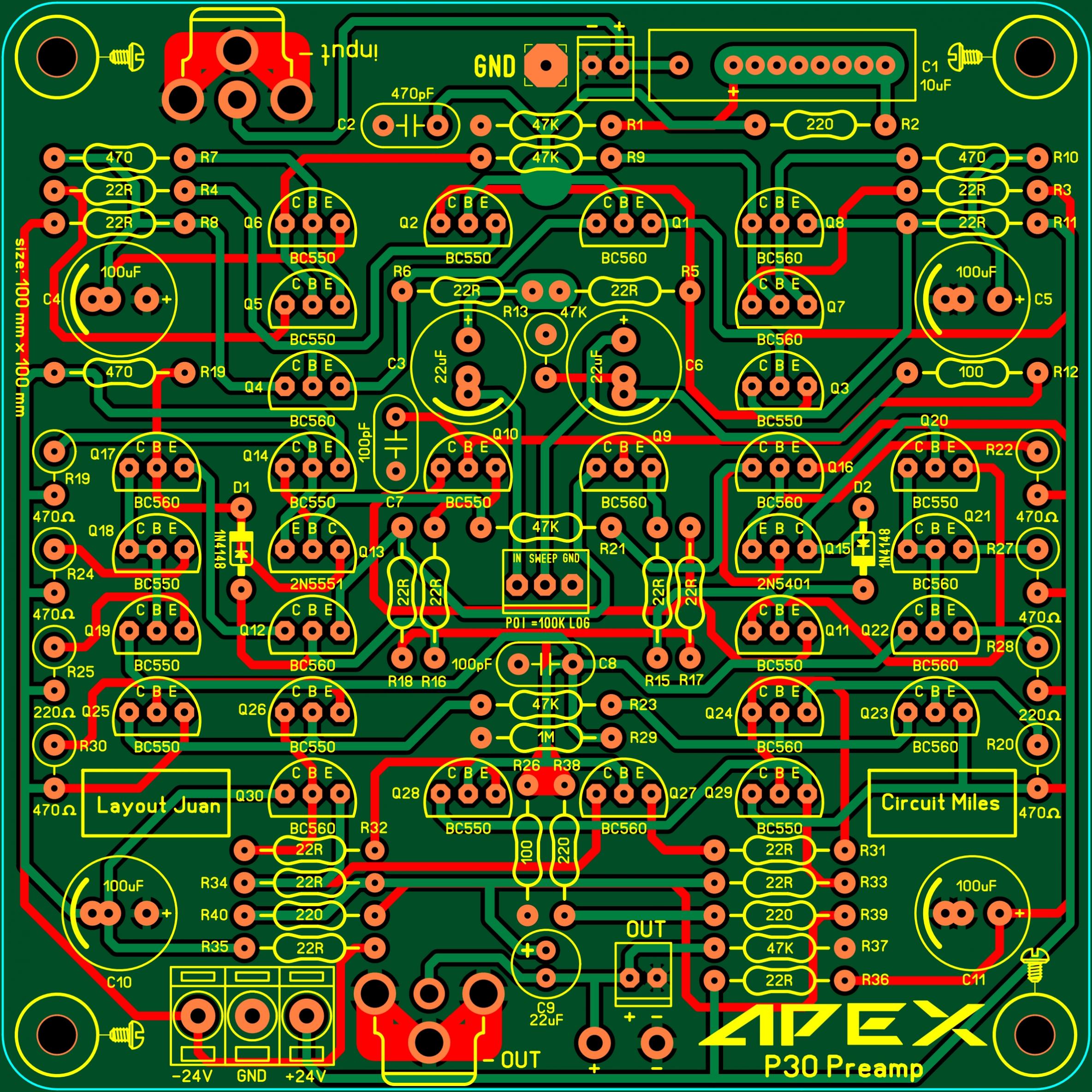

hello that layout is been tested and works well? I'm close to completed my Apex P30 preamp, if possible can you share the gerber files? oh yes I forgot, if some one knows where is the post with the files can some one just replay back here? so I can search for it?

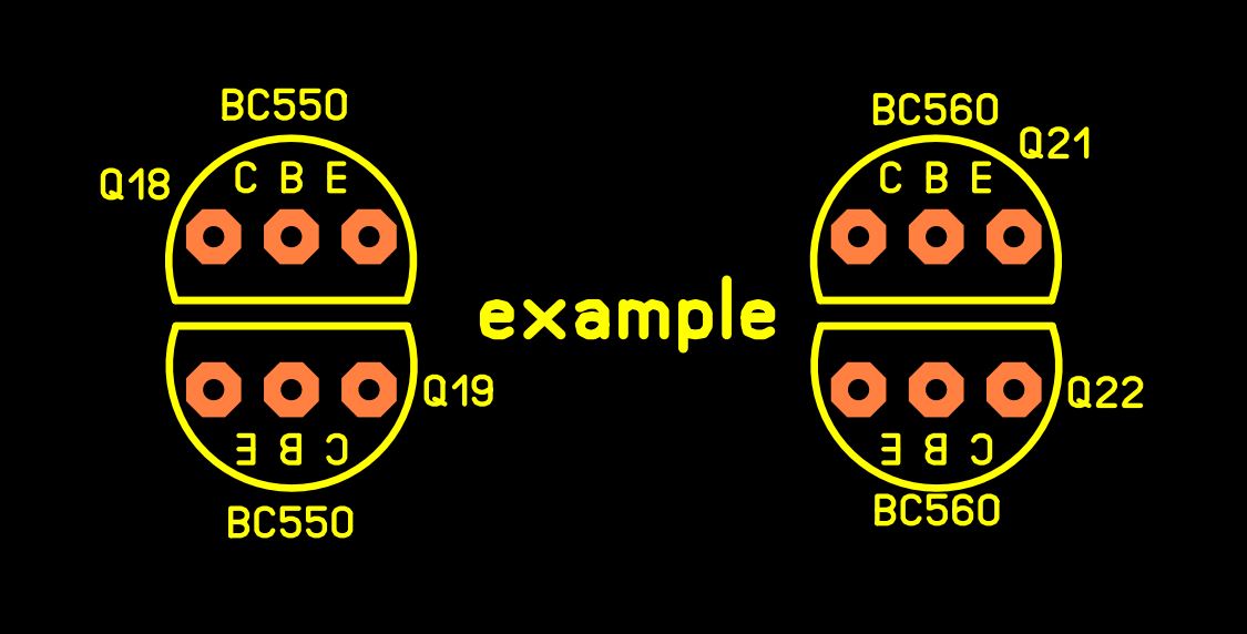

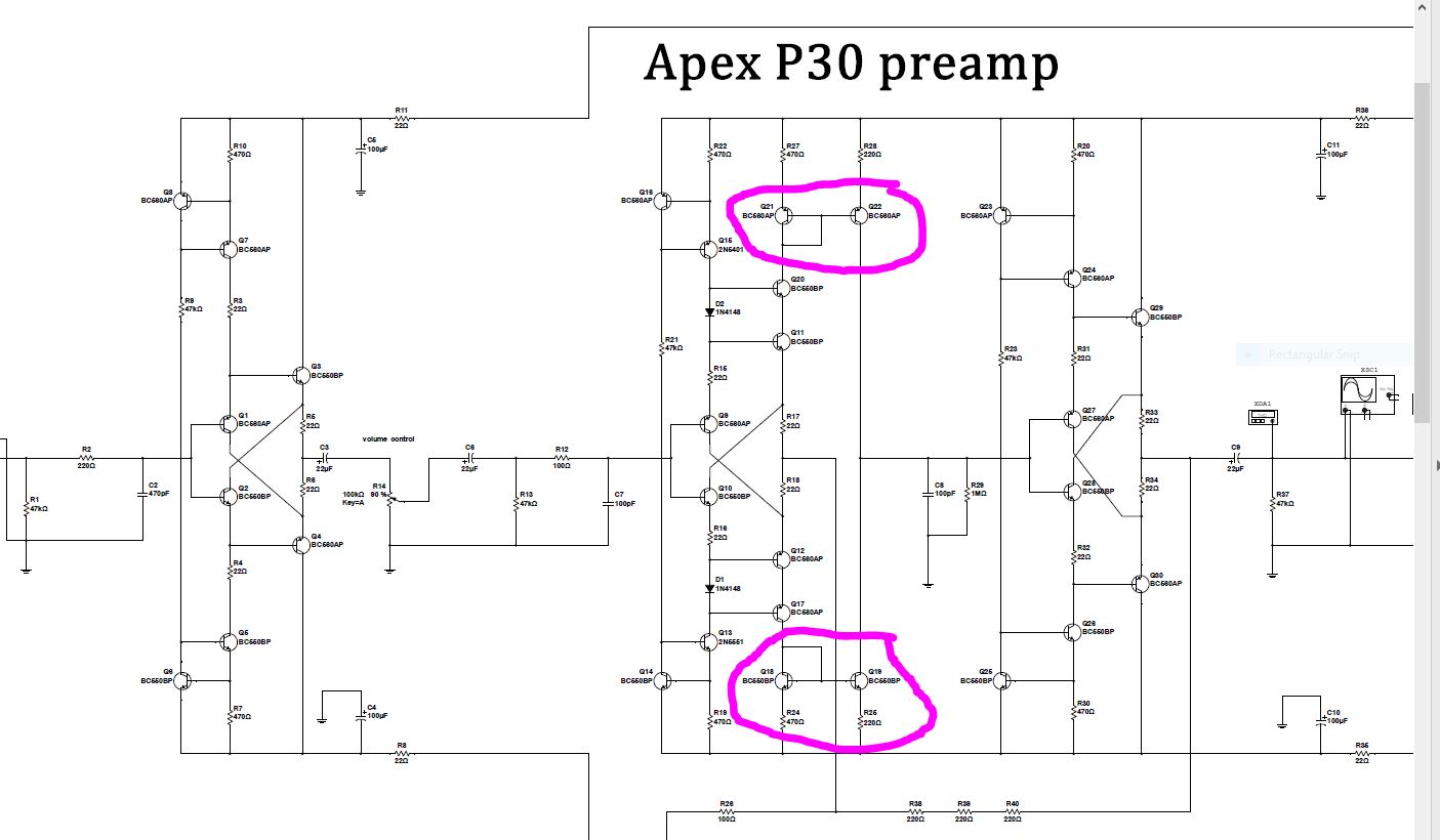

ok I need I suggestion from you guys should I rotated this transistors so they can then share body temperature example Q18 and Q19 facing each other and Q21 and Q22 also facing each other like this small picture example
see generated schematic from simulation

I'm not 100% sure but I think it goes on one of the NPN emitter just wait for other members to respond where that goes just to be sureHi Sir Juan,

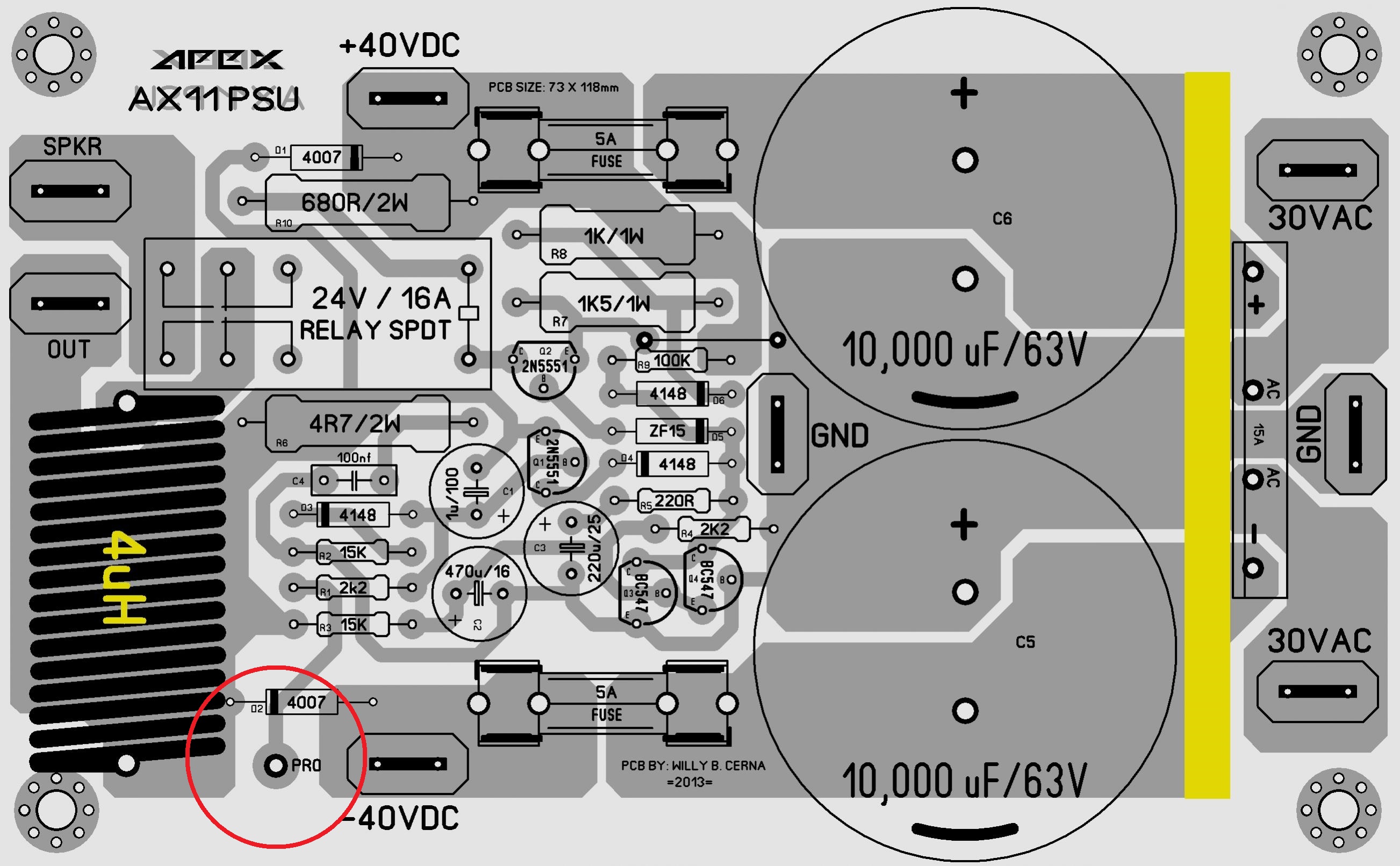

Where/how would I connect the ax11 psu PRO terminal to the ax11 board? thanks much!

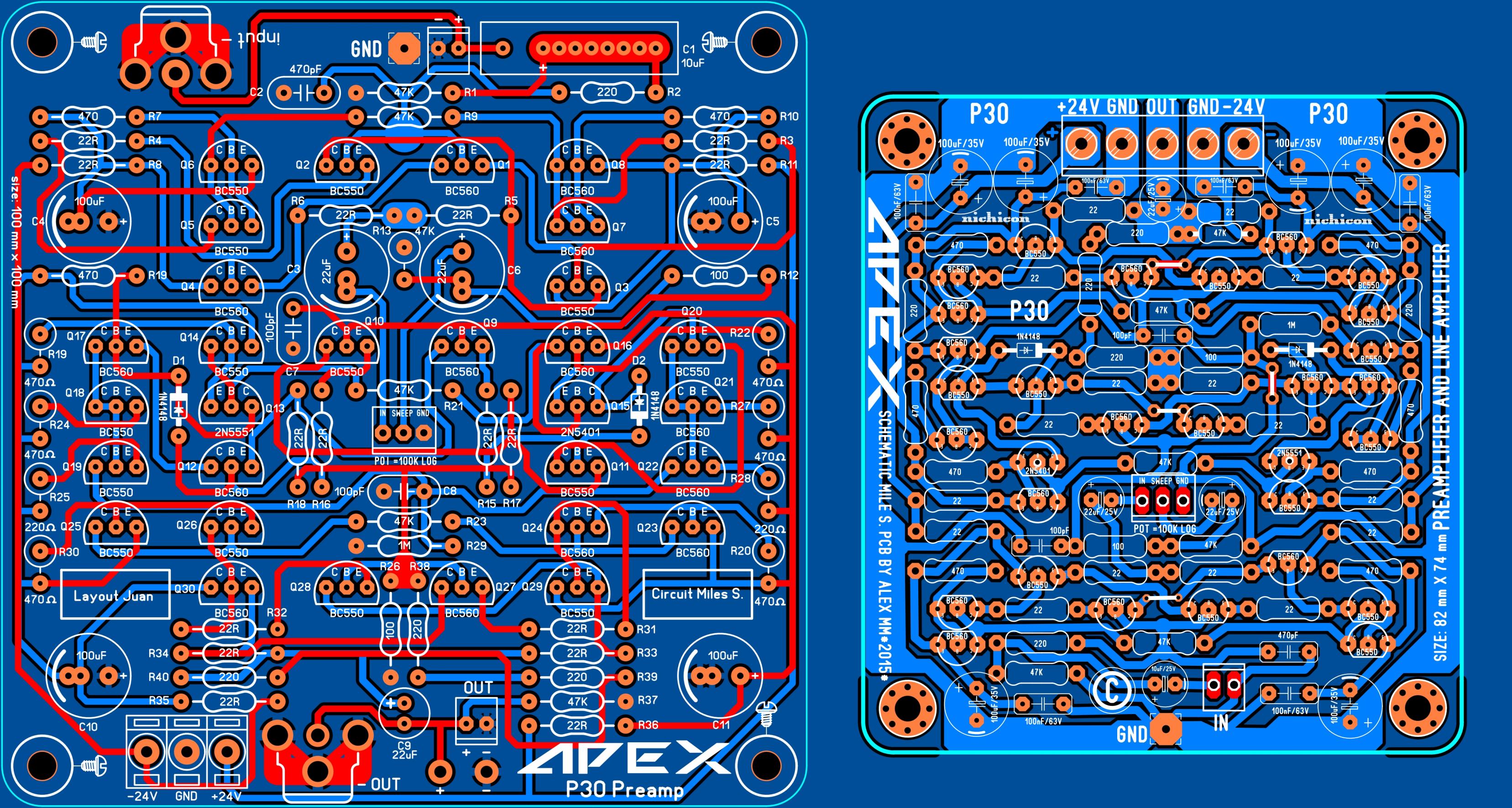

hi guys this is what I got so far Alex's PCB still better design but at least I'm trying to learn from this
ok now I should continue looking for bugs "this never changes"

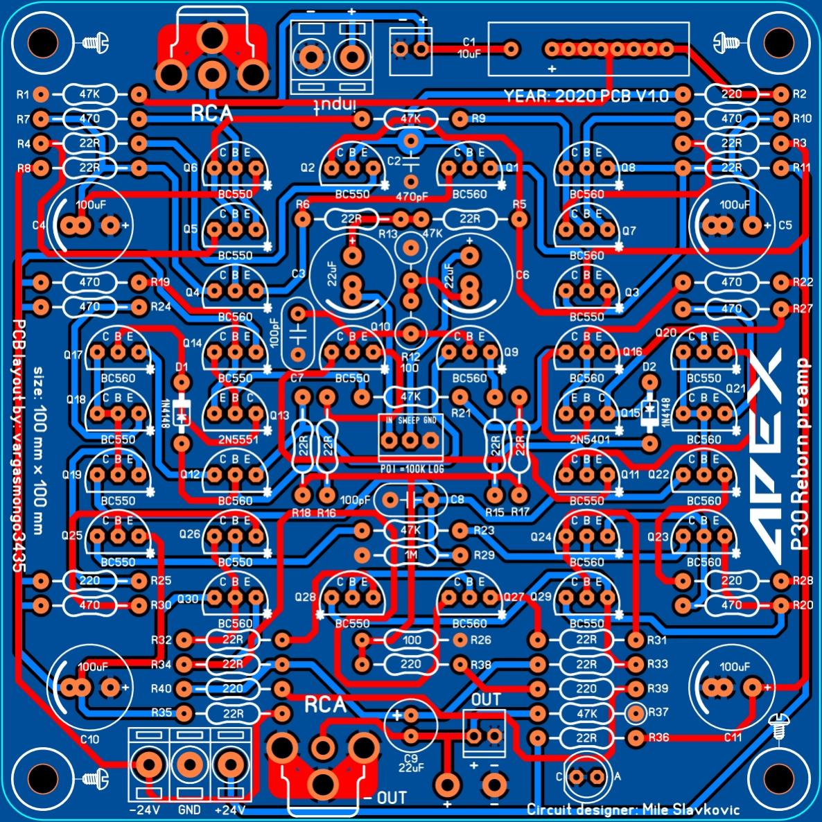

Apex P30 Reborn preamp new PCB design
hello guys I'm coming back with the design is much better than the last time I will give a careful look one more time is done but I want to be sure before I order a sample for prototype
questions, can I add LED's to the board to indicate power on? or is not convenience because can cause distortion to the preamp? by the way olafk made this nice 24V power supply will it work fine with the preamp Apex P30? and lastly how many VA volt amps I need for the transformer?

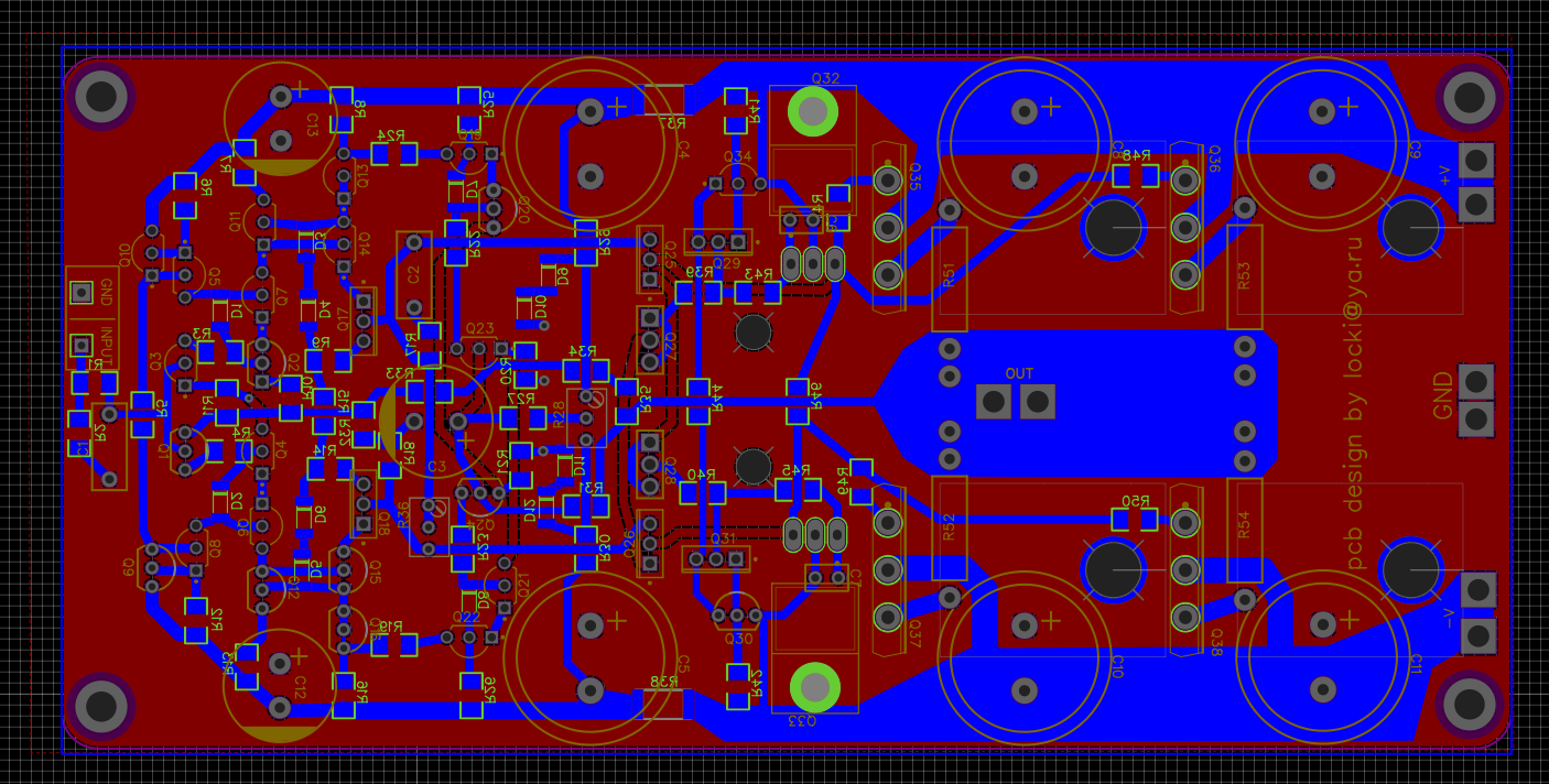

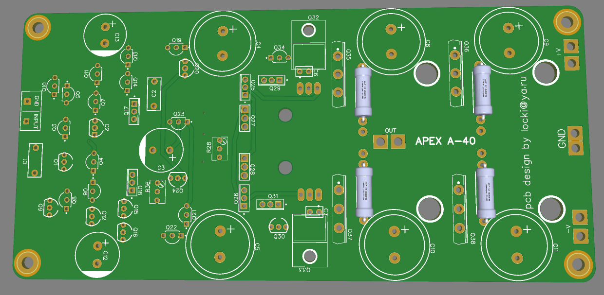

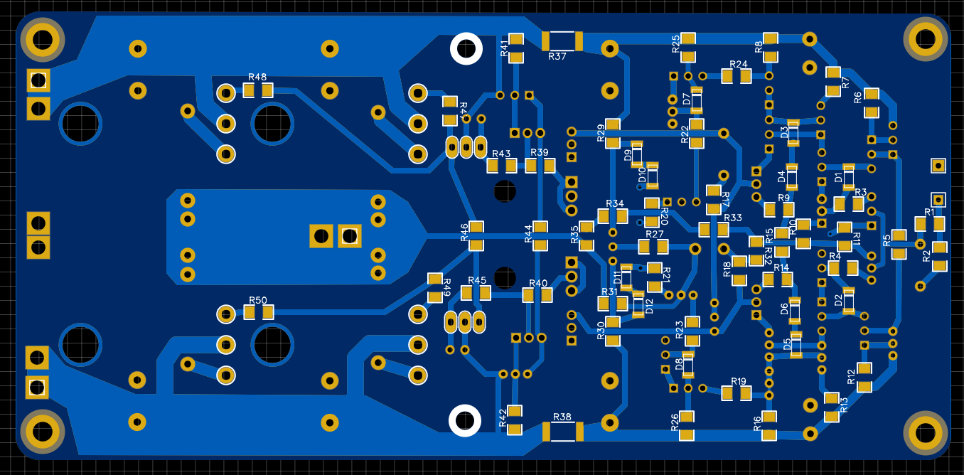

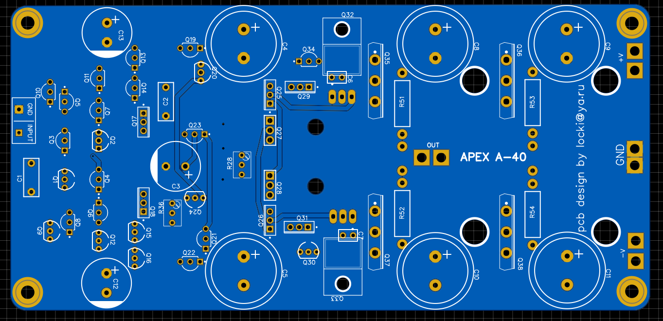

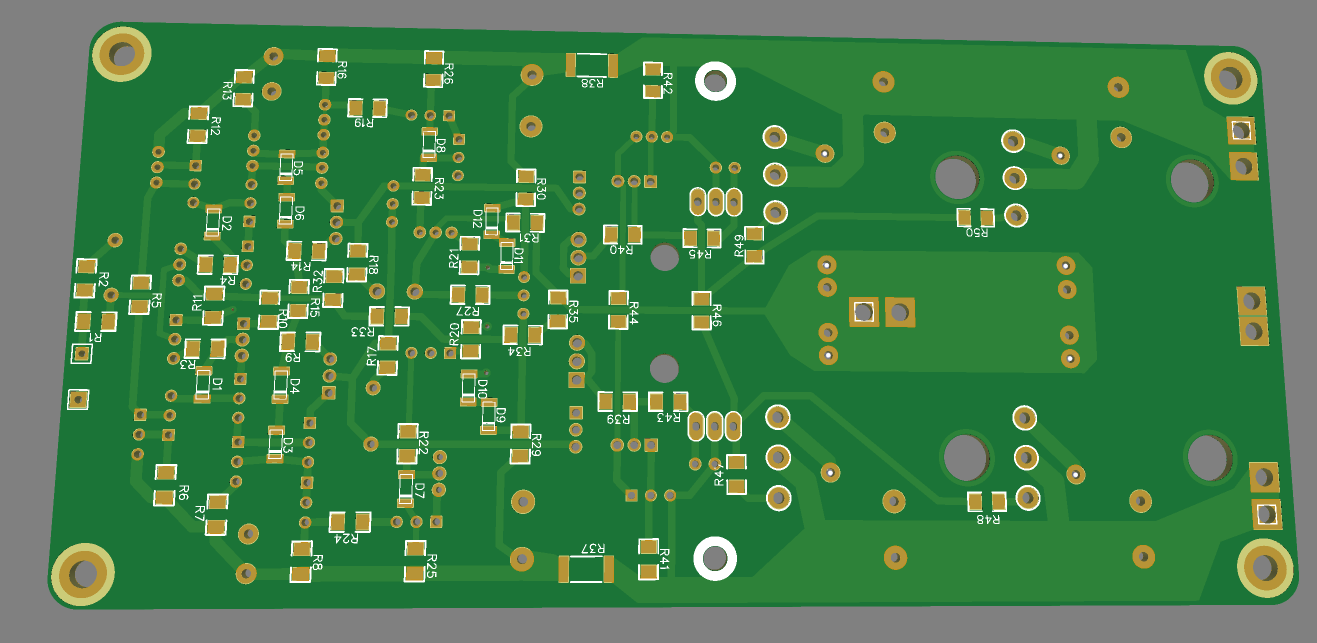

A variant of my quick wiring of the apex a-40 boards. If people like it (need it) - Gerber in the application.

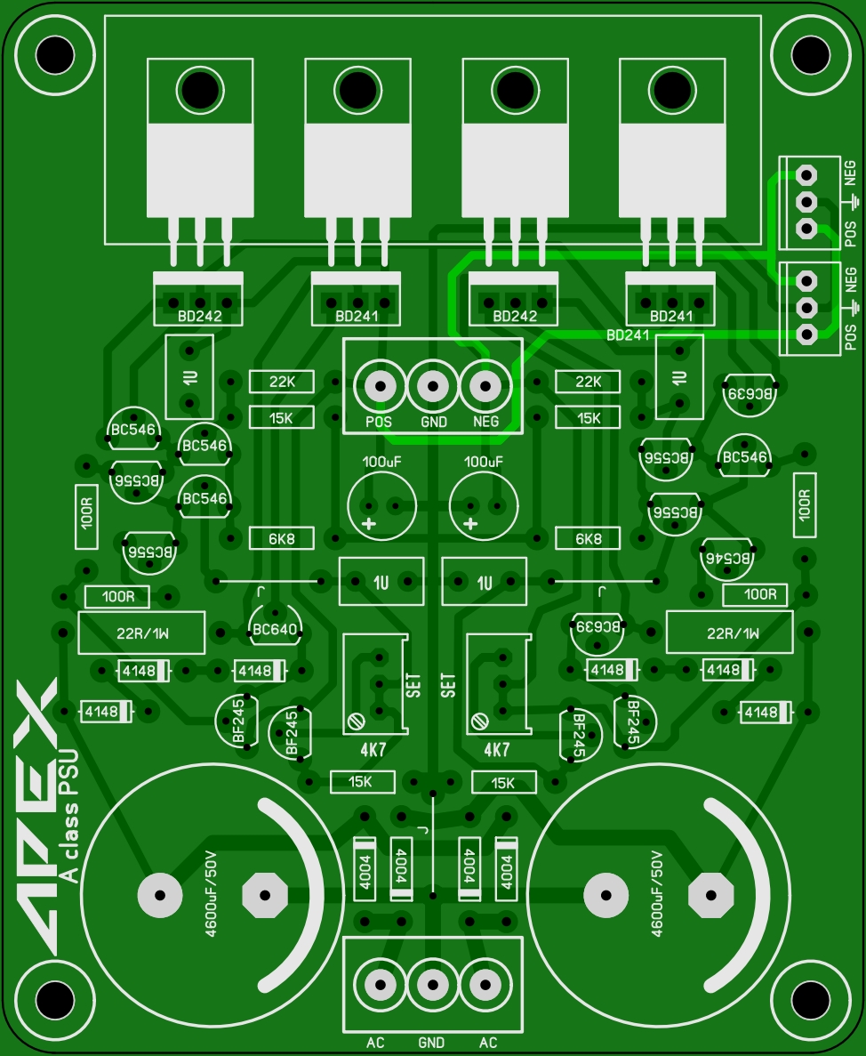

hey guys I'm gonna leave here the class A PSU can you guys take a look to see if I got it right?
sorry I forgot to mention for Sprint Layout 6 users this is not been build yet from this layout yet
not tested yet in real time till is 100% sure

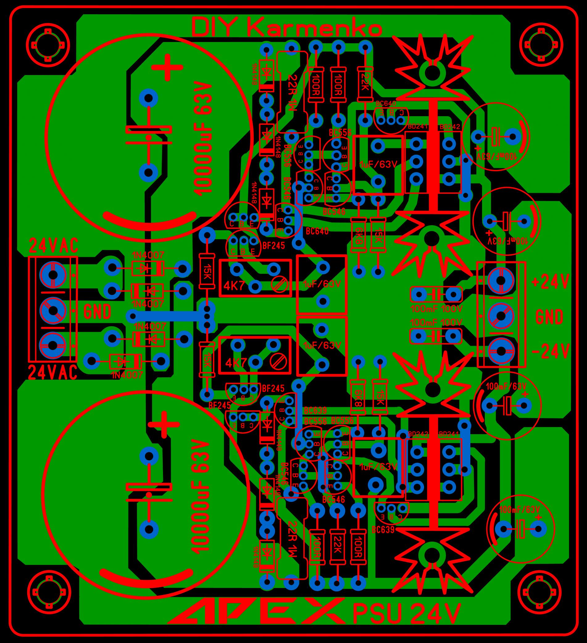

PSU 24 v Class A
thank you I been looking for this file for a long time I guess I can just leave the one I was making for later
sorry for come back again have you build this layout? can you post pictures please

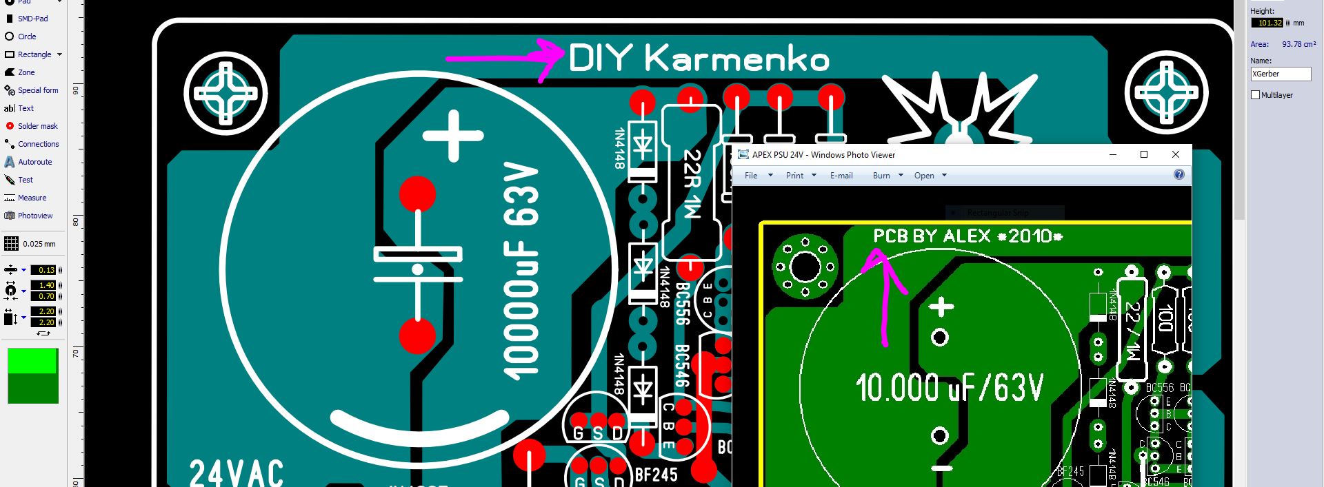

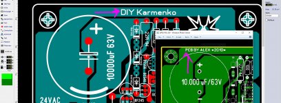

hey Karmento 46 not to complain here but keep in mind that Alex MM is the one who make this layout at least change the name to his name if I order I will leave his name on the PCB that is fair he done so much for us that he deserve respect you know keep his name on the design I use to do that a long time ago and I learn not to do that, and give credit to him he deserved
First of all, I would like to thank Slavkovic whose scheme, and Alex, it doesn't matter that I put my name on, I put it for a reason because I was drawing this dog because I couldn't get the files
and my plate is double sided so isn't it diy Thanks!
24V PSU

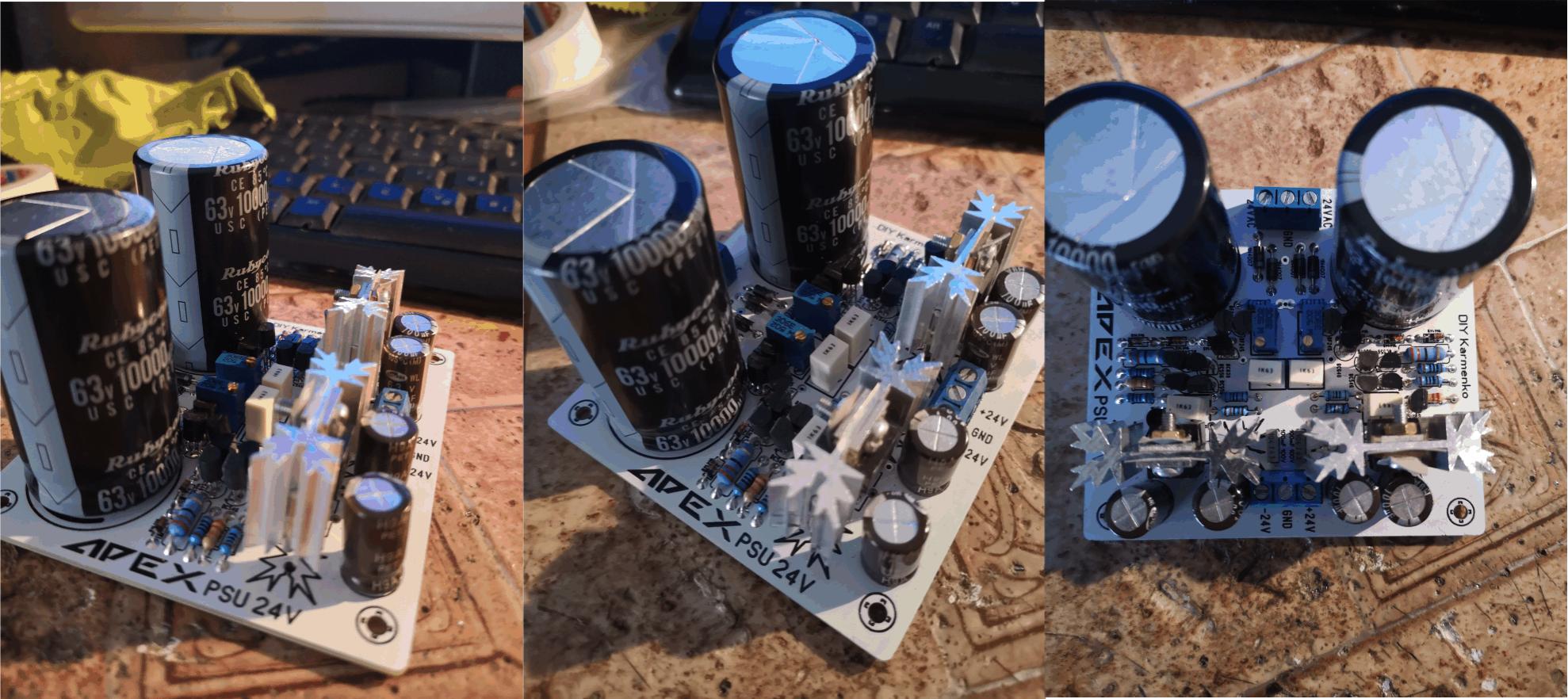

excellent look great nice build, sir question did you found with no problems the semiconductors BF245? they are 4 on the PCB does the regulator perform really well the adjustment work ok I'm asking because I haven't see not many pictures of the build PCB by the way I have the new Apex P30 layout if I tested and work correctly I will share gerber and Sprint Layout 6 files here but I need to be sure is correct before I order a few sample PCB to tested
