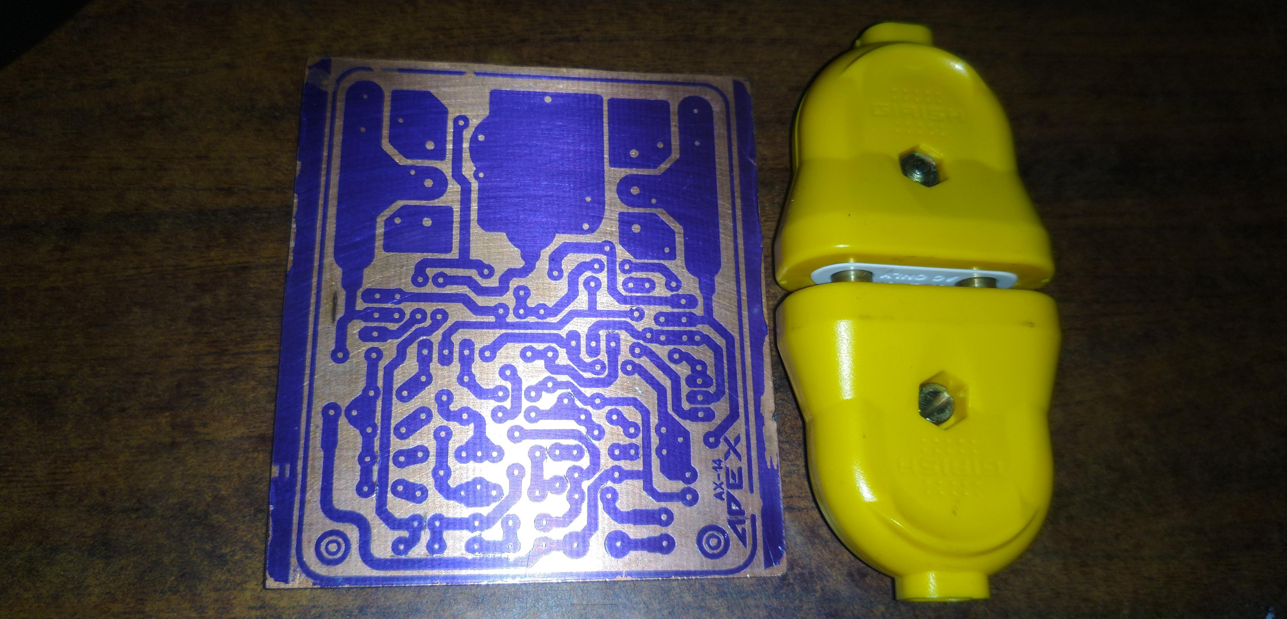

Hassan i have done a short google search "apex ax17" and found different examples for
layout, parts placement so on..
Only for example alex mm is one of the master in PCB design here.
Look here in the thread: #2918
100W Ultimate Fidelity Amplifier
You can see sgnd is connected to gnd via 10 Ohm resistor (ground lift), also Emitter R27/28 are connected together to Output.
I don't see that in presented file of layout? R27 is connecting Transistor Emitter to ground only.
You can also see in alex layout the 10 Ohm/3W-R29 is going from output to 47n- C10 and
than connecting ground, i think it should work as R-C network together, i've never seen it that way.
Could this work too, that way?

R28/R27 connected together with jamper....pcb is correctly...
i confused abut ax17....
i see many pcb of ax 17...i check my pcb with schematic...step by step...every thing be ok....just i read in forum that c6 replace 1000uf/16v....and replace R21 whit 1/5k....but yet have problem....maybe my mistake..tommorow i check every thing again....a have problem too with fh11..but mr mail help to solve that..
Ok, that comes in mind as i wrote here.
I also don't have build this AX17, but for SOA of 1943/5200 is max +/- 42V more safe
with 8 Ohm load only.
For Test add some power R of 10Ohm/5-10W in each supply line.
Have you connected sgnd to Pgnd now? as suggested, also a 4,7-10 Ohm R can be used to
connect it, sometimes helps.
You can also compare to Alex PCB to yours for differences.
Maybe your start with 50 volt was to high for any transistors?
Let us know your next steps of testing, so experienced members will help with more
advice.

very tanx that help me...im not in home...when come back do it and tell to you what happened...best wish for me and you.

hi again....today i connected a 10R/3watt resistant between ground and signal ground....and connect psu....no pupop....no noise...no hom...ax17 work properly...tnx a lot. i use 6 ohm duble woofer for sony vx333.
