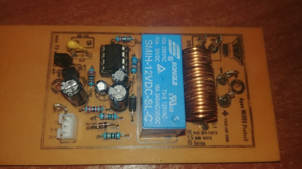

protect ne555 with zobel
Hi dear apex I have the protect ne555 with zobel, but the PRO option is activated with mv at the output when the amplifier volume is increased. the protection dc works perfect but the pro is the problem I can leave it disabled without connecting but if it has the option it would be good to leave it active some modification so that it is not so sencible
