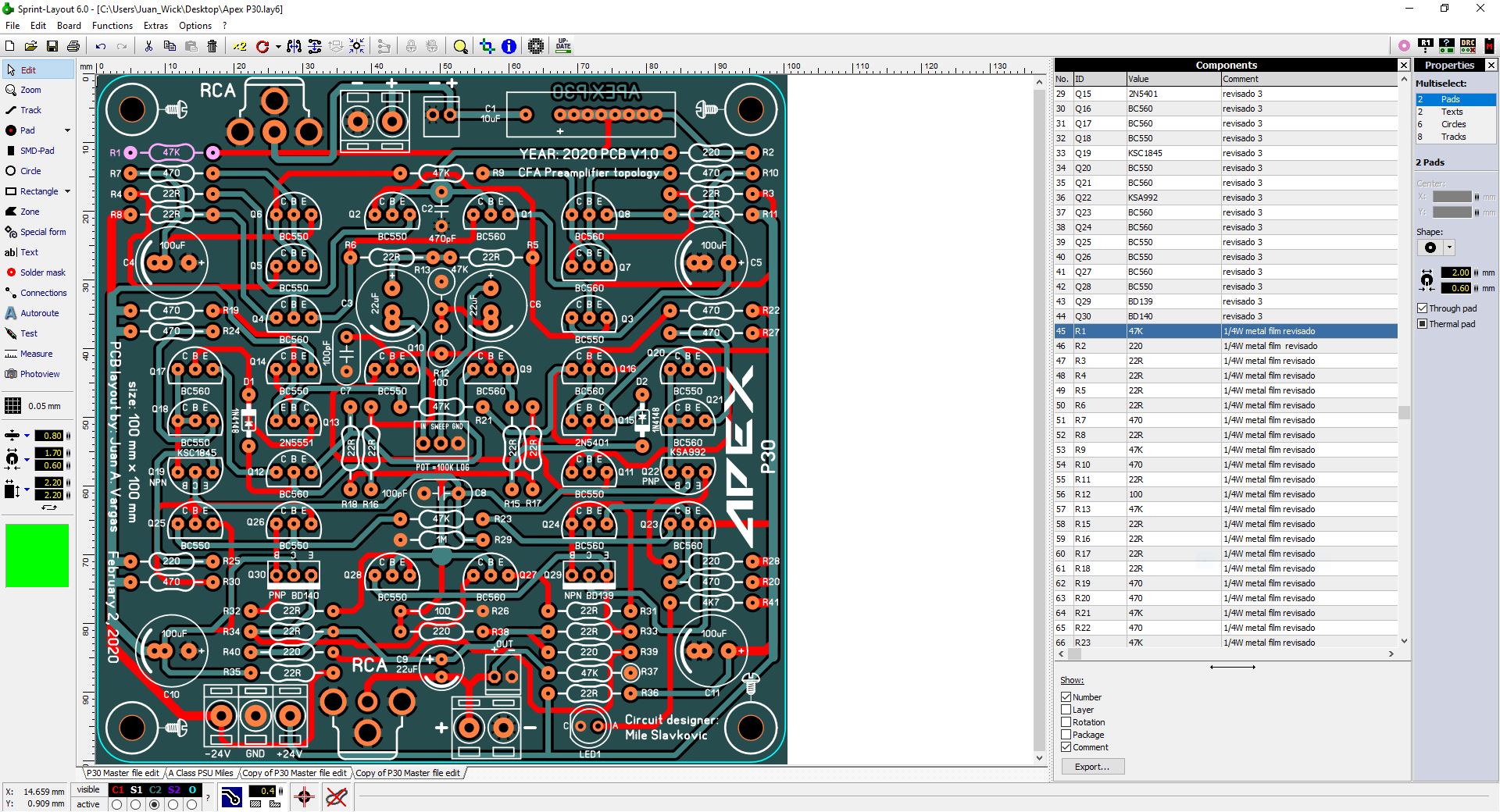

Great job on the PSU design - instead of changing and re-routing the mosfets, wouldn't TIP31/32 been a decent replacement? I'm not sure, that's why I'm asking.

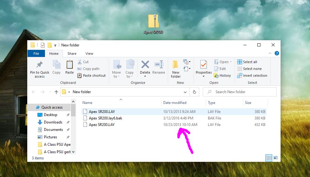

Also - any chance you have Lay file, or gerbers for the SR200 type of PCB design?
since the original design works fine I didn't want it to change it too much,
oh the SR200? yes I do have it is a copy from Alex layout so please make sure is correct "those are the years where I was learning to use the software in 2013 😛
