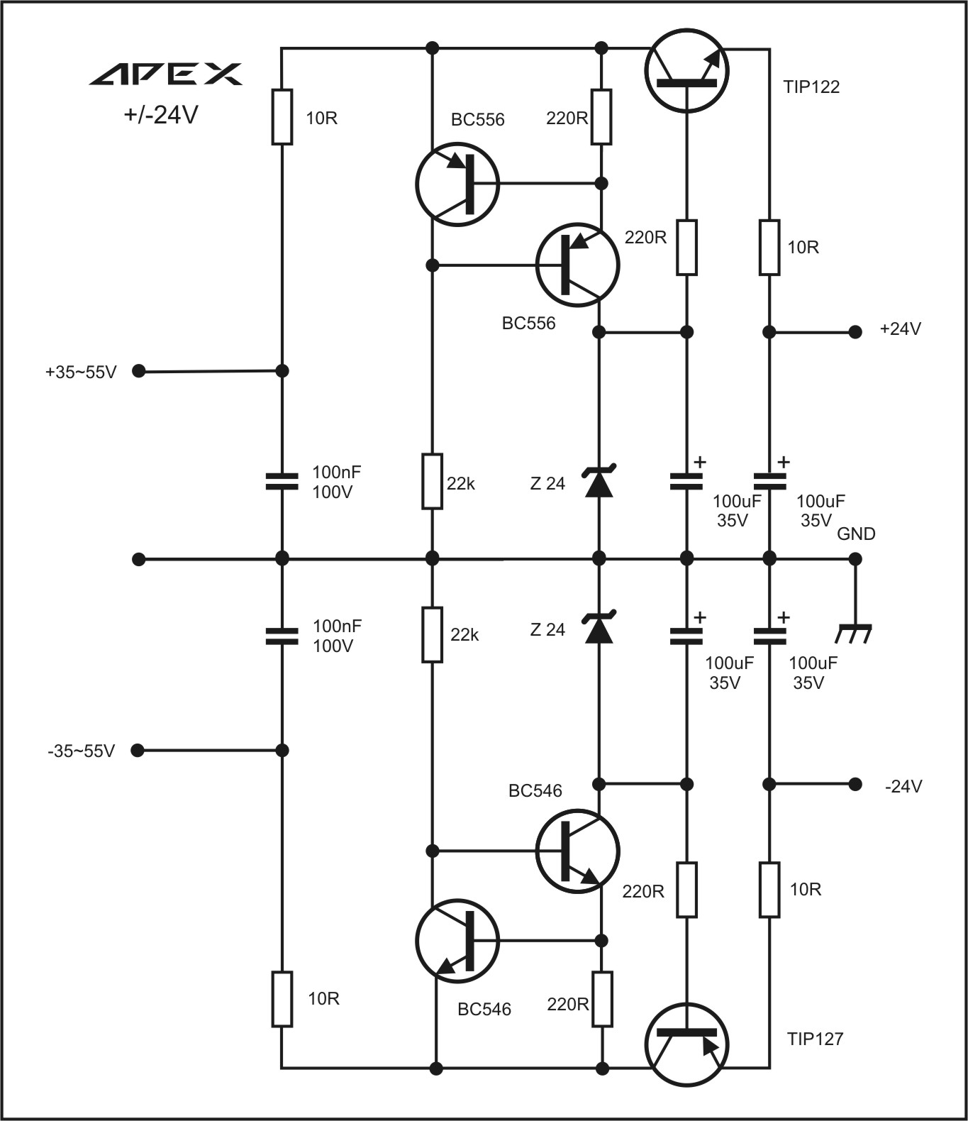

+-24V power supply

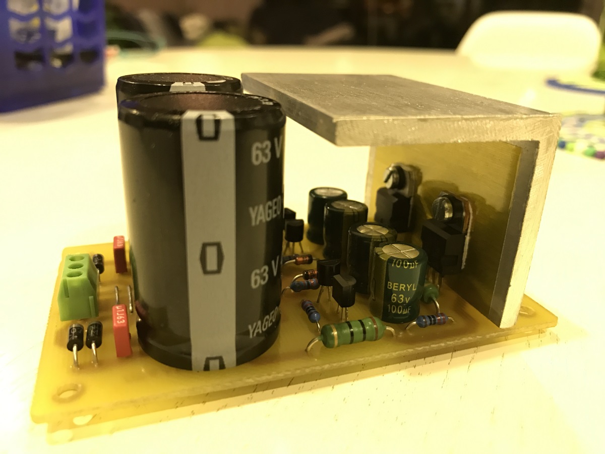

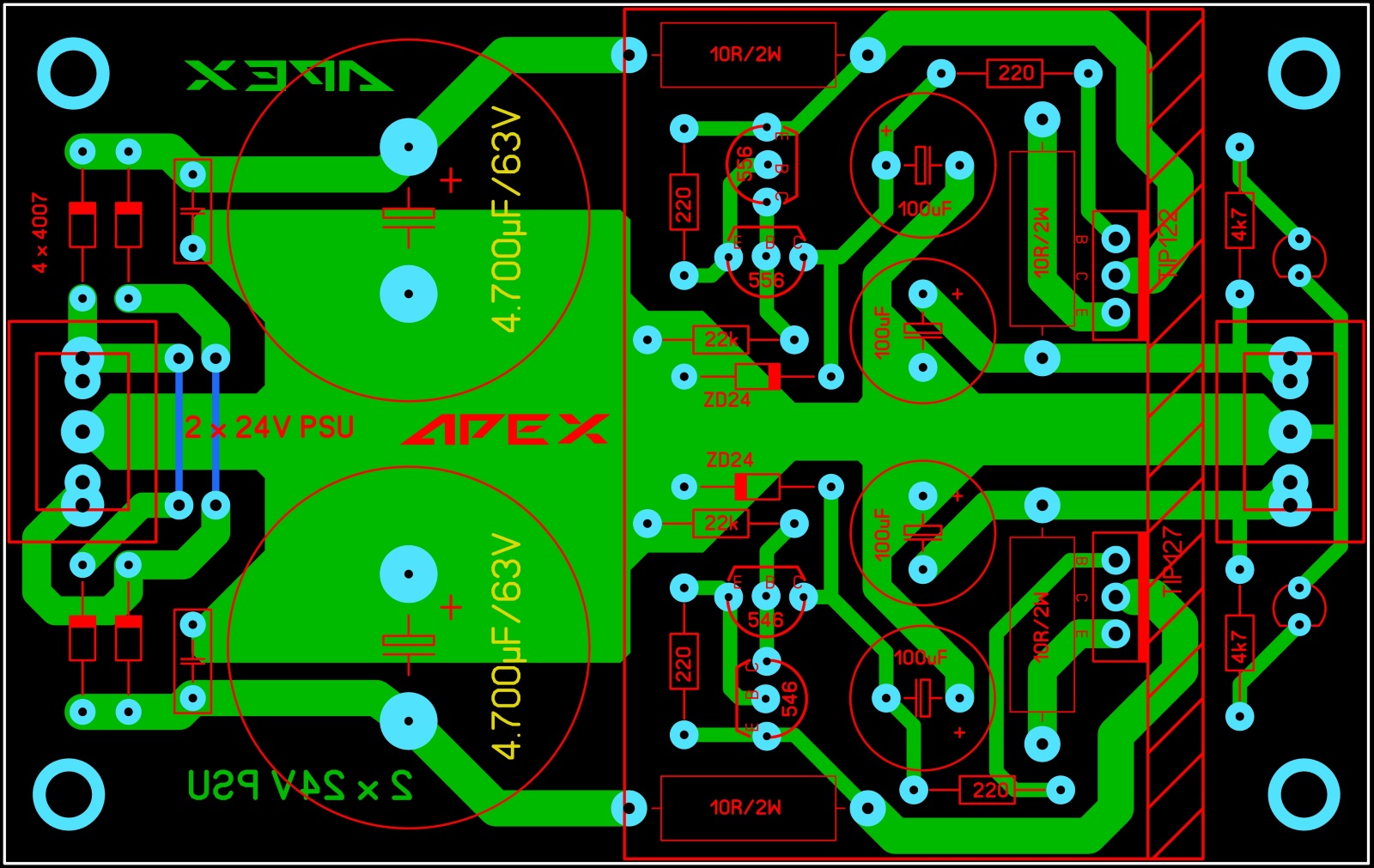

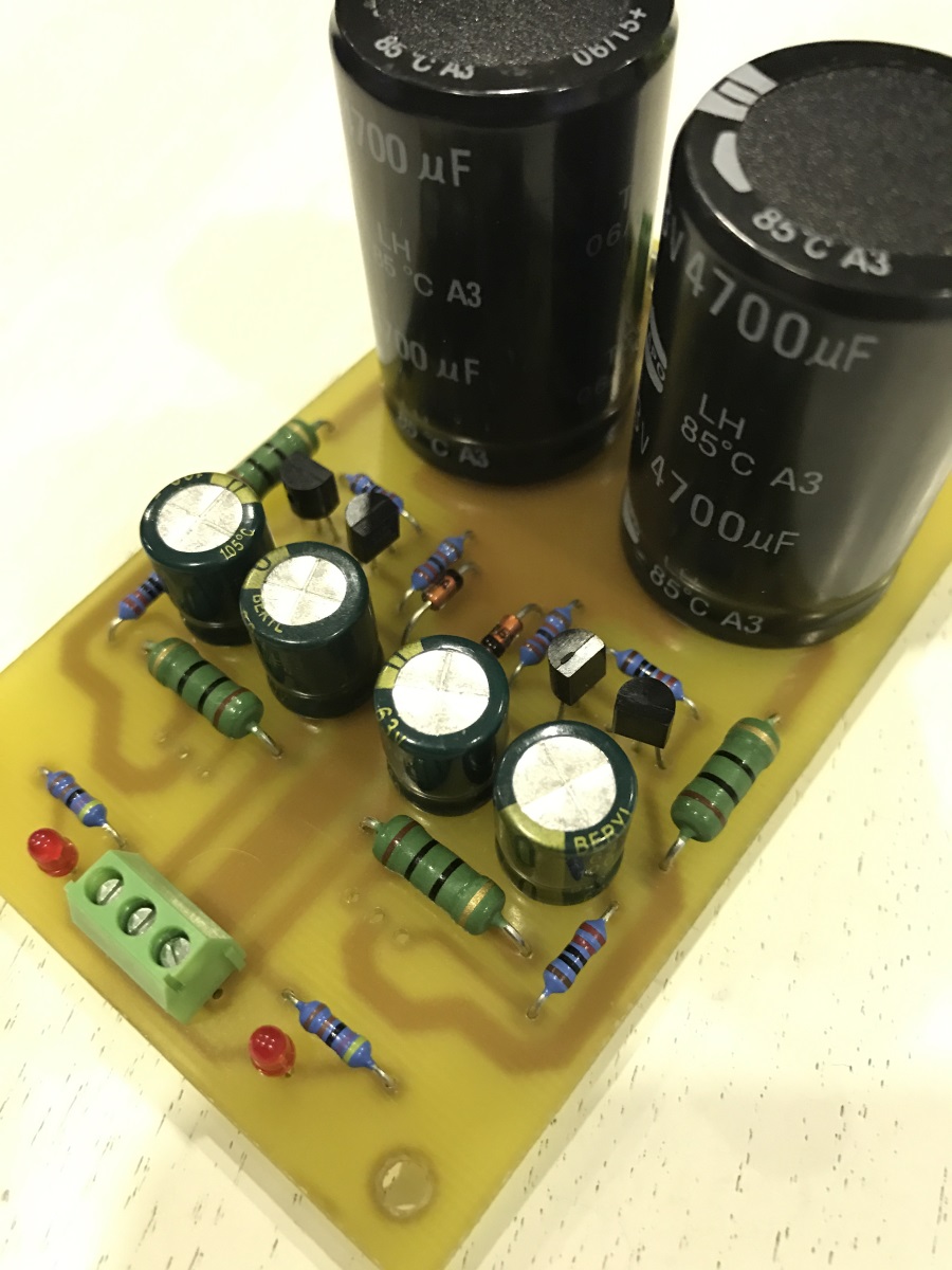

Hi, I have built the +-24V power supply. It works very well. Enclosed the sprint file. Maybe someone finds it useful.
regards Olaf

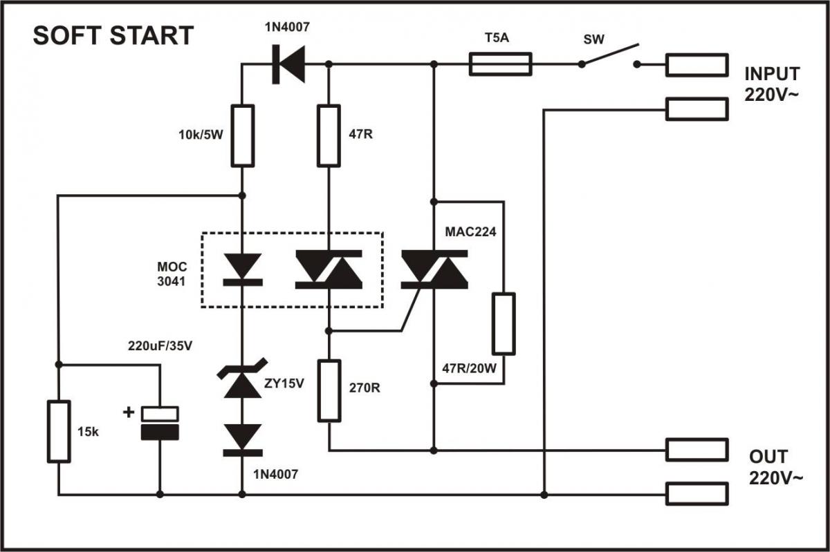

It looks to me that the T5A and the 47r, 20W are chosen to suit a 1kVA transformer.
I would use a lower resistance than 47r for a 1000VA to 1200VA, maybe 20r to 30r.
Or changing to a lower fuse for a 220/240Vac, 500VA (T2A), 750VA (T3.1A), 900VA (T4A).
If this is scaled to 110/120Vac duty then halving all the resistor values would be about right.
Maybe need to increase the value of 220uF to get the delay you require.
And double the value of the fuse.

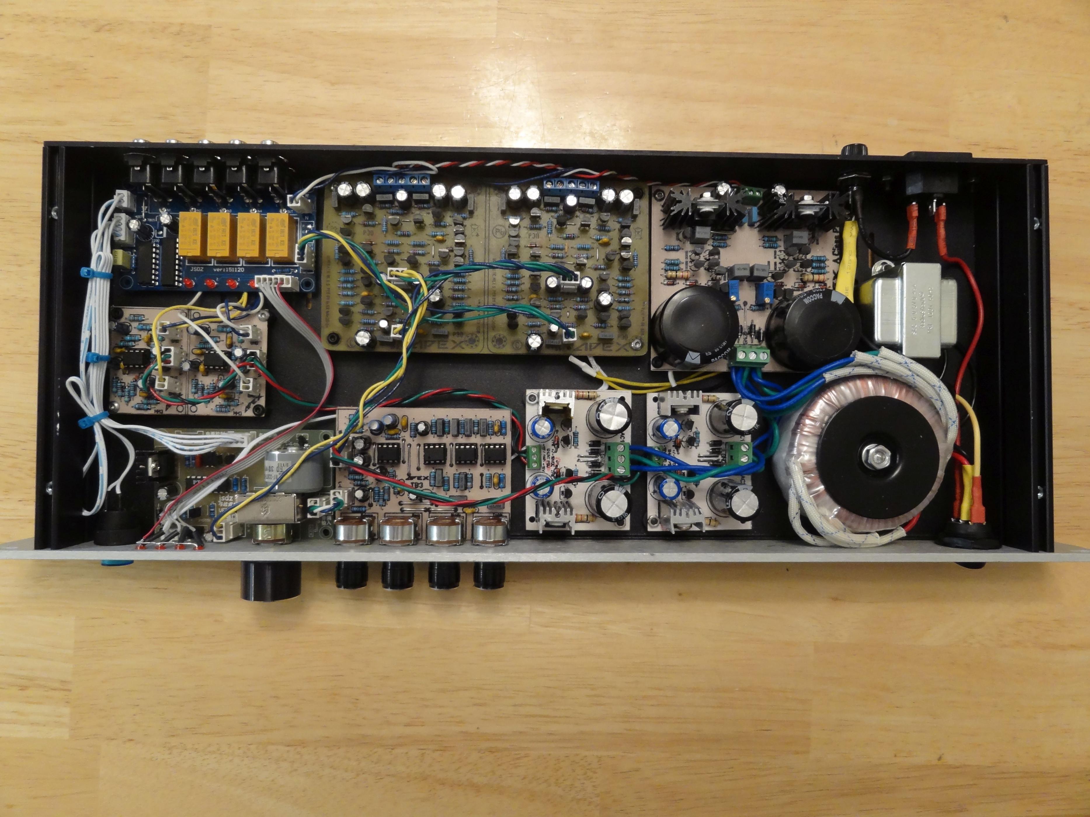

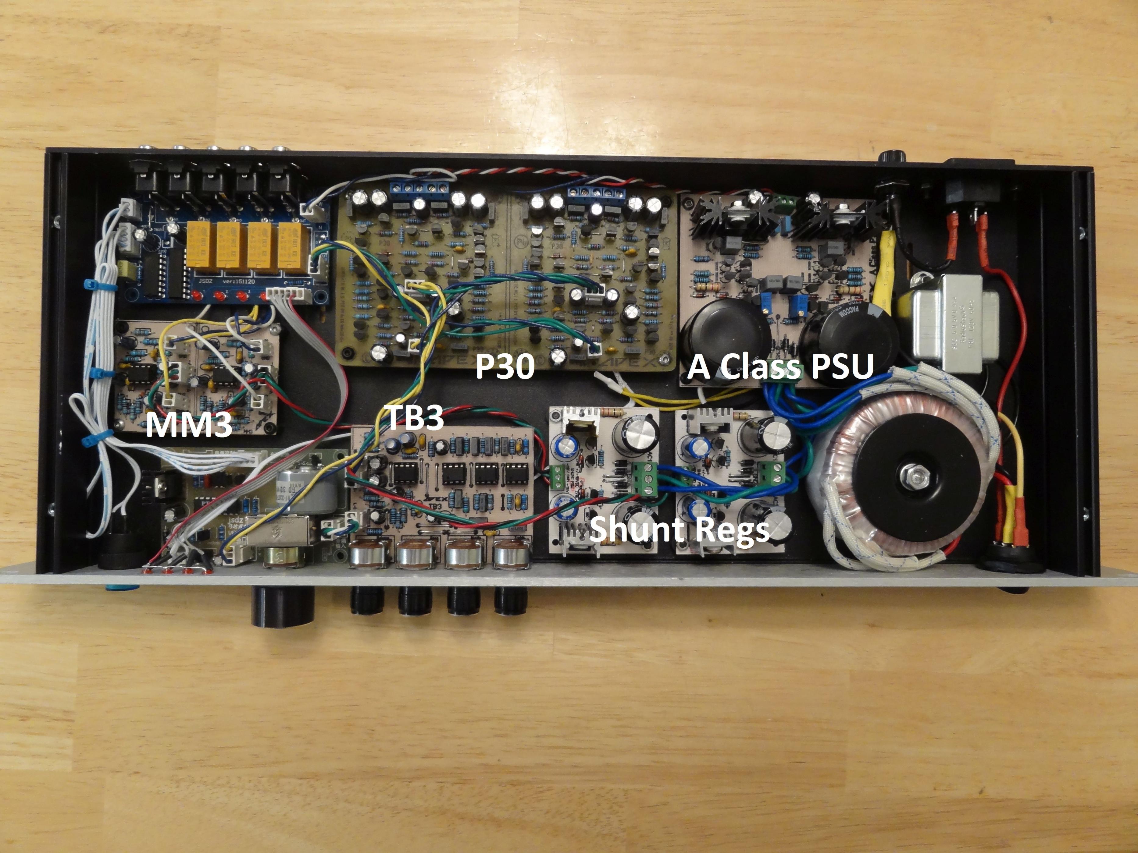

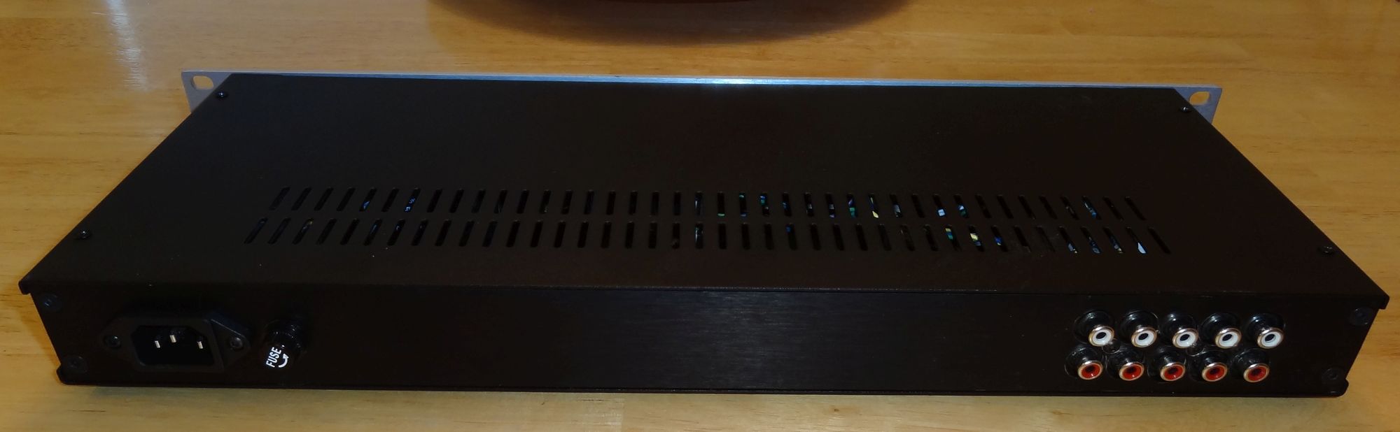

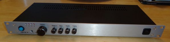

Hey Guys,
I finished the P30.
P30, MM3, TB3, Shunt Regs and A Class PSU.
I added a volume control/channel switcher with remote. Pretty cool setup.
