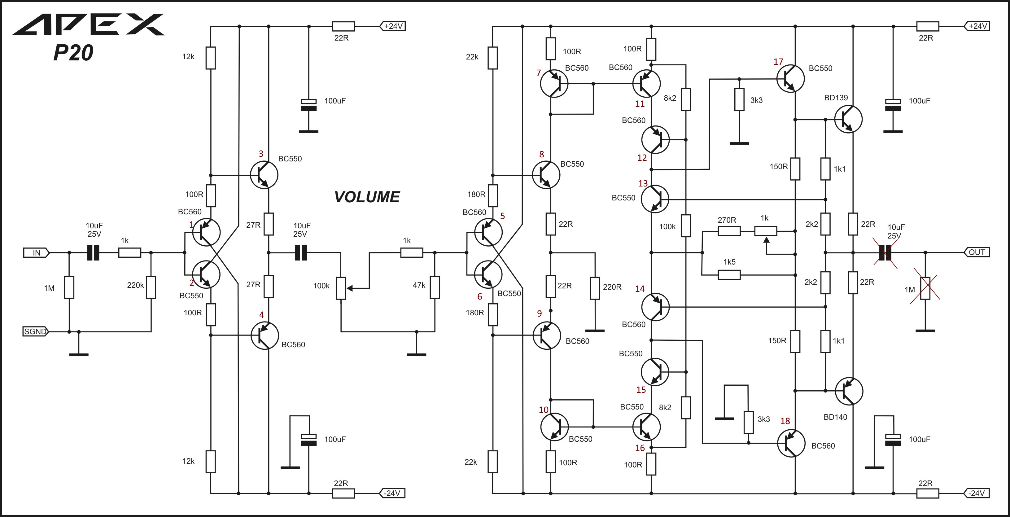

Hi, here is the sprint file and the circuit with numbered transistors. Maybe someone finds it useful.
The power supply in the picture from the previous post is a standard circuit with LM317 / 337. However, it must be replaced with one with a larger heat sink for stereo amplifier.

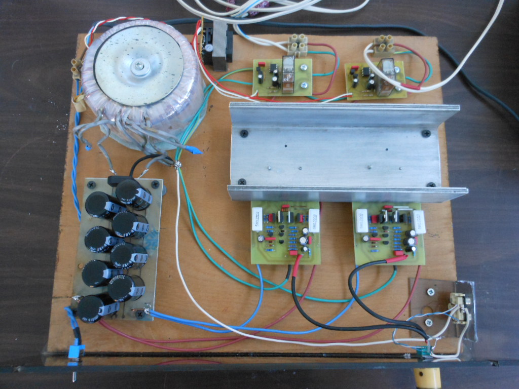

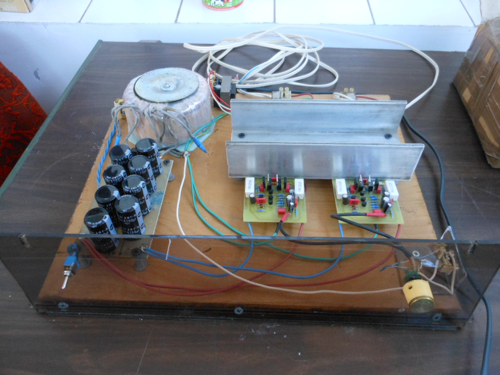

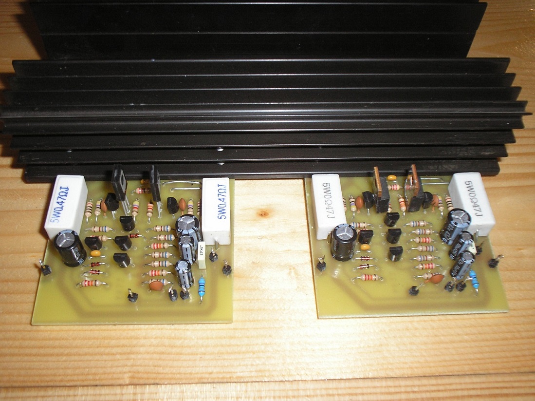

Maybe i vas a litle late vith the tread but here is my AX-11, best amp in the world 🙂
attachment.php
attachment.php
Transformer is recycled, 4x12V 8.6A from halogen light power supply, gives 2x36VDC after bridge, rectifier is simple, KBU806 and 4x4700uF per rail, vas transistors MJE340/350, drivers MJE15030/15031 and outputs 2SA1943/SC5200
Sound is great vay better than most comercial amps i have and better than LF55 that i was builded previously.
Thanks to Mile for help an cheers to all :cheers:

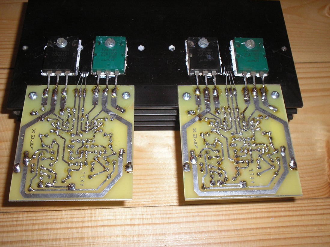

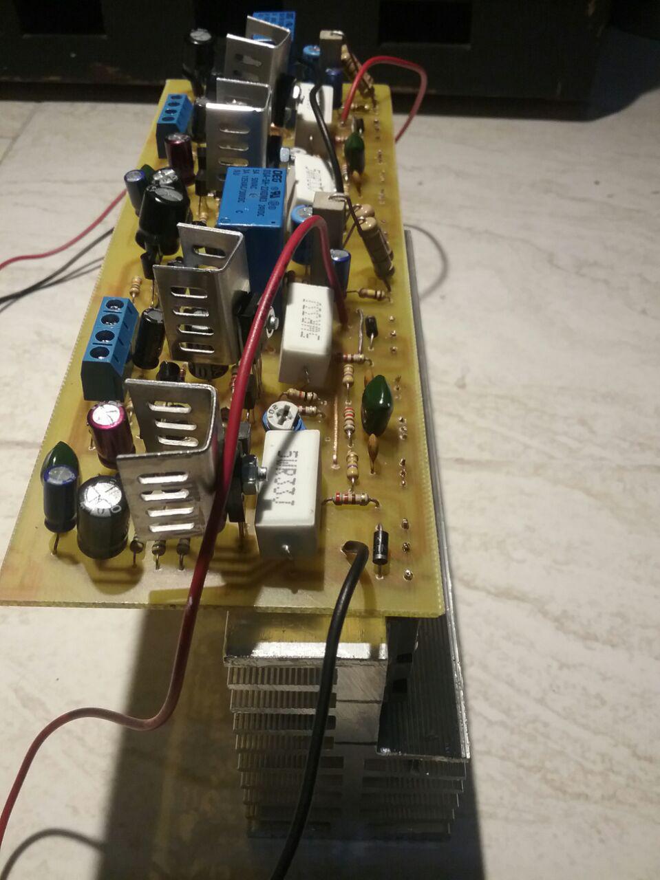

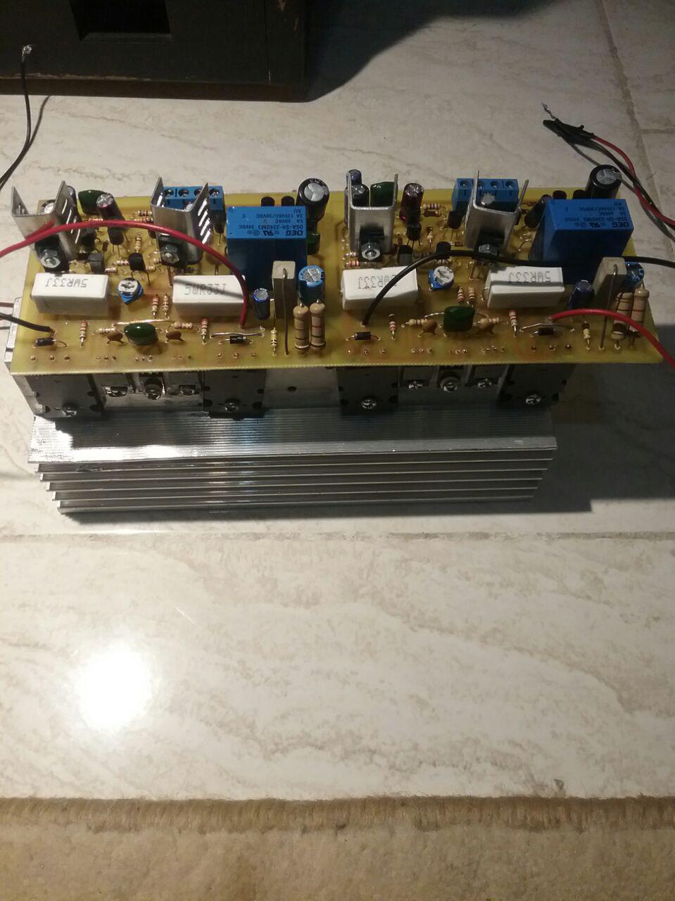

Hi.
this is a stereo apex ax-14P that I've made recently.
It has very clear sound.
I've made very amp heretofore, but this one is one of the greatest amp that I've ever made.
but when amp clipping occurs, the relay goes to Continuous off/on that destroys the sound.

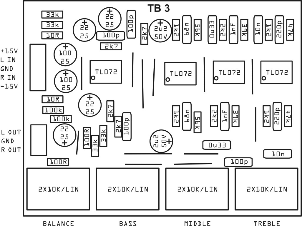

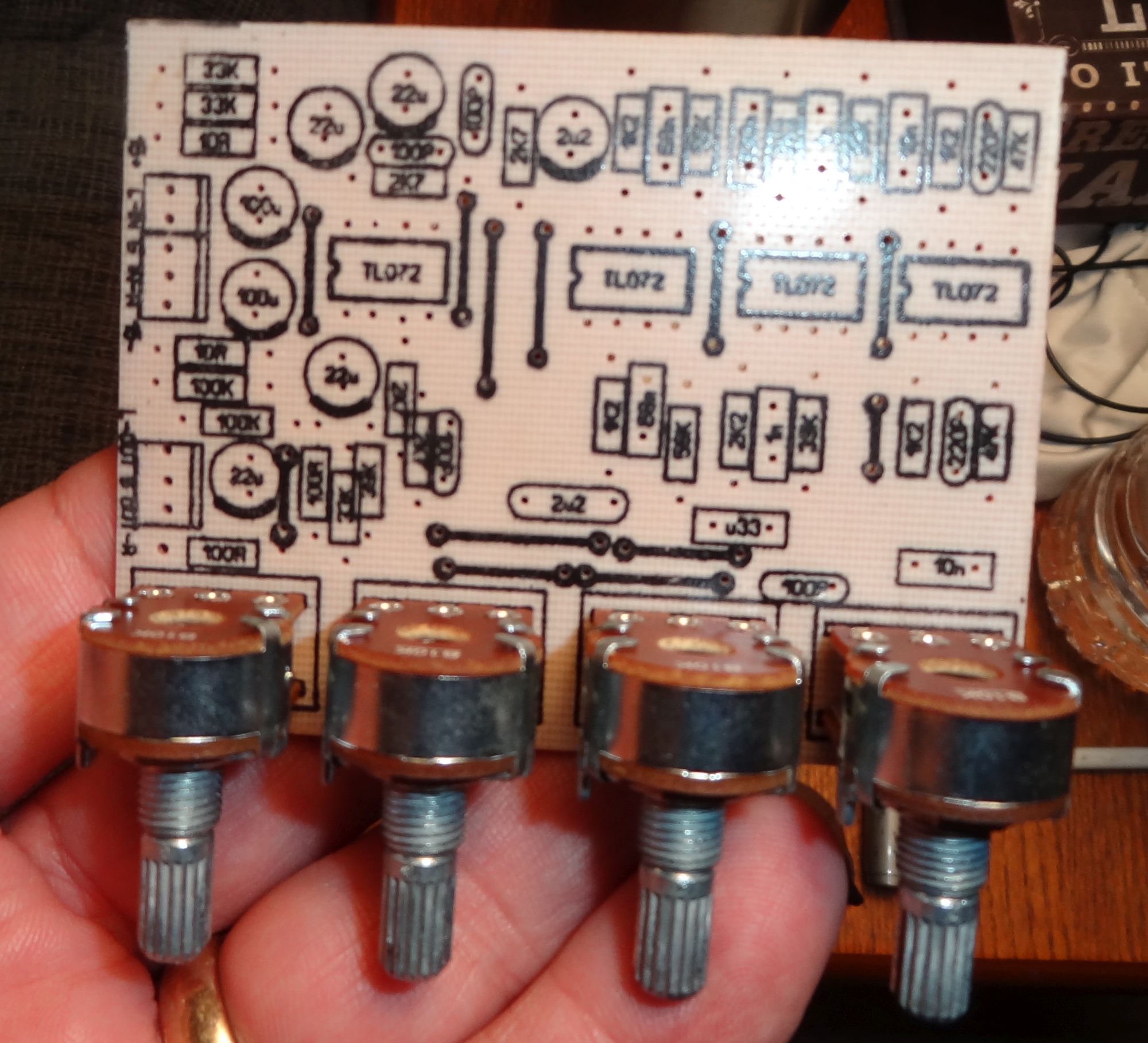

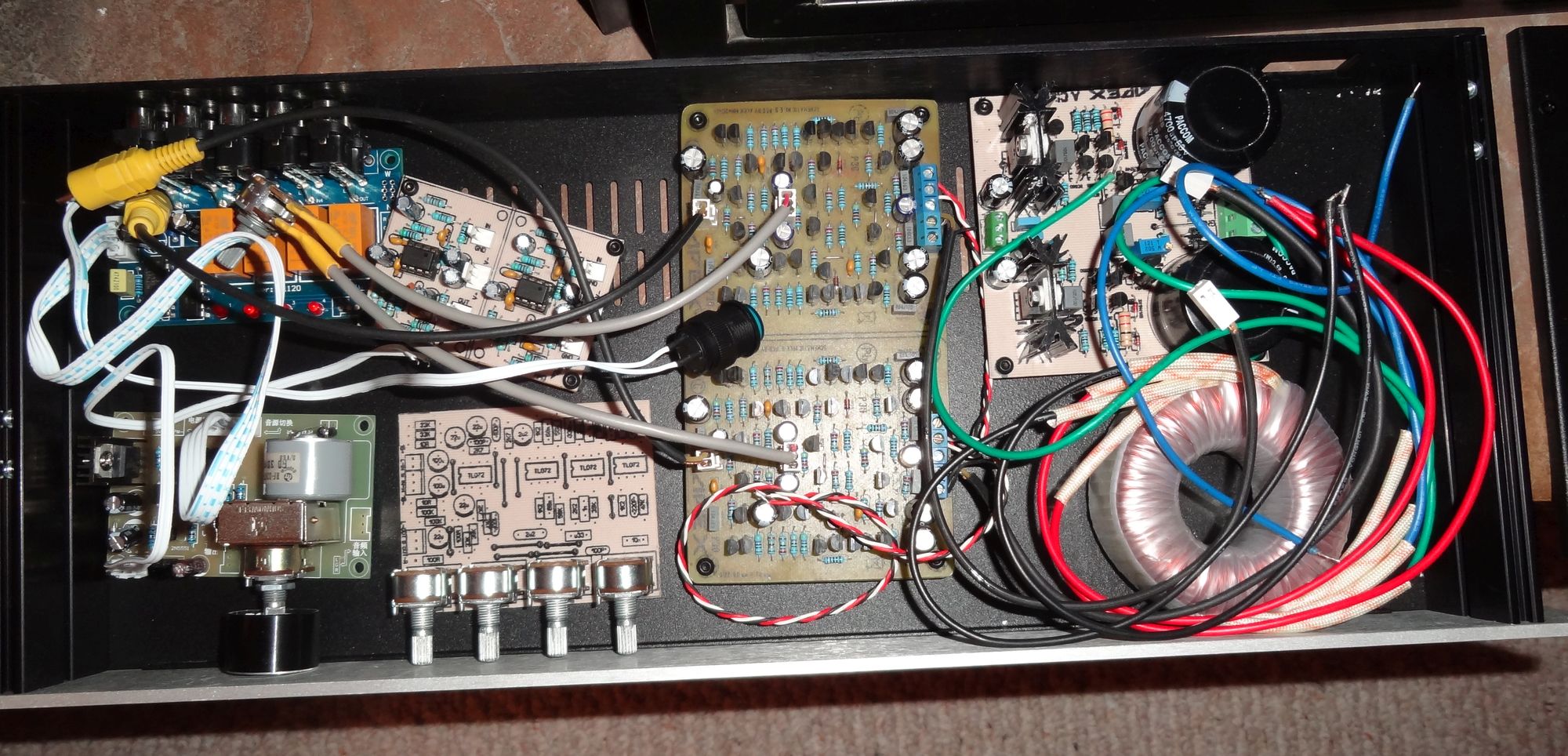

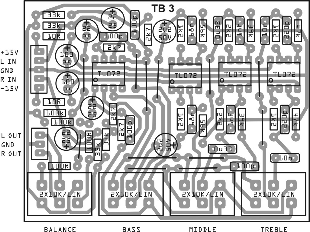

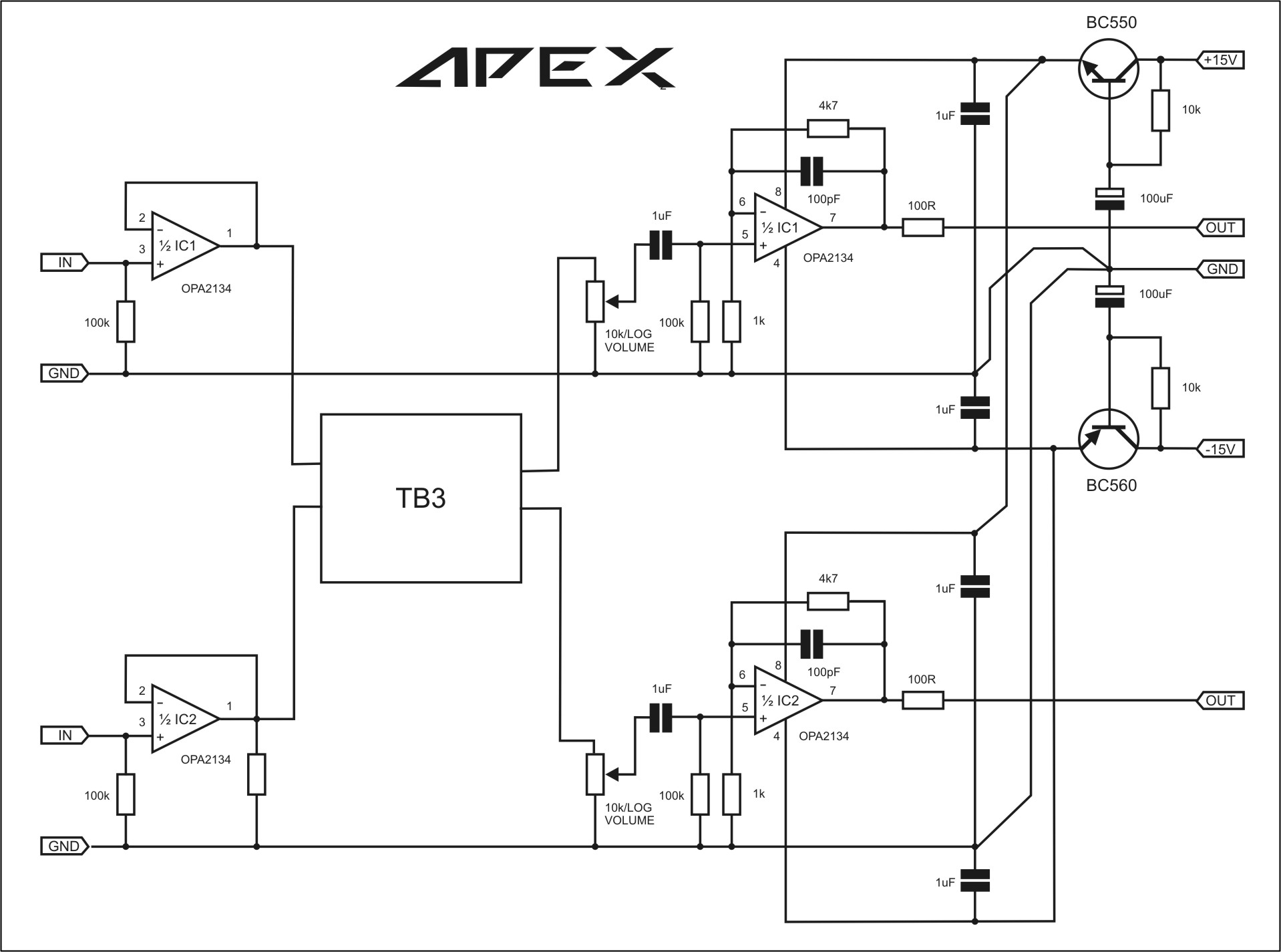

Hi Mile,
Thanks for the Tone control circuit. I am building an all APEX P30 preamp. Included will be the P30, MM3, A class PSU and this tone control circuit. I am not sure how the tone circuit and the volume control connect with the P30. DO you have a schematic showing where to integrate the tone circuit?
Thanks, Terry

Hi Mile,
Thanks, Terry
Nice work, connect tone control input to output of P30 input buffer and tone control output to volume pot input... A class PSU can not give current to supply all this circuits.
